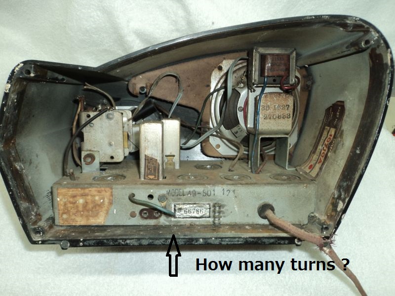

I bought a Philco Boomerang, but without the back cover and the antenna coil.
I would like to know how many turns the antenna coil has and what is the diameter of the wire.
If you have a photo, with that detail, I would appreciate it.

The original loop antenna it is not glued to the back panel, but to the inside of the radio.
In this photo, it sees clearly.
Regards from Portugal,
Carlos
There's an old Rolling Stones song, "You Cant Always Get What You Want." The method I described will get you a working radio. Also, I realize now that plug on the back is an accessory plug, and the loop appears to be hard wired into the circuit. Good luck. Download the Rider's information from that link and read through it carefully. Lots of good information there. Let us know how things turn out.
Looking at Beitmans the ant is 2.8 ohms that is not listed on  Riders, enjoy your project looking forward to updates. David

To make your antenna ....
Set the radio onto a thick (1"+) piece of wood (anything will work, softer is easier to cut) and trace the pattern.
Knowing the thickness of the cabinet, redraw your tracing, but smaller to take the cabinet into account.
Cut the pattern with a band or jig saw and use this wood as the pattern
Put double sided tape around the pattern
Wrap your wire around the wood pattern and stick it to the tape
When you have more than enough wraps (based on your photo) stop./
Put strips of hot glue or similar across the windings to hold them in place.
Cut the wood out or slide the loop off , wrap it in several places with clear tape to keep it together and install it inside the cabinet.
If your pattern was properly cut, the coil should be a tight press fit.
Test the set and reduce the number of wraps until the set works best.

One thing that nobody has mentioned is that there are actually two windings in the loop antenna coil, one acts as the antenna to the set, the other is to connect an external antenna. I can't remember the ratio but I think it's 3:1, they may give a DC resistance of each coil in the service literature. I think that the best course of action is to make a form out of some plywood, or lumber, by tracing out the inside of the cabinet, and cutting out the shape, including the ribs that the back attaches to, but you will have to make it smaller to accommodate the wire, this is if you want to make a facsimile of the original loop antenna. Otherwise you could just make a electrically similar coil and mount it to a replacement back, which is likely the easier route.
