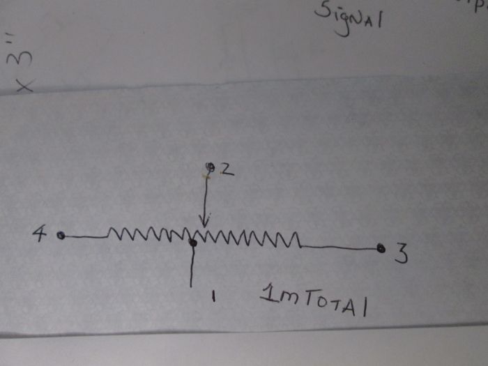

Hey folks; does anyone know how the volume portion of the 46-1201 on/off switch is designed? What I mean is this: Is the potentiometer that makes the volume increase/decrease a split design (1 for phono, 1 for radio) or is it 1 pot that is able to switch it's function one way or the other?
It may be a long shot but I'm beginning to think that the radio volume side of the switch is bad.
Just a thought.
It doesn't switch per say the center of the pot is connected to b-.  But the wiper travels the length from phono to radio. The center point of the two resistances are connected to a separate terminal (1). Wiper is connected to terminal 2. This set uses an odd control.

See connections 1 and 2 on R200.
Got it; thanks. At any rate, I tested the switch and all is well.
