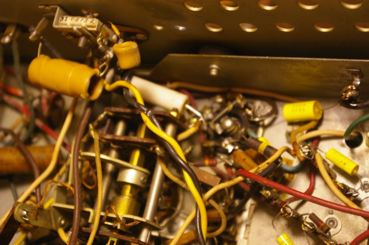

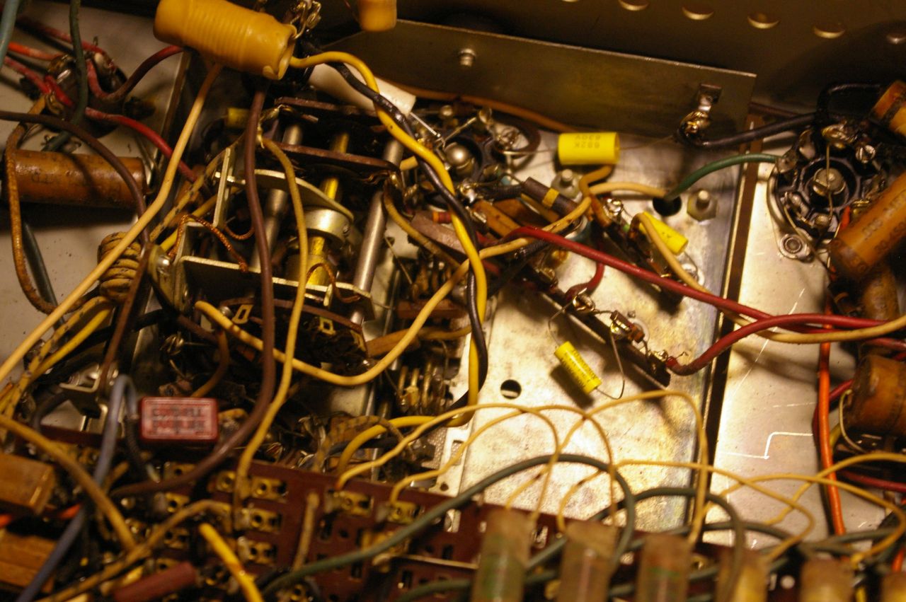

Got motivated tonight to start replacing the paper condensers, starting with the hard to get at ones under the rotary switch and the push button tuners. I figured to get these out of the way since they are the most obstructed and difficult to replace.
[Image: https://64.media.tumblr.com/b0e795e4f309...df4729.jpg]
[Image: https://64.media.tumblr.com/6edb7e02dbca...258f99.jpg]

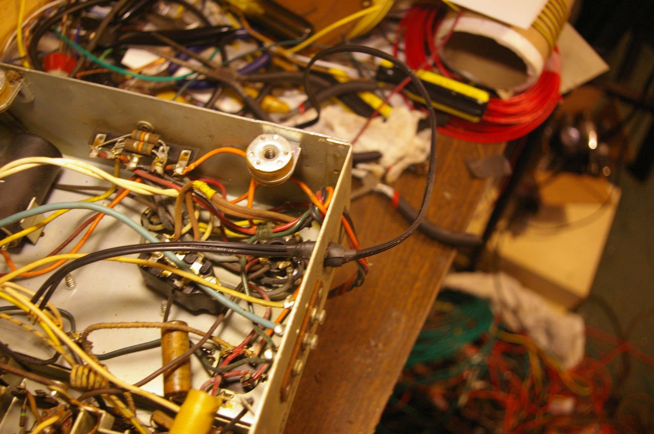

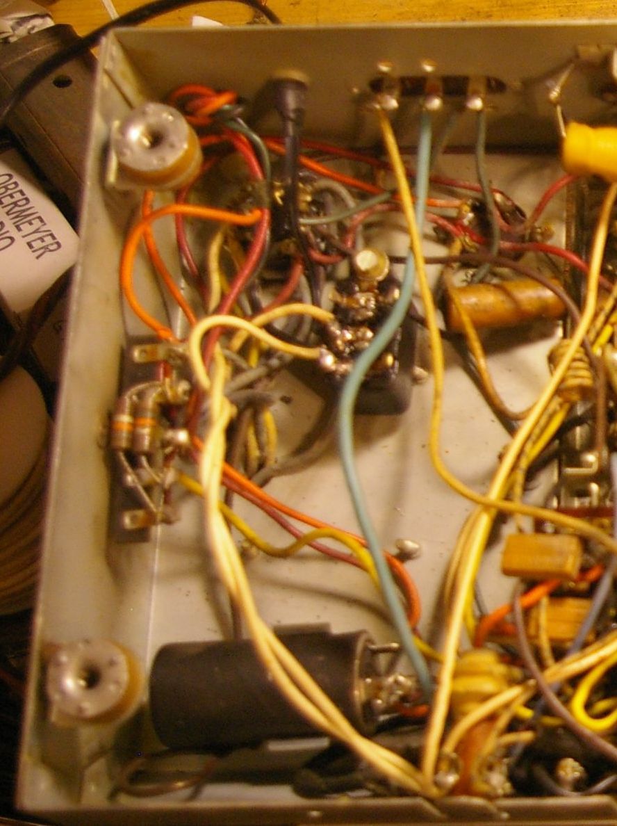

HOORAY !  Today my order from AES came in, and I got back to replacing paper condensers. I finished replacing everything in the area which is obscured by the output transformer, and then put that back. Now I just have one corner left to do, but it has a lot of paper condensers, some of which are quite buried, so I will have a nasty chore there. Here is a picture of all the condensers in the area I replaced since my last posting, and then with the output transformer back in place.
[Image: https://64.media.tumblr.com/be95bc13c845...e45bc5.jpg]
[Image: https://64.media.tumblr.com/5f2dcd66f92b...4285ca.jpg]
