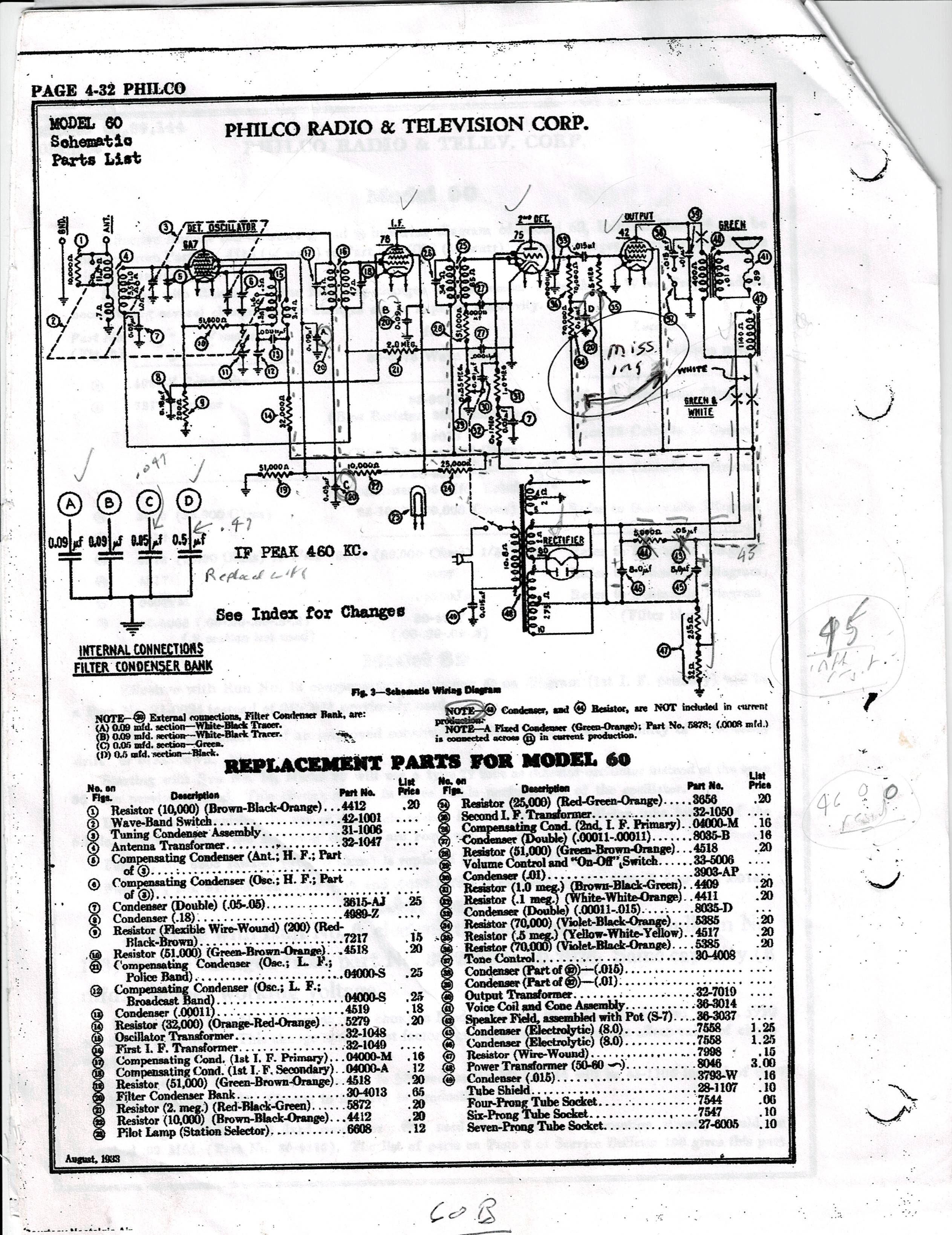

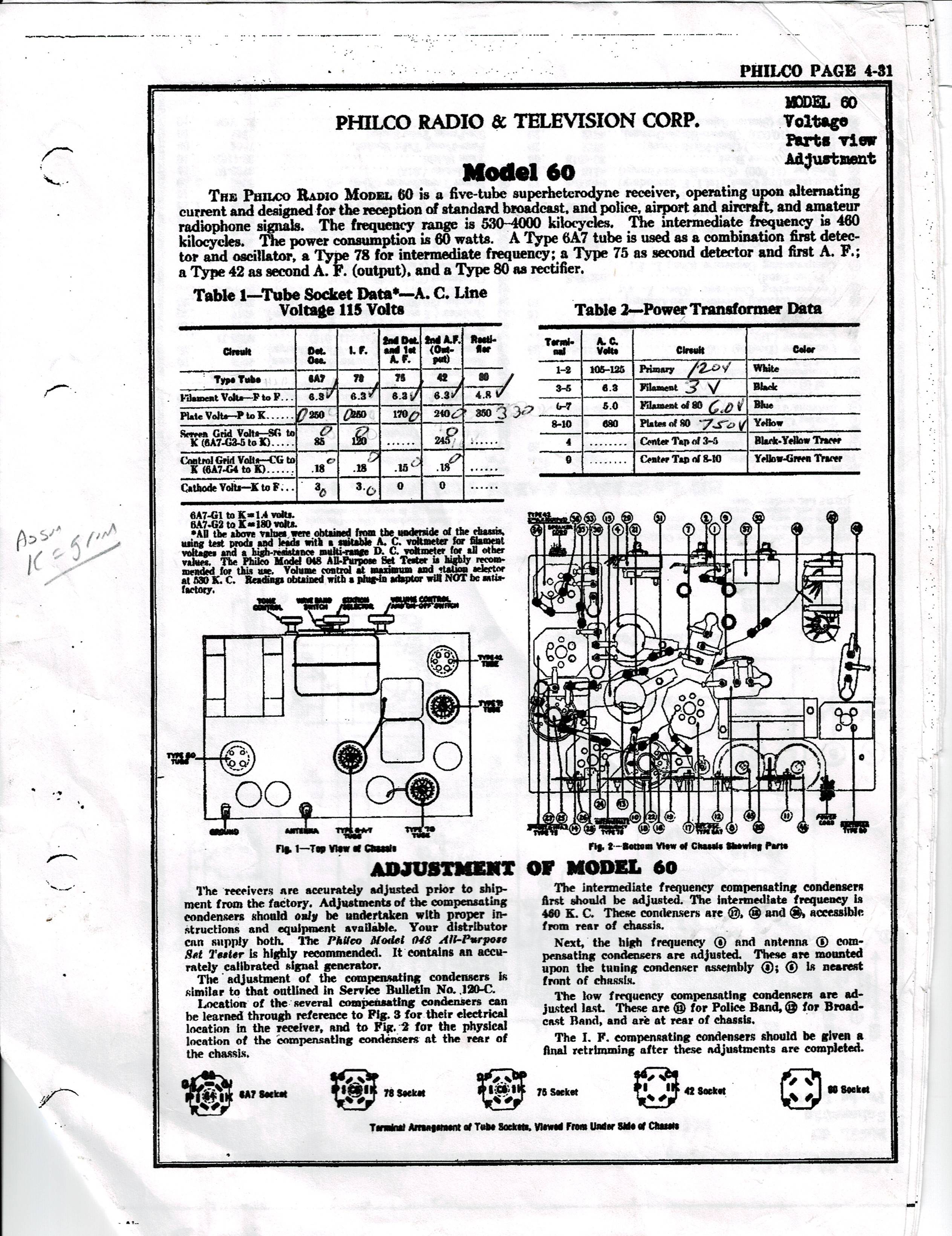

I am refurbishing a model 60 B. All tubes replaced as well as capacitors ( excluding mica capacitors )  Attached is the schematic, and results of the voltage readings at the tubes on Table 1. As you can see there are no volts at most of the plates and grids except tube 80 reading 330 volts. All filament volts are okay  Table 2 has the power transformer data and while terminal 3-5 is only 3 volts the plates at tube 80 are  750 volts.  Tubes 42 and 80  light up but not so for the other tubes. Needless to say there is no sound. Any Thoughts?

The resistance from pin 1  to the +side of 46  reads 0 ohms, continuity. From the + side of 45 it's Infinity ie no continuity.  From - side of 45 to chassis is 268 ohms. Regarding the wiring when I replaced the caps  I followed the existing wiring. I notice now on the schematic that the plus from 45 should connect to tube 42 directly as well as a 70 K resistor. These wires are not there as noted on the attachment. I also noted there were several versions of the model 60. The one I have is the 60 B based on the cabinet face. Attached is the new schemo for 60 B from the Radio Museum (Its A pdf so you need to open it ) which seems to more closely match what is there but again these wires are missing. I would think the newer schemo is more accurate? Regarding tube 80 its base was loose so I purchased some NOS for that tube as well as all the others. I have a tube tester  Sencore TC 136 but it does not have the sockets for these types of tubes .

Ok so if you measure an open circuit between the +'s of 46 & 45 then there is bad connection or something is miss wired. You should see the same resistance as the field coil. Without this connection you will have no hv farther than 46. And yes # 42 is the field coil.
The diagram from RM is pretty hard on the eyes. https://philcoradio.com/library/download...l.%201.pdf
