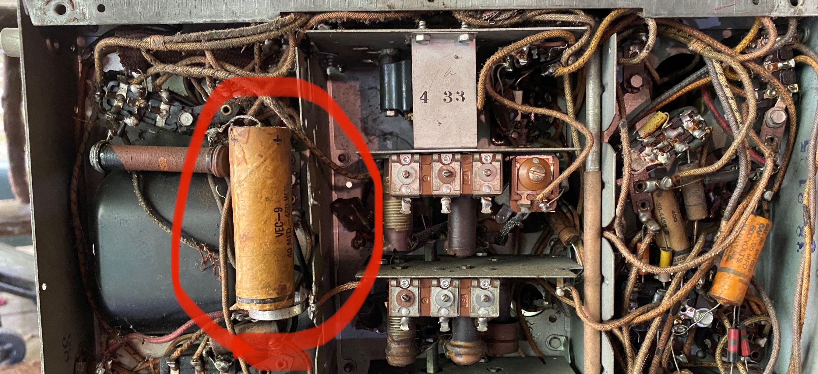

I have recently inherited an unfairly treated 37-10 that I would like to get started with the usual safety checks and parts replacement. This radio has been in the family continuously since my great-grandfather purchased it, and I'd really like to have it put back into working order.
I've pulled the chassis, given it a bit of a dust blow-out, and in preparation for ordering parts, I've also downloaded a mess of documents on it.
There is a cap in the "power unit" section that I cannot find referenced in the schematics, parts list, or drawings of the chassis. I thought maybe I'd been mistaken on the model information, but the sticker inside the cabinet, along with some quick cross-checking of other pieces/parts show up as being legitimately in the correct place and part numbers, etc, so I'm feeling confident that this is at least probably likely correctly identified.
I've pulled the cap slightly out of the retaining mount so that I could get a better look at it.
It's appears to be labeled 40uf/450V. If you can zoom in, you'll see the markings on the right side. I can provide a closer image if that helps.
There's no part in the part list with that spec.
The drawing of the underside of the chassis just has nothing there.... The other parts in the immediate are I've been able to find and identify. So, it seems I have an extra part?
I'm not quite ready to yank it all the way out to see if there is a part number underneath and I'm just not reading the markings correctly, or follow those wires to see where it's hooked up and maybe back-trace the schematic, but that might be my next step.
I searched the forum, but couldn't find anyone else that seems to have mentioned this. I did, however, find reference to an updated service bulletin "Changes: July 1937"-- and while it mentions this model, it had nothing to do with this capacitor.
Can anyone shed light on it? I mean, I intend to replace the cap anyway, but if this rings a bell, and might point me toward new and better reference materials, I surely would prefer to avoid any additional surprises as I start fiddling with this thing. Or if it legitimately shouldn't even be there, I'd like instead to put it all back to the way it should be.
Thanks in advance for any help!

Welcome to the Phorum! I think the part is a long ago replacement electrolytic cap. The schematic for the radio calls out four electrolytic caps - 16 mfd (item 31), 8 mfd (item 82), and 10 mfd and mfd 20 (item 84). The 10 and 20 mfd ones appear to be in one can and the other two in separate cans. These cylindrical cans should be standing vertically on top of the chassis. They will be marked on the side with their values. That info may be obscured by other items. My guess is someone had reason to replace one electrolytic cap and added the 47 mfd cap under the chassis. It might have been the 20 mfd cap since its in the same can as the 10 mfd cap. Using a higher value of 47 is not unheard of either. Tracing the wiring in the schematic should tell you which cap it replaced. This is not an easy radio to work on. It seems crowded under the chassis and I saw two bakelite blocks which have caps inside, potted with a tar like substance. On the plus side, there is a lot of documentation.

Yank it. Someone wanted to disguise a fix for problem that they couldn't find or fix.

I had considered that it was "a fix" of some sort. It has clearly been serviced to one degree or another in the past.
A couple of the tubes are, while the correct type, no longer "Philco" branded. The power cord is most certainly not original(and a bit of a sloppy soldering job). And I noted that there is also a resistor in the RF unit that is... well, the lead appears to have been actually snipped vs just "come loose" or unsoldered. So... somebody has had their hands in here at some point. I won't comment on other also noted "globby" soldering joints beyond that they exist.
There may have been a small number of quietly expelled vulgarities, an obscenity or two, and a dash of profanity for good spice.
Now that said, if someone had gone in here and added this 40mfd as a "fix" vs replacing the canned 10/20 combo, two things makes me go "hmmm" that I would like to possibly also get an opinion on. If you have the time, of course.
- doesn't this notably change the characteristics of the rectifier output?
- if someone had just added this in there, whether as a replacement for one leg of the canned combo or just a "I have no clue but it works now" type of "fix", I find it curious that they would go through the trouble of attaching a mounting bracket to the chassis. That seems like more work than just replacing the original part or just hooking it up and calling it a day, no?
I'll double-check it later this afternoon after work and see where it hooks up.

I have come across added electrolytic caps. The best option is to make it like the schematic. That means tracing the wiring from the original caps to see if the added cap replaced one of the original ones. If it didn't, make notes/photos of what is connected to what when you remove it. Replace the old electrolytics with new ones under the chassis (they can be a slightly higher value if you can't find exact values), being sure to cut the connections to the old ones. Again, make sure you have notes/photos showing where wiring from the old caps went and what they connected to. I can see a repairman taking the time to add a clamp. The replacement was sizable and better to secure it so it doesn't move around and stress wiring connections when the radio is moved. Same goes for other wiring; make sure what you're taking out doesn't remove a circuit shown on the schematic. Also remember that a schematic is not a wiring diagram. A schematic just shows signal flow and not the point to point connections. Schematics are hard for me as I'm used to wiring diagrams (which require little knowledge of signal flow).

The cap in question was one half of the power filter can, so either the other side hadn’t died yet or the repair person didn’t think it was important.
Anyway, after many replacements and parts-wrangling, the radio is working( for what poor reception I get here even with modern equipment). And I’m down to shifting bits and pieces prior to remounting in the cabinet(another thread pending in cabinet restoration coming soon)

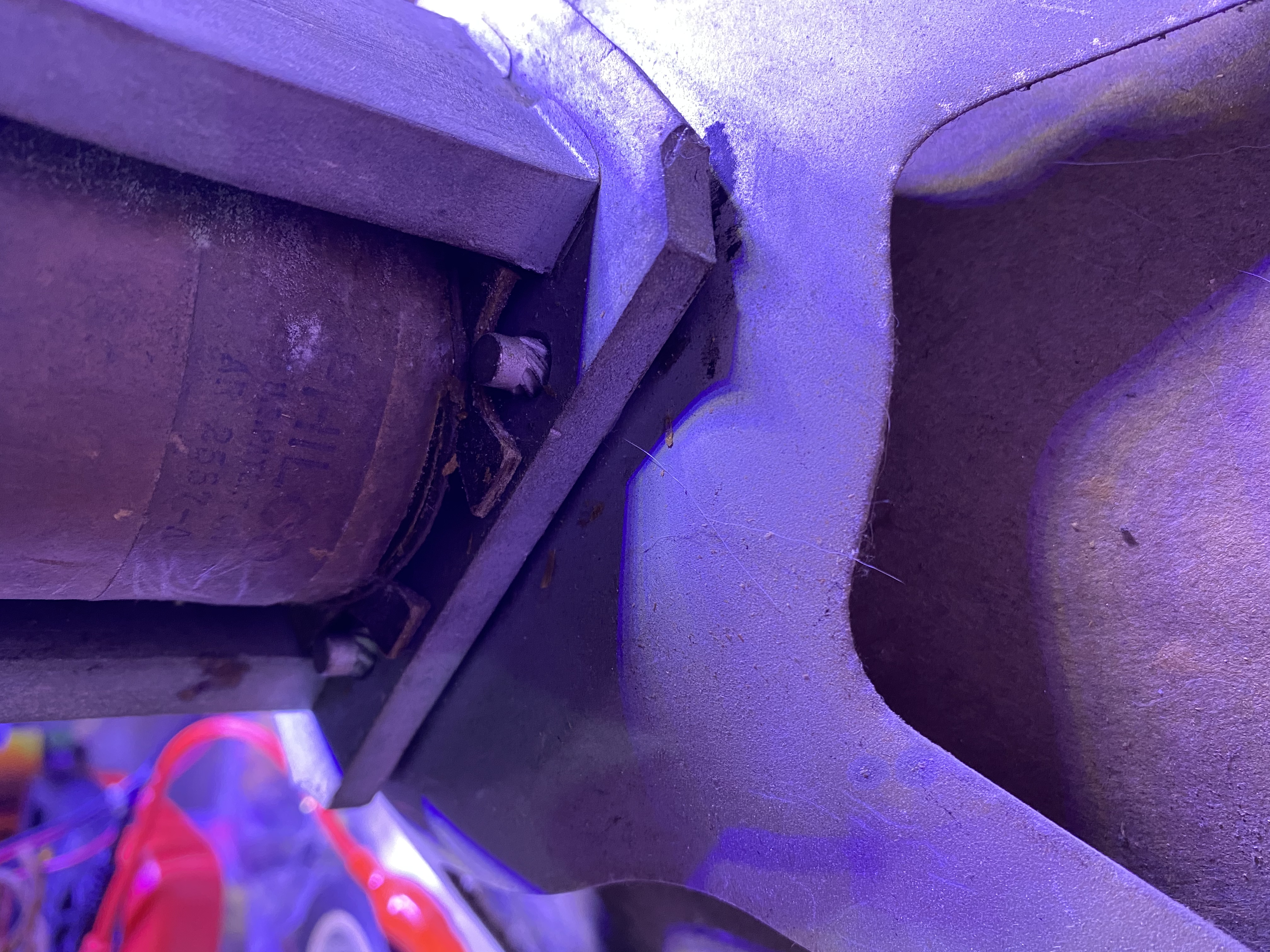

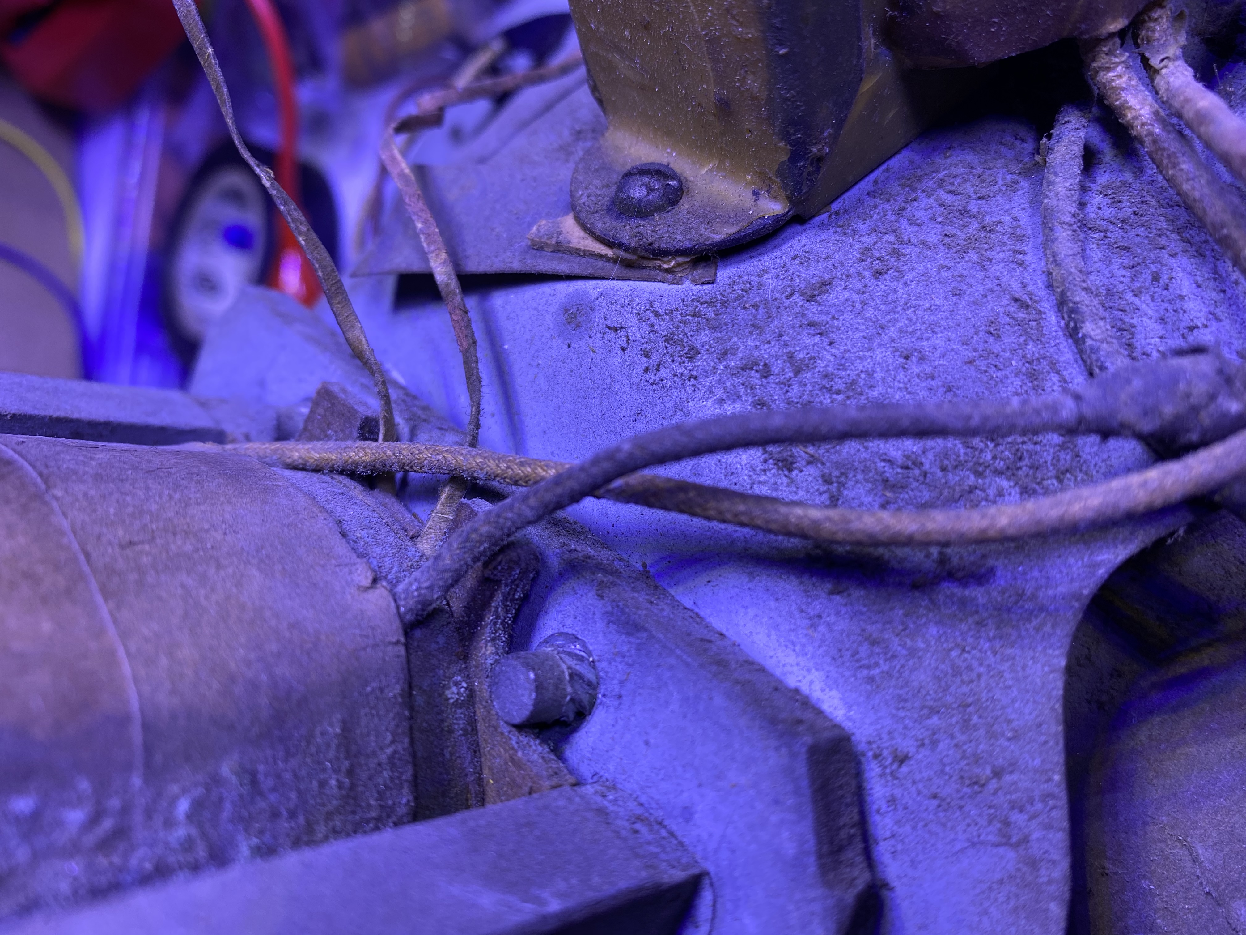

I cannot, for the life of me, figure out how these strange smooth-headed bolts are keeping this thing in short of “they just pounded them in”
So... do I just pound them back out, in reverse?
Check out these weird twisty attachment things at the corners. The other side is a smooth round bolt head. Nothing to turn.
Before I proceed on a “gosh, you’re kinda not all the bright, are ya?” course of action... is there something about these I’m just not seeing that should be obvious?
Knows enough to be dangerous, occasionally successful, rarely correct.
Posts: 1,114
Threads: 14
Joined: Feb 2013
City: Irvington, NY
That's exactly what they are "just pounded in". They are called drive rivets and are driven in by force. To remove just drive with a punch in the reverse direction.
