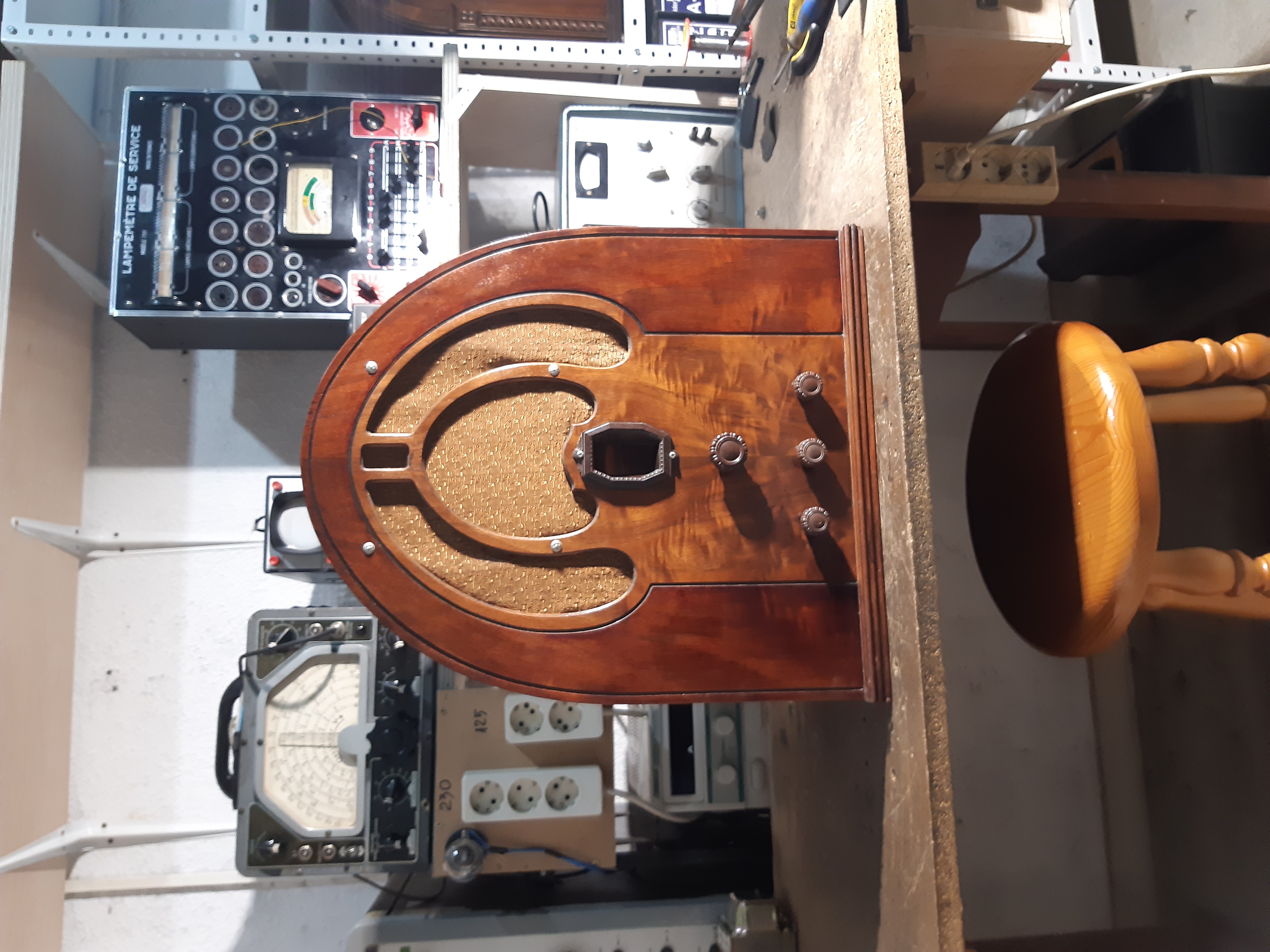

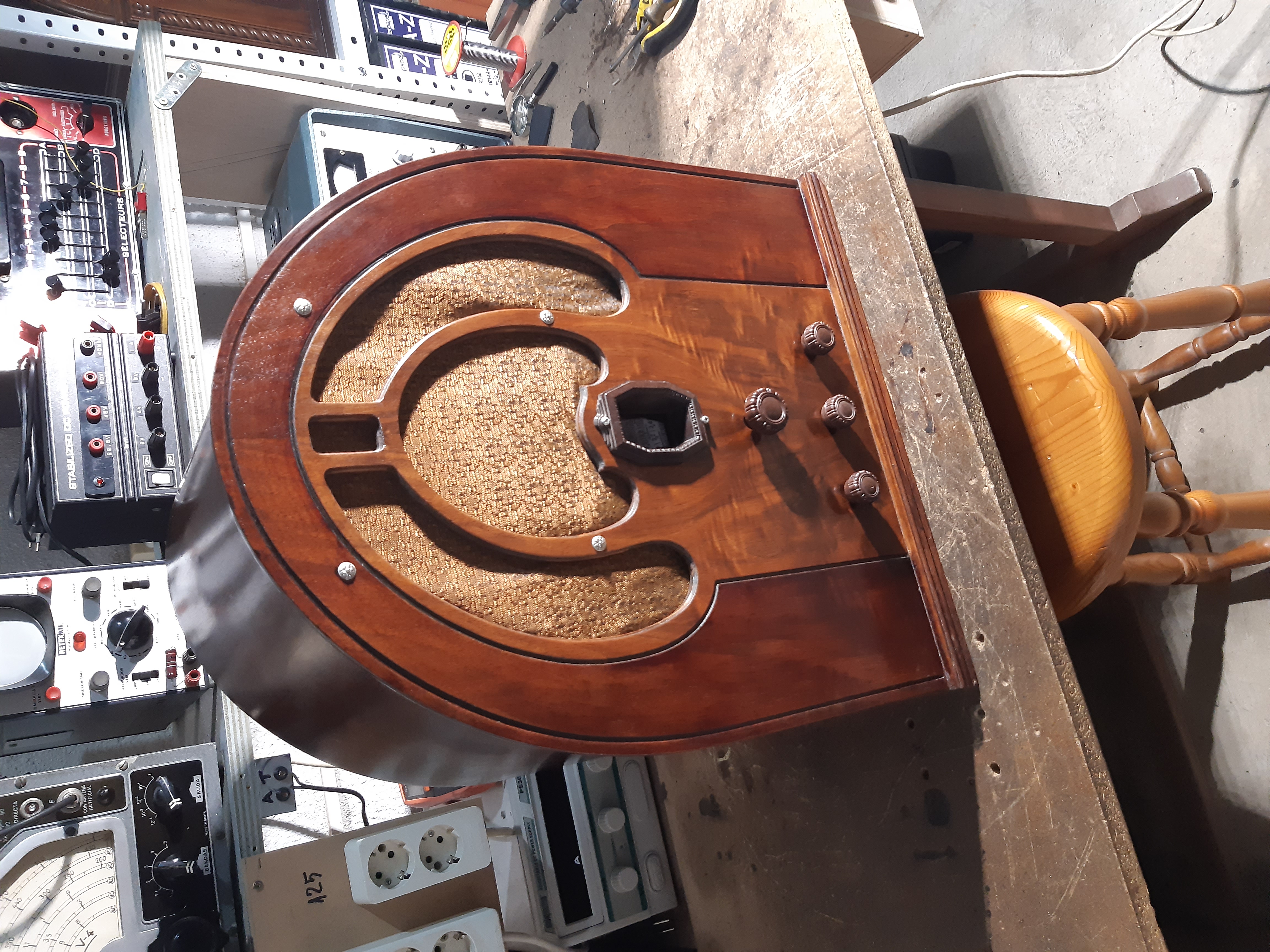

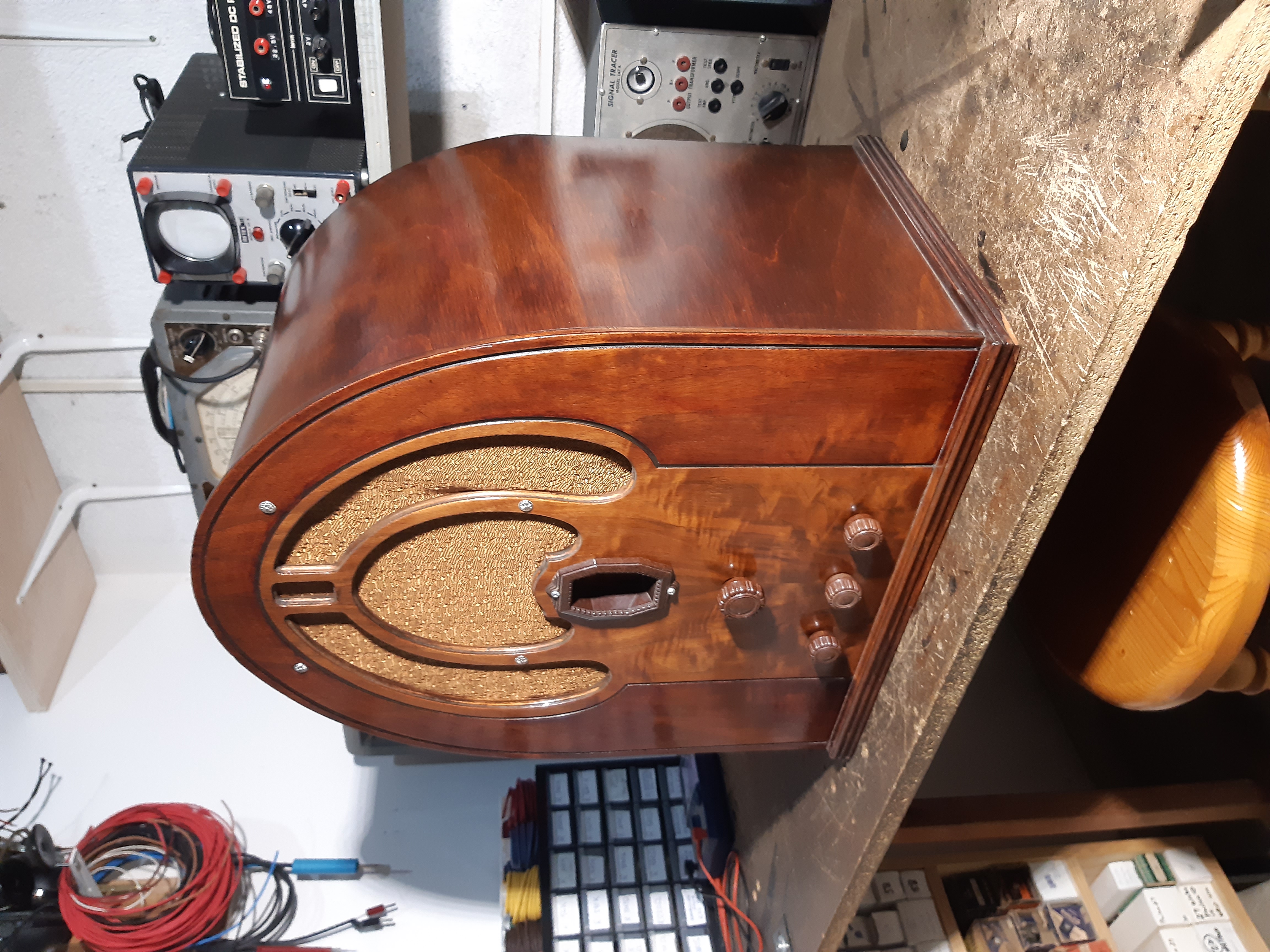

Posts: 3,186
Threads: 226
Joined: May 2008
City: Omak
State, Province, Country: WA
Hello Farran,
Wow that Philco looks great!
