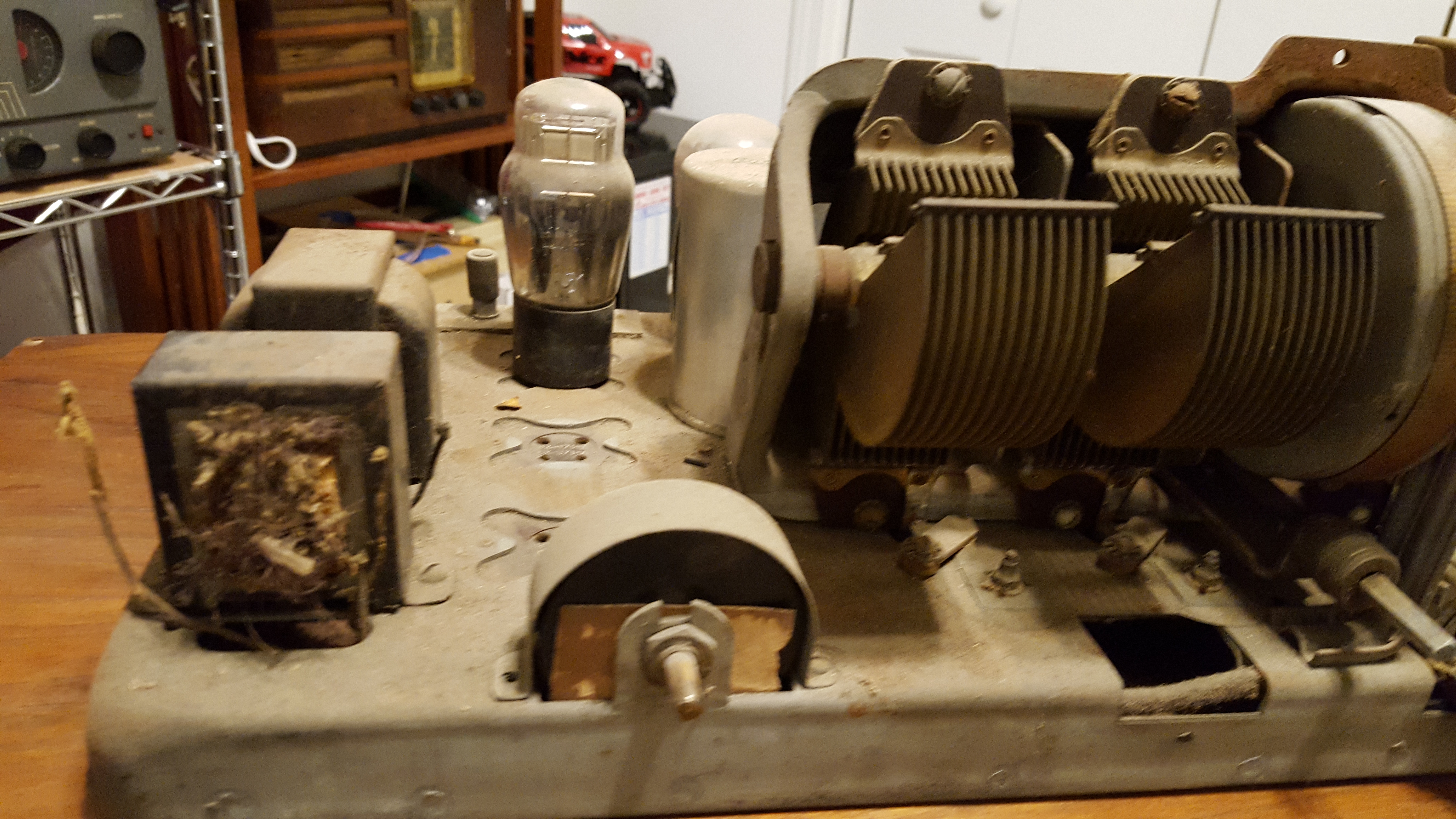

I'll get them on order. I will try to post a few pics of this as it is now, not near the shape that Buzz'z is, but I   will give it a try.
A little tip. If the dial cord is entacked lub the bushings on the tuning cap so there is the least amount of stress on the cord. It's a pain to restring. Looks like you got a little rodent damage... Good thing It's got a steel cover over the bottom of the chassis.
Hello George,
I see where your transformer became lunch for a little mouse !
I have a Zenith 1930s radio I even found a nest under the chassis .
That doesn't mean anything. I have a Philco 65 which had mouse damage under the chassis - inside that steel cover. If a mouse wants to get into something, and if there is any way it will fit through the smallest hole, it will do so.
