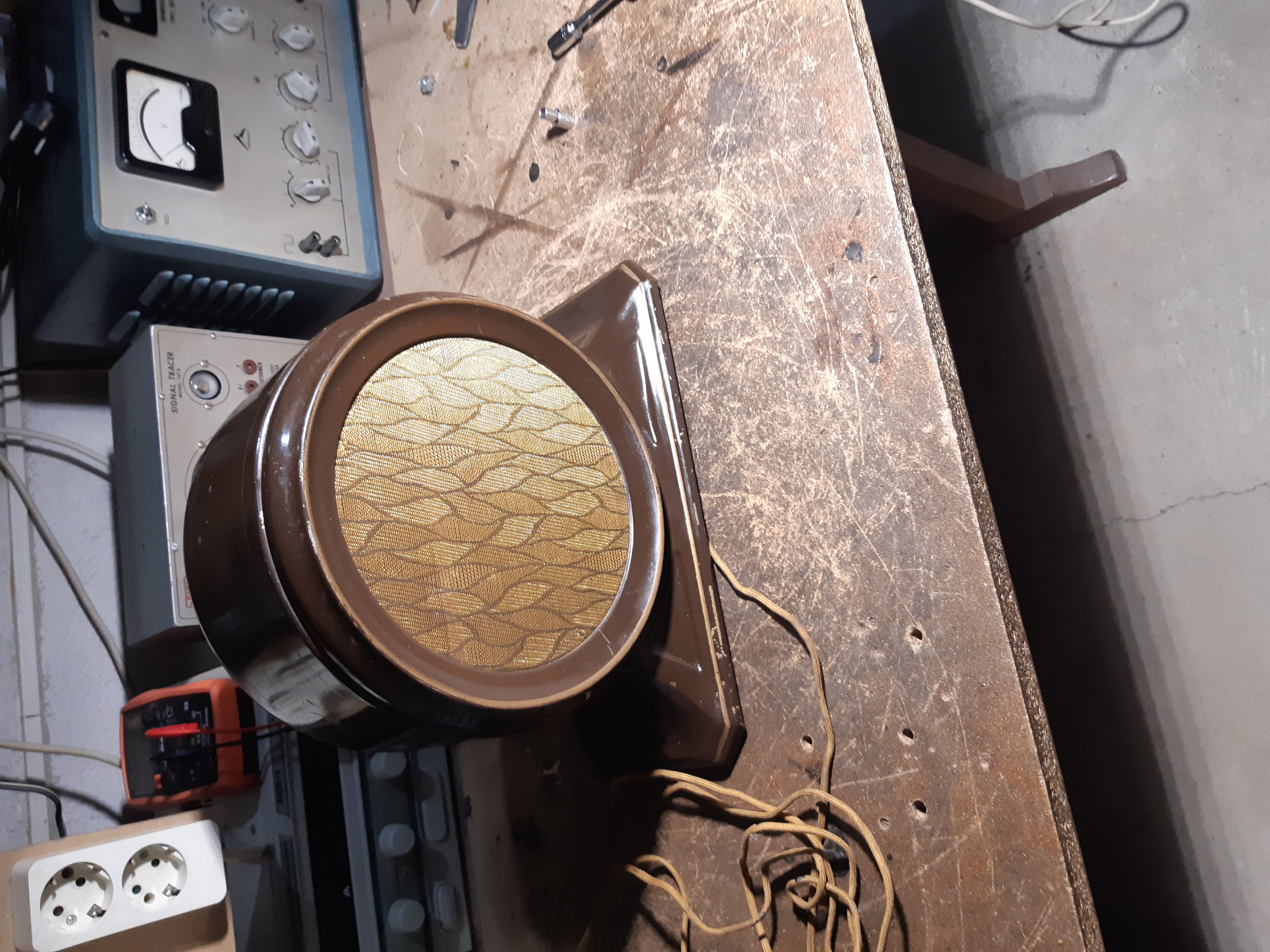

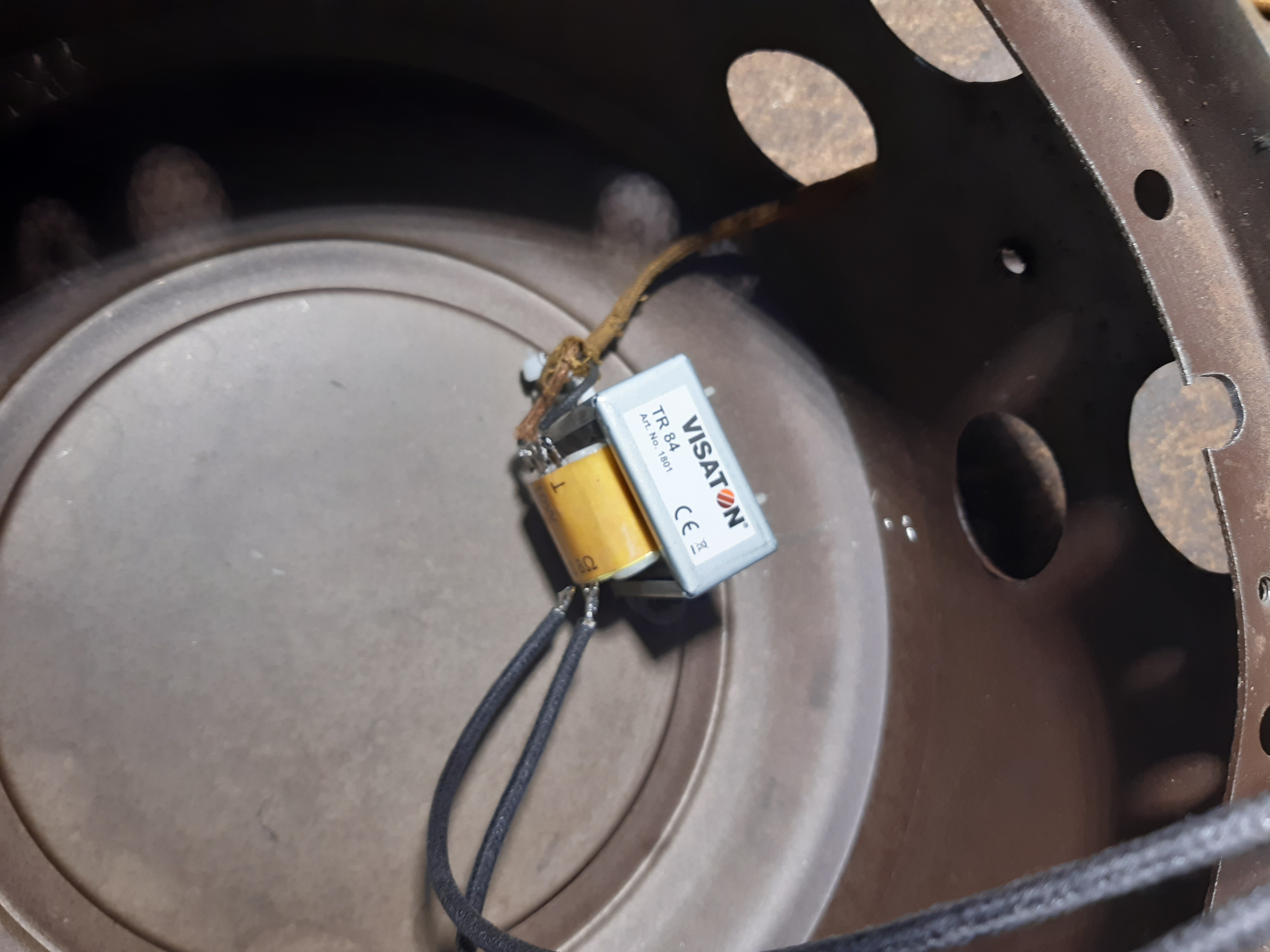

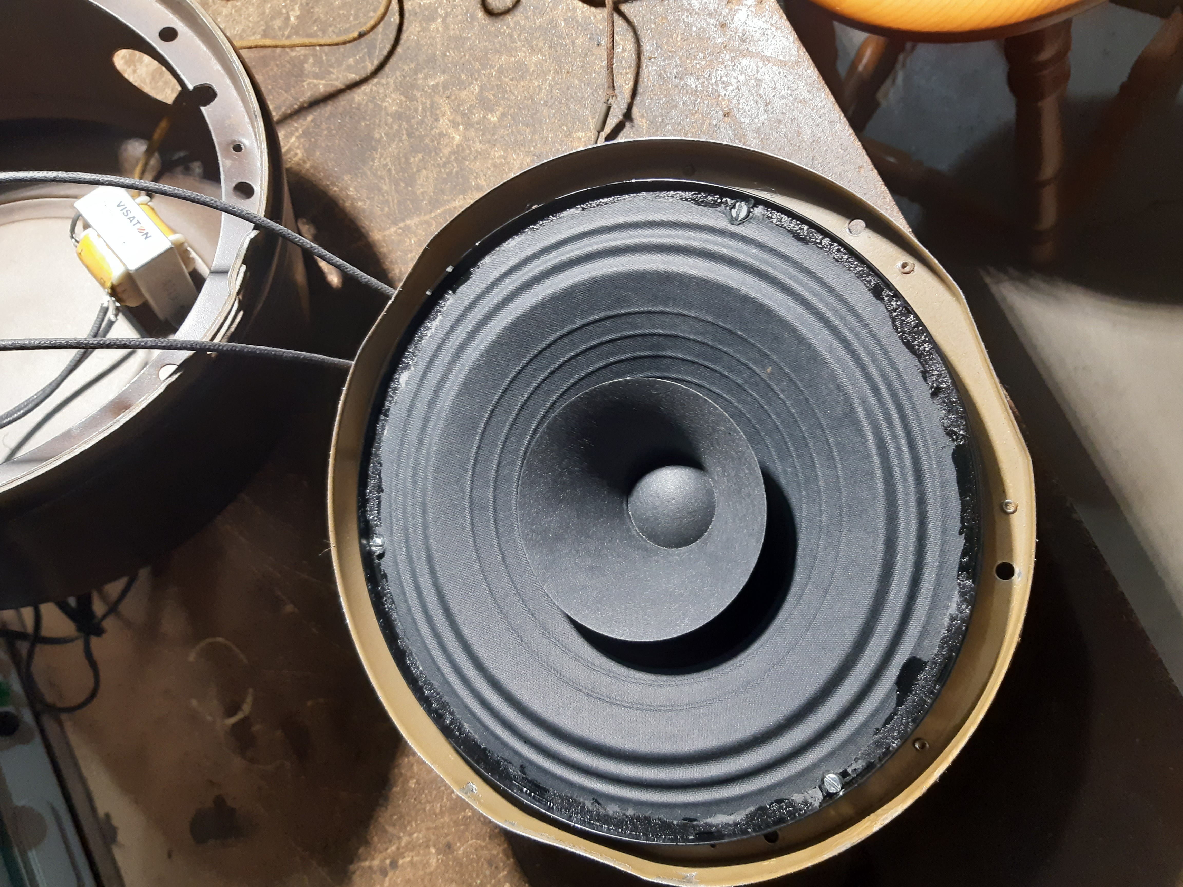

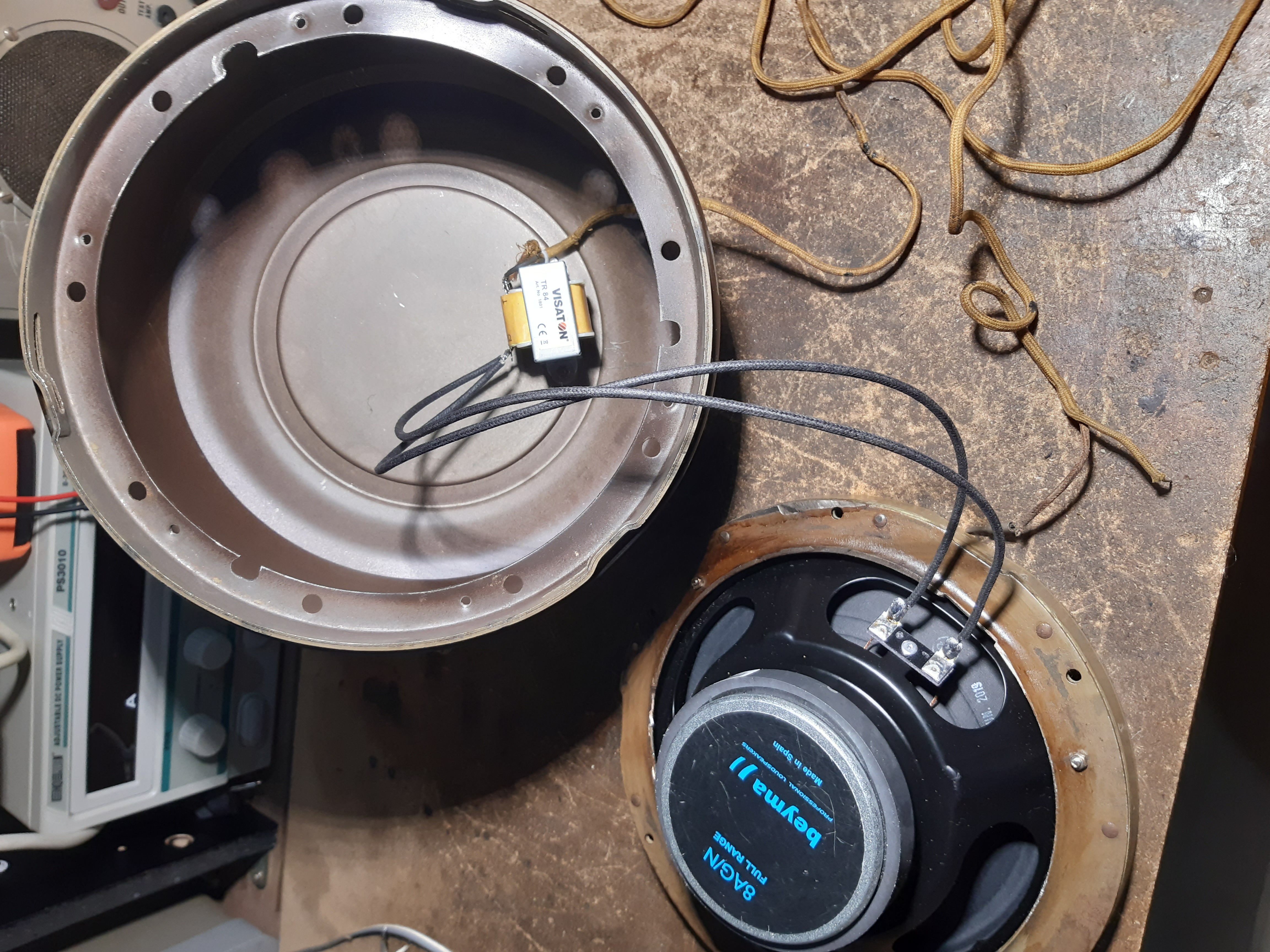

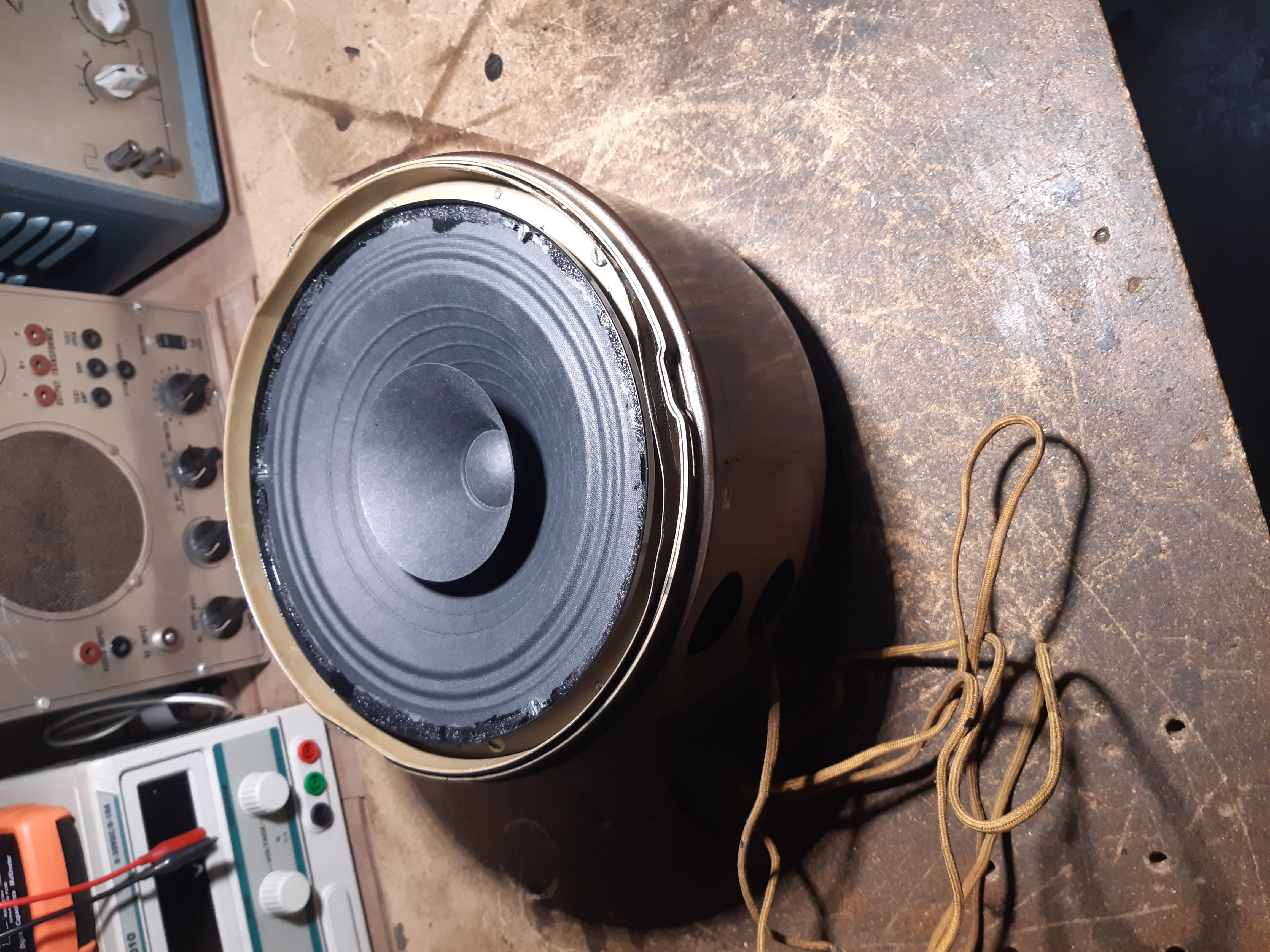

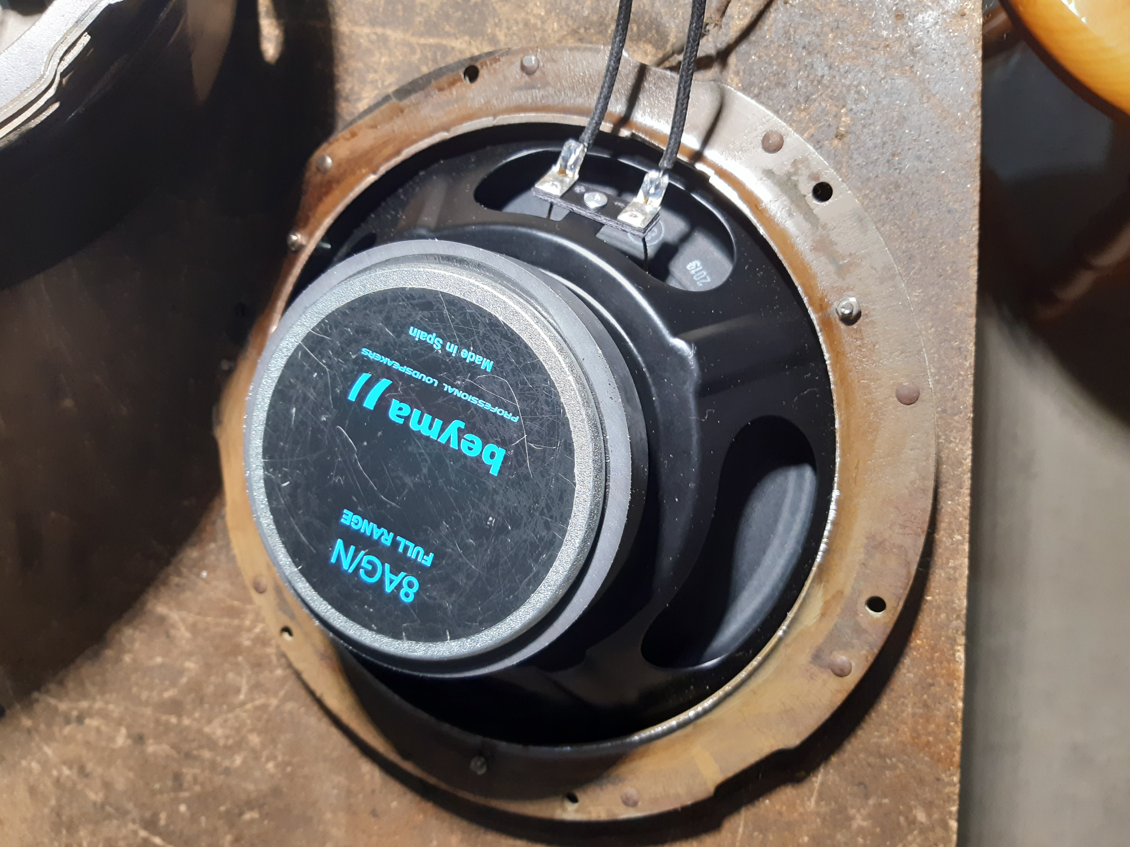

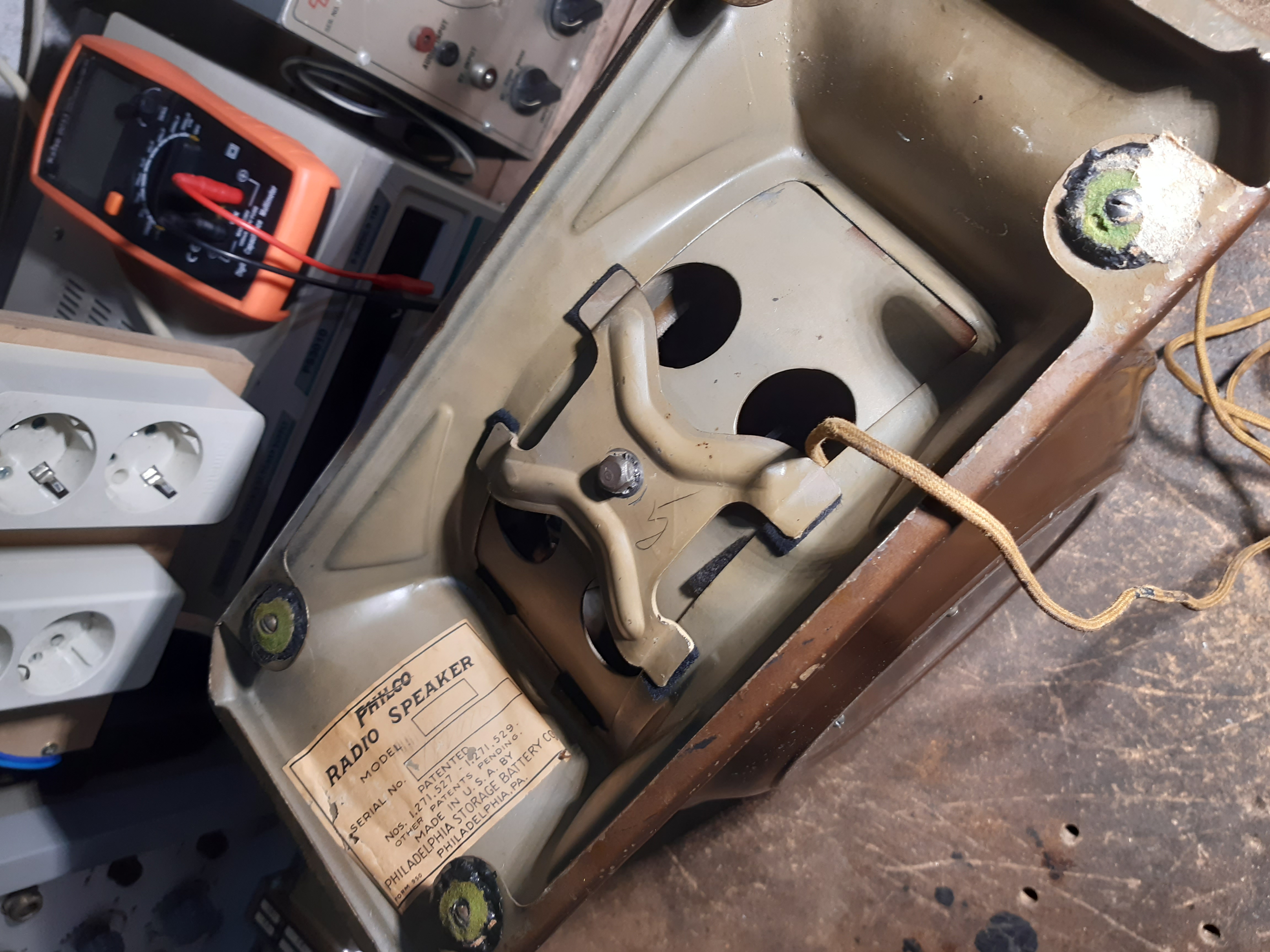

I have recently purchased a 211 speaker. As always, the speaker does not work. These speakers were very bad. I have replaced it with a low impedance 8 ohm one. With the corresponding transformer.
I took advantage of the ring that held the old speaker.
Attached photos. I have also taken advantage of the old cable.

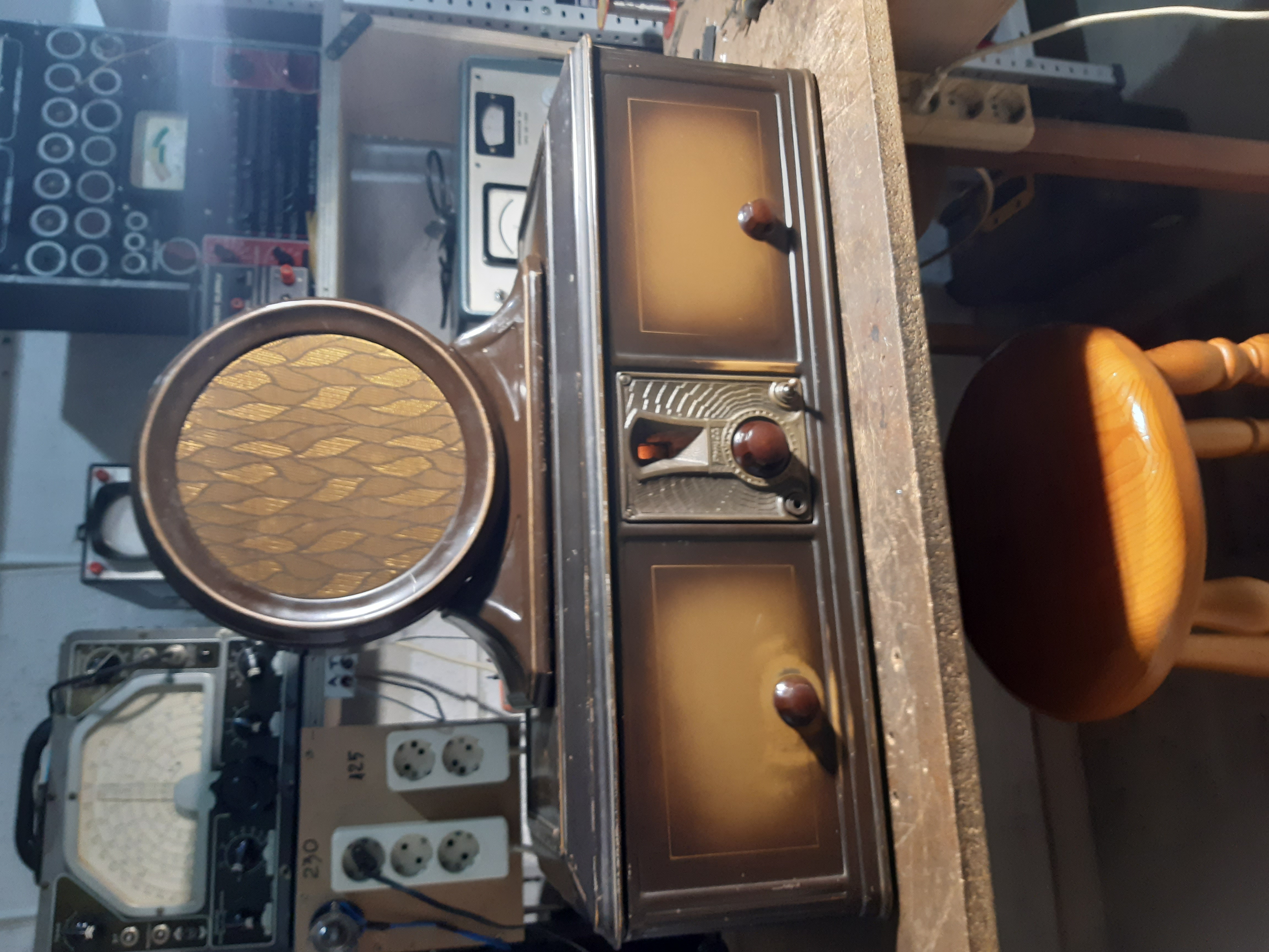

The 511 radio works great.
