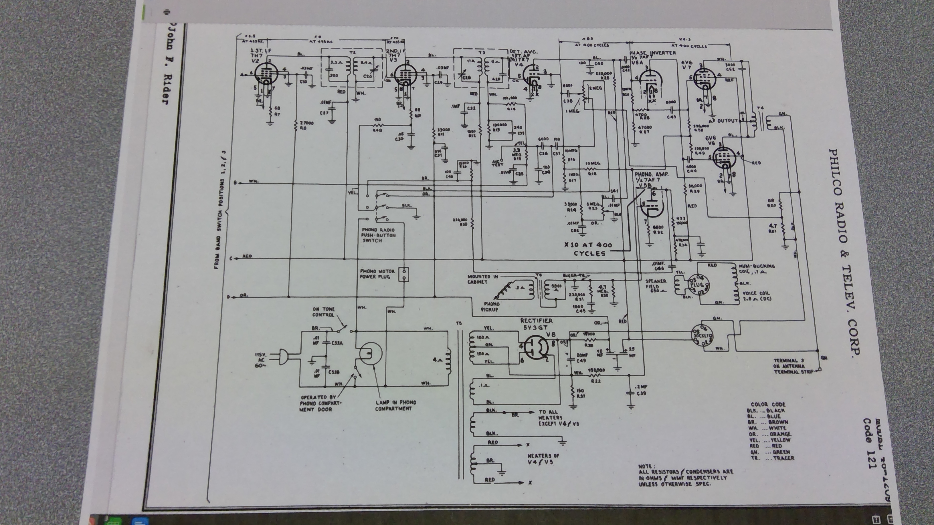

What is the recommended connection when replacing a non polarized line cord with a polarized line cord on a 46-1209 chassis? I have the hot side connected to the bakelite terminal where the brown wire to the on tone control is connected. What difference does it make?
If there is a contact that potentially goes too GND/Chassis, I connect it to the wide one (Neutral).
But it is not really important.
When I run into this situation, I usually connect the hot side to the switch and rewire the cap block to the other side of the switch. This way, the safety caps don't get power till the switch is on and the transformer primary won't be hot when the switch is off.
Rod
I've seen AA5 units whose switch is in line with the chassis.
Yes, I have one on my bench right now. If at all possible, I'll add a polarized plug and move it to the hot side. Some are easy, others more challenging.
Most if not all Philco AA5 sets were made with the switch in the neutral (B-) side of the line.
When I work on these, I also move the switch to the hot side of the line, and use a polarized plug as well.
I wonder what the thinking was behind it.
I like the idea of moving the cap block to the other side of the switch so that the power is not on the transformer until the switch is made. That, and I have wired the hot side of the polarized plug to the switch. Thank you, gentlemen, for your comments and advice.
