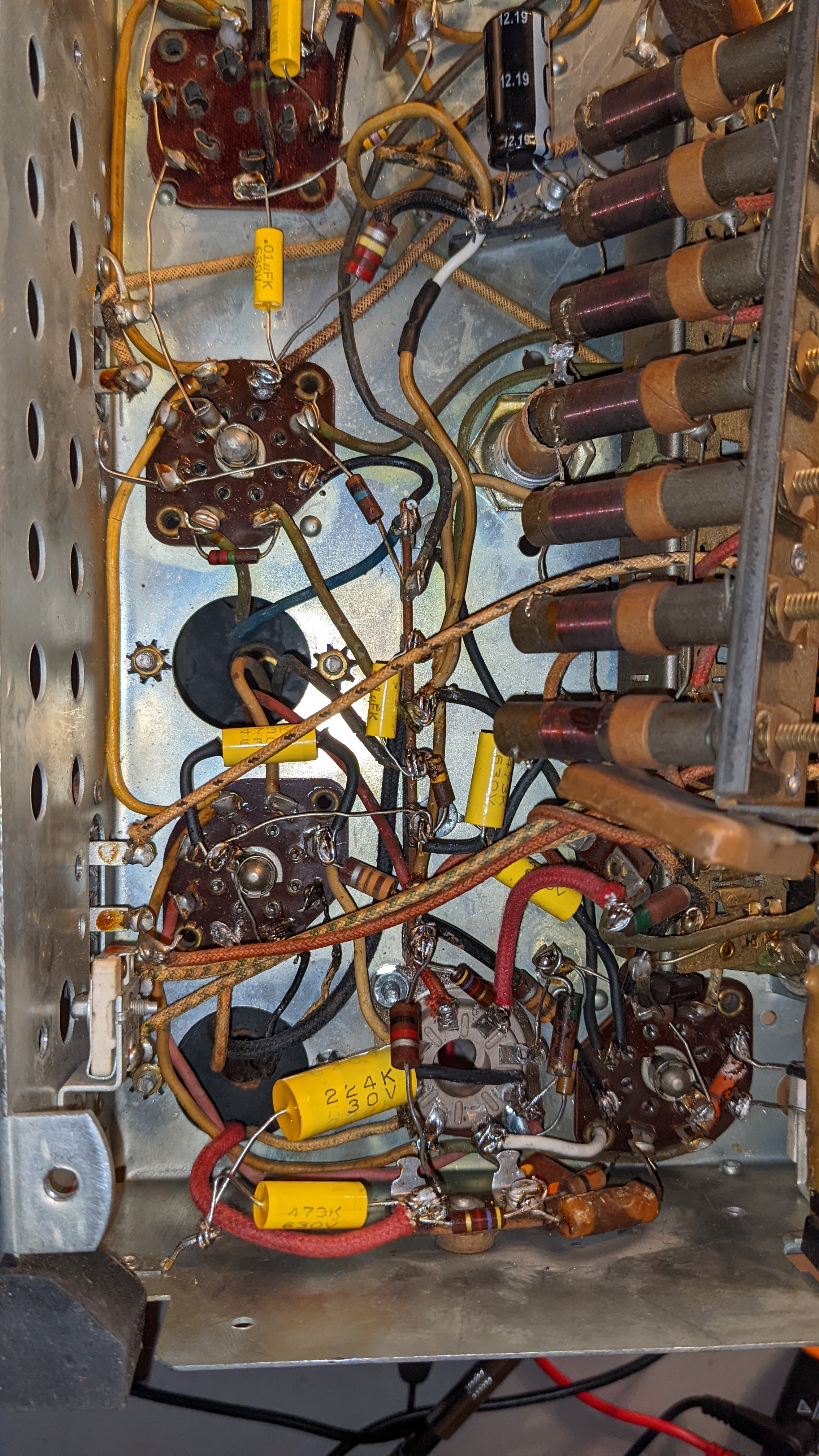

I had to replace the 6J8 tube socket as you may be able to see in the picture.
I also happen to have four other 40-180 radio chassis, of which, 2 are complete and work fine, and the other two are in line for renovation. So, I have quadruple checked the 6J8 wiring and cannot see a problem. I did find that I miswired cap 10 to the 1235, but after correcting this, and firing up the unit, resistor 29 still smoked.

Looking at your photo of the 6J8 socket. I see pin 6 connected to the 4.7K resistor and a red wire. What does the red wire connect to?  It should only connect to the 250 pf cap, nothing else.
Its hard to tell from the photo but it looks like the red wire connects to a terminal with more than one connection (brown wire?). The red wire should only connect to the 250 pf cap.
As John said, disconnect anything associated with the 4.7K which gets hot. Start with the red wire connected to pin6 of the 6J8 and follow it to the terminals it connects to.

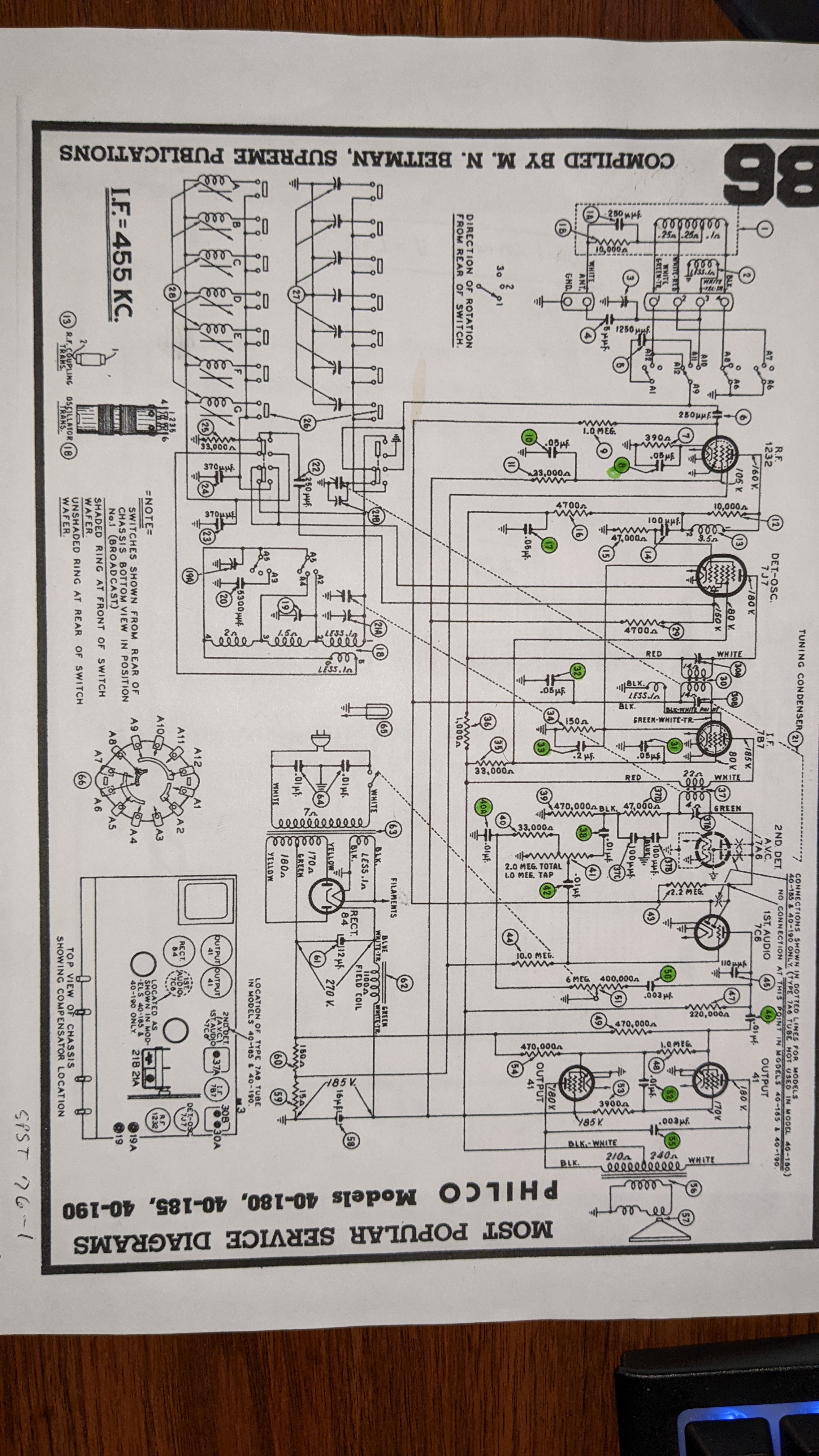

So, I've been following along and it's nice that the problem is resolved but I don't see any 150 ohm resistor in the schematic where he describes it. The only 150 ohm resistor near by is the cathode bias resistor. What's happening?
Seems that a 150 ohm resistor was added in series with the 250 pF cap connected to pin 6 of the 6J8. Appears to be an undocumented production change as it does not appear on the schematic.
Rob - you are correct. There are no other 150 ohm resistors in the schematic besides the cathode bias resistor. I currently have 6 of these radios and they all have this 'extra' 150 ohm resistor where I indicated! I can only speculate that it was a mid-stream manufacturing change that did not get into the schematic, or, the schematic I have is an earlier (or later) version then what my radios have.
Someone smarter than me will have to deduce why this design was implemented.
According to the Philco service data the resistor appears as a production change in run 3, but it never made it to the parts list or schematic.
