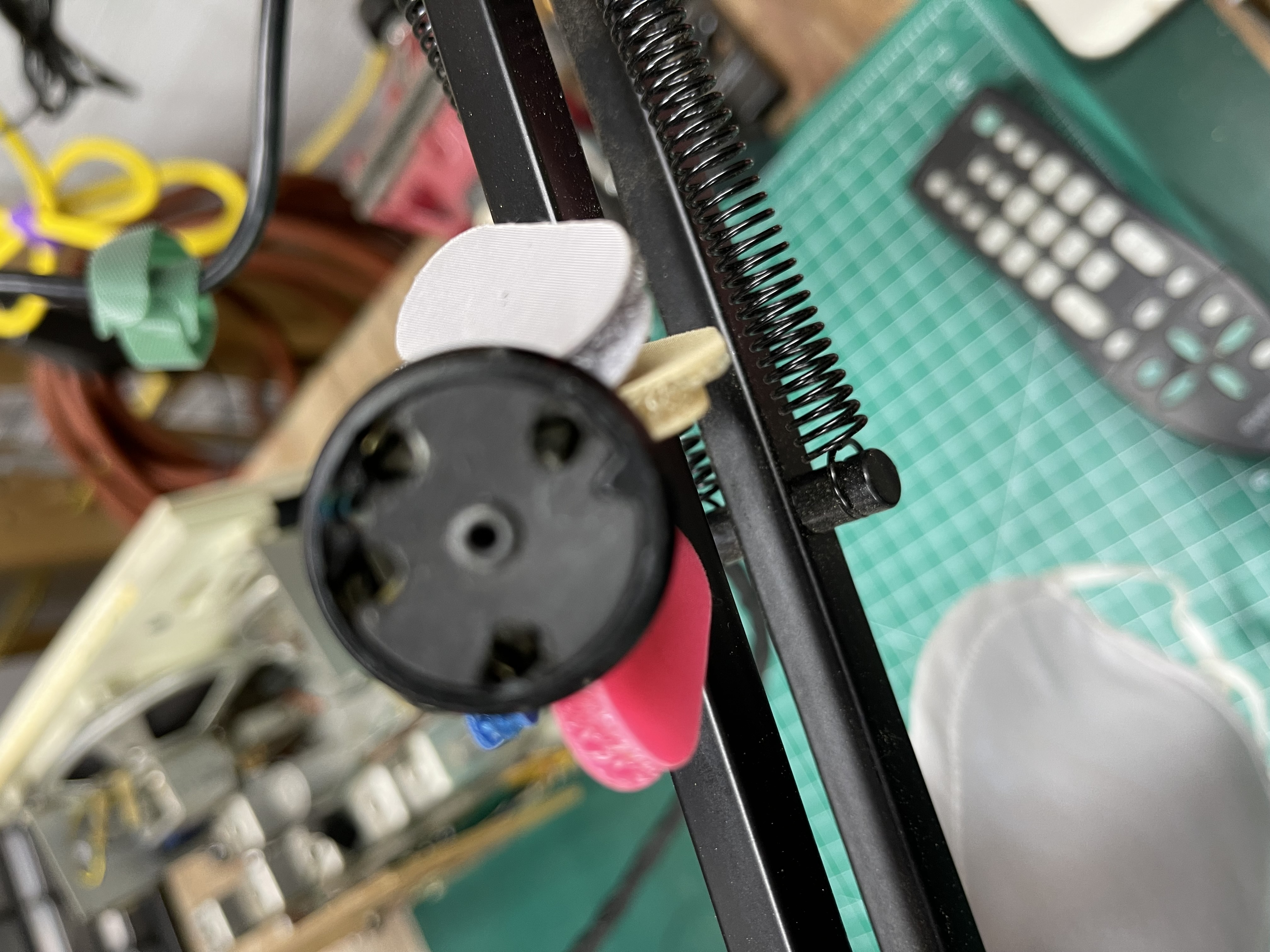

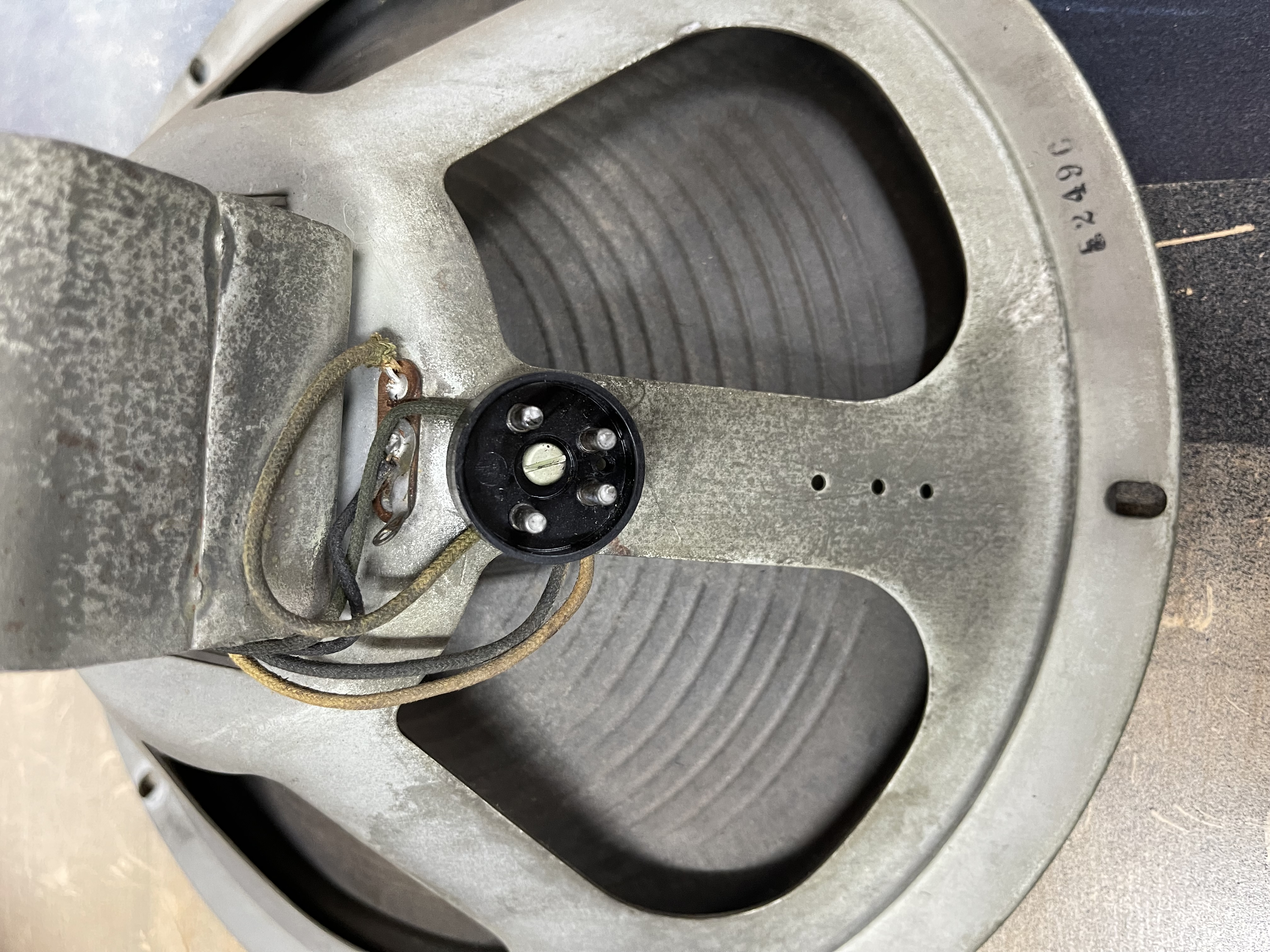

The speaker wire and connector contains 4 wires and was in bad shape with wires that had separated from the chassis itself. Looking at some online pictures, I think I have them in the right positions but wanted to know if anyone had detailed information to confirm. The schematic is not exactly easy to understand for a novice.

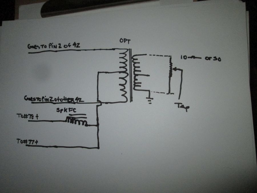

89 doesn't exist he's referring to #85 it's the bakelite block that the line cord is soldered to. Perhaps this pictorial will help you sort the spkr wiring. If the opt is bad it's pretty hard to find one that has a tapped 2ndry and work properly. So using a pot across the winding, adjust for best sound and replace with two fixed resistors.
OOps, Sorry about that guys, was rushing out to the barber and didn't proofread. Thx Terry for picking up the mistake and replacing about 100 words with a pic worth 1000!!
And a great idea for that trick tapped secondary.

Terry did nice job showing a drawing!

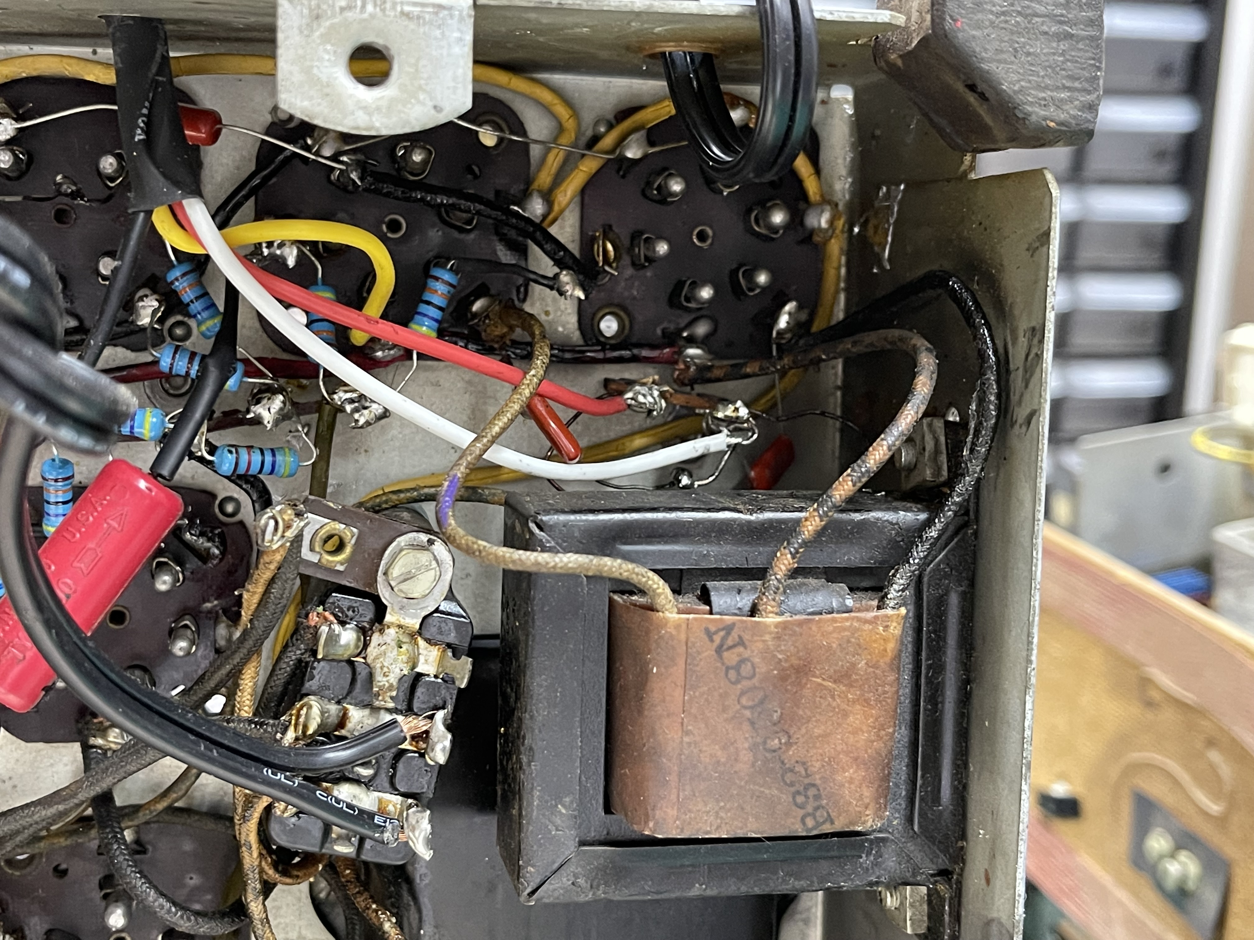

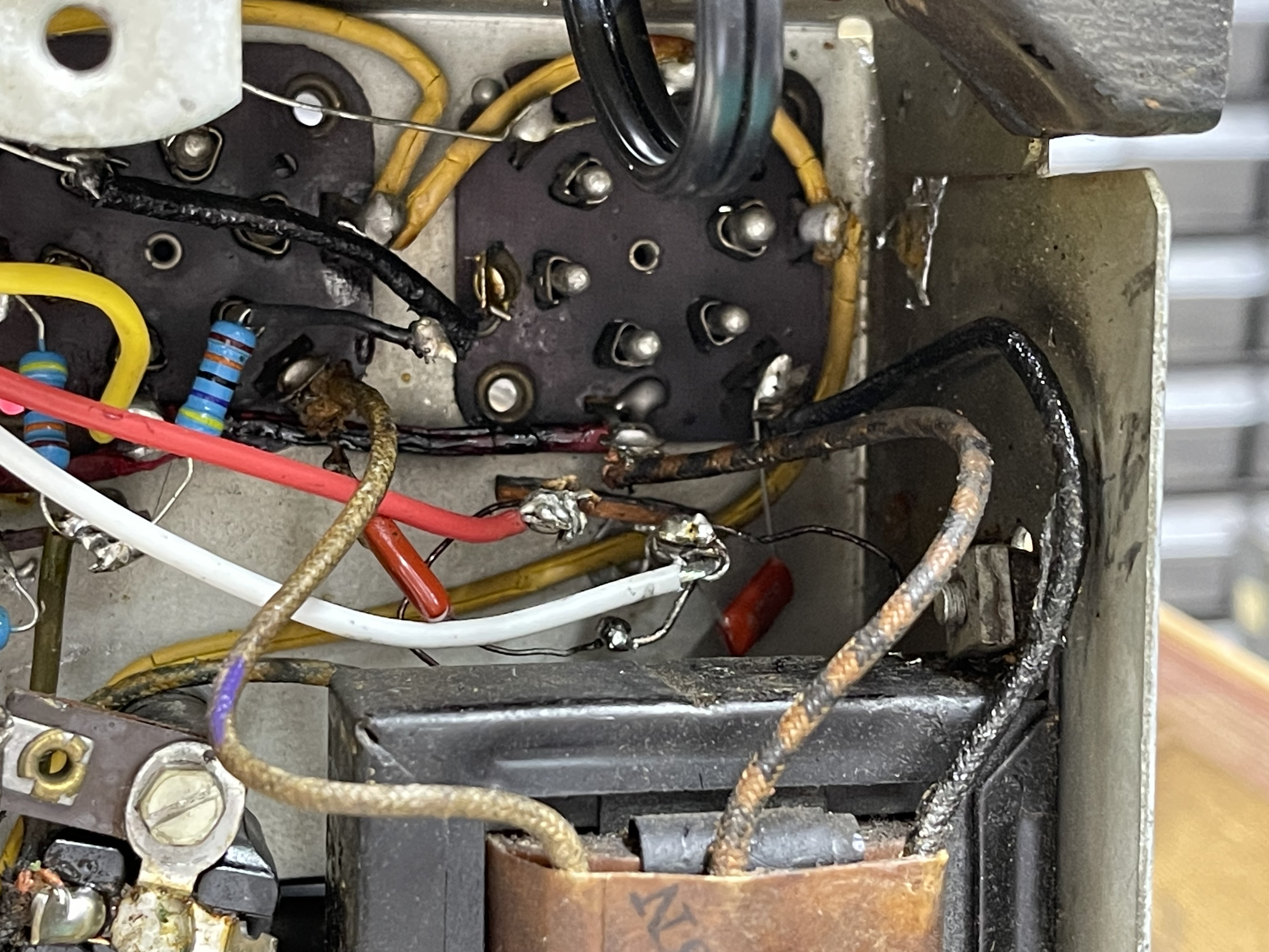

I traced from the OPT (black and white wires) to each Pin #2 x #42 tubes as expected. I am not sure what the #85 capacitor is based on the schematic so I am going to include some pictures that may help.
This is a time when I wished I had a clear picture of before I replaced parts and after! Lesson learned.
The speaker has a connection as you can see and since they were frayed and cracked, I ran new ones up through the chassis and made connectors on the other side so it would be 'safe'. The yellow, red, black and white wires that are in the shrink wrap are the ones I brought in.
You can see the 2 orange drop capacitors that I used to replace the paper ones. I do have some X2 capacitors I could use if those are the ones that could fail and make the chassis hot.
Ok so ypu set is a little different then I thought. Your spkr only has the voice coil and field coil connections. It's just like the 41-300. Most of the older sets have the output transformer mounted to the spkr frame and are wired as I described.
You've got 2 hv wires that go to the fc and two wire that go to the vc. Pretty easy. Next step is to use your ohmmeter and measure the resistance from the wire with tracer on the opt (goes to pin 3 on the 42) to pin 2 of each 42. Should see a low resistance like several hundred ohms. If much high the opt is bad.
85 on the schematic is near the ac plug and the off/on switch and the big black thing last pic in the center is it!. If you flip it over and it has a black tar bottom then it hasn't been serviced. Should replace caps and x2 are a good choice.
