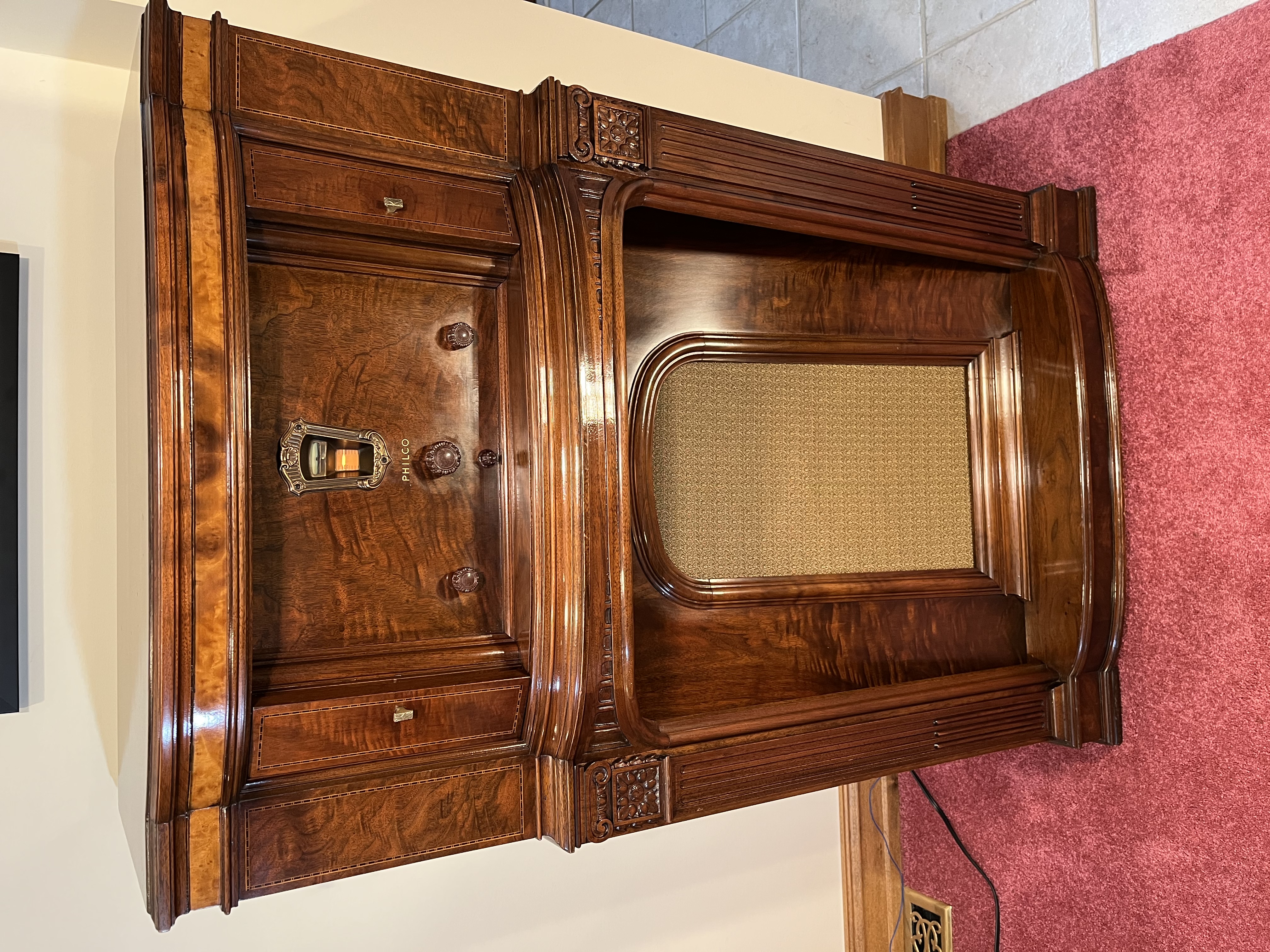

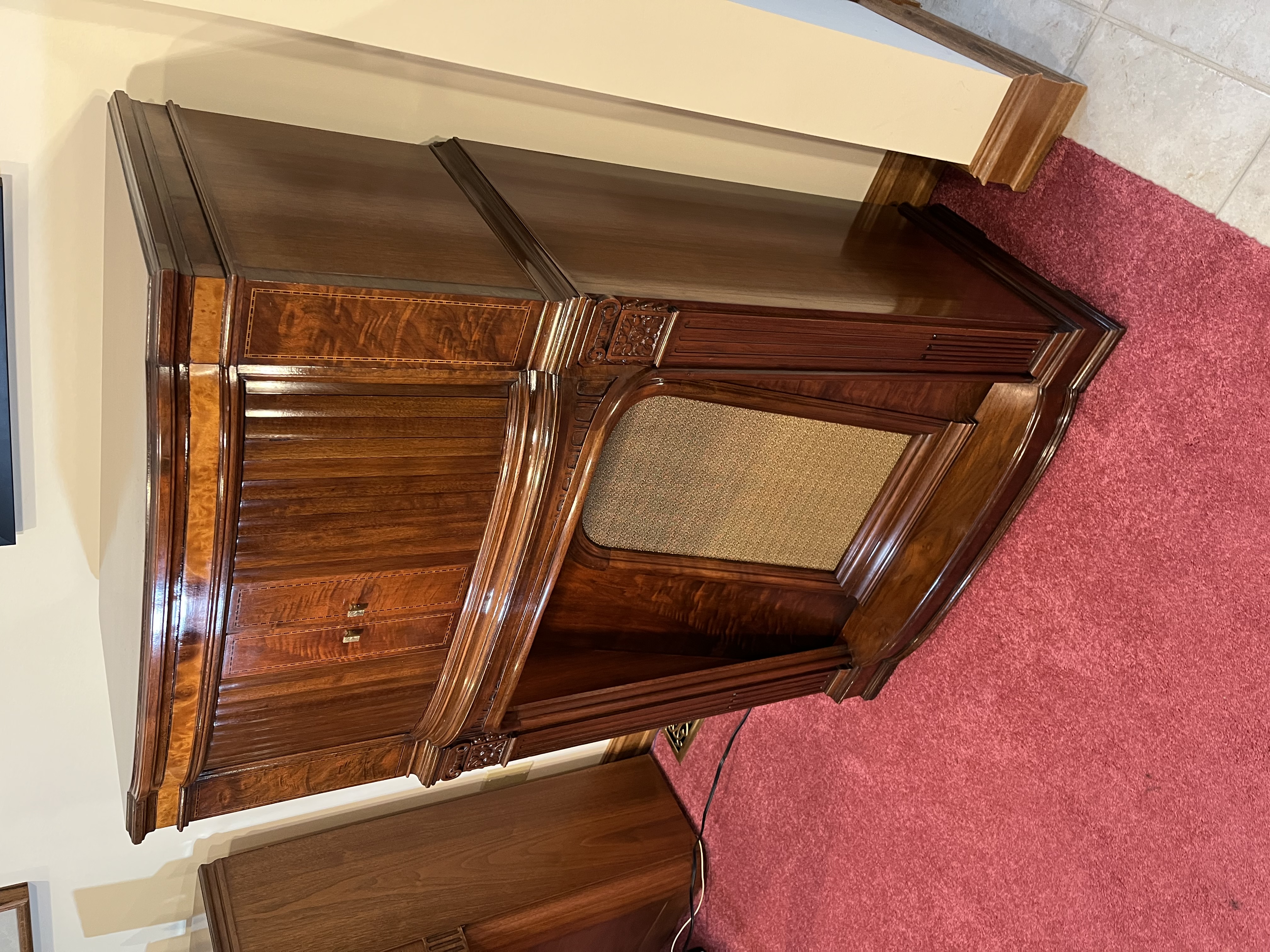

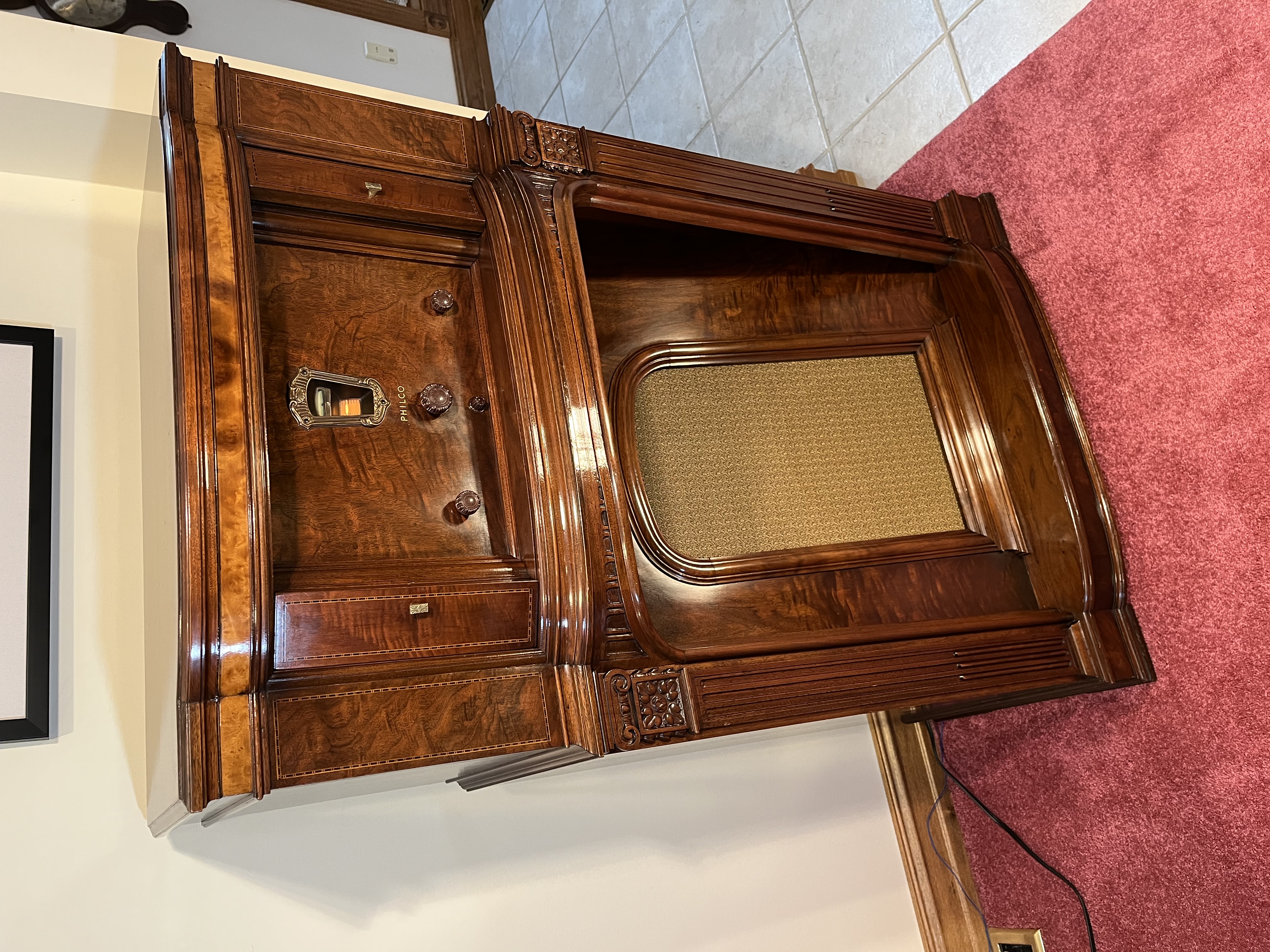

As the replacement bulb in my unit is a 40 watt bulb I intend to replace it with a C8 40 watt or an led with the same lumen.
My radio was a lucky find as it appears to have the original finish and I believe never saw a basement. I replaced the grill cloth as the one installed was clearly cloth from the seventies. Unfortunately, I could not find a reproduction which matches the original.

Yowzah! That is in amazing condition! Top of the line from 1932. Thank you for the excellent photos.
I was able to get my replica grille cloth shortly before the supply ran out. New patterns have slowly become available again do there is hope.
