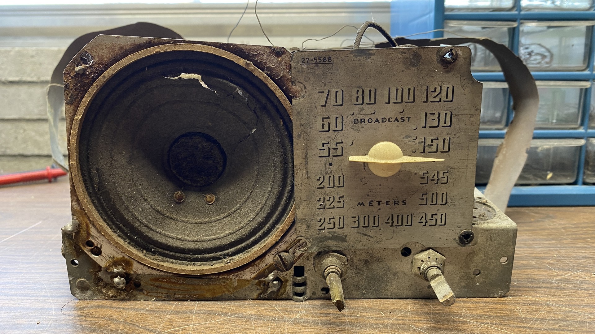

This year I picked the chassis of a Philco 41-KR, which uses the same chassis as those tiny five tube Transitone/Philco Transitone models.
Before picture:

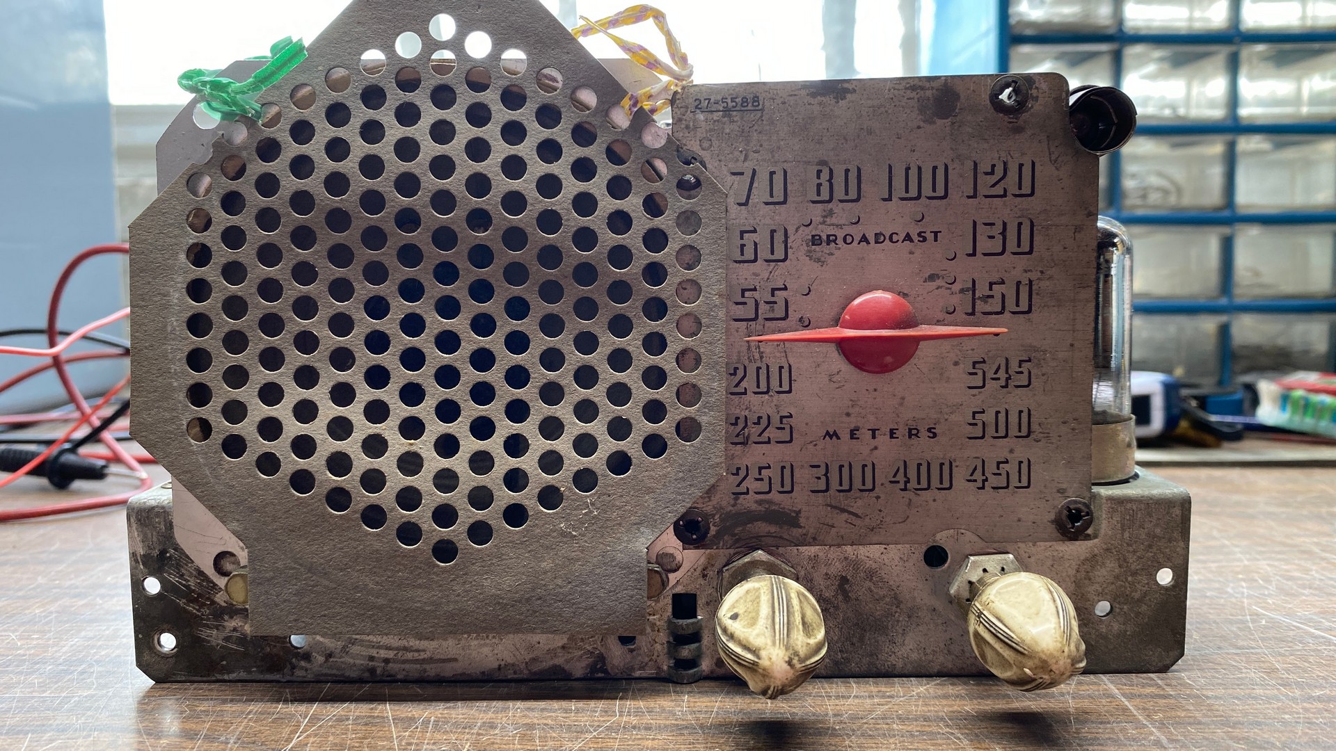

After picture:

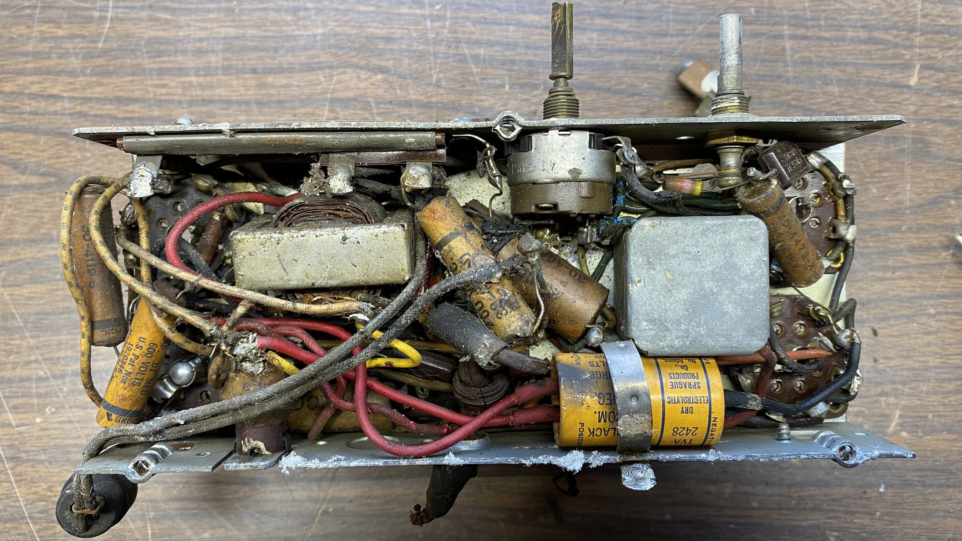

Before picture, underneath:

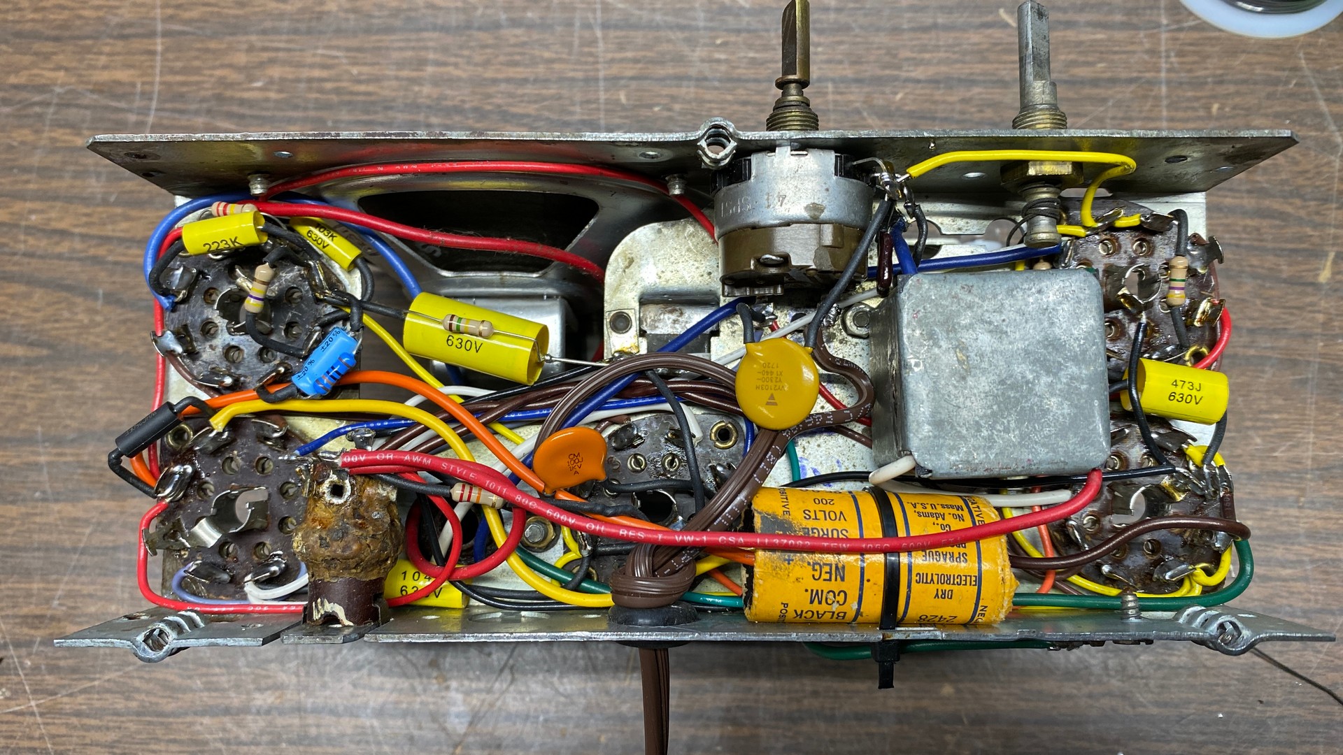

After picture, underneath:

The "after underneath" picture certainly is brighter

The 35Y4 uses pin 4 as a heater tap for the dial lamp; otherwise it, too, is a pin-for-pin replacement of the 35Z3. Philco originally used pin 4 on the 35Z3 socket as a tie point for other things, and that tie point must be removed. However, as my repair technique for these little Transitones involves stripping the chassis bare, removing all wiring and components and rewiring it from scratch, this is no issue.
Completely removing all rubber-covered wires and rewiring the radio is the only way to ensure the radio will be more or less "safe" now and in the future. Of course, no series string filament AC/DC radio is completely "safe," but they may be safely operated as long as common sense prevails.

These Transitones are so cramped under the chassis, plus being filled with crumbling rubber-covered wires, I have found that completely stripping and rewiring is the only way I can service them to my liking. Others may disagree. But I feel comfortable with my technique as it totally eliminates old rubber insulated wires and replaces them all with new wires.
And, really, it isn't that difficult to do, especially after you've done a few this way.
I don't feel badly about not restuffing paper capacitors in these sets. As you can see from the photos, the capacitors can use all the space they can get. The yellow film caps are great space savers in these radios.

Wow Ron, I’m going cross eyed looking at that cramped chassis! My neighbor found one of those tiny Philco Transitone radios in his attic, he said it was his grandfather’s and wanted to know if I would repair it for him. After looking at it I passed. Missing antenna, destroyed speaker and a crushed IF can  , no idea how that happens. Plus gobs of crumbling wire, I told him it was time to let it be. I noticed in your ‘after’ under chassis shot that the audio output transformer is missing. Good luck on your project, I know you will do your magic on it!

The audio transformer isn't missing - it is mounted on the speaker. It's smaller than the original audio output transformer, so I could place it above the chassis and the chassis will still fit inside the cabinet.
The speaker I used is a PM speaker taken from a 1955 Philco C579. The grille you see over the speaker was part of the speaker's original installation in the C579. It is on there temporarily until I can get the cabinet stripped, fixed, and repainted.
