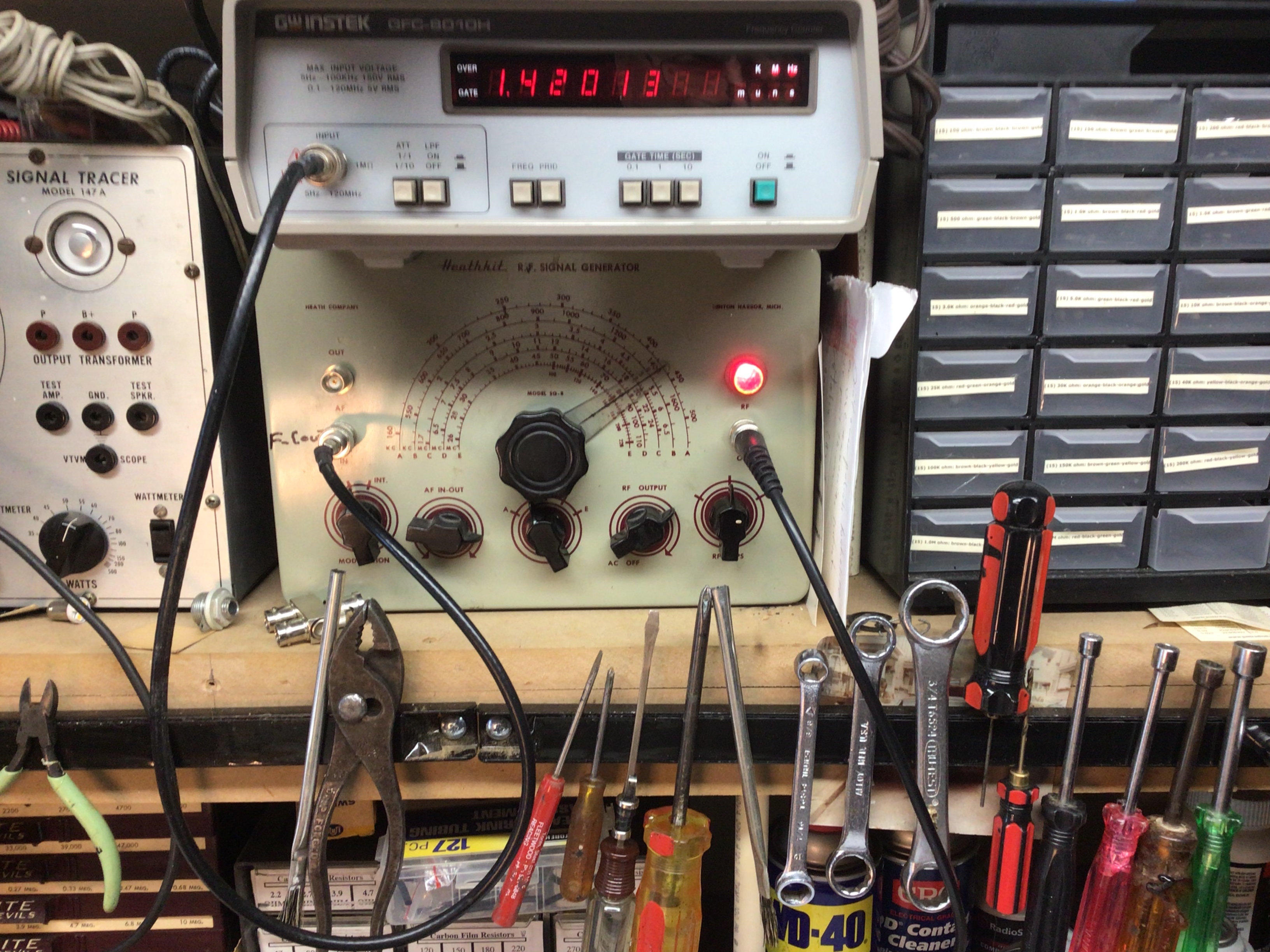

What I have done with my Heathkit SG-8 which was my dad’s, is I replaced all the old output jacks with BNCs which makes it more compatible with modern cables and my frequency counter. Since I’ve never need to modulate with an external source, Ive repurposed the audio input connector and rewired it to before the RF attenuator, that way I can connect my frequency counter and have a strong input to it regardless of my output settings that I use for alignment. Works great and gets the job done!
