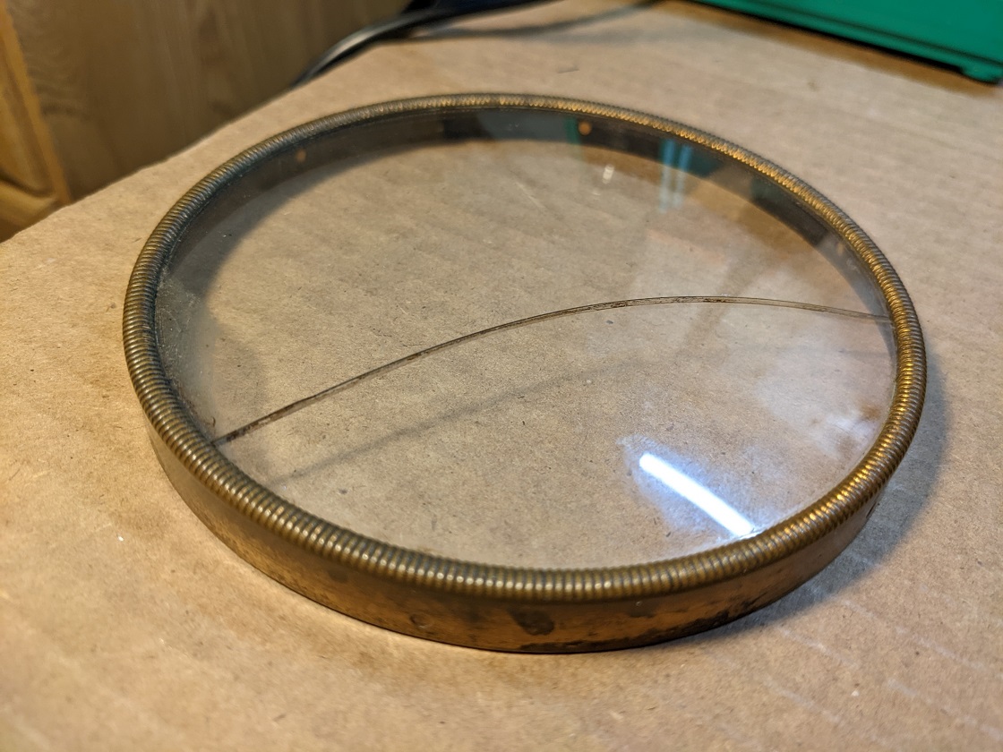

The glass is cracked on the Concentric Tuning Dial of my Philco 38-7CS chassis.  The easy part was removing but I am not smart enough to figure out how to remove the glass from the bezel.  The part's list shows as one part number so does that mean the glass cannot be changed?

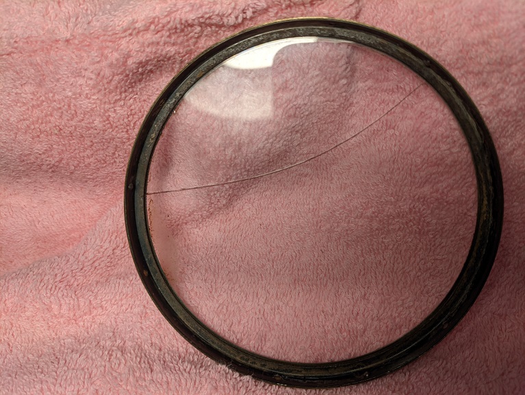

There is a 'ring' around the inside holding the glass but not a c-clip ring.  Not sure how the ring is held in place but it's not budging even after beating on the glass with rubber mallet.  I can't get anything between the glass and the ring.
Last resort will be to break the glass and see if the ring is removable.  I was hoping someone had changed the glass and could help.

I've scraped along the ring and the bezel but can't determine if one solid piece or if pressed to fit.  The brass part is one piece.

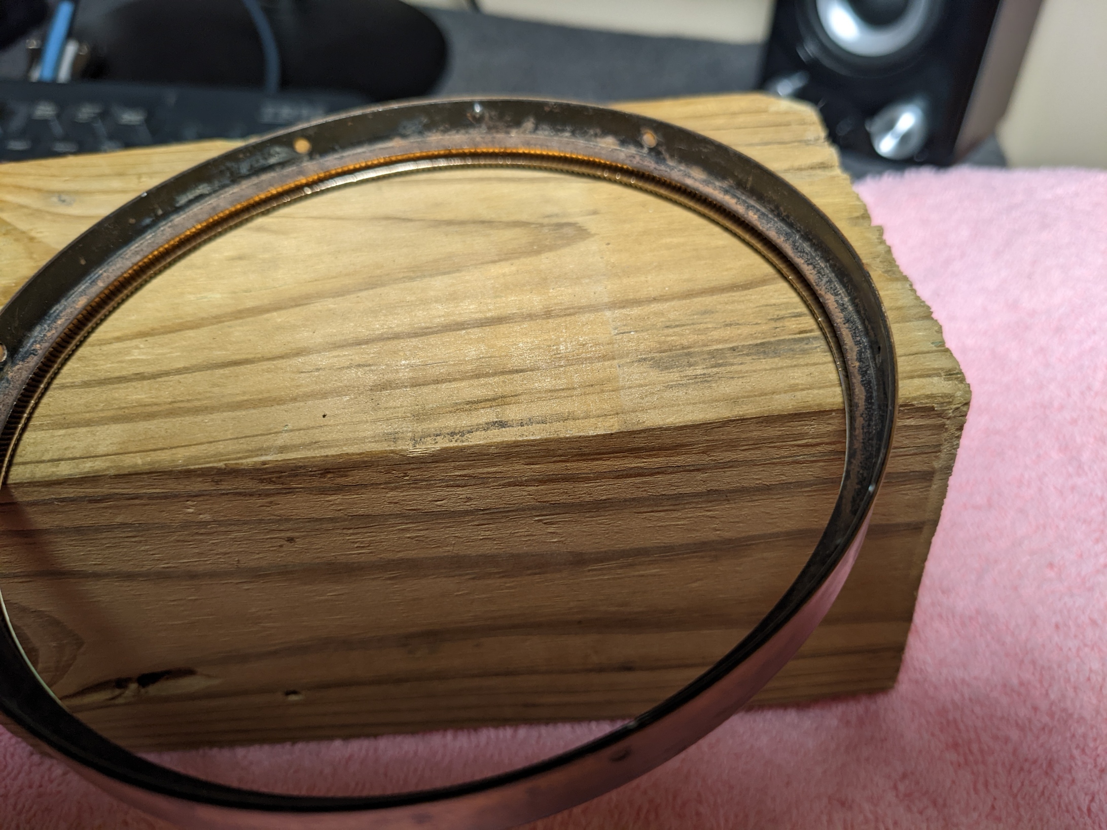

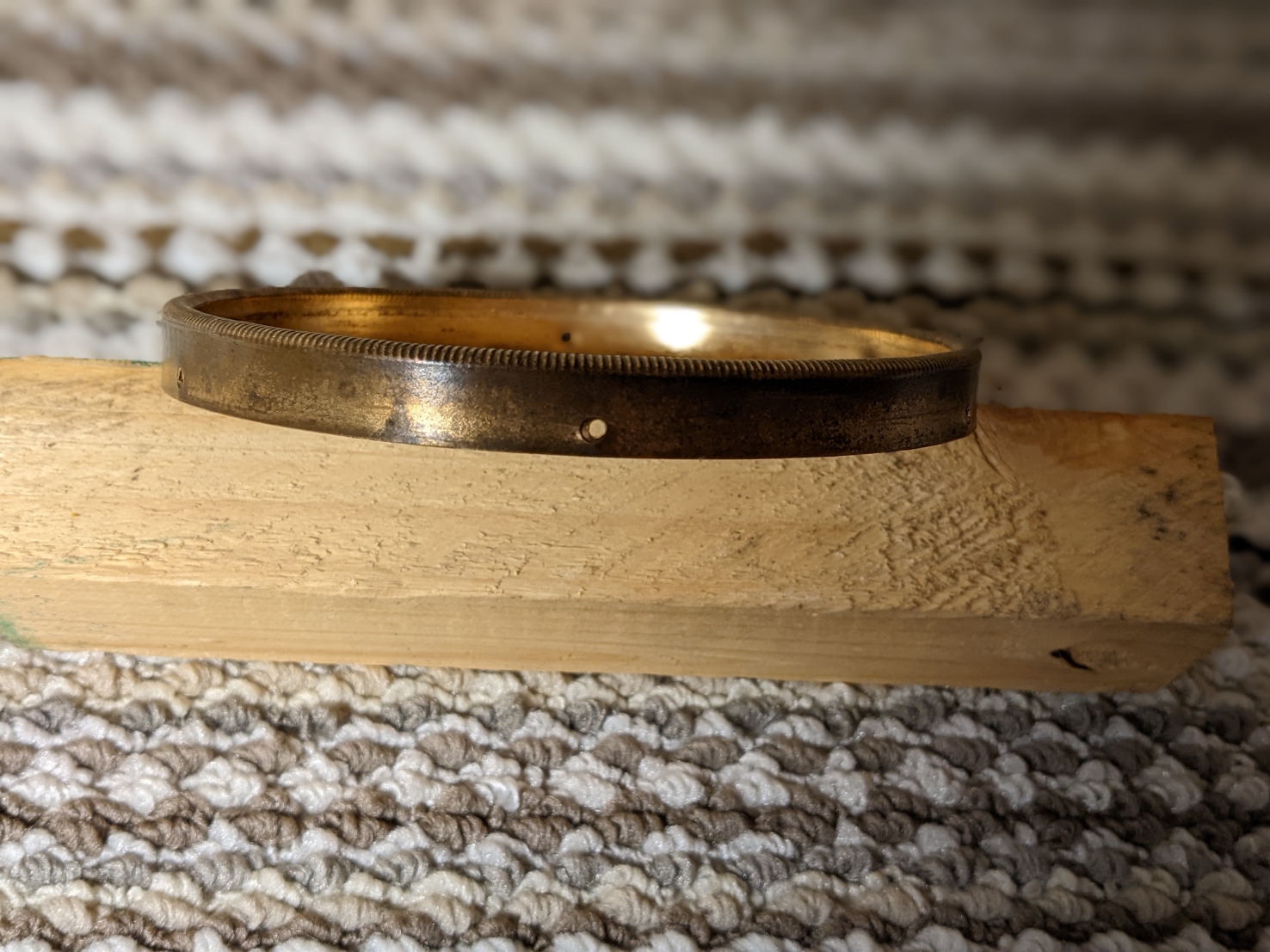

I decided to do the glass replacement myself.  I removed the old glass and found what looked like old black rubber and don't know if it was originally a 'gasket' or if it was some type of adhesive.  I soaked the adhesive with alcohol and removed what I could see.

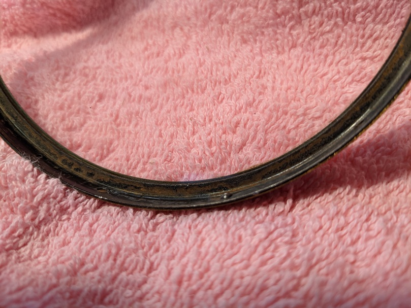

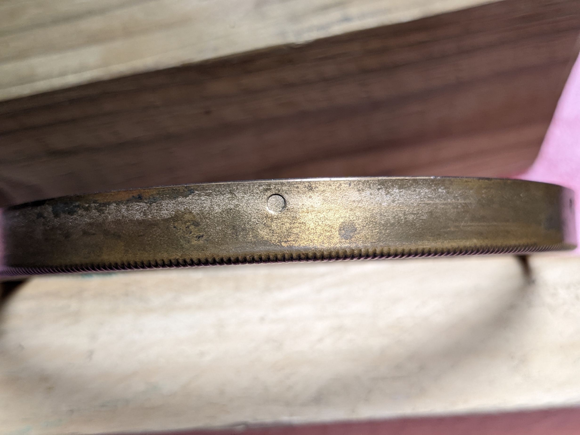

I noticed the friction ring was held in place by indentations from the brass piece.  See picture.  I used a 1/16in drill bit and drilled out the indentations, but the ring still wouldn't move.  The drilled holes will not show once assembled.
I then soaked the space between the ring and the outer brass cover with alcohol and finally sprayed it with penetrating oil (PB Blaster) every hour for a few hours and let it sit overnight.  Next morning the ring slid off with a little pressure.
I haven't decided what I'm going to use to replace the old rubber.  RTV or rubber cement.  The ring fits tight, just need something to keep the glass solid.
