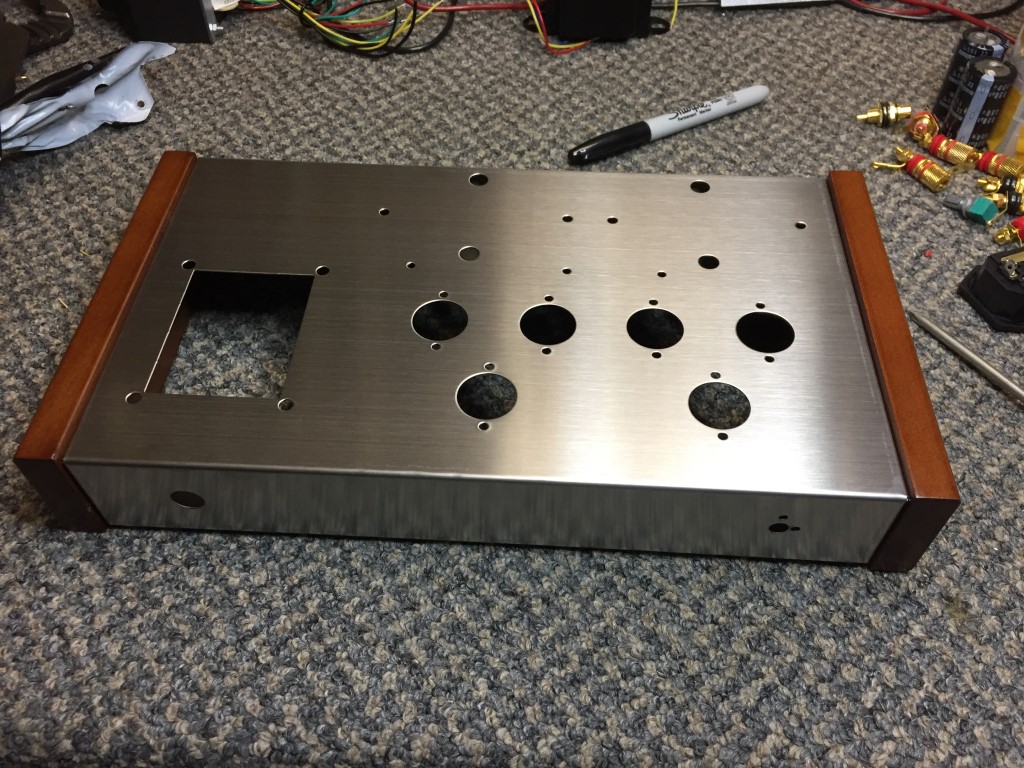

Break open the box

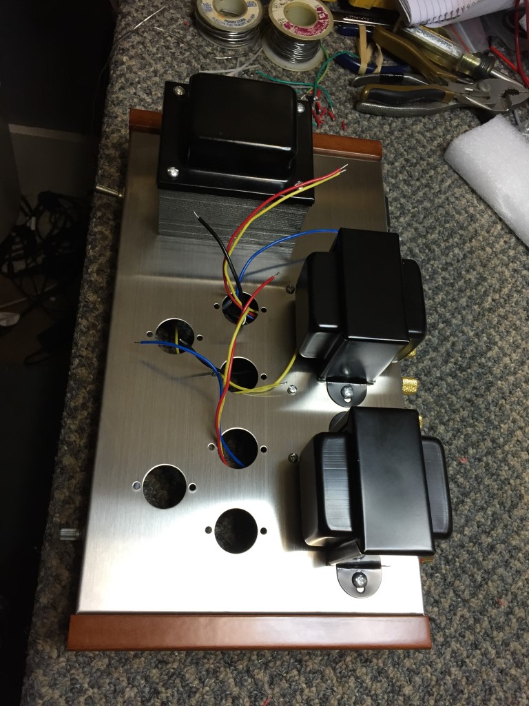

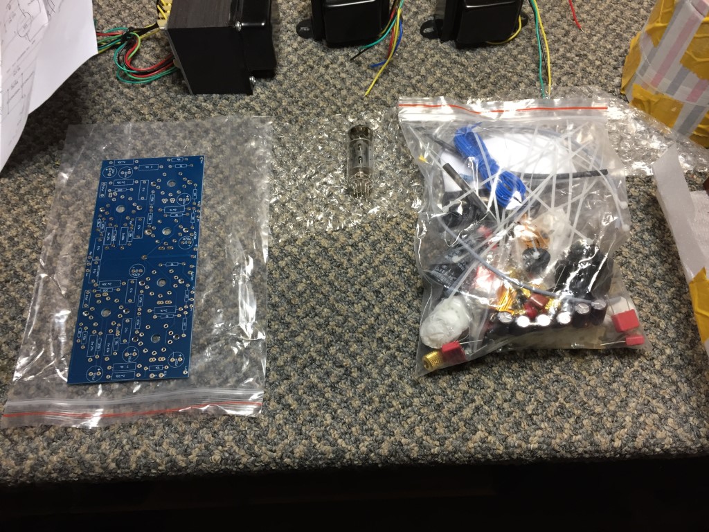

A pile of parts. Nice solid chassis!

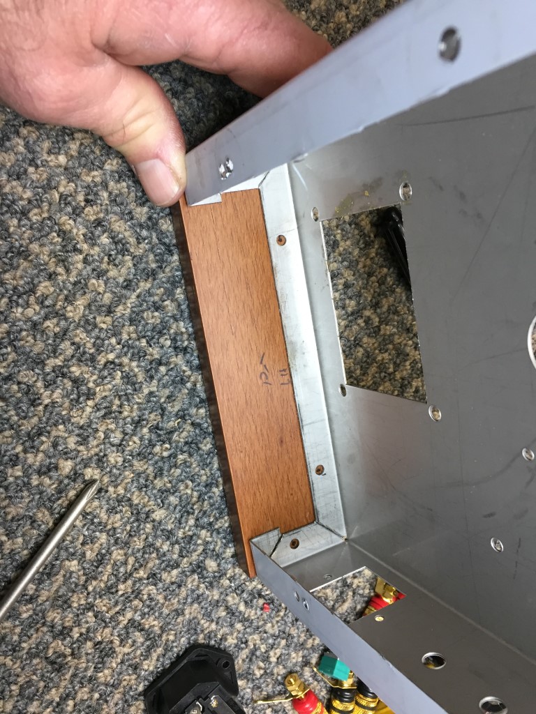

Putting on the end panels. These are actually solid wood and nicely finished. Mark these carefully and drill pilot holes. They fit real nice.

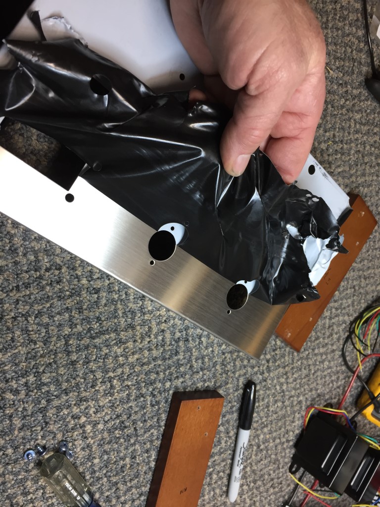

Peeling off the protective layer. Take care not to scratch the stainless chassis while assembling. Slow and easy takes you all the way here!

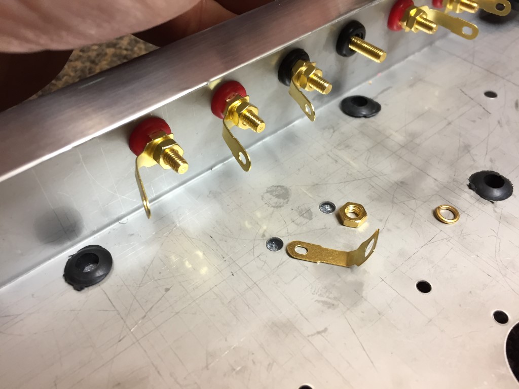

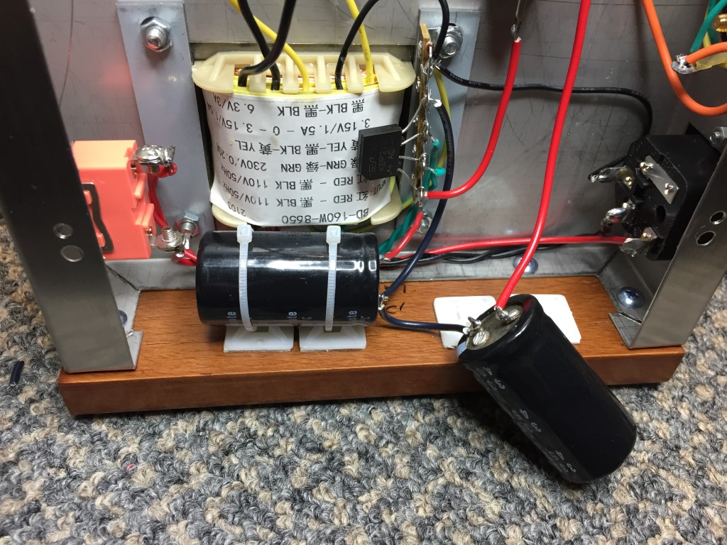

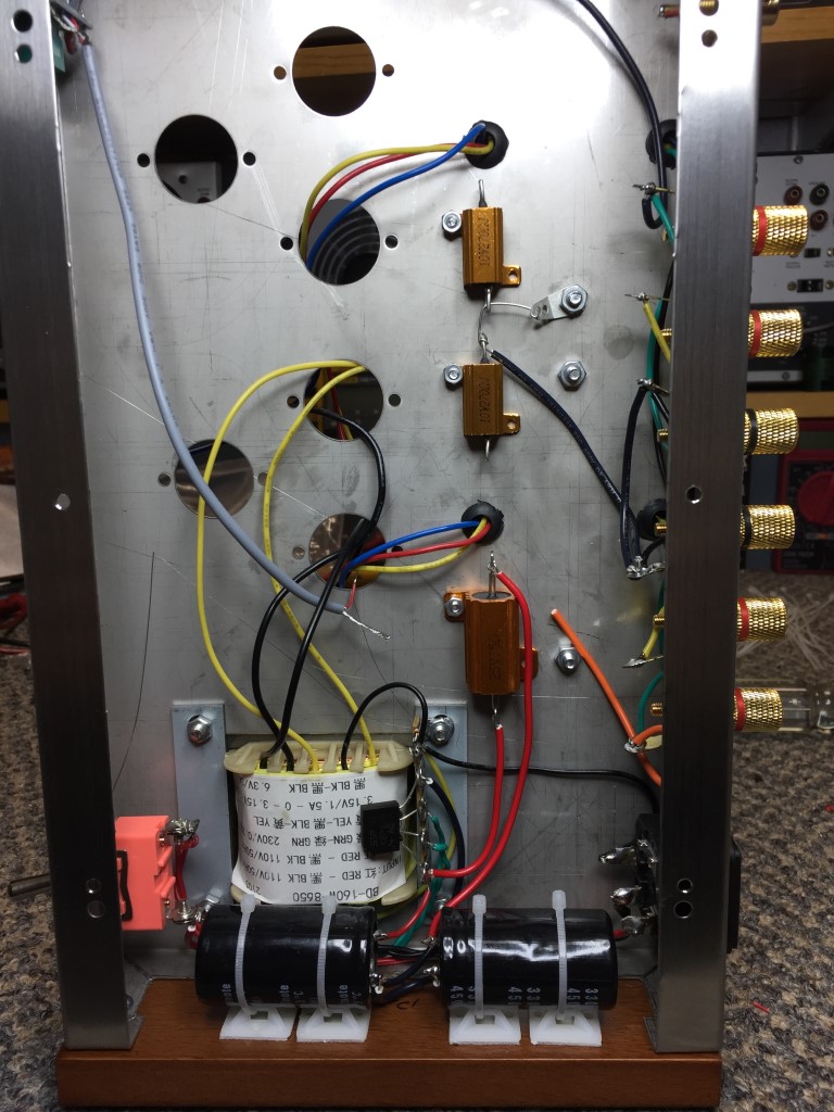

Working on the speaker connectors. Like before, had to glean a little off the insulators so it will fit tight. Oh, the best way to put on is a nut 1st, then the connector, lock washer then the 2nd nut. These aren't too bad quality, much better than what came with my 1st kit. I used a small screwdriver to lock while I tightened down.

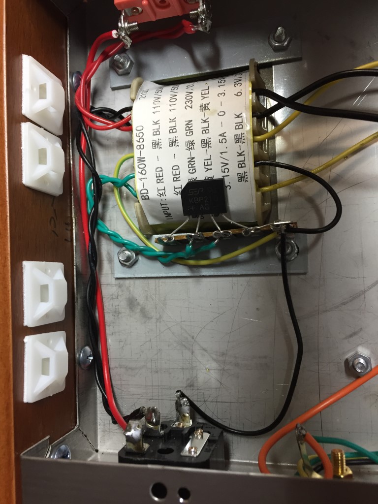

Putting the sticky pads on to mound the 2 big electrolytics and mounted the bridge. I found an old school terminal strip fit real nice. Also connected the primary of the transformer, power switch, ac plug and HV secondary winding. I also grounded the CT on the heater winding.
Putting the big electrolytics in place

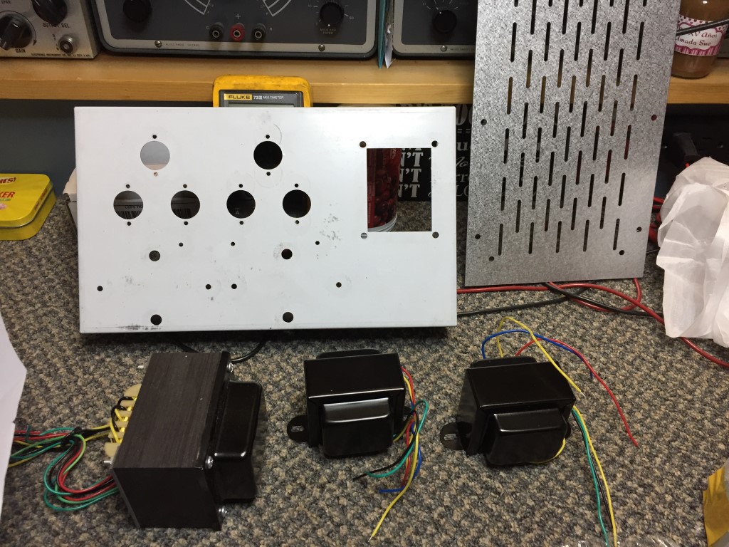

Ready for the PC board. Got all the power resistors and transformers mounted. Note: The 10w 250ohm resistors had to have the holes drilled out for it to allow the supplied screw to pass through.

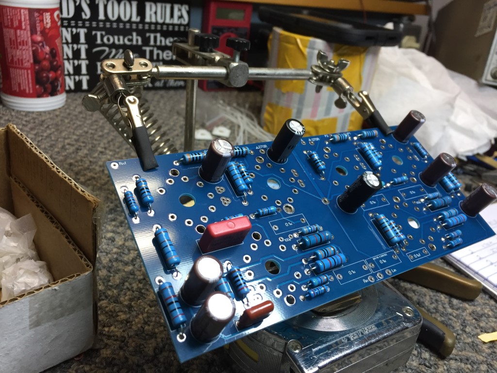

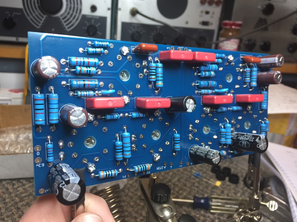

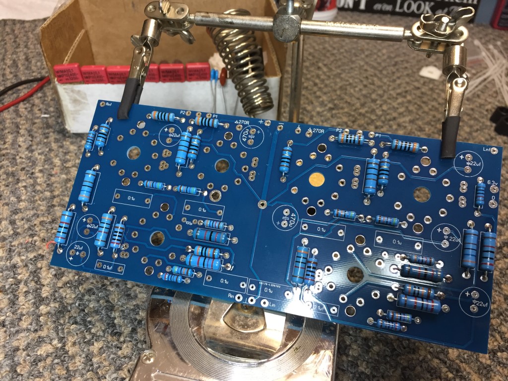

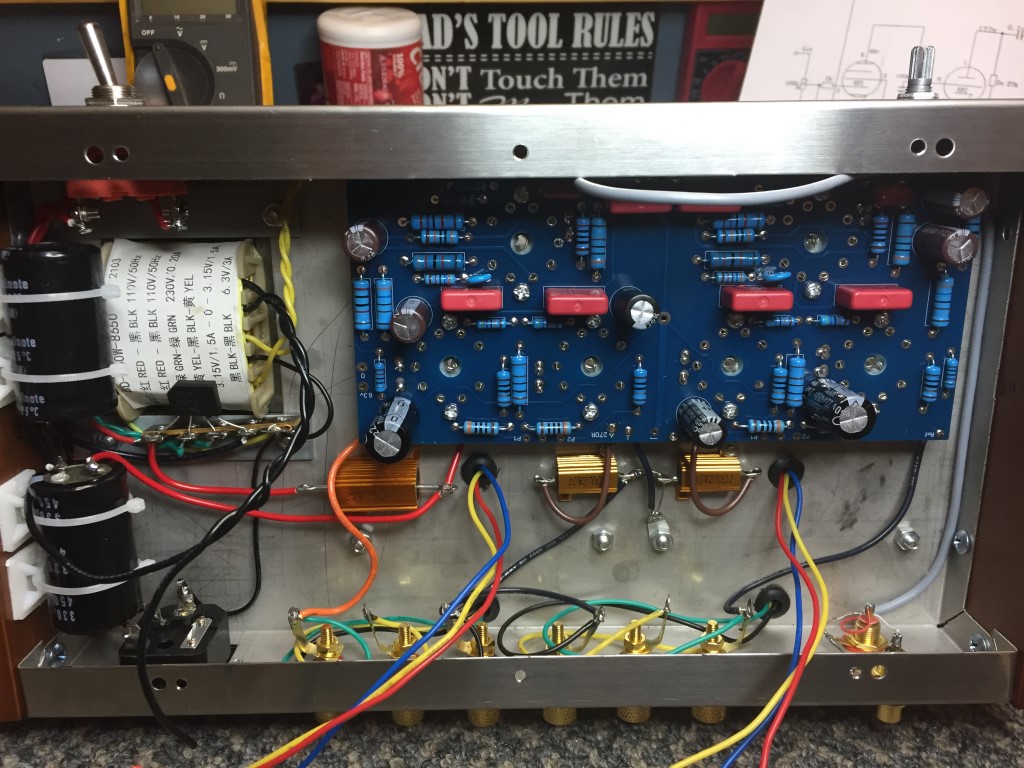

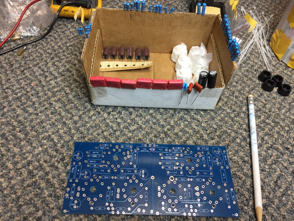

Another snow day! I spent the afternoon working on the PC board. They had it labeled clearly with the value of each part. I only wish they had the part location related to the schematic, such as "C1, R22, V1 etc. This part went pretty good. It was straightforward and simple. As in a previous build, I used a small box labeled with each part, then stuck the wires in the cardboard as shown. This idea was picked up from an old Heathkit manual.
Started with the resistors. I checked each one before I installed.
Next I put the Electrolytics, then the smaller caps.

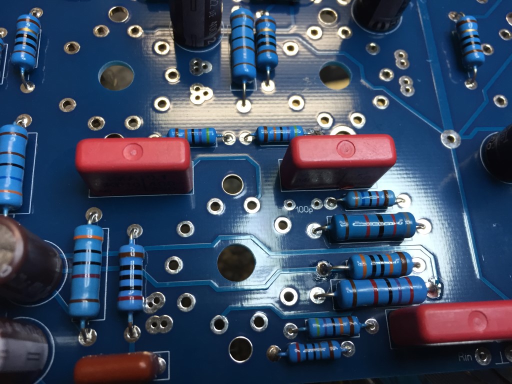

This one was a little harder to locate, It's a 100pf disk and I had to hunt to find its location.

Tim, is that a double sided board?
I think I would be tempted to replace the electrolytics they furnish with the kit with Nichicon and/or Panasonic, and the film caps with WIMA, for greater reliability. But that's just my opinion. I hope the kit turns out well!
I'd do the same, only first I'd like to ask if by any chance the caps are of some good brand in the first place. From the photos I wouldn't be able to tell.

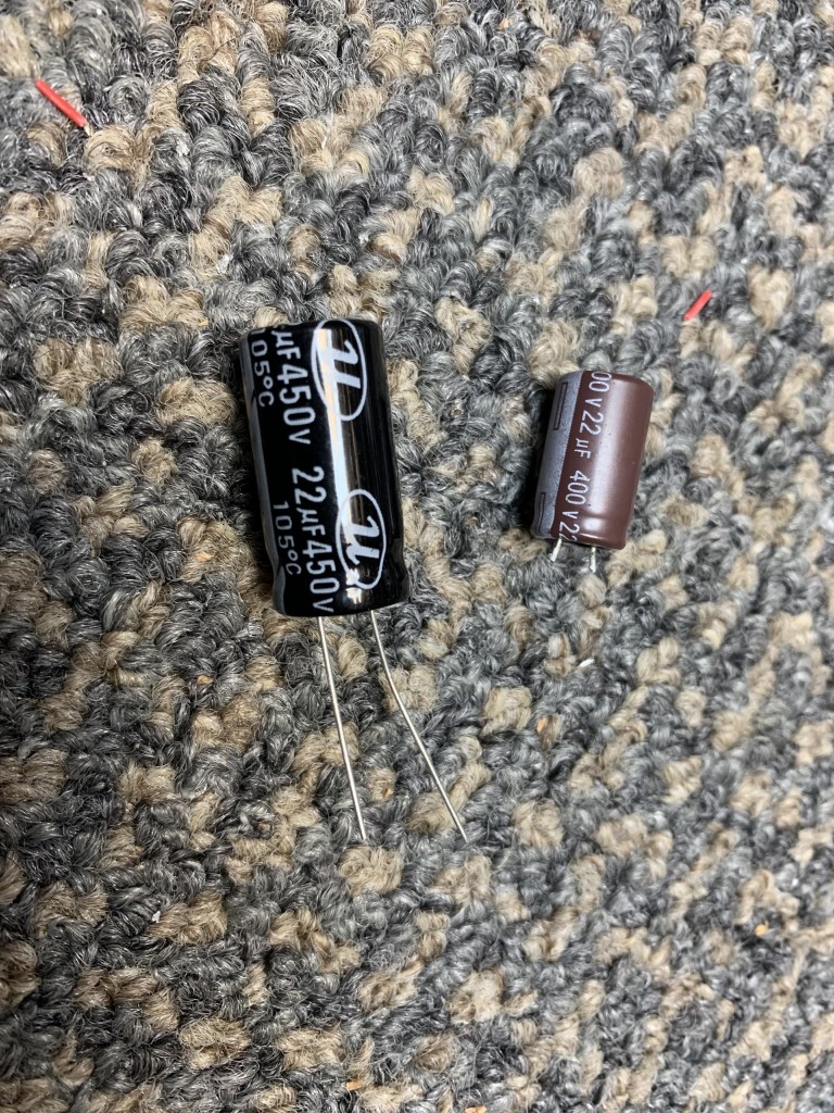

I may go ahead and replace the 2 big power supply electrolytics. They didn't look that impressive and will be hit hard right off the bridge. I couldn't find any of the brands mentioned (in the size and value) but I did find a few CDE caps. Most all say "from China". The smaller ones on the PC board "appear" to be operated well below their rated values, and shouldn't be hit with much ripple current. I think the B+ is in the 250v neighborhood and they are 400v caps. I did a hunt for some WIMA caps and found quite a few offerings. But I have a dumb question, just what is WIMA? A brand or type?

I decided to follow Rons advice to some degree and am upgrading the main filter caps and screen caps with some I had from Mouser. You can see the size difference here on the 22uf 400 vs. 22uf 450v from mouser. The others in the circuit wont have as much voltage or ripple.

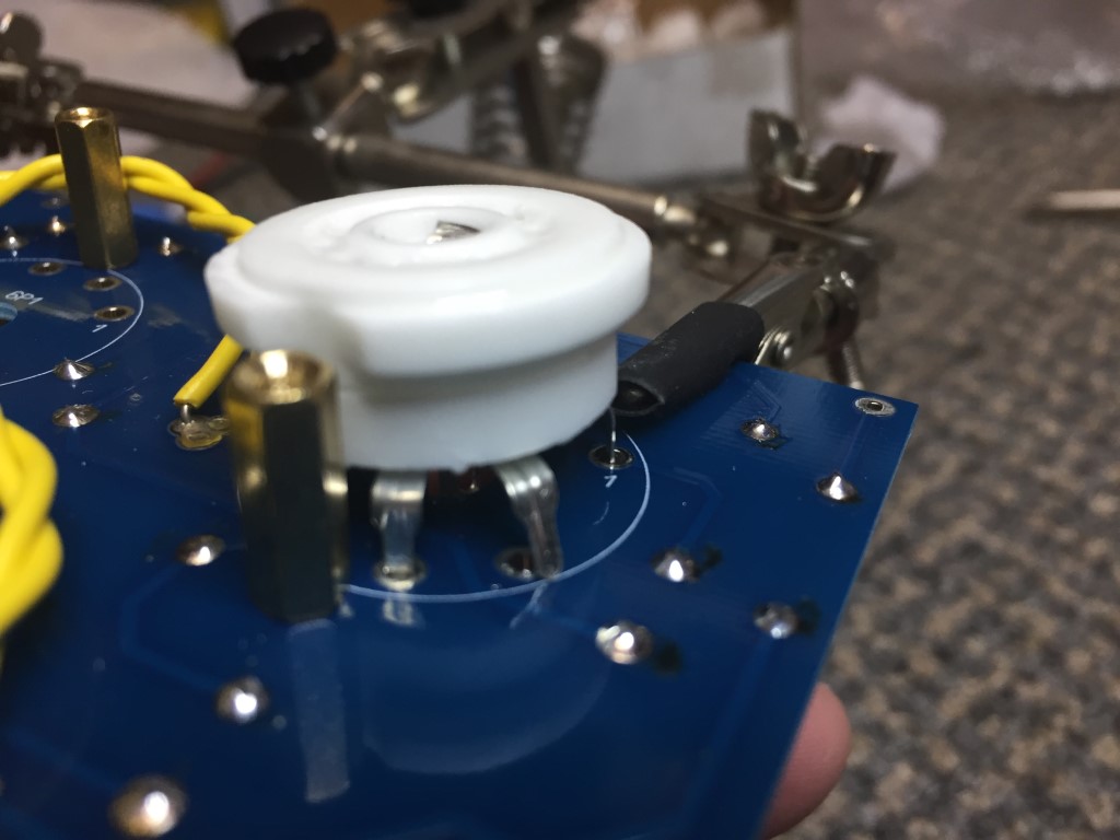

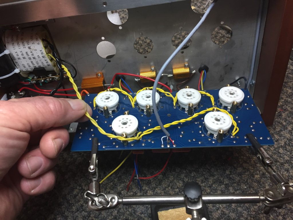

You have to kinda watch the pins on the tube sockets when inserting to the PC board, Seems like they kind of want to escape. I found it was best to install the spacers 1st on the PC, then insert the tube sockets.
The completed PC board. I did not solder the tube sockets at this point. I will wait until the board is mounted and the sockets are level with the chassis before I solder. I detest crooked tubes and sockets.
I left plenty of wire so the board can be removed for service if needed without unsoldering. The input cable is shielded and the filament wires will go straight down against the chassis.

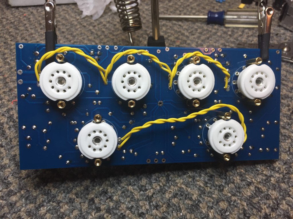

*Note that the output tubes and voltage amp tubes are on separate filament windings, also on the voltage amp tubes, you have to solder the filament leads on the PC board on a couple extra pads near the tube sockets. Not a fan of this but it works. The output tubes have clearly labeled pads on the edge of the PC board. You have to jumper the filaments of the output tubes as shown. There are no connecting traces, just extra pads to solder to. Again, not a fan of this, but it works.
The final installation. I still need to solder the wires for the output xformers and a few other things. This is where I quit for the night.
