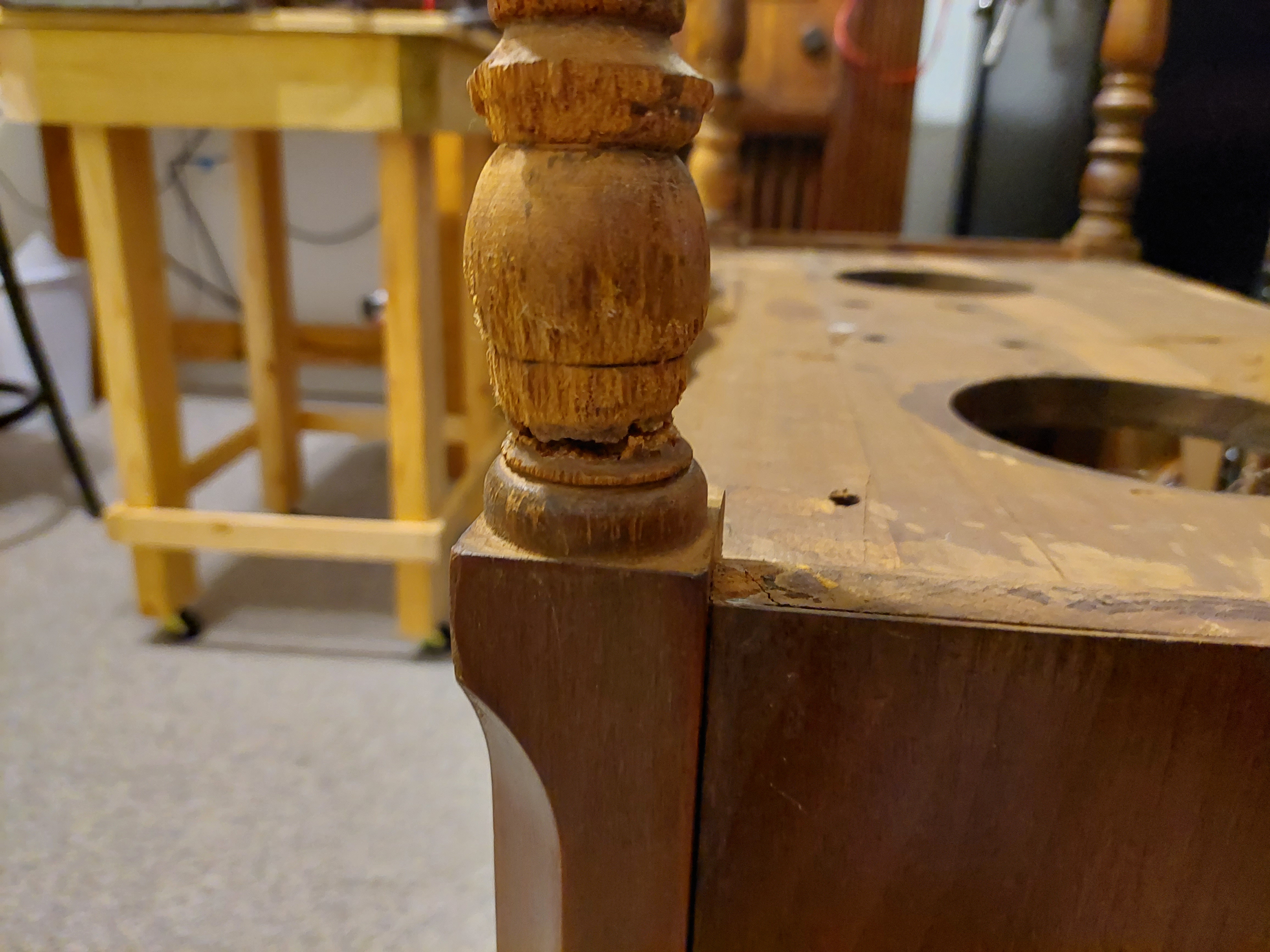

Thanks for the responses they are always helpful. I inserted a wooden dowel and reglued the leg. Seems to be OK. Years ago, my cat used the front legs for scratching post. I don't think I can make it good as new but will do the best I can. I am still researching all I can before getting started. I am sure I will have questions for yall in the future. Here is a pic of the leg.

Kitty sure must like your console! A good quality wood filler, a little filling and tooling, and some toning laquer should get you an acceptable repair. Take care and BE HEALTHY! Gary
P.S, lemon oil extract rubbed on the scratched wood will usually keep felines away.

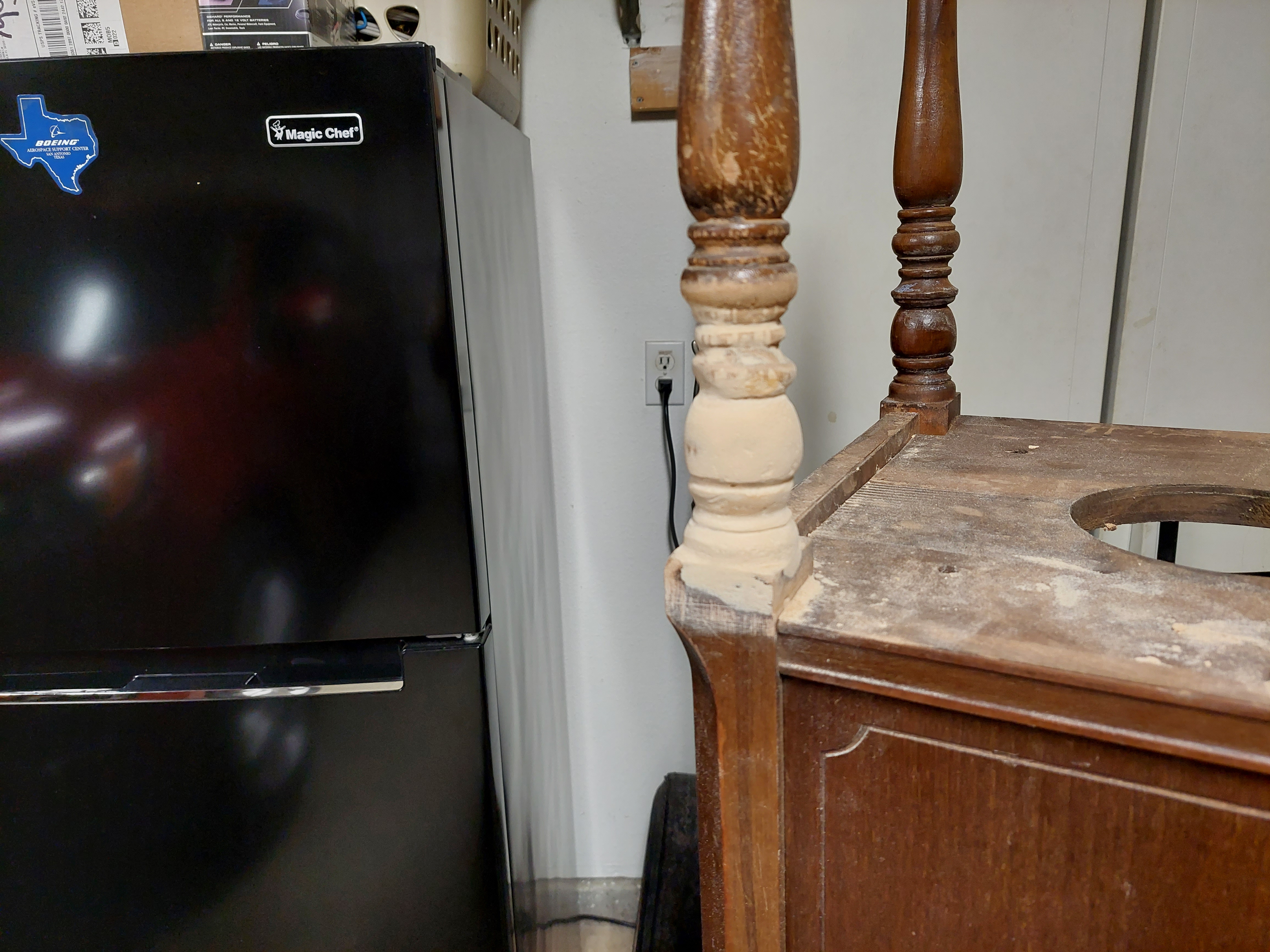

Havent been able to work on this much. I had use a lot of wood filler, trying to get it shaped is a pain. questions: should I use something on the filler before putting on the tinted lacquer? Did Philco use gloss or semi-gloss for the clear finish coat? I wont be able to make it look new but close I hope. Picture attached.
May I suggest checking local woodworking clubs, wood turning clubs etc for someone to turn a new leg? You could remove one of the good remaining legs for a pattern?

Fortunately the late 1929-30 Philco lowboy cabinets were sold with a multitude of chassis, so they built a lot of them. It might be an idea to post an ad looking for the legs, and posts from a junk cabinet, I remember Rodney out in Washington found one that had been stored outside under some stairs, but salvaged the chassis, and some solid wood cabinet parts, there may be others out there. Actually the cabinet you have is different from the one Rodney had, so I think it may be a 1928 model console.

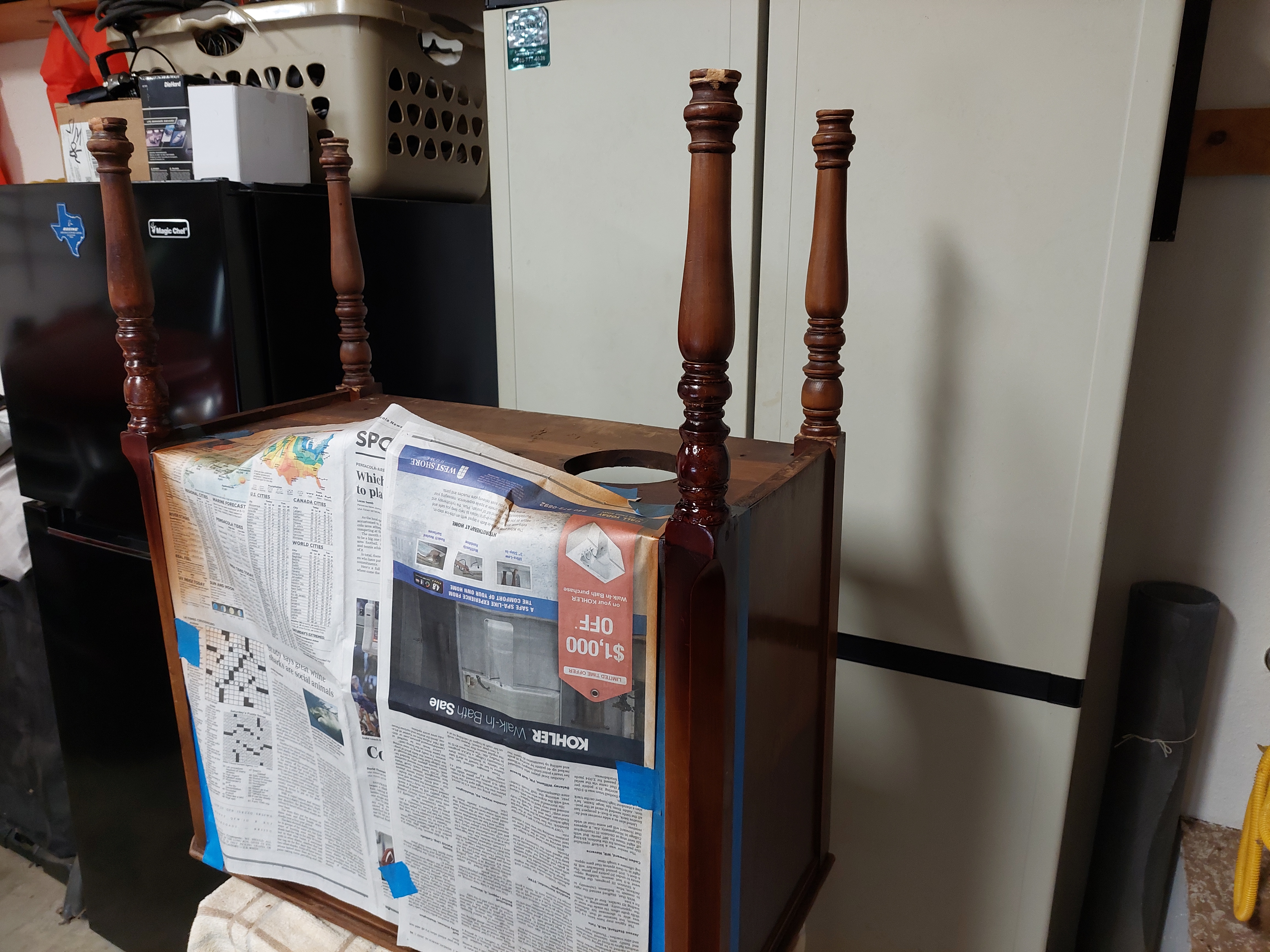

Well, I do not know what I am doing. Applied the wood filler and when I was putting on the Mohawk ultra-classic medium brown walnut tinted lacquer in came out reddish and shinny.
Could not get a good color over the filler unless I used several coats. Took some 0000 steel wool to the legs and re applied the toner. Still reddish and shinny. So what can I do now.
I would like to get the legs finished so I can do the top. I really don't want to cut one of the good ones off and then have to re-mount 3 legs. Any and all ideas will be greatly appreciated.

That really doesn't look all that bad. 0000 steel wool is a polishing grade, and wont cut the shine all that much. Try a coarser grade of steel wool and gently rub down the finish until it dulls to your liking. You may want to spray further than the repair to help blend the wood tones. There are much better wood finishers than me on this phorum. You have nothing to lose by trying. Take care and BE HEALTHY! Gary
