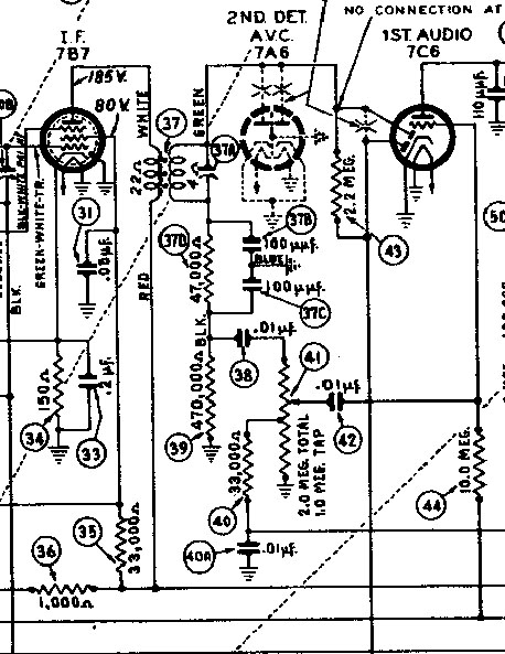

Here's the volume area of my schematic:

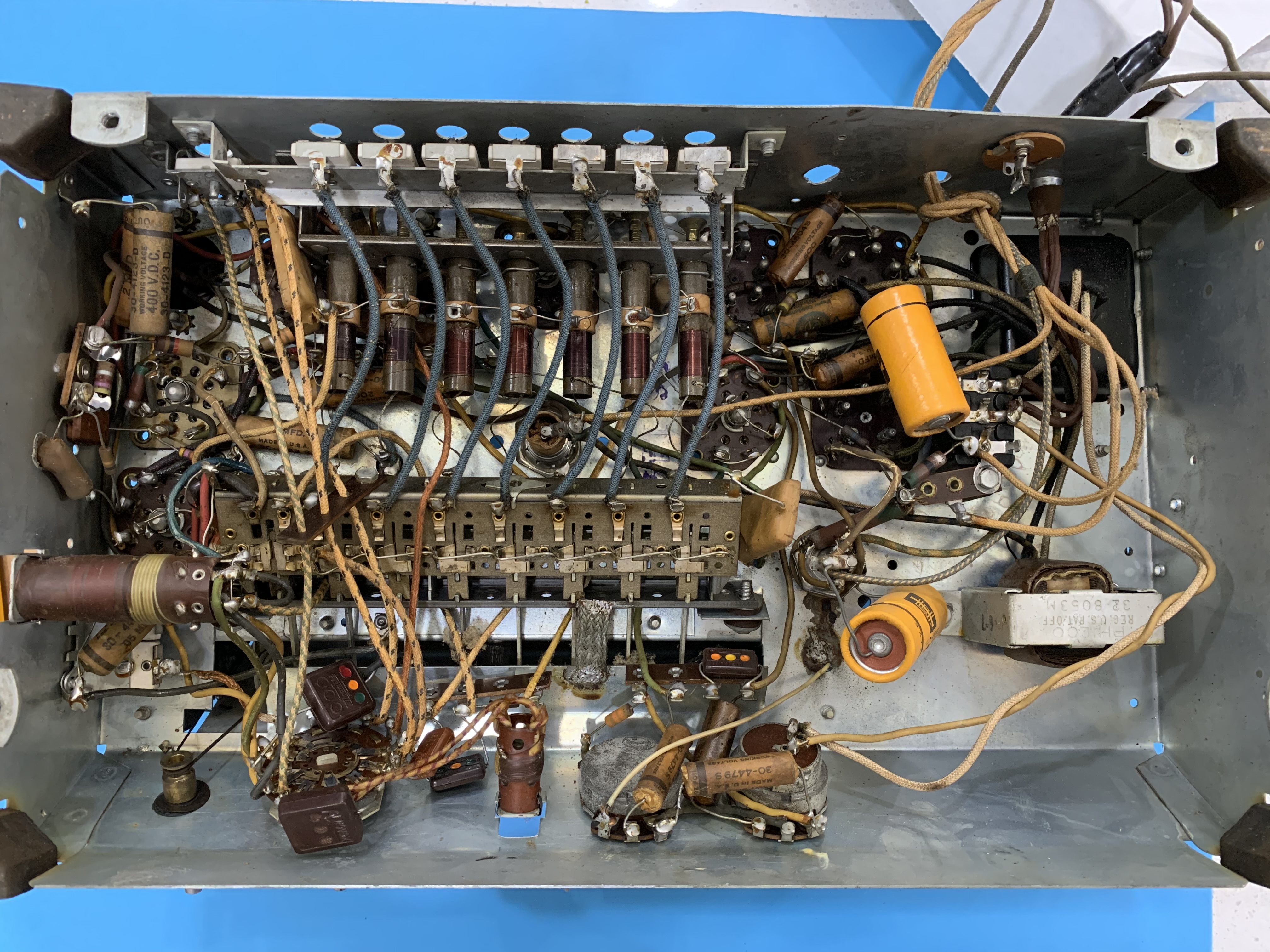

Here's the underside of the chassis prior to the enthusiast's restoration:

- The restorer noted one of the pushbutton switches was bad. Is there any way to use That as the switch to stop the radio signal while using the input? Seems like an elegant solution.
- If that's not an option, this radio has the aircraft and police band -- is that an option to disconnect that band, and use that as the "switch" ?
- If those aren't options, where should I put the switch?

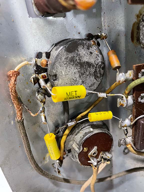

- The aux input I installed on the AA5 wired into the top and the bottom of my volume pot. This volume pot has an additional leg (see chassis photo). Anything I need to differently?

I may have answered some of my own questions. The Bandswitch looks more complicated than I want to monkey with. I do still wonder if the bad pushbutton is an option.
Also, I inspected the restored volume control, and noticed something odd - the wired connected to the top of the pot appears to have the shielding connected to the bottom of the pot. When I got this radio, it wasn't operable, and it looked like someone was trying to add a phono input, and gave up, so the original posts' pic may show a miswired solution.
Can anyone tell me why the wire is connected the way it is? Why would the shielding be connected?

The shield is grounded to the low end of the volume pot which is correct. You want the shield connected to ground to prevent hum pickup. What does the other end of the shielded cable connect to?

Greetings,
I followed it back to a terminal strip underneath the pushbutton coils. where it connects with a capacitor and some other wires. I know that's no help at all for you to try and help me.
When I push the bad pushbutton, and turn the band selector to the aircraft/police band, it's very quiet, and my music sounds good jumpered in to the volume. I think I'll solder it in, and call it a win.
I think I'll settle for that, as I'm afraid I'll mess up something if I install a switch somewhere.

Better fidelity can be obtained by breaking into the audio circuit by installing a SPDT switch as follows:
Break the connection between C38 (the input to the Audio Amp) and the junction between R39 and R37D (the output of the Detector). Connect the common pole of the SPDT Switch to C38. Connect one switchable leg to the junction of R37D and R39. Connect the other leg to the Audio Jack that you are using. Use shielded cable if necessary but ground the shielded cable between the switch, detector output and audio amp input at only 1 point to prevent ground loops. If the audio jack is not grounded to the chassis, connect the ground terminal to the shielded cable and ground at the other end of the shield. I will try to attach drawings.

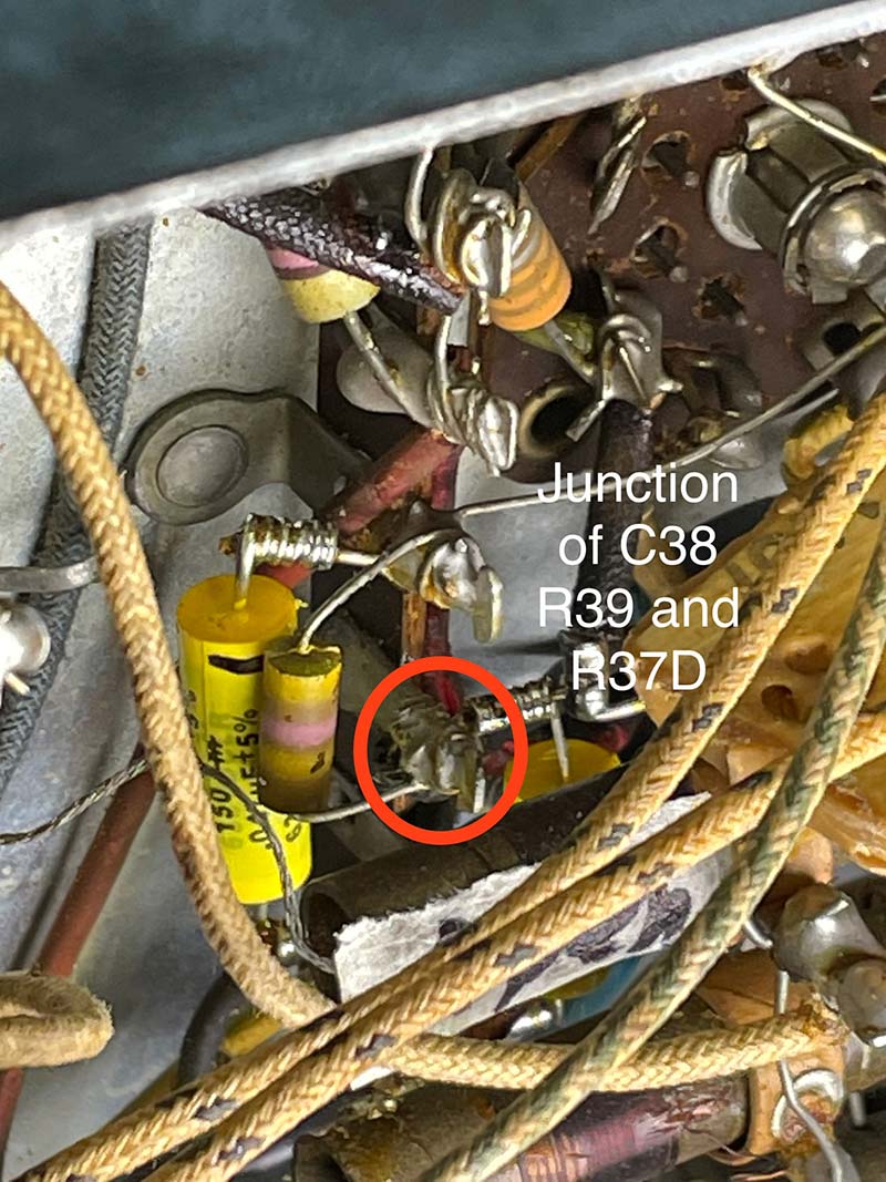

So this may be more of a "learning exercise" or thought experiment at this point, as the junction is under the coil assemblies for the pushbuttons, and I keep looking at my friends nice work and not wanting to bungle it. I do want to learn, and understand the process. I may yet give it a go.
I believe I've found the junction (see attached photo).
R39 is on the left. C38 is on the bottom right, barely visible. The other end connects to a different terminal lug, which connects to the wire that leads to the top of the volume pot. (this was the wire in the previous post that I "didn't know where it went  )
What confused me was R37D, but I think I understand now. I was looking for a 47k resistor, but it appear that's inside of the 2nd IF assy, and the black wire is actually what I should be looking for. It's connected to the Junction as well. Do I have that right?
The other question I have is about "shielded wire". I was planning to use an off the shelf aux cable, with L/R tied together through 100 ohm resistors, and possibly another 500k resistor and a .02uf cap (tied to top of pot) , and the ground wire tied to bottom.
Clipping this in with test leads, this generally works well for the aux audio, but decreases the volume for the radio stations and introduces hum if the jack is not plugged into a source. I assume I've introduced a "ground loop" that you mentioned, but I don't quite understand the concept yet, or how to look for them and solve them.
Thanks for your patience and sharing your expertise.
David
