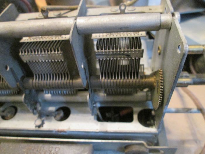

I started looking over tuning and it stopped about half-way.  I look in the back and the  variable capacitor is in the right place but then I noticed this little half-gear has reached its end stop.   It shouldn't be stopping right there.   The shaft has serrations that hold this gear in place.   It's a double gear made from two then pieces of metal and there's some springs that hold them together.
So what goes here?   It must have been this way for sometime.   Considering the shaft condition it looks like should have never happened.  It was stiff, maybe someone tried to force it at one point and it skipped.
How do you properly realign this gear?

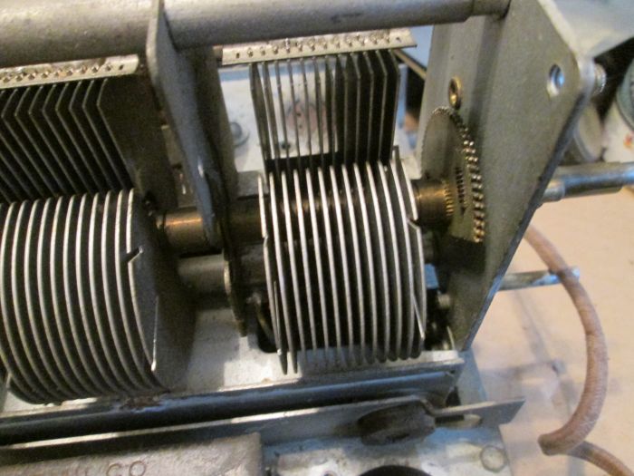

It doesn't look like there is any way to change the relationship between the split gear and the tuning capacitor's shaft. It's pressed on. As long as it hasn't broken away or the teeth are stripped off your ok. The planetary drive can be replaced separately and probably isn't a bad idea to disassemble and clean it . They get gummed up stiff.
Here's a couple of pic of the relationship of the split gear vs tc plates from a 37-620.
