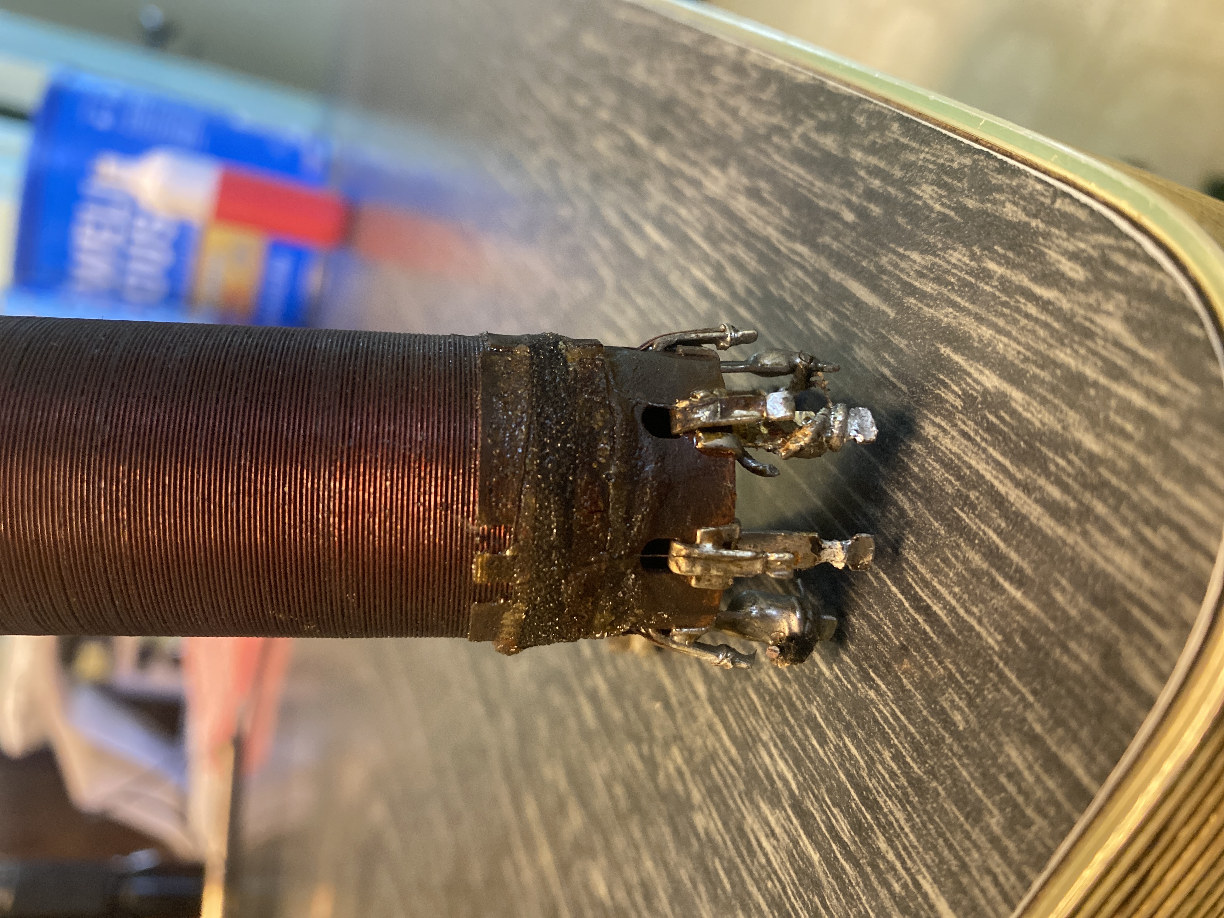

Okay folks so I got the oscillator coil out of the 60. The ohm reading I got was something around 125!!! I believe the schematic says it should be about 3.0…. I’ll attach a picture as you can see, no leads appear broken, but why on earth am I getting 125 ohms? I checked the upper part of the coil and got exactly 2.4, which is what the schematic calls for. So I’m confused…. I know if that lead was broken, I wouldn’t get any reading at all  Icon_eh
It's called rot. If you unwind the small coil at the bottom you'll find some green dots where the copper wire is failing.
Oh I see, I didn’t know that would throw off the reading. I just figured I would get the correct reading or none at all.
So once I rewind the wire, it should read at around 3.0 ohms correct?
As a rough number 40 gauge wire is 1 ohm per foot. 38g is going to be a little less .67 of an ohm per foot. So you can calculate about how long of a piece wire you'll need to rewind your coil. That's the long answer short answer is yes.
Okay thank you so much for all the help! You all are amazing!
Got the old coil unwound! The wire itself wasn’t broken, but the insulation was all gone. Which explains my wacky ohm reading. Once I had the wire removed, I laid it out flat so it’s not overlapping itself, and then I got 2.4 ohms! So now I know that the oscillator coil wire itself doesn’t necessarily have to be open in order to cause problems!
