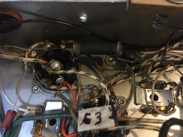

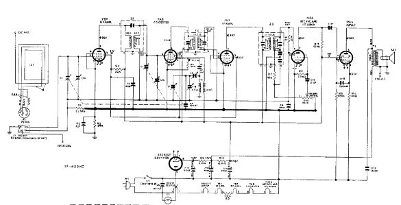

in between other work I have been plugging along on my Philco 51-930 radio chassis I have a Questions one concerning R5 the Filament dropping resistor which looks like a old style dogbone resistor is no good So since reads 2000 ohms and schematic say 100 ohms.
I will need to calculate a high value because of our higher line voltages and far as wattage goes and type resistor should I go with?
Far as C8 that should be a safety capacitor and I am thinking C2 too.
C12, do you think I need to put a high voltage capacitor or can just use a one yellow capacitor rated at 630 volts since this is just plain old AA6
 Here is a photo of that R5 and the Schematic
At 100 ohms that sets the filament string to operate at 115v. If you increase, it to 166 ohms that will set filament string at 125v. Dissipation is 3.75w so I would use a 10w. Closest common value would be 160 or 170 ohms. Either would work fine. Don't know that I'd bother to change C2 or C12 to a different type.

Replace the 35L6GT tube with a 50L6GT. This will set your filament string at 116.5 volts without the dropping resistor. Now, replace the dropping resistor with a 56 ohm, 3 watt resistor. This resistor will set your filament string at 124.9 volts, close enough. Smaller dropping resistor at less wattage (it will dissipate 1.26 watts of power), your radio will be happy and so will you. Icon_smile
The 50L6GT is a plug-in replacement for the 35L6GT. Only the filament voltage differs.
Hello Ron,
I think replacing the 35L6GT with a 50L6GT is the easiest way to solve the issue!
The radio will be really happy with those voltage and extend the tube life .
