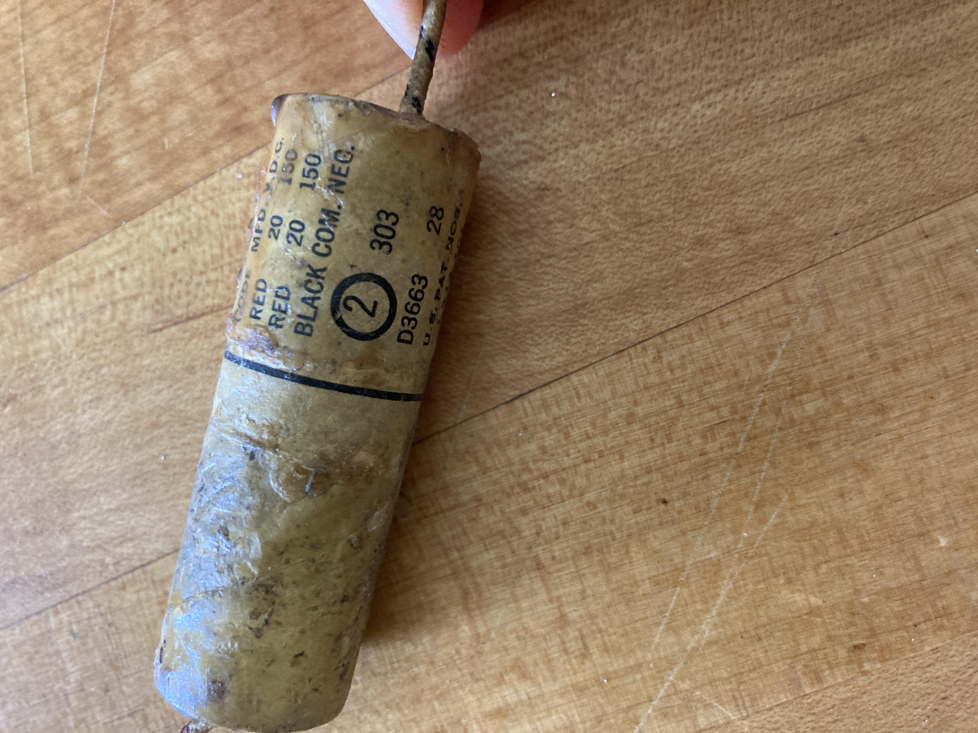

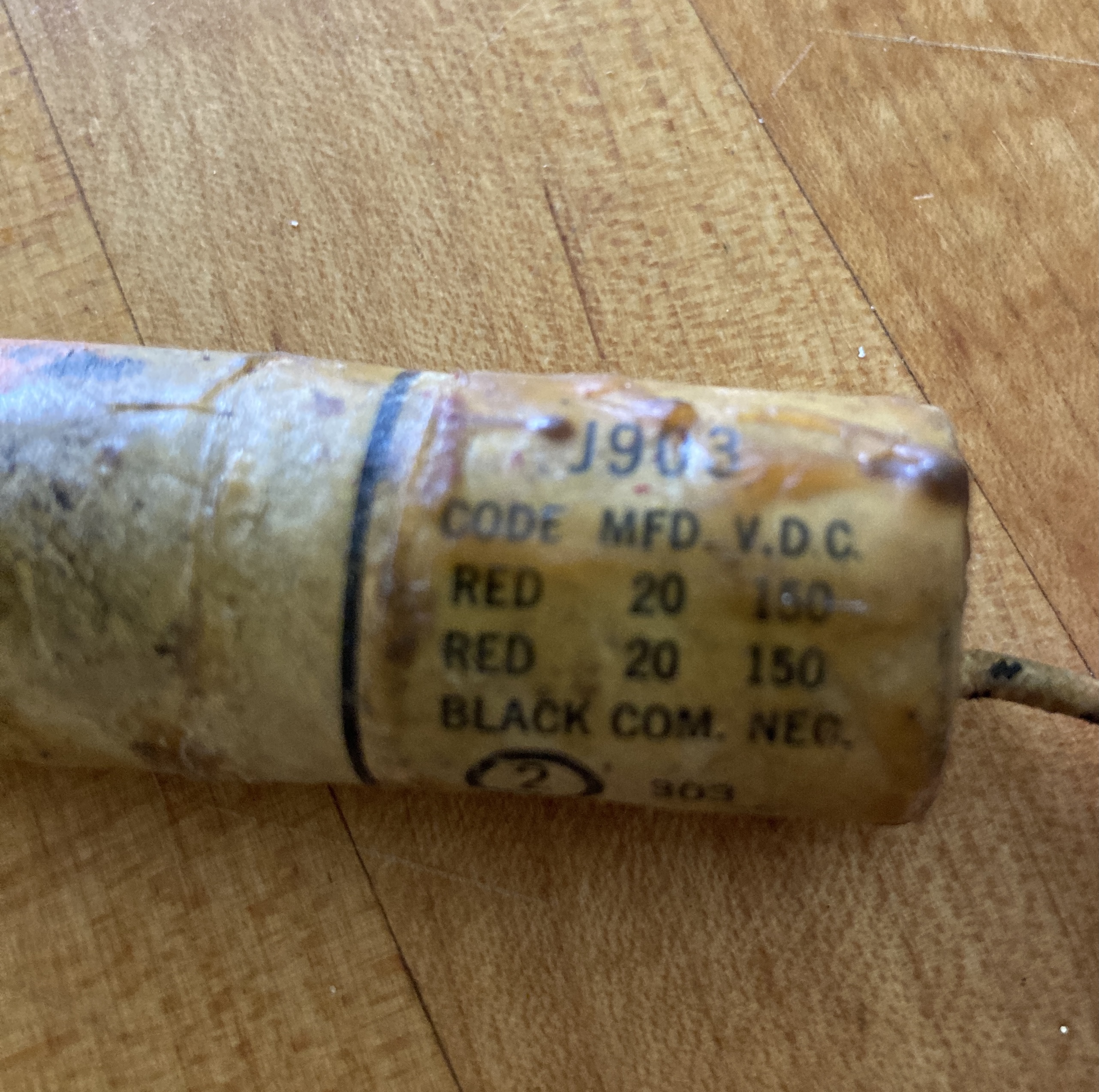

I figured out the replacements for all of my other paper condenser except this one?  What do I replace this one with - I have tried all morning to decipher it.  The photos are of the same part - just different angle.  Its the largest condenser in these types of radios.  2 wires on one end; one on the other.

Welcome to the Phorum,MV! What you have is a dual 20 MFD 'condenser' with a common negative. If you are looking to repack the paper cap you could use 22 MFD electrolytics (for size issues). Pay close attention to wiring them common negative. I would also bump the volts to at least 250 v. I know just enough to be dangerous at my stage in the hobby. There are other sage minds here to help with a lot more expertise. All you need do is ask. Take care and BE HEALTHY! Gary
Hi and welcome to the Phorum. You can replace the dual 20mfd cap with 2 - 22mfd 160 volt aluminum electrolytic caps. Tie the common negative leads together and you have the same as the original, but smaller. Like Gary mentioned, you can remove the guts of the old one and insert the new parts. Use a black wire for the common and red for the positive leads. Fill the ends with hot glue.
Some will mount the caps on a terminal strip and run the wires to the strip terminals.

As the guys have mentioned, you can replace with two 22uF caps with their negative lead connected together.  Here's an example of a similar (although this one had 3 caps instead of 2) situation where the new electrolytics are inserted into the gutted paper tube.  usually some warming of the old capacitor with a heat gun and then some pulling and digging will get the guts extracted.  See: https://philcoradio.com/phorum/showthrea...8#pid35928
The new electrolytics were pushed further into the tube than you see in the photo and then sealed with hot glue. the three positive leads are not shown but exit from the top side of the tube.
Icon_smile Thank you to everyone, I had to keep looking at the pictures and found the new caps on-line and I see it now - written in PLAIN sight  Icon_e_geek !.  One question - why boost to 250V?
