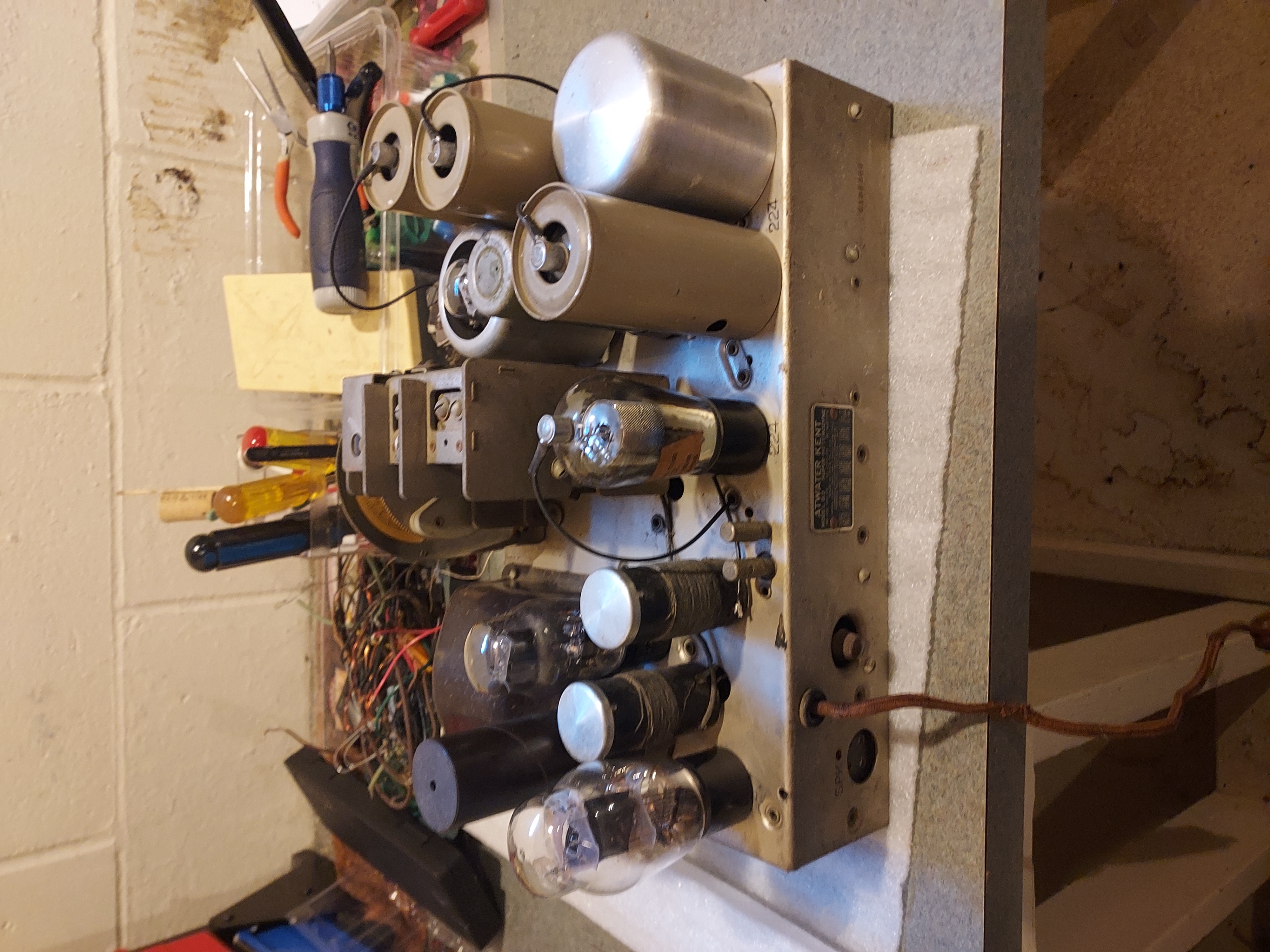

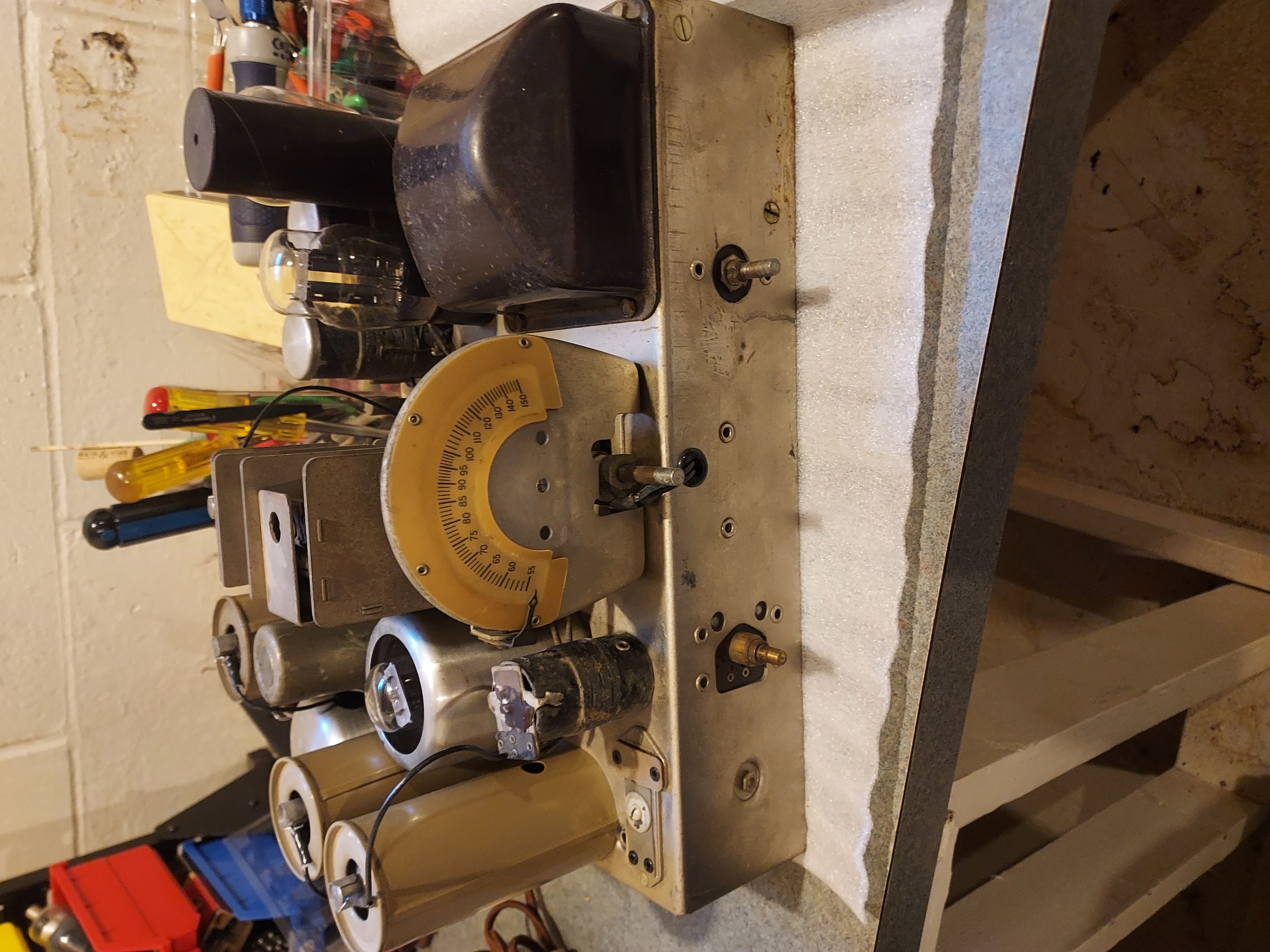

I removed the chassis and snapped some pictures.
As you could see, the radio has been tended to, as the previous owner said; he also claimed it worked. I believe him, but it is not in my habits to turn on radios without having it checked out myself.

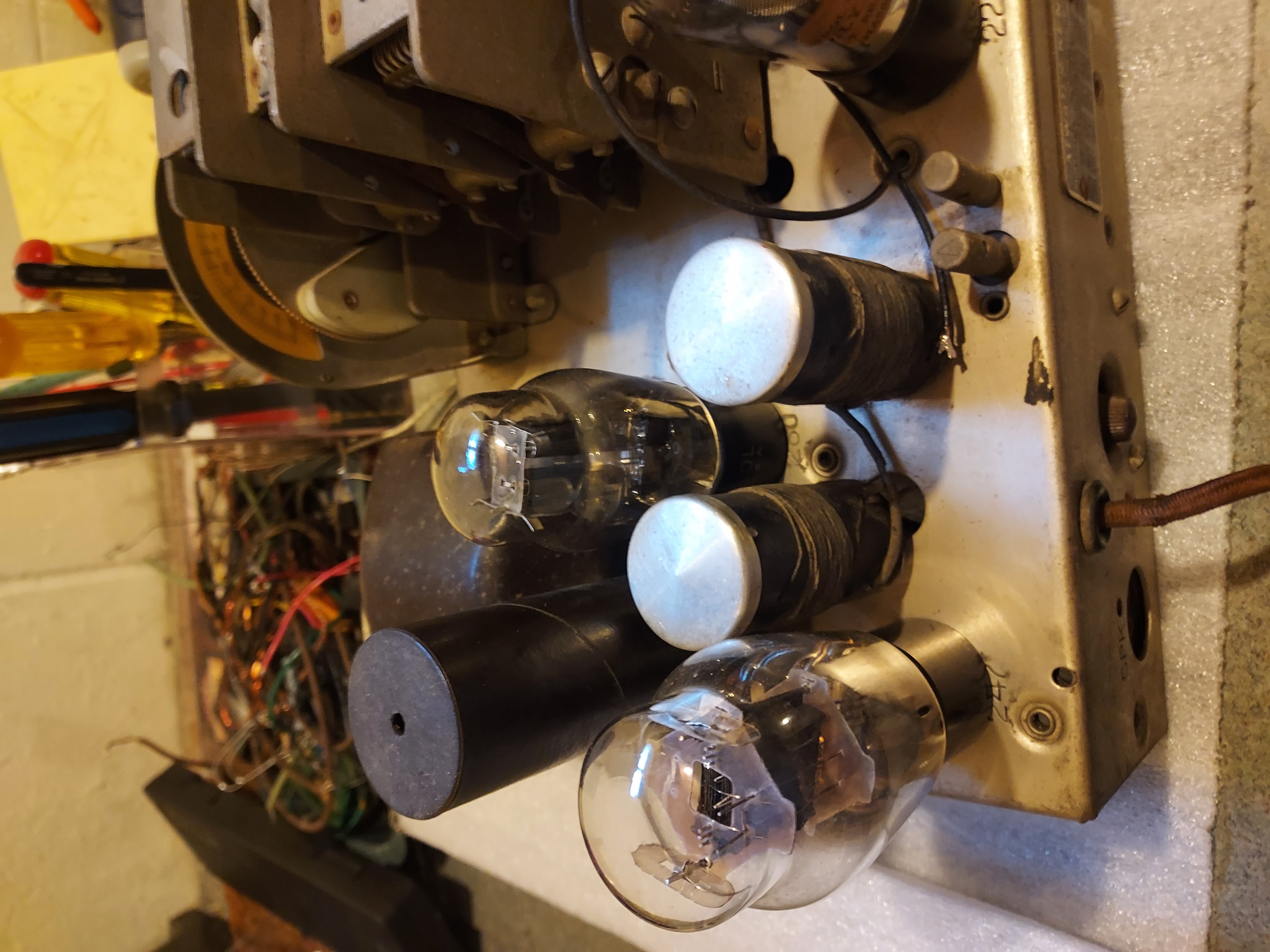

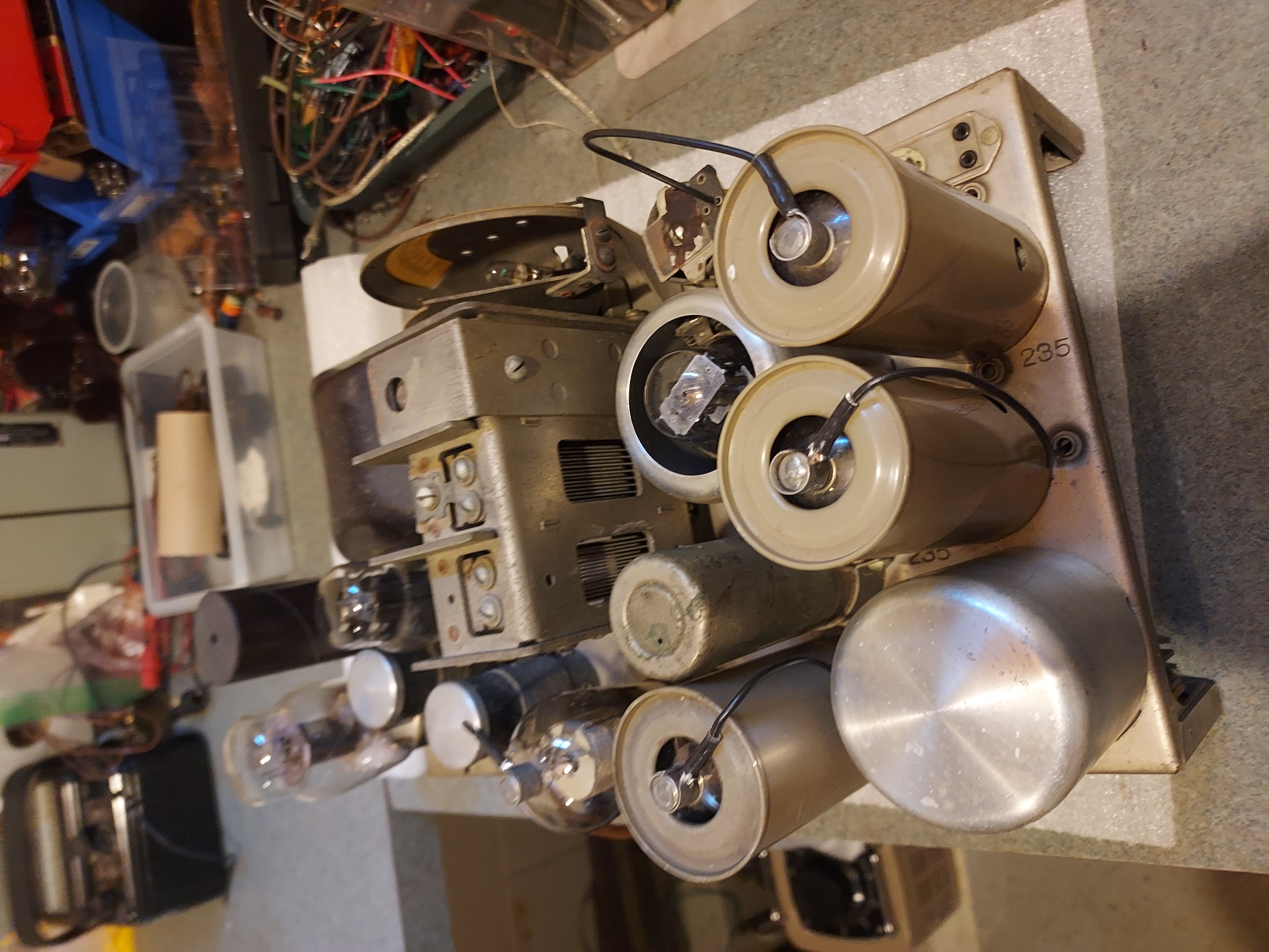

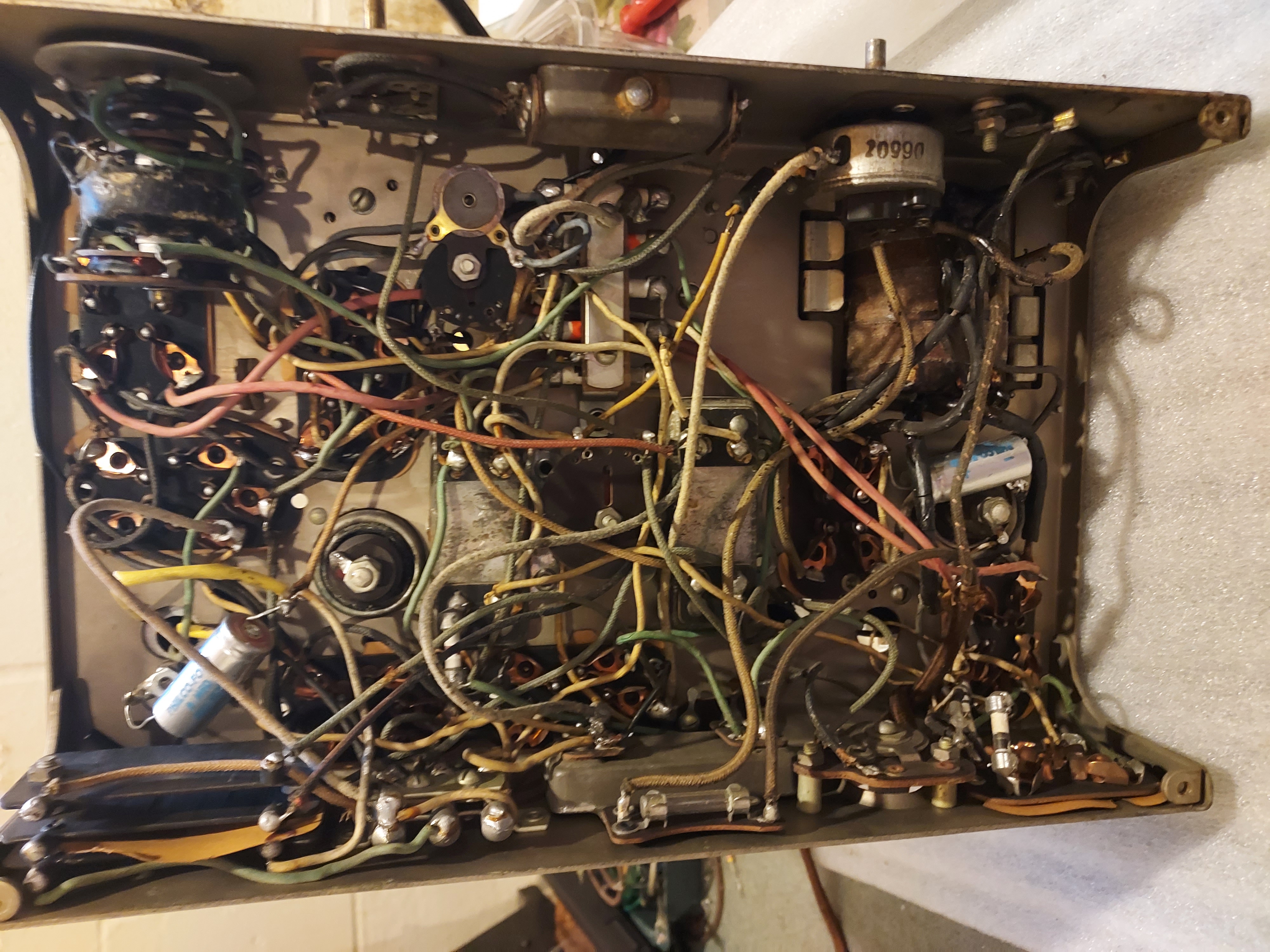

The radio was repaired with Philco-Ford capacitors. The original (or what is there pretending to be the origianls) are disconencted.
I also checked the tubed. All are working, but one 35 tube is weak and the other cannot be determined to be eiyther 24A or 35 (they look the same and test pretty much the same). Luckily I have two working good 35 tubes.

I got curious and looked up the print on Nostalgia Air. Looks like the 82 uses two 35s and one 24. So that is probably your mystery tube.
Jayce
The tube numbers are stamped on the chassis, so there is no mistery. What I mean, without marking on the tube (glass or socket) and people sometimes subbing 24A for 35 I have to go by assuming it is a 35.
I of course could try to see the grid wire spacing, but not sure how well I could tell the difference.

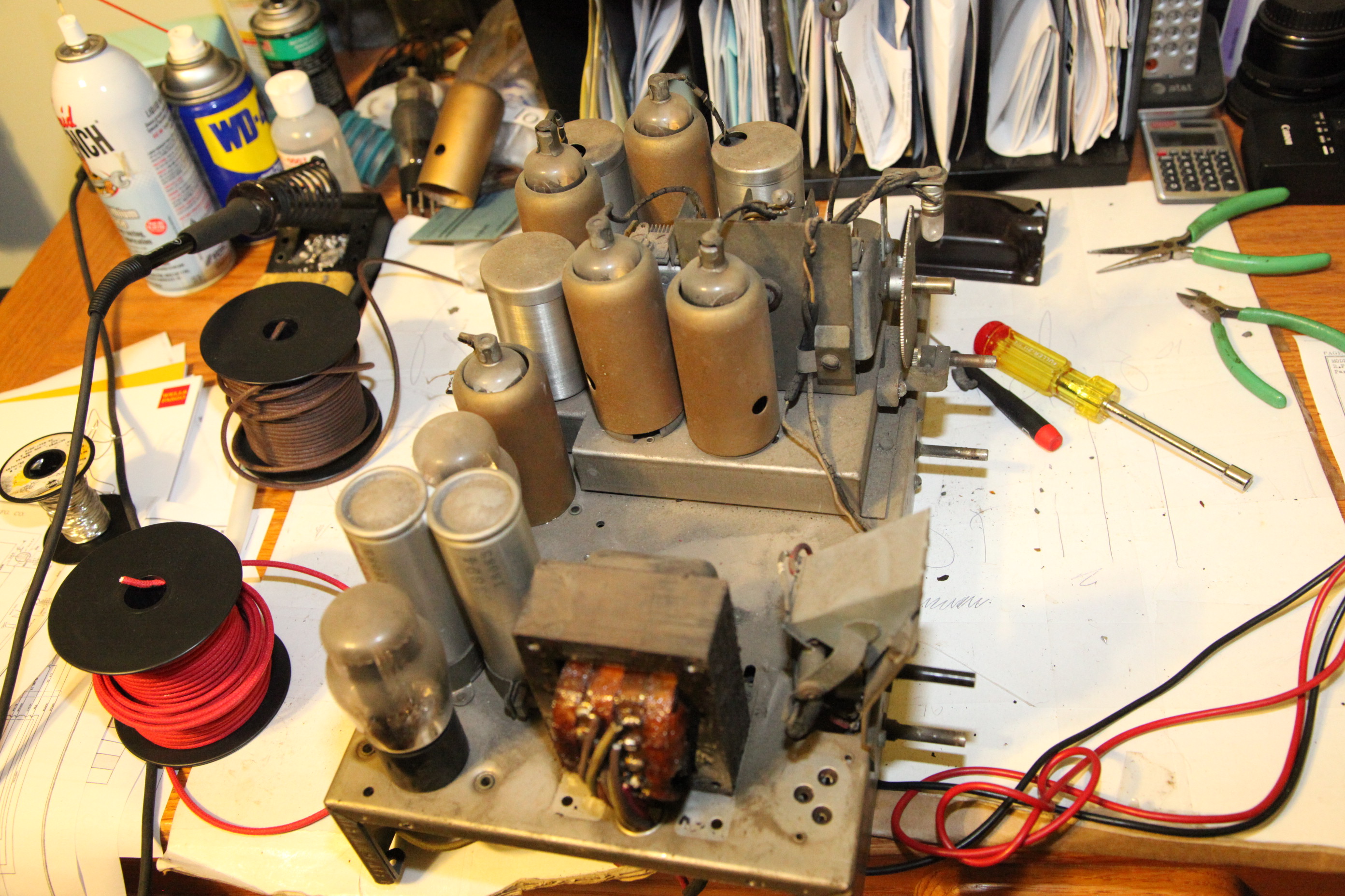

Posts: 5,650
Don't forget to check, and replace the wiring on the power transformer, this is why may of these A-K transformers fail, insulation falls off, high voltage wiring shorts to chassis, and a smoke show follows. Russ is the guy to ask about these.
Arran,
Yes, I did exactly that with my AK808A. I used colored heatshrink tubes to restore insulation.
Here it is. Year 2014.
Set the chassis on the Simon's holding fixture.
All the wirewound resistors, including flexibles, are right on the money. The Bias resistors (old style dogbones) are within 10%.
Most rubber wires are pliable; very few are cracked in a place or two. Most wires are cloth-covered.
Volume pot is good.
Tomorro more will come.
