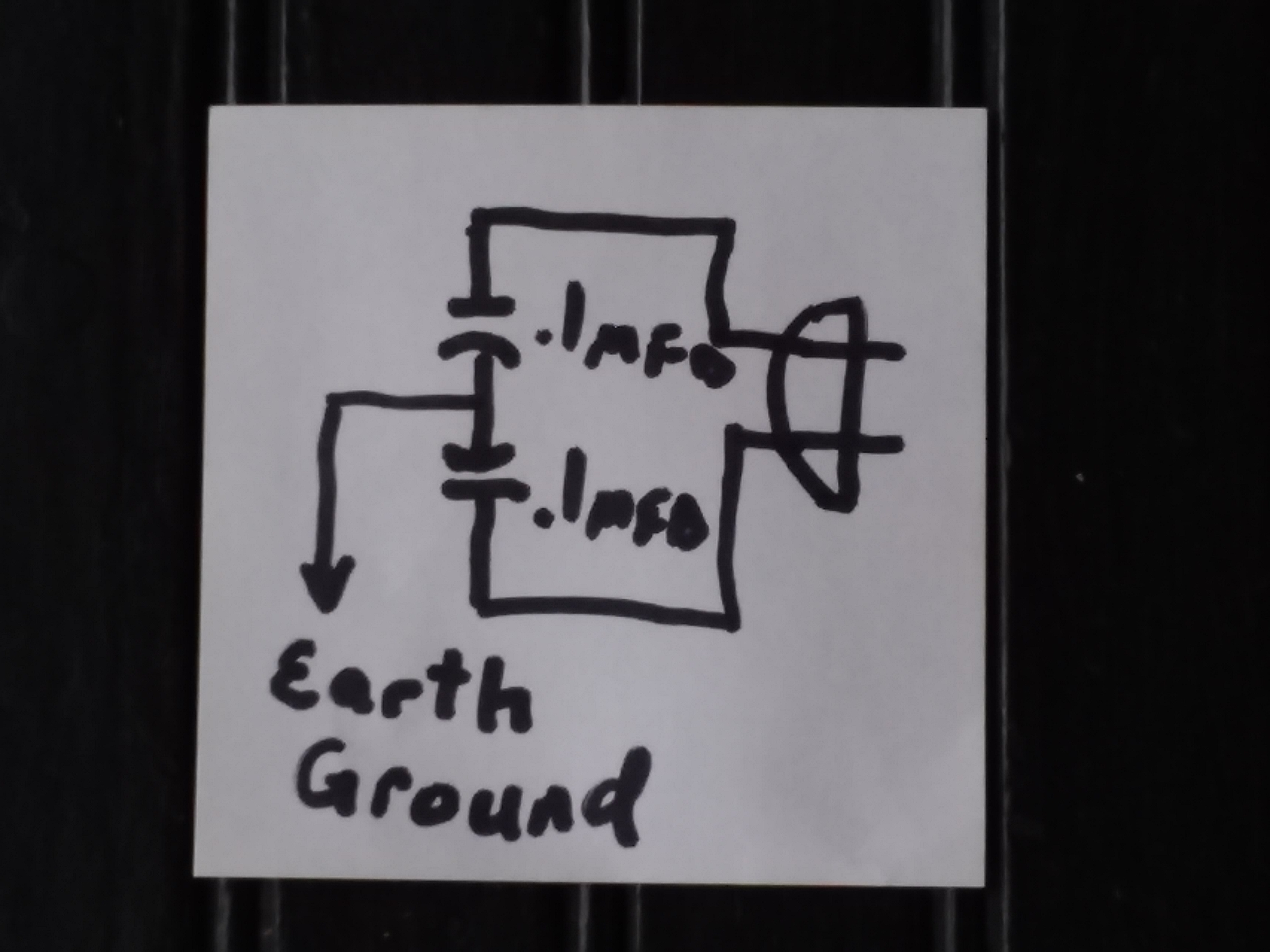

I'll try to clear it up for you. In America the AC power supply is referenced to earth ground. Most house wiring is 120 volts AC 60 cycles. Houses are full of hundreds of feet of wire. The ground wire for all the power in a house comes to a single point and that is electrically connected to earth ground. All that wire acts as an antenna both for transmitting and receiving lots of electrical noise and interference from motors, fluorescent lights, wall worts, etc. And that's how it gets into our radios.
The objective with the capacitors is to attempt to filter out the noise to earth ground before it gets to the power input to the radio. It uses (2) .1mfd capacitors, one connected to each side of the AC power. The other lead of each cap is connected together then attached to earth ground with as short a wire as possible. Typically earth ground is the cold water pipe in a house. The plug would then be plugged into my power strip. I would use Y2 safety caps at 0.1mfd.
If I were to make this I would put it in a small box with a power cord and plug and a separate ground wire. If the box is metal then it to would be connected to the ground wire.

Wall warts can be a real problem things like power supplies for lap tops, phone chargers some LED lights and touch lamps. Try using a portable radio walk around your place and try and find the trouble makers. Have a touch lamp even turned off still sends out a signal in the air have to unplug the thing! High voltage power line near your place say 1 or 2 KM away can send out lots of noise over the air. During the summer storm season with a power outage thing are nice an quiet on the air waves and listening to a radio is so nice.
If you want to make a good filter, take Schaffner "high-filtering" input filter,
https://www.digikey.com/en/products/deta...gKwdPD_BwE
(One like this; go to their datasheets and pick one with the highest filtering capabilities), and make an AC power box for your radios.
I use Schaffner in my devices as an input filter (they make pluggable one, though I would recommend the other types, they have stronger filtering) with good success.

A improperly designed (homemade) or poorly installed filter is practically useless as the RF noise will simply "go around" the filter. Of primary issue is the Earthing of the filter, too long a path or a noisy path is useless.
Filters have bypass caps, the AC pass of the caps can accumulate if filters are on multiple equipment on the same branch circuit, the ground fault detector can give way. The filter must use a ground path as the leakage current will be enough to be felt. Most of the caps in these filters use at least a 0.1 mf.

Well-designed filter, beside using the Y- and X- rated caps, will also use a good MOV. And a common mode choke.
And, well, a fuse does not hurt to add either.
