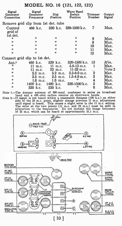

Thanks for getting back to me.  I have the 5 band set and I am using all the original tubes no substitutes.  I followed the alignment procedure in the file that I have attached to this post.  The alignment went well except for the 5.2 m.c. of which I could not set.  I am using a 9 foot straight wire antenna. Would grounding the set help ?
