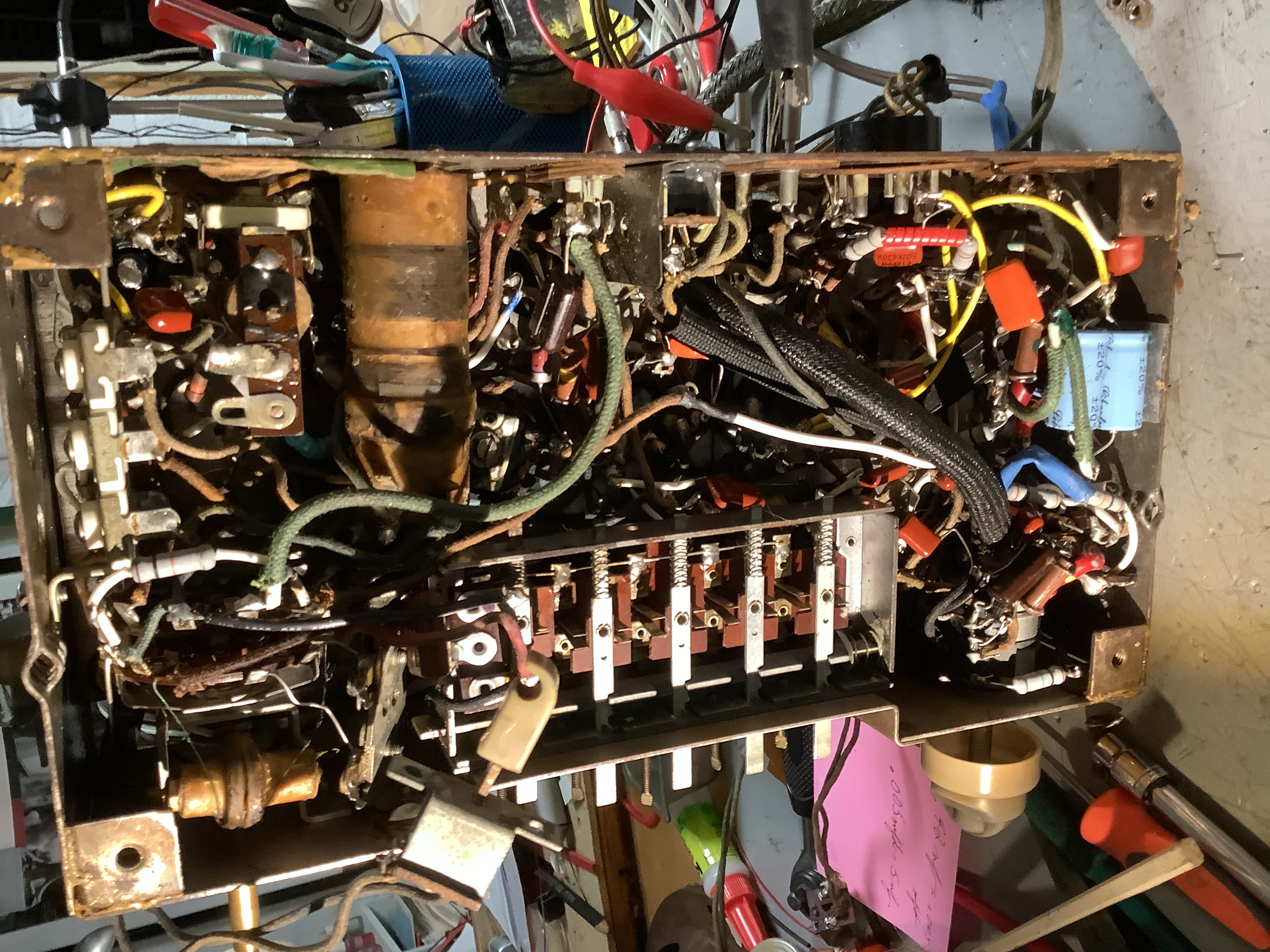

After recapping, cleaning tube pins, variable capacitor, switches and contacts the bc band was working, along with the preset push buttons. When I went back to work on it the next day the radio had reverted to nonfunctional mode.
I’m sending a picture of the chassis. It’s definitely crowded inside! Thanks again! - Rob Q.

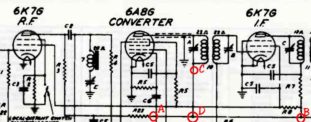

If you have voltage on the plate of 6K7 (RF) and the plate of 6K7 (IF) then something must be wired incorrectly. Check both sides of the IF (#10) for voltage. Then check at R23 and then the junction of R8 & R7. If you have voltage at the resistors but none on either side of the IF (#10) then it isn't connected to where it should be.
In-other-words, if you have voltage at point A and B but not C, then there must be a disconnect between point C and D.

I had wired the IF incorrectly. 6A8G plate voltage is back. Still no radio reception. I’m waiting for a NOS 6A8G to arrive. When the one I have is in the tube tester, readings are all over the place. It would be nice if that’s all that is wrong with the radio, but I’m not getting my hopes up yet. I’ll let you know what happens. Thanks guys! - Rob

Good Deal Rob! I was wondering if here was a miswire, but was going with a cold solder joint first. I gotta get around to learning how to easily cut, markup and paste sections of a schematic like Elliot Ness did in his last post.
