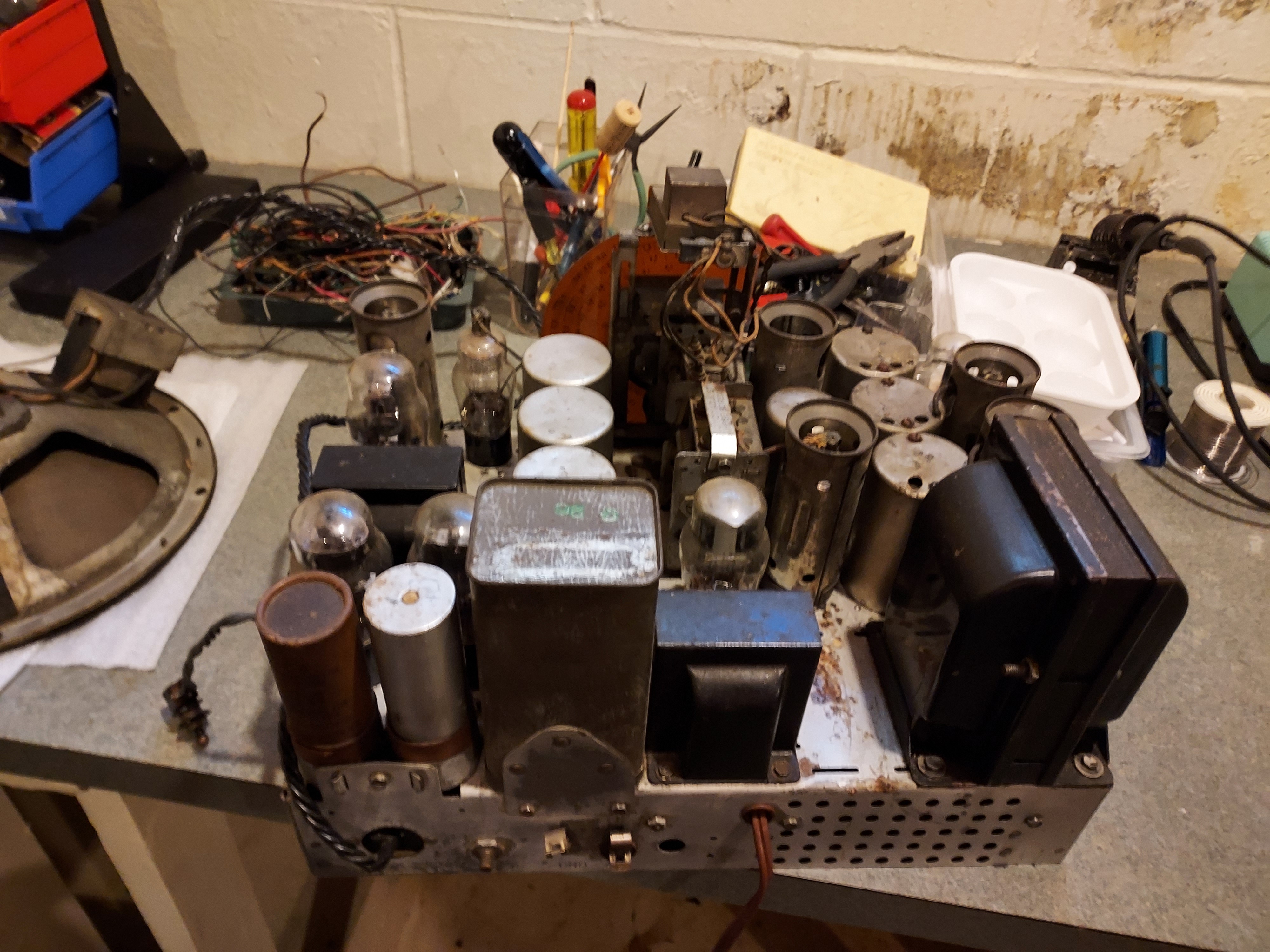

Well, I am not sure what I should've called that.
The radio has obviously been tended to by someone, and even the backelites have been restuffed.
I am still seeing things that are not exactly to my standards by nevertheless it could be a good job done by someone. Itr's just I do not leave 1940-s 1950-s electrolytics Sprague Atom in and then turn a radio on without replacing them.
Plus it seems the tin can has not beed redone but bypassed. Which is electrically speaking is just fine. The speaker cord has been made well and the splicing inside the chassis is also done well, not with some unsighty black tape but a good grade thick heatshrink tunig.
So, here are some pics.

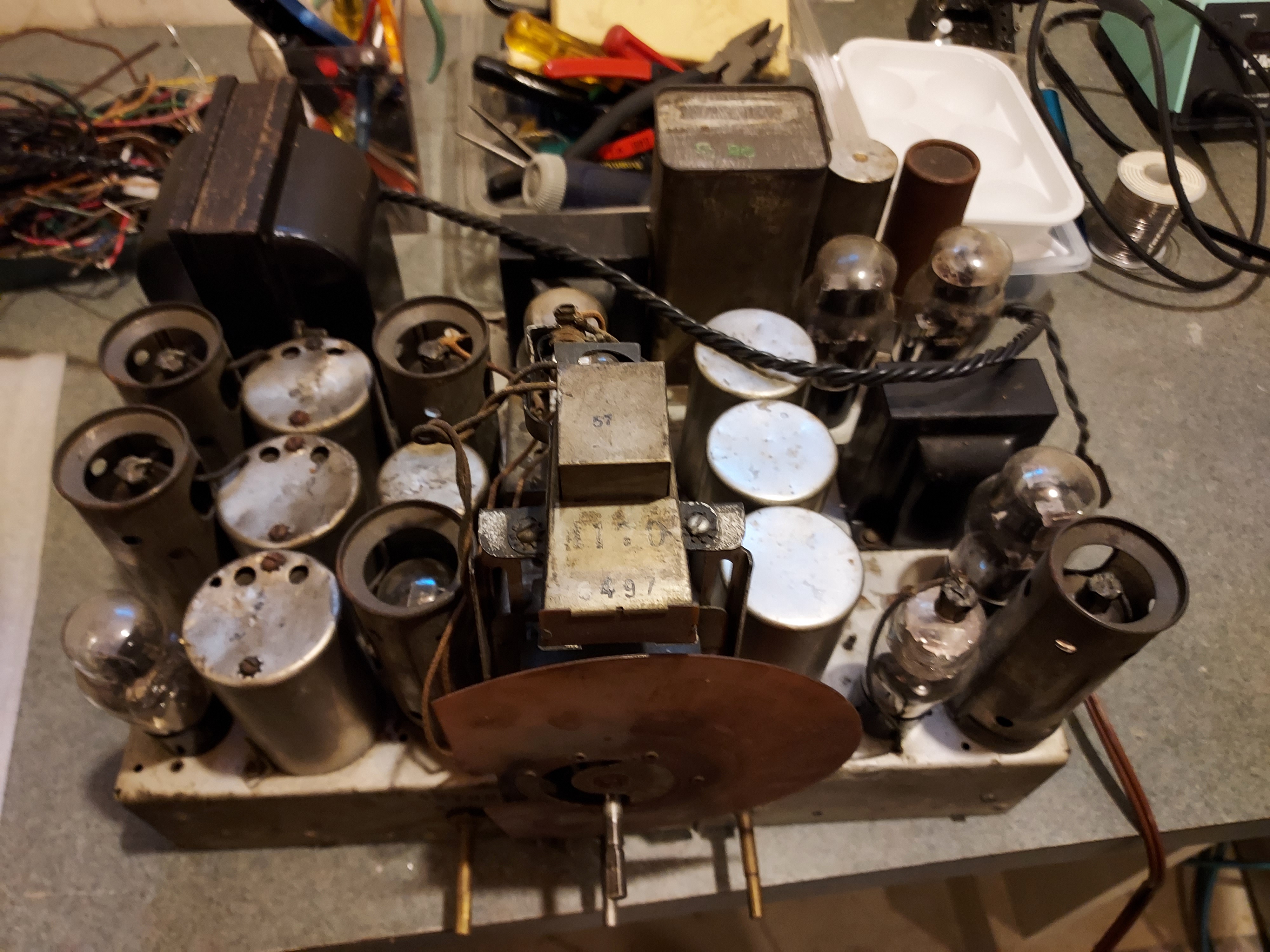

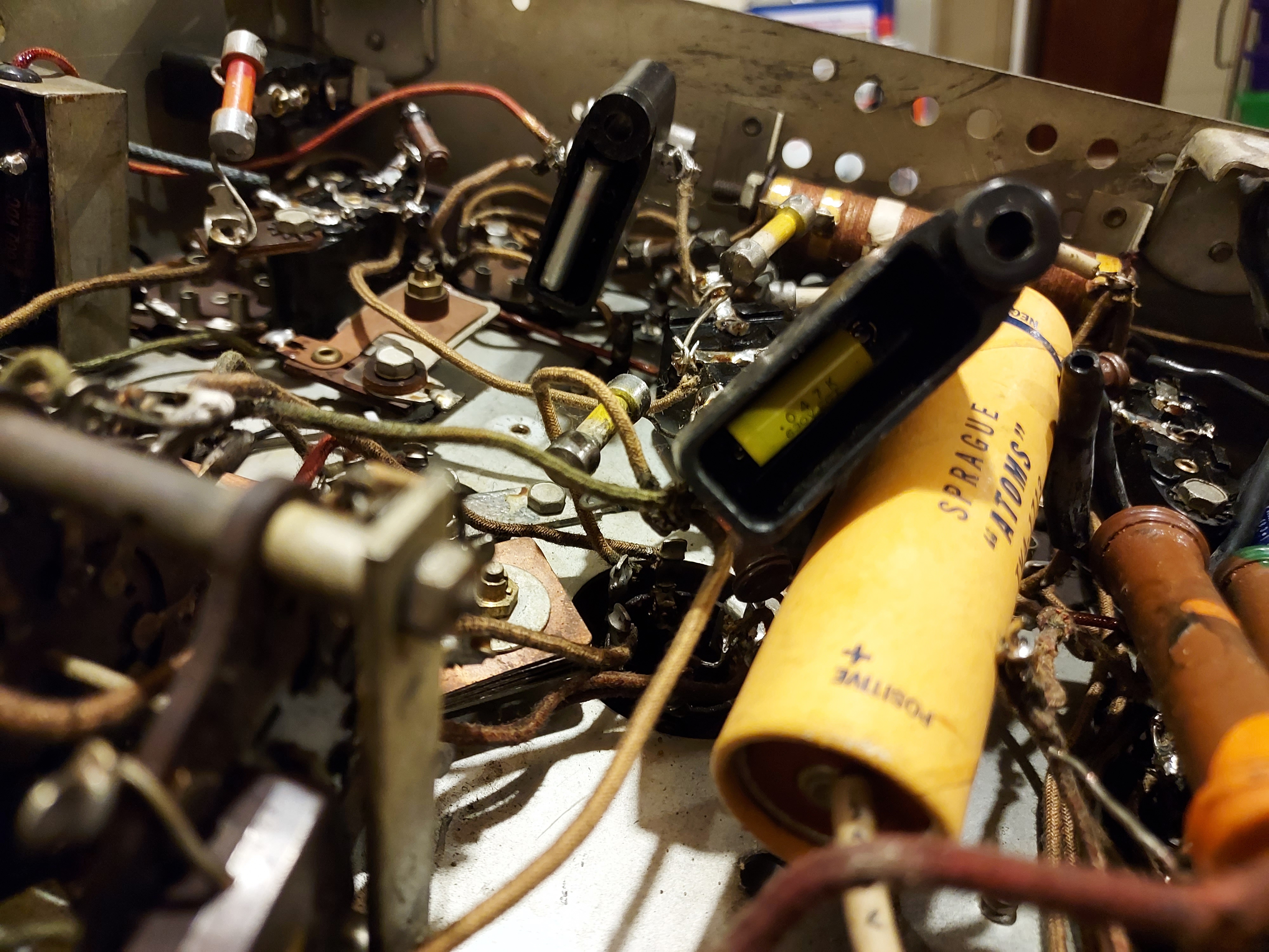

The chassis

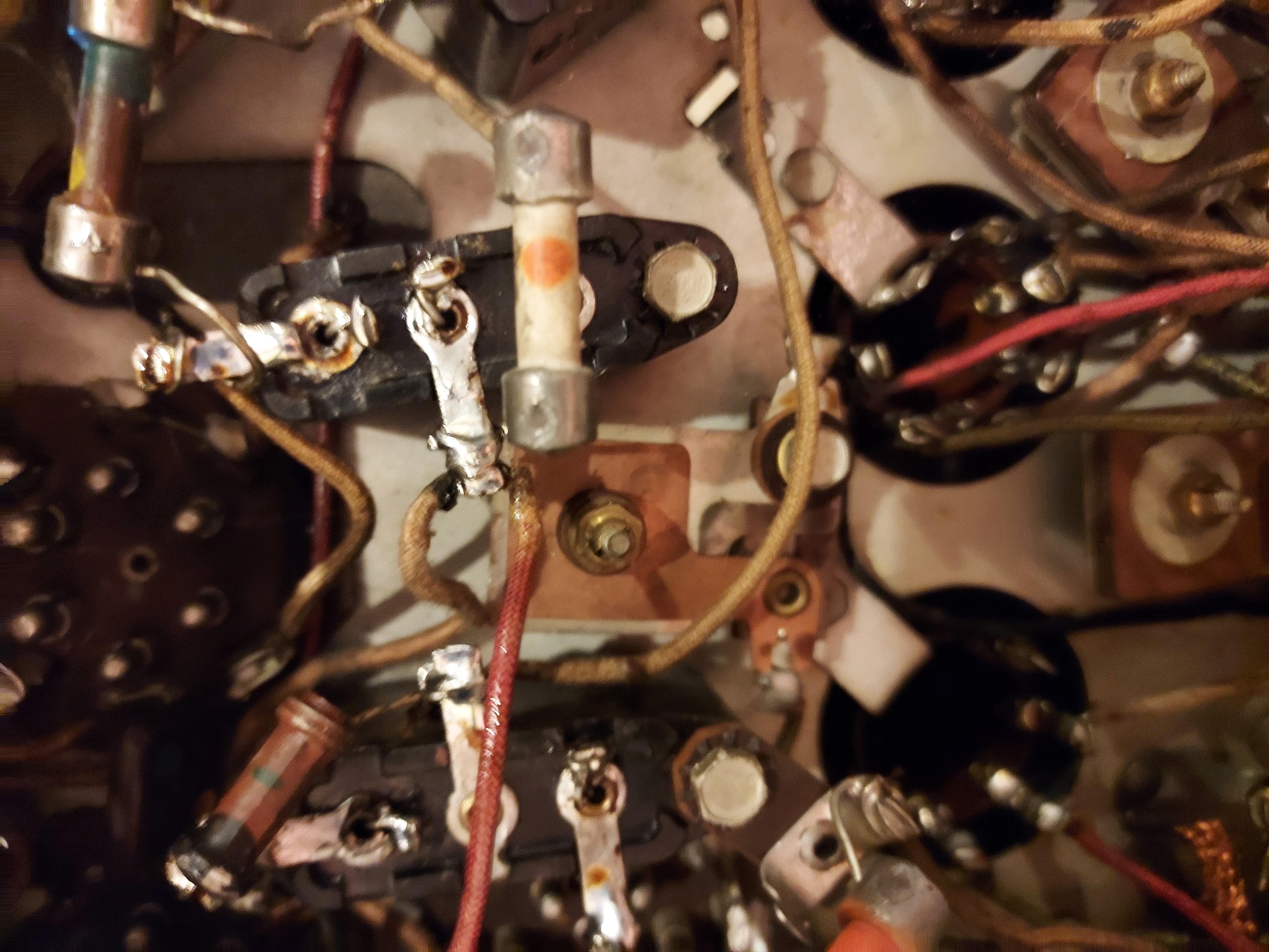

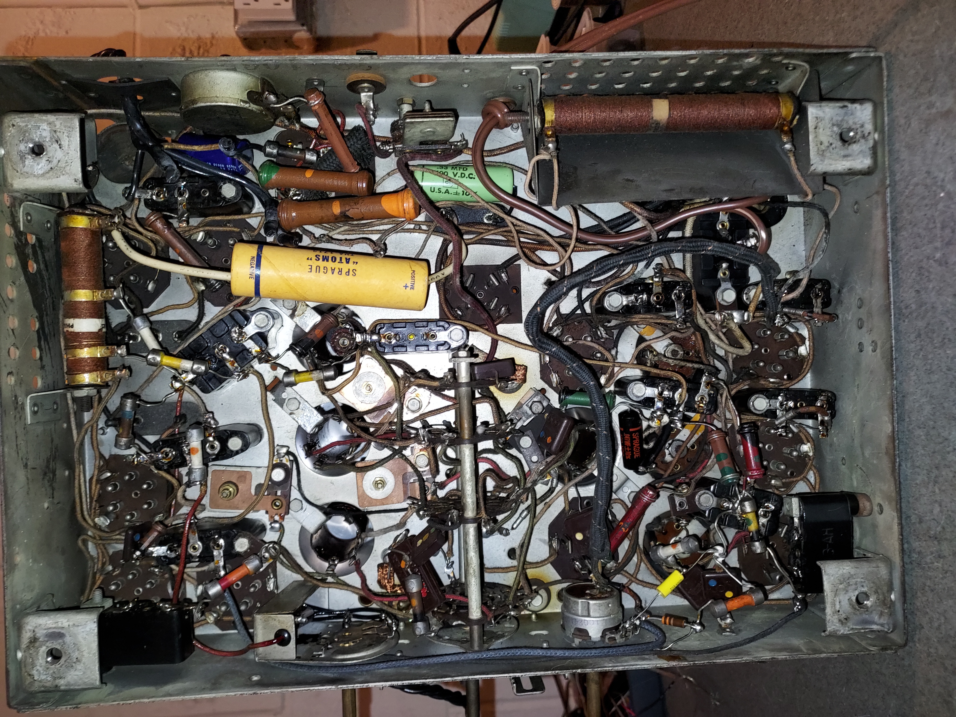

The restuffing is done with various type caps
Yellow tubular
And some film type I do not use.
Why not? Well, the pins seem to protrude through the body. You could see a lighter spec (could not focus) at the lower end of the cap. It is the pin going through. Has it been any closer to the chassis (the blocks are raised on that cylindrical bushing), this would touch the chassis. I have not looked what cap it is and what voltage is there on taht pin, though I think it is likely OK, so I will check the value and probably leave it be if it is what it should be.
Overall this is how a fragment of the job looks, a close-up.

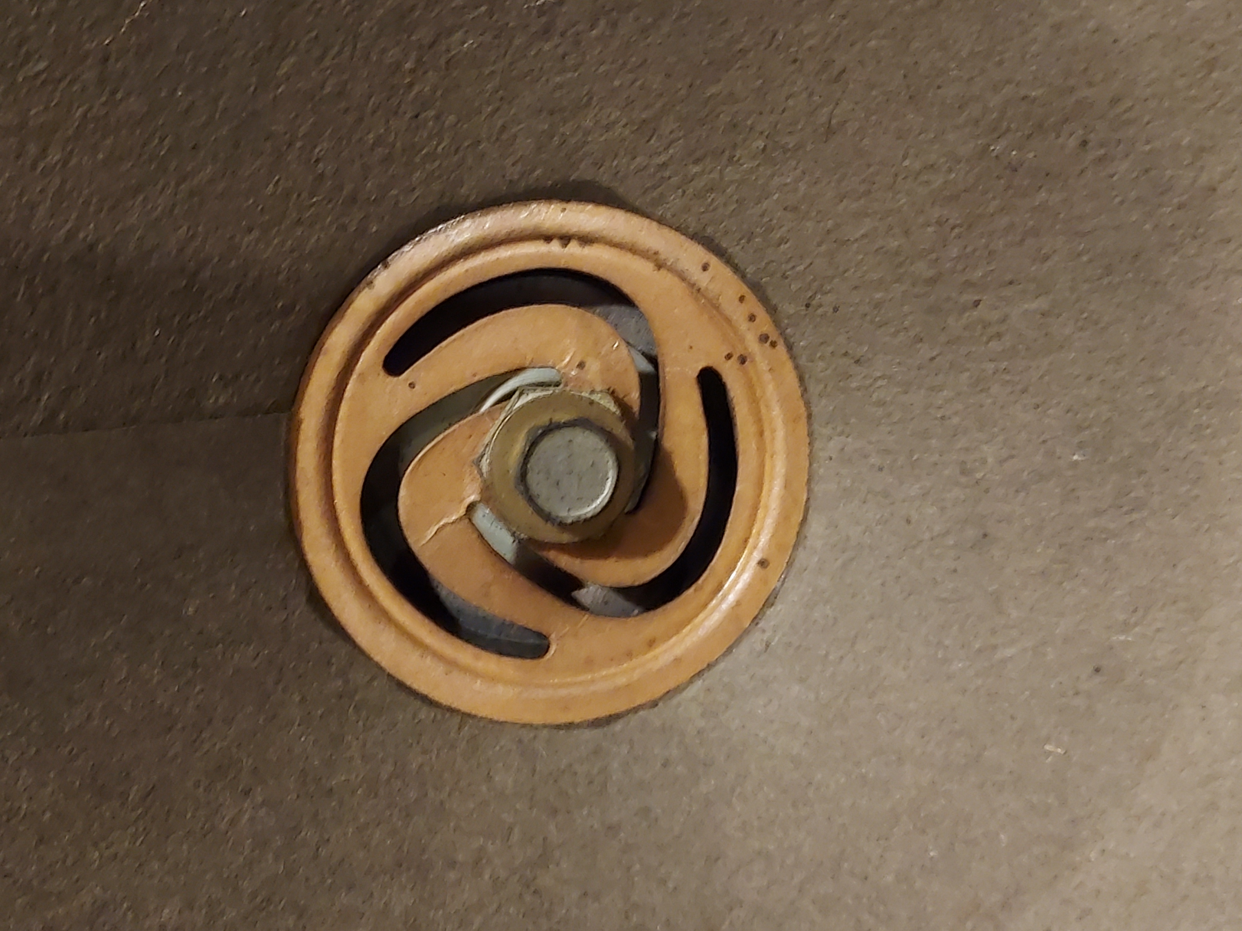

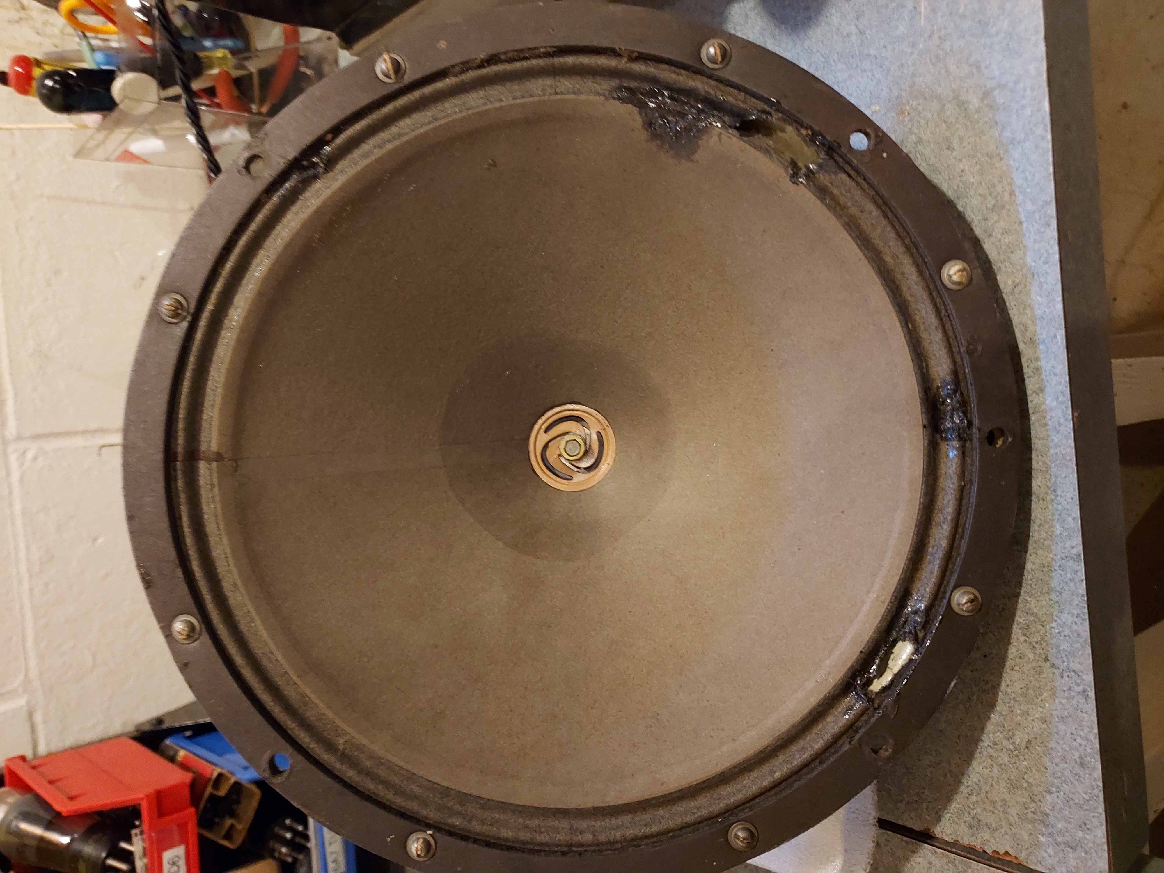

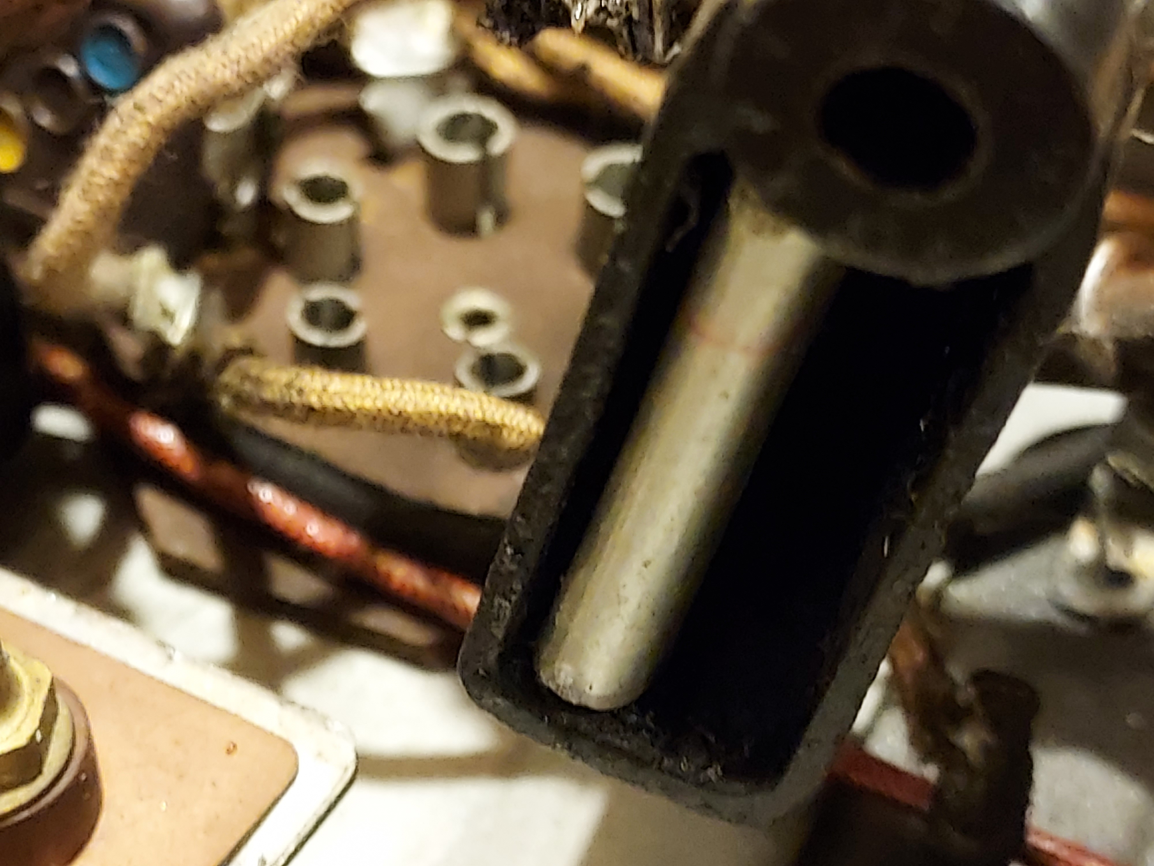

The speaker has things to be considered. Two larger holes, on the rippled part, that have been covered with what is probably a rubber cement to keep the edges from further rotting. It actually might play OK. I will think if i need to patch them or leave them, or even re-cone.
Speaking of the recone, the previous problem alone might've not make me think of it, but the spider has cracks. They are not break-offs with full separation, but cracks nevertheless, so if I play that, I am not sure how long this would hold, or if it is affecting the sound already.
I have also checked the tubes, all are excellent except one 76 tube, which is less than 50%. Luckily I have a couple, both are very strong.

That Sprague "atoms" cap reminds me of some caps that were around when I was a kid in the 60's. It's a little hard to tell from the pic but the ones that were about 1 1/2" x 4" long were 100mfd at 450v. A little over kill for your 16B.

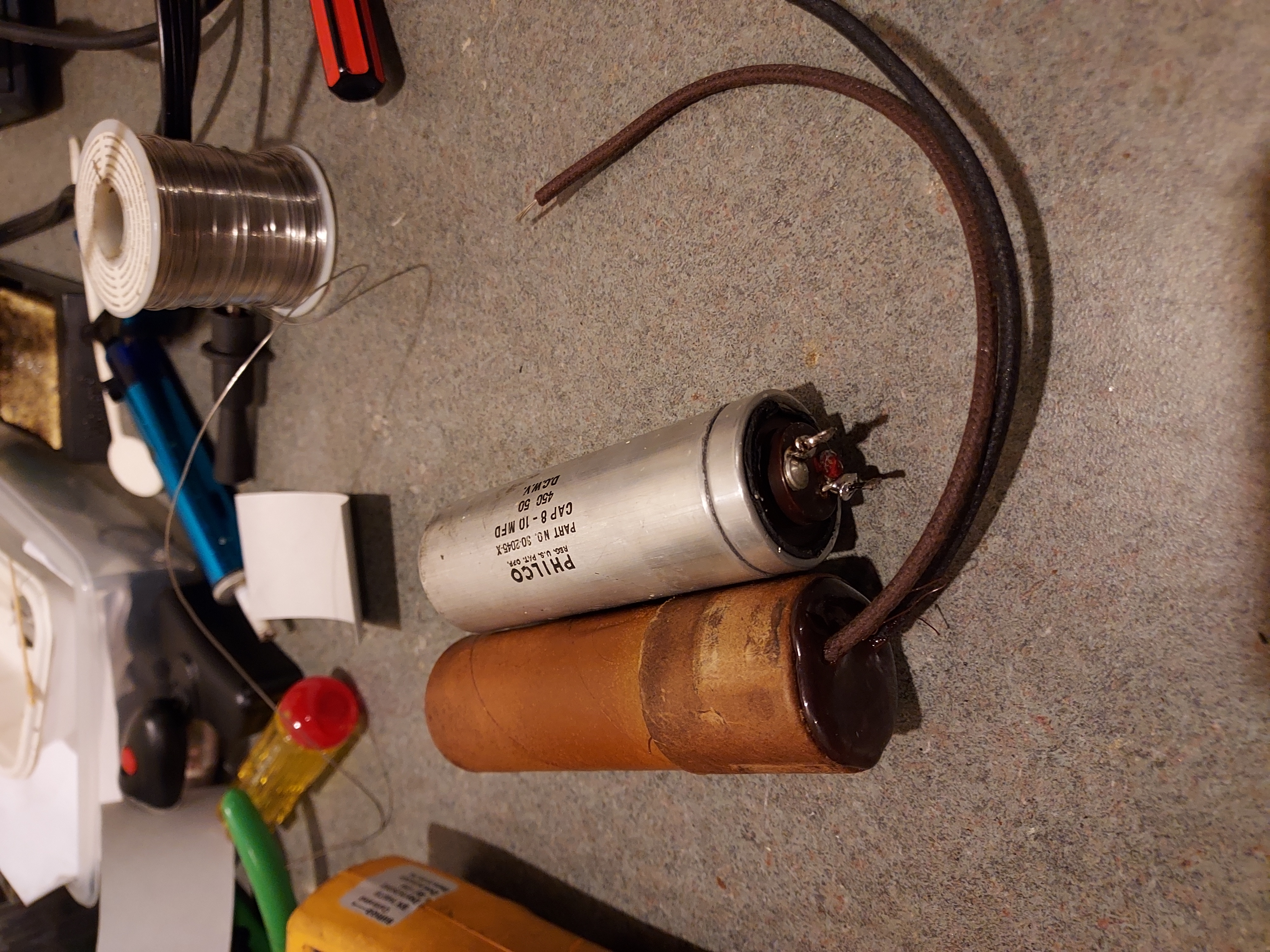

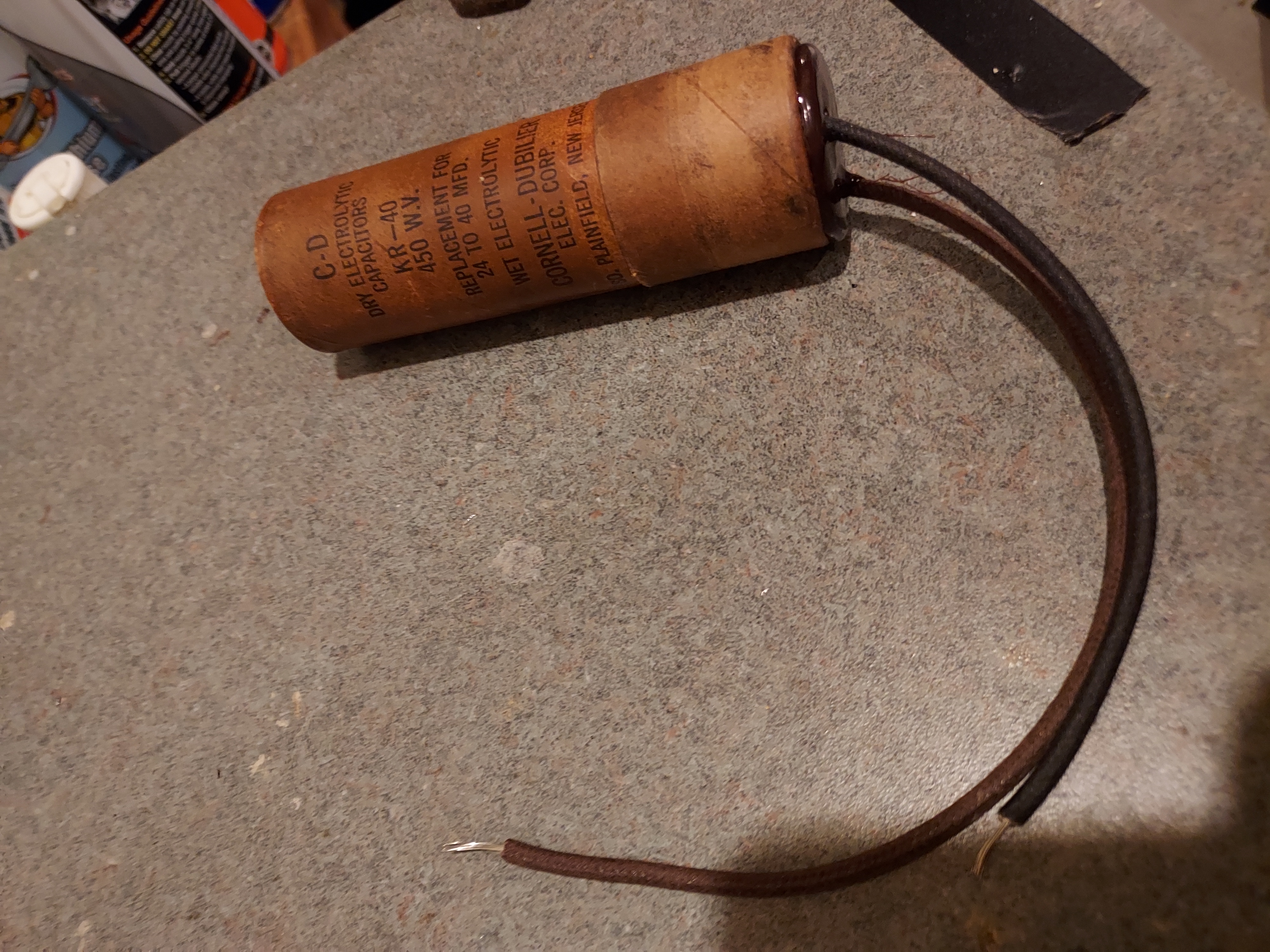

There are two tubular electrolytics.
One is a dual, a Philco cap, 10uF and 8uF replacement type. Surprisingly it showed 10uF and 10uF on both halves. Not an original one, I think.
The other is a Cornell cardboard shell one. I decided it looks age-appropriate.
The 10+10uF was actually used, probably as the Ground to Centertap cap. I have not found the original one that is supposed to be used for it.
So I decided `to make the dual one to be the rectifier and the filter caps; the first would be a Solen 8.2uF and the other 22uF 450V, a high ripple type so it lasts forever.
And the cardboard I made into the missing 10uF Centertap-to-GND cap.

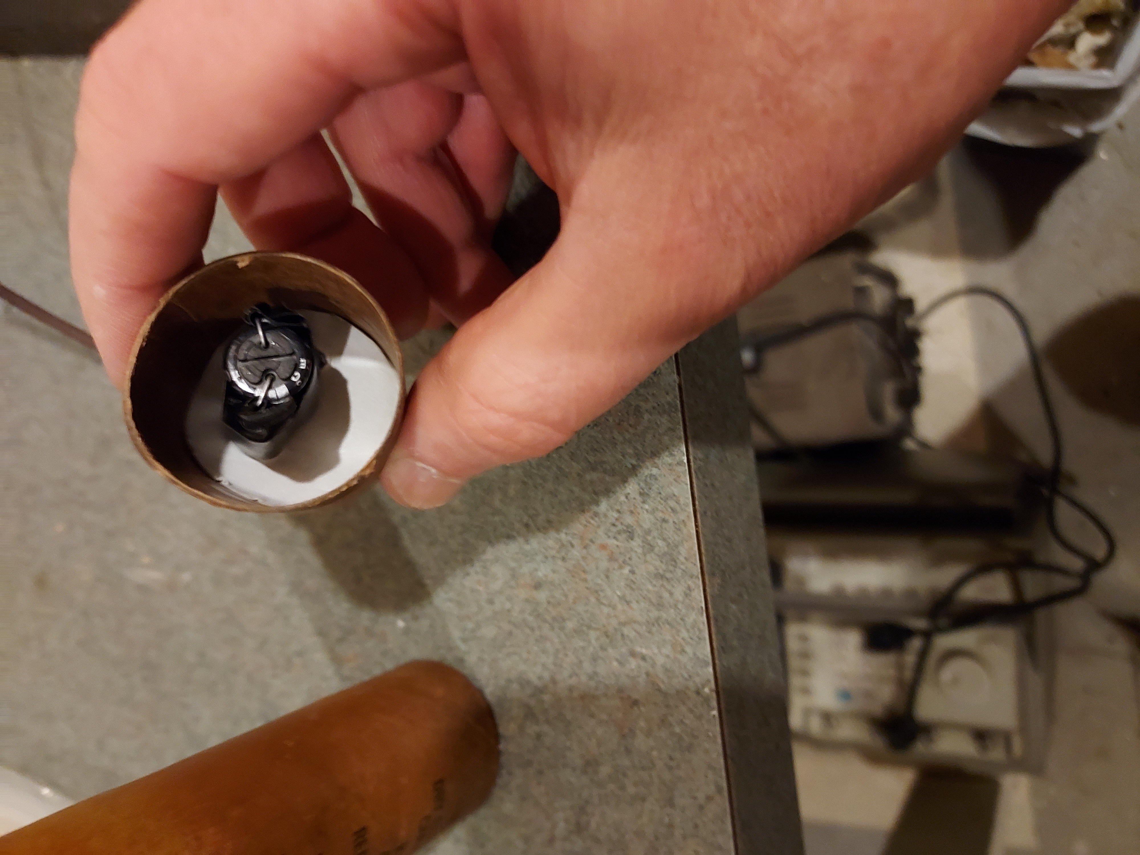

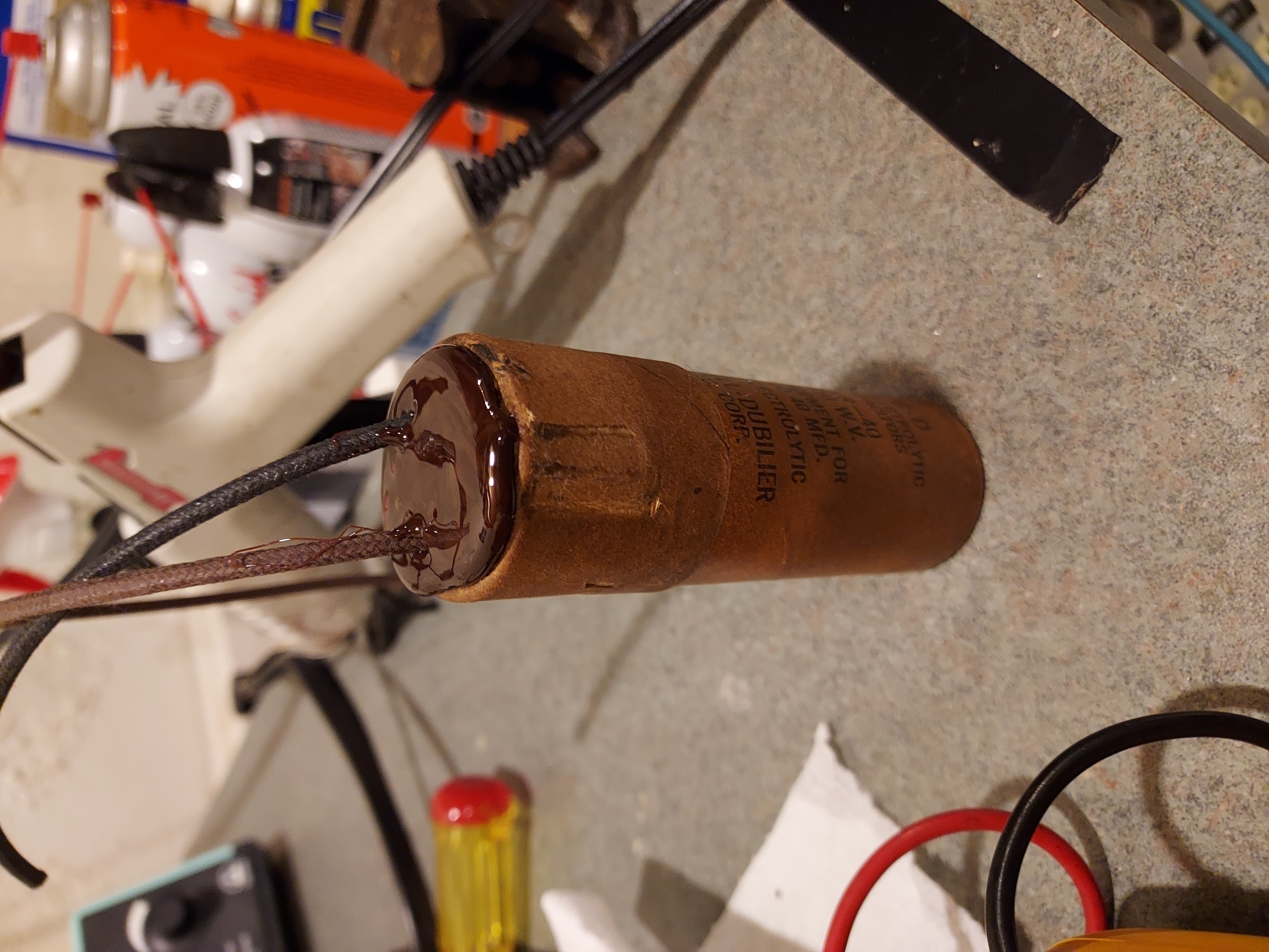

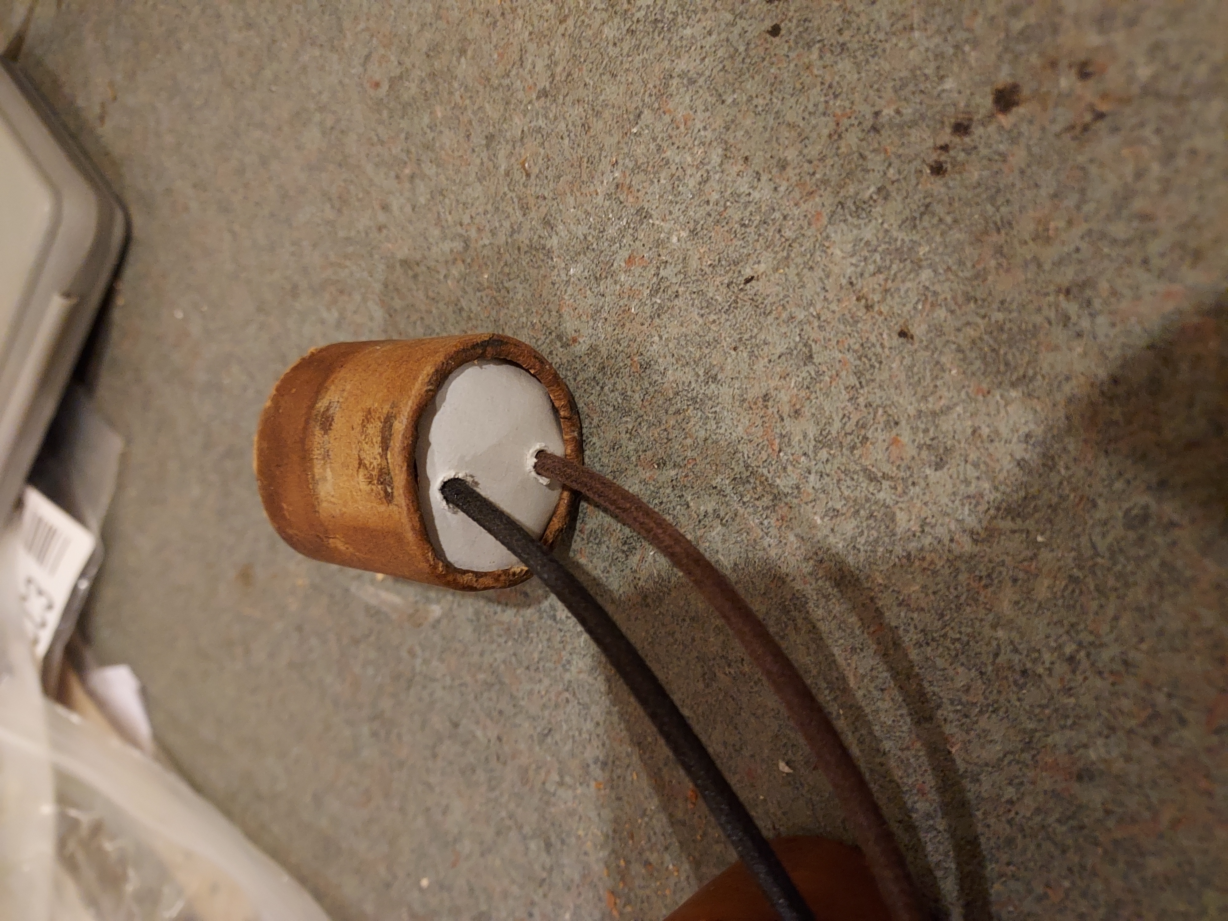

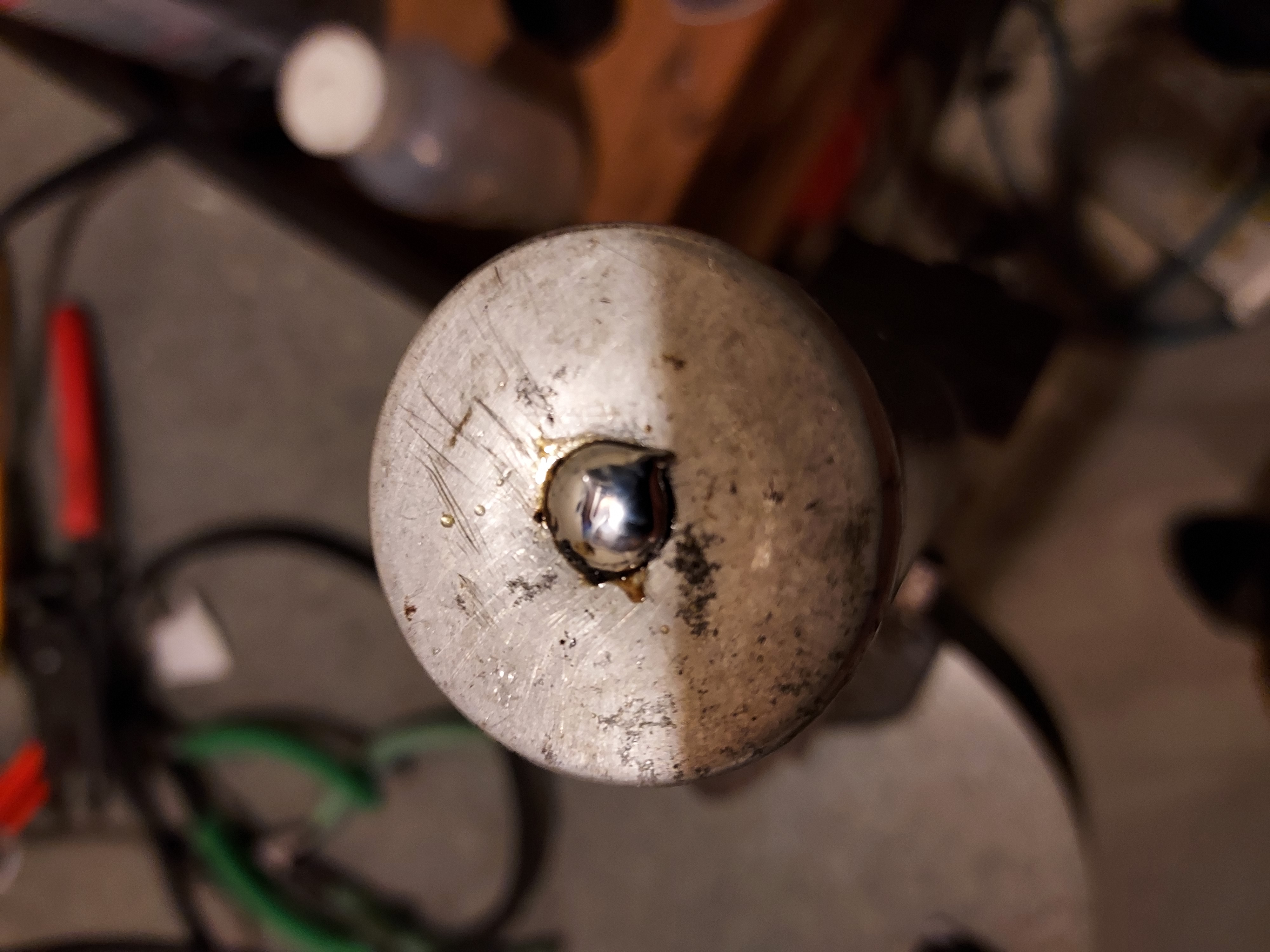

So yesterday I started gutting the cardboard one. I remember failing a few years ago in doing so, as I could never extract the core, and in trying to break the top layer of whatever that is, a brittle potting compound, I destroyed the shell.

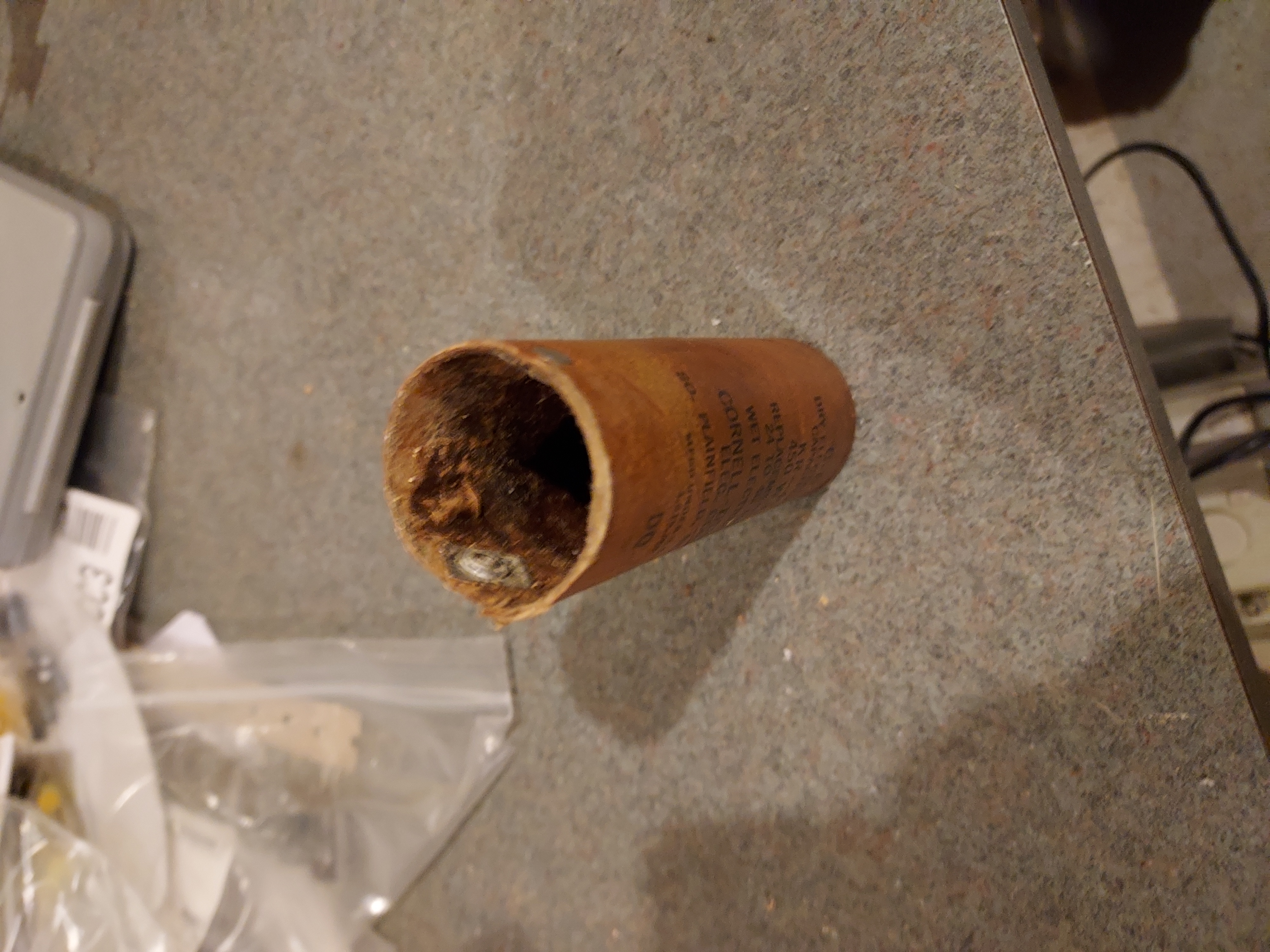

So this time I chipped at the top layer with a small chiesel, it was like 5/16" thick, and successfully got to the softer core. I then tried to use a corkscrew to extract it, with no success. Then I used heat and then the corkscrew, also with no success, no matter the effort.
So how did I do it, you ask? Well, I soaked the cap in mineral spirits for a day. Then I tried the corkscrew, again unsuccessfully, and then I decided to use the heat gun again, and this time the soaked and heated core came out without much effort.
So this is what you do: remove the top hard potting compoundm soak the cap in mineral spirits overnight and with some (not even much) heat use a corkscrew to gut it.

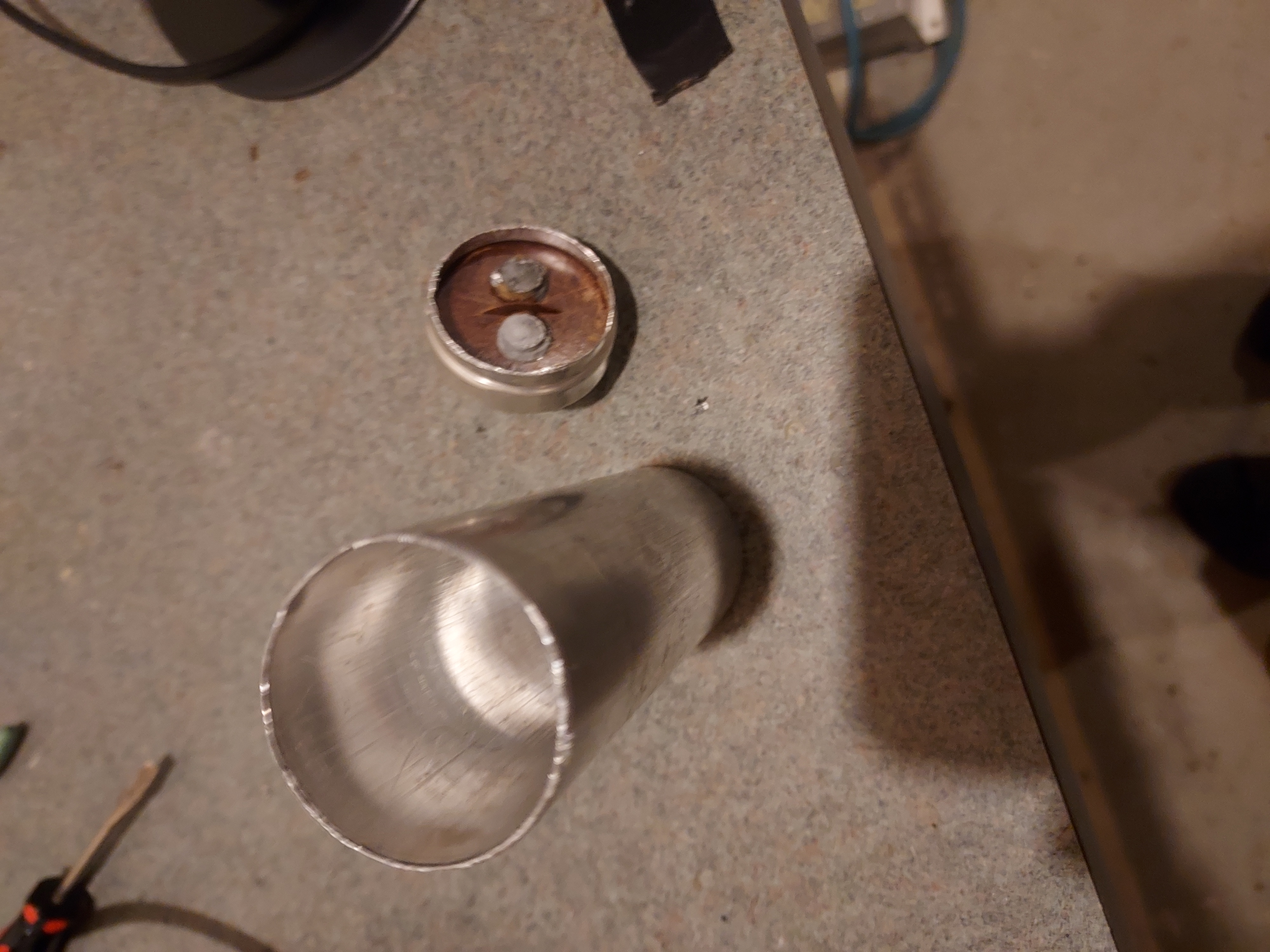

Then I quickly cleaned the interior of the remnants of that hard tar at the bottom, cleaned it with mineral spirits, and then I did what the photos below show.
The shell is gutted.
Fishpaper bottom is made and the wired cvap is inserted.
The cap's wires are potted inside and the bottom is potted outside.
The aluminum cap's shell is meantime being soaked in vinegar to remove all salts that are left. This one gutted very easily.

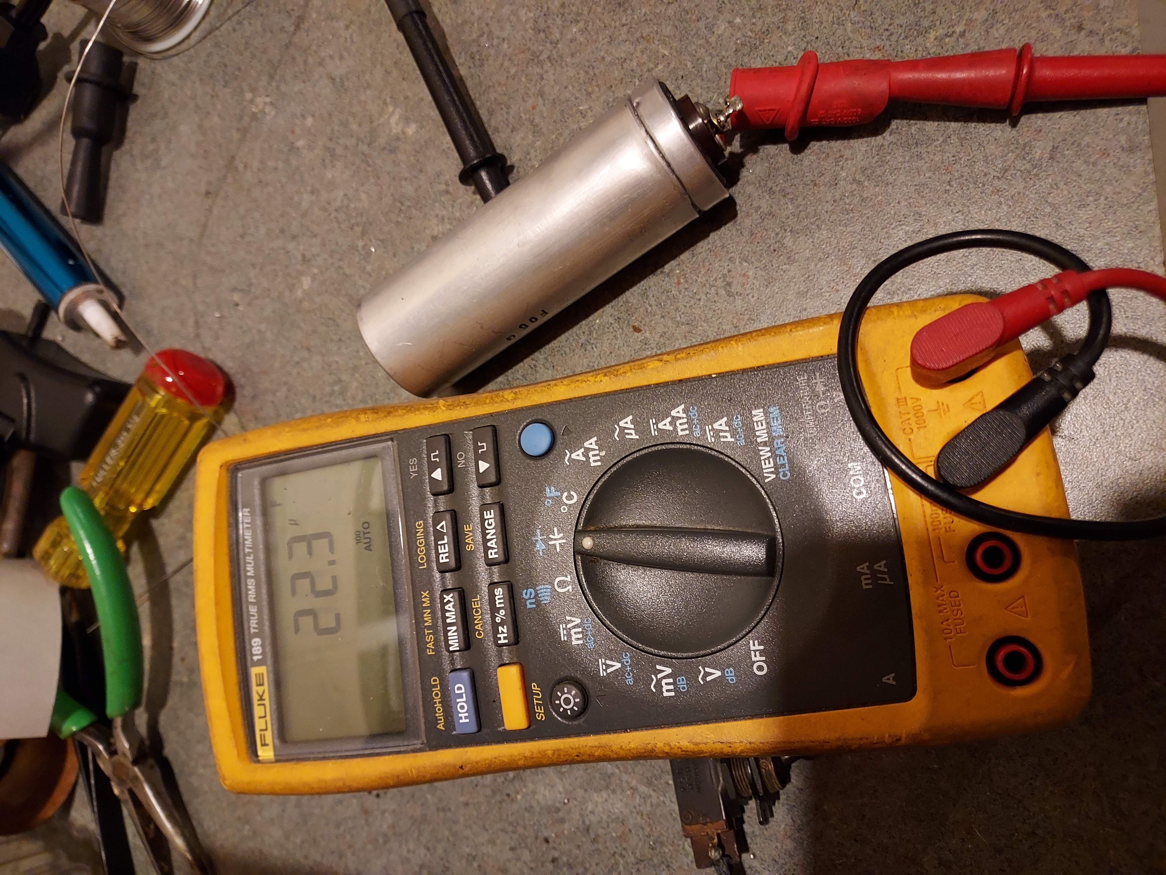

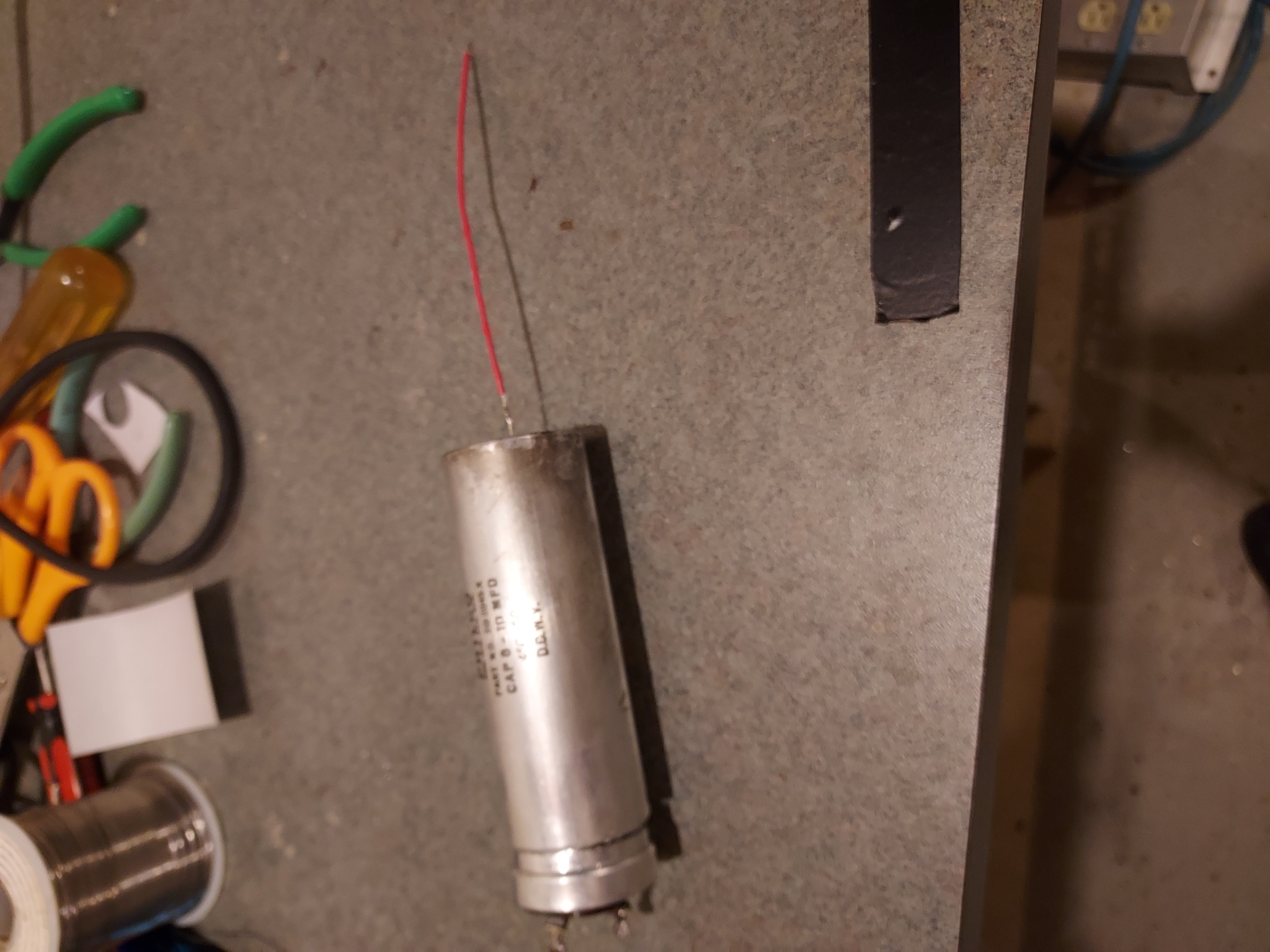

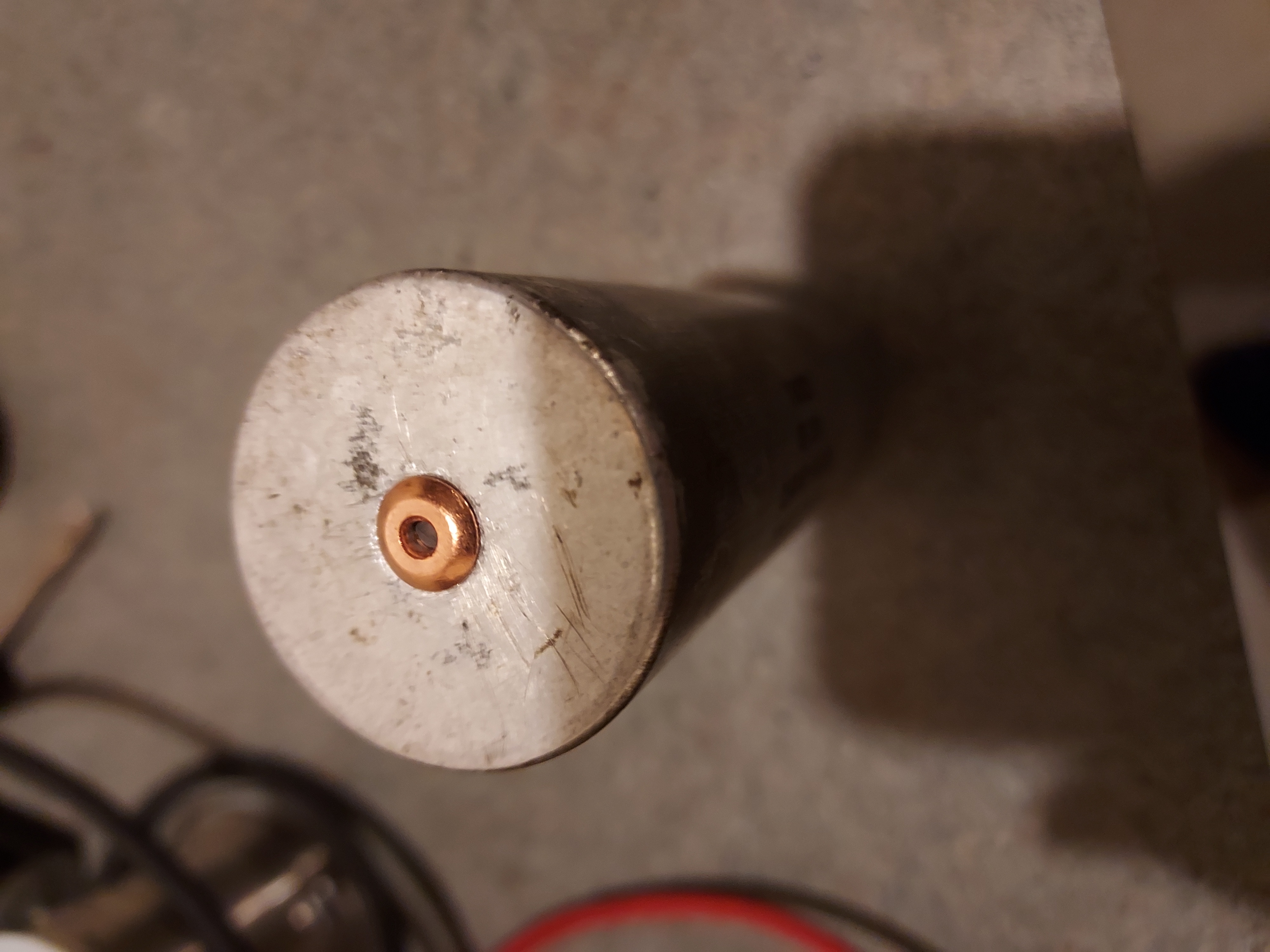

Then I took the aluminum cap from vinegarv bath. It clean it remarkably well. Rinse with water, dry.
Also the top, where there was the rubber plug, is fitted with a copper rivet to accomodate the common minus wire.

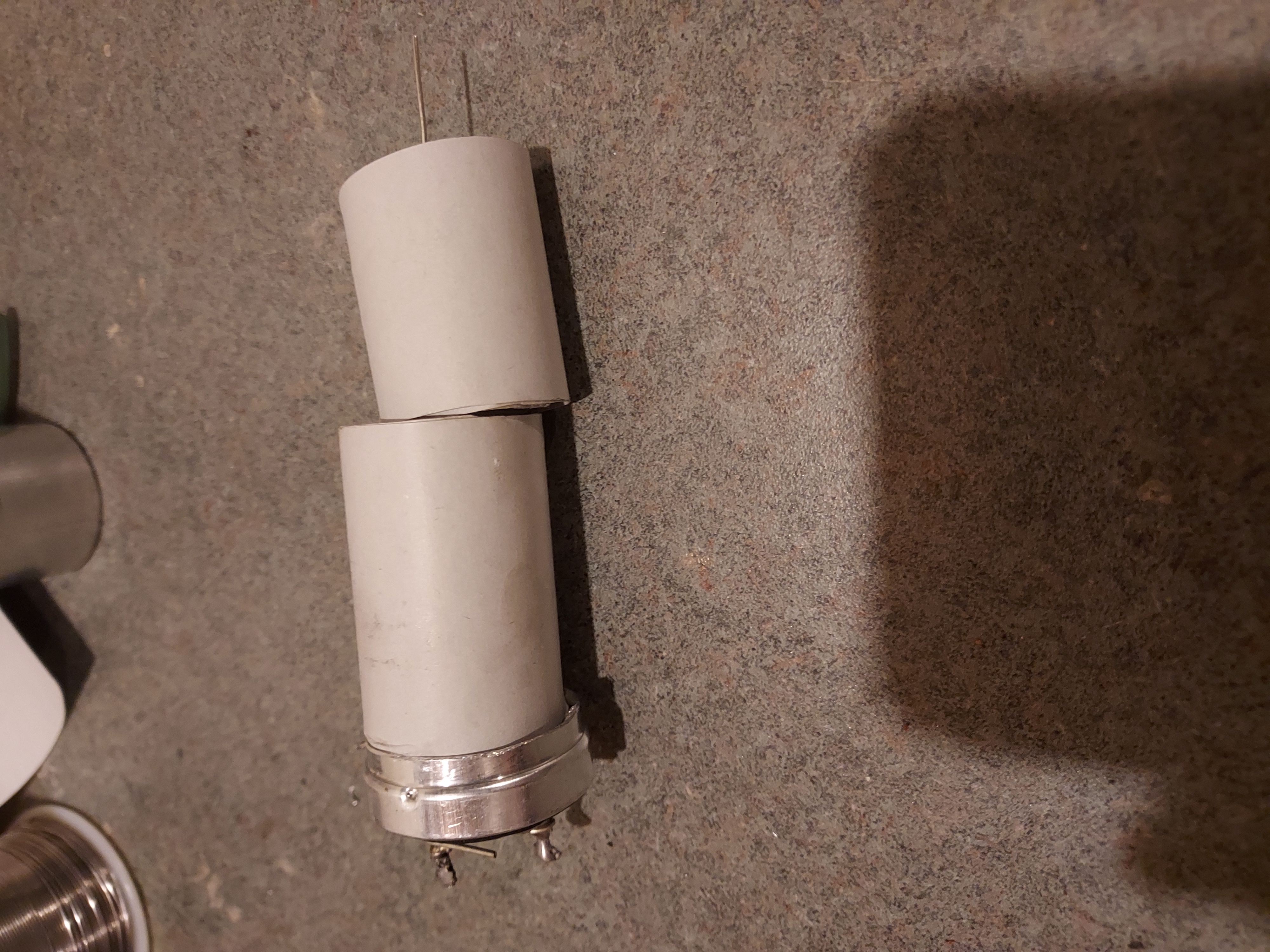

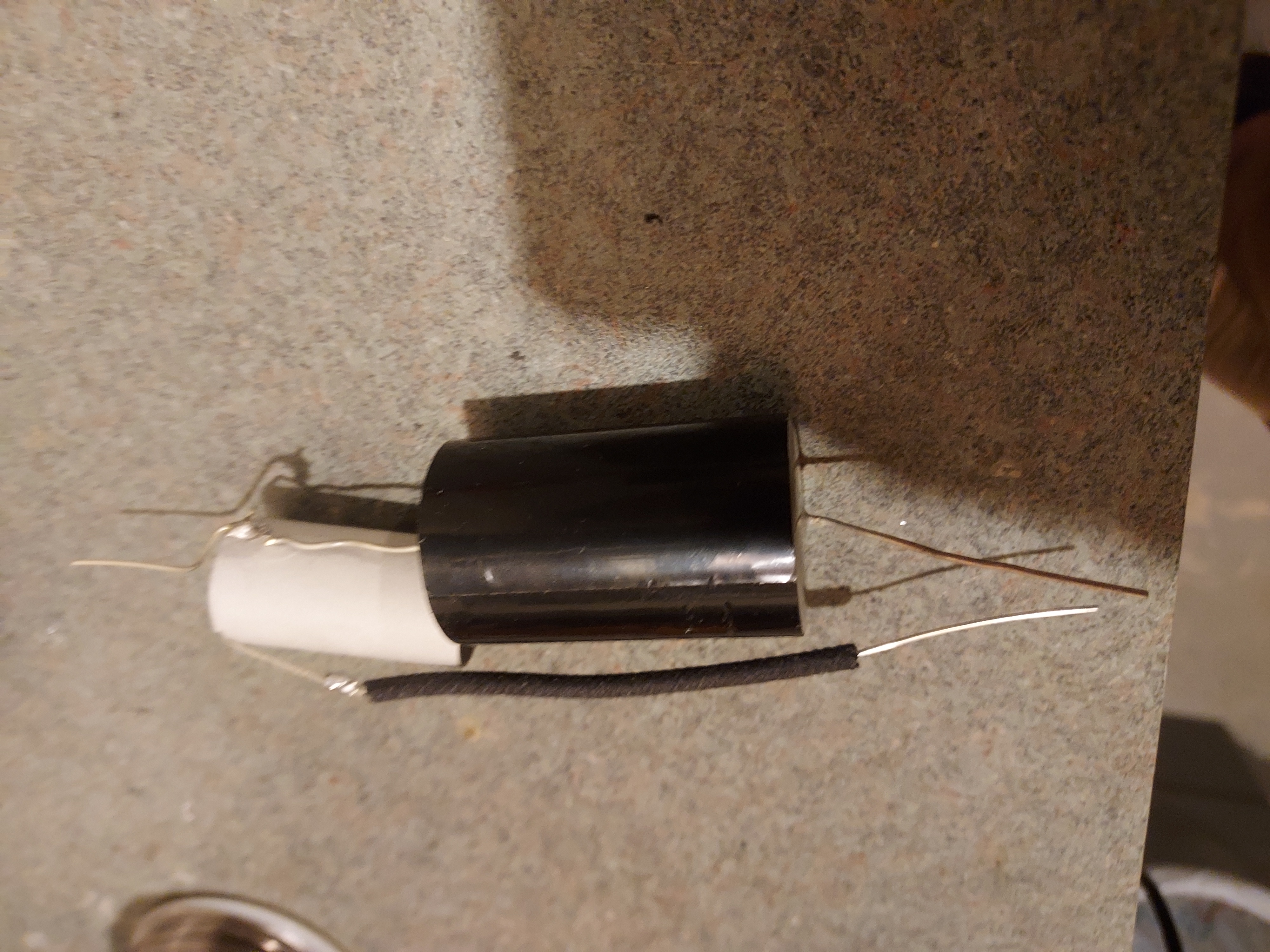

Then make the stuffing. An 8uF Solen cap with a 22uF hi-ripple 450V Panasonic cap on top. The 22uF is wrapped in fish paper so that it keeps the wires from touching close to aluminum shell etc.
The common minus is sticking up and will go through the center of the top of the can.
Then the Solen is also wrapped in fish paper to keep the positive wire from the 22uF cap from touching the aluminum.
It is done separately as the electrolytic cap is excentric towards the film cap, and its diameter is larger than the radious of the Solen, and so the resulting common wrap would not fit in the aluminum shell.
This way it does. The paper wrappings are secured with fabric glue and are reliably keeping the bare wires and the solder joints insulated.
The common minus obviously was hard to aim to go through the rivet, so all it took was soldering lead wire to it, long enough so it could be easily aimed at the rivet hole, and then the rest just followed, even without pulling the lead wire.
After glueing the case together, the terminals and the common minus were soldered.

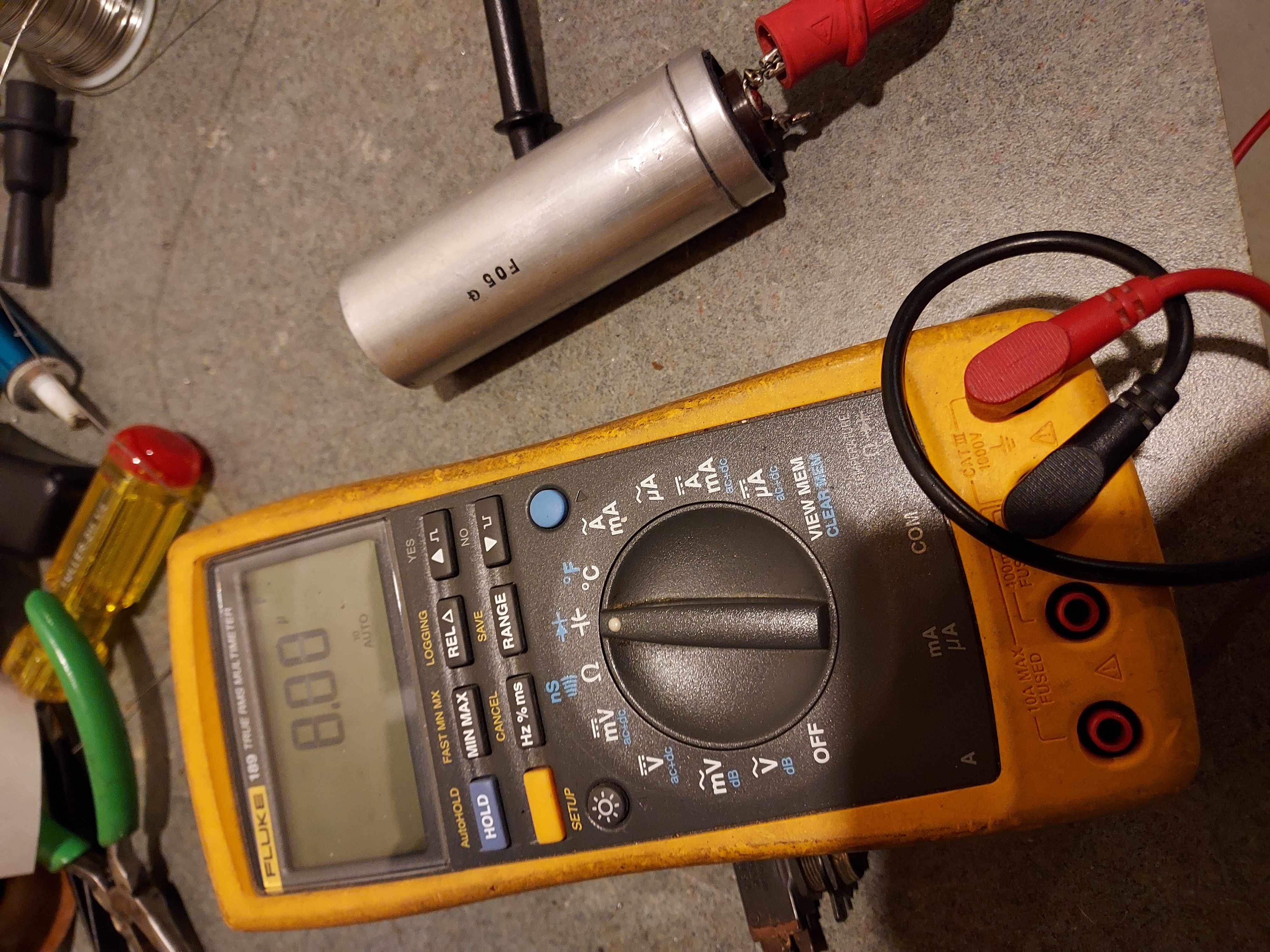

Here's the common minus. It reliably makes the case the negative, so now it can be treated as was the original cap: using the lug slid under the cardboard shell touching the case and then clamped by the common dual clamp that holds the caps to the chassis.
The meter shows 8uf and 22uF.
The two caps together.

I am still thinking if I Ineed to fix the speaker cone and spider.
Also the toggle switch (interstation noise suppression) does not work, so I will have to either fix it or replace it.
Posts: 16,533
Threads: 573
I have just spoken to Rich Stamer; he indicated the spiders do not get repaired and a full re-cone would be what he would do. He keeps the voice coil impedance, but itself it also gets changed.
I looked at the cone again (well, there is a pretty detailed photo here up in the beginning of the thread): it has a few tears loosely smeared with cement, and the spider, to me, has to be replaced: I do not see a good way of repairing cracks in cardboard.
So I think I will send it out for a full re-cone.
