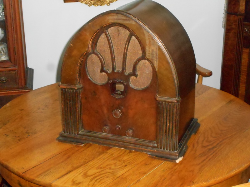

  I just picked up a Philco model 90, and have not had a chance to get into the chassis yet.
 Does this model have the dreaded capacitor blocks?

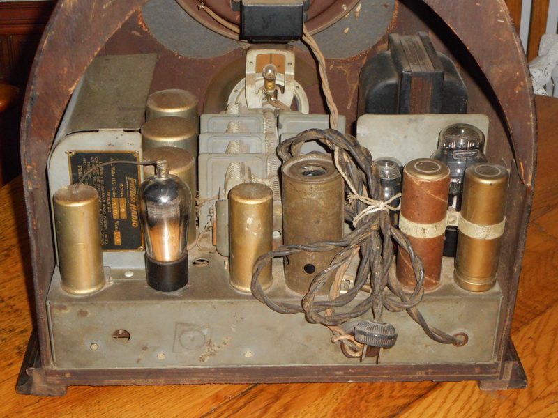

Pretty sure it does unless they make them different in CA than in the US. Whats to dread? It's no big deal.
...and you have the original looking electrolytics in the back! And the tube shields, that's a plus. Also the power cord and plug. Stuff that often goes missing...the bakelite condensers are half the fun! no problem. Just heat them up a little, push the contents down with a stiff wire, then take out the screw and finish the job. You may have to unsolder a wire or two, but not always.

Nice unit, like the way the Canadians put the metal plate label instead of paper, and the aged gold tone on coil shields. Identify all the cap blocks and if any have a resistor like the 70, try to preserve it as it is probably a hand wire wrap resistor - keeps it a bit more original.
That looks to me like the long term effects of nicotine. The original owner may have been a heavy smoker.
Thanks for the  positive  comments.  This one will be a winter project. i probably will have to replace the cord as it is sort of brittle.
