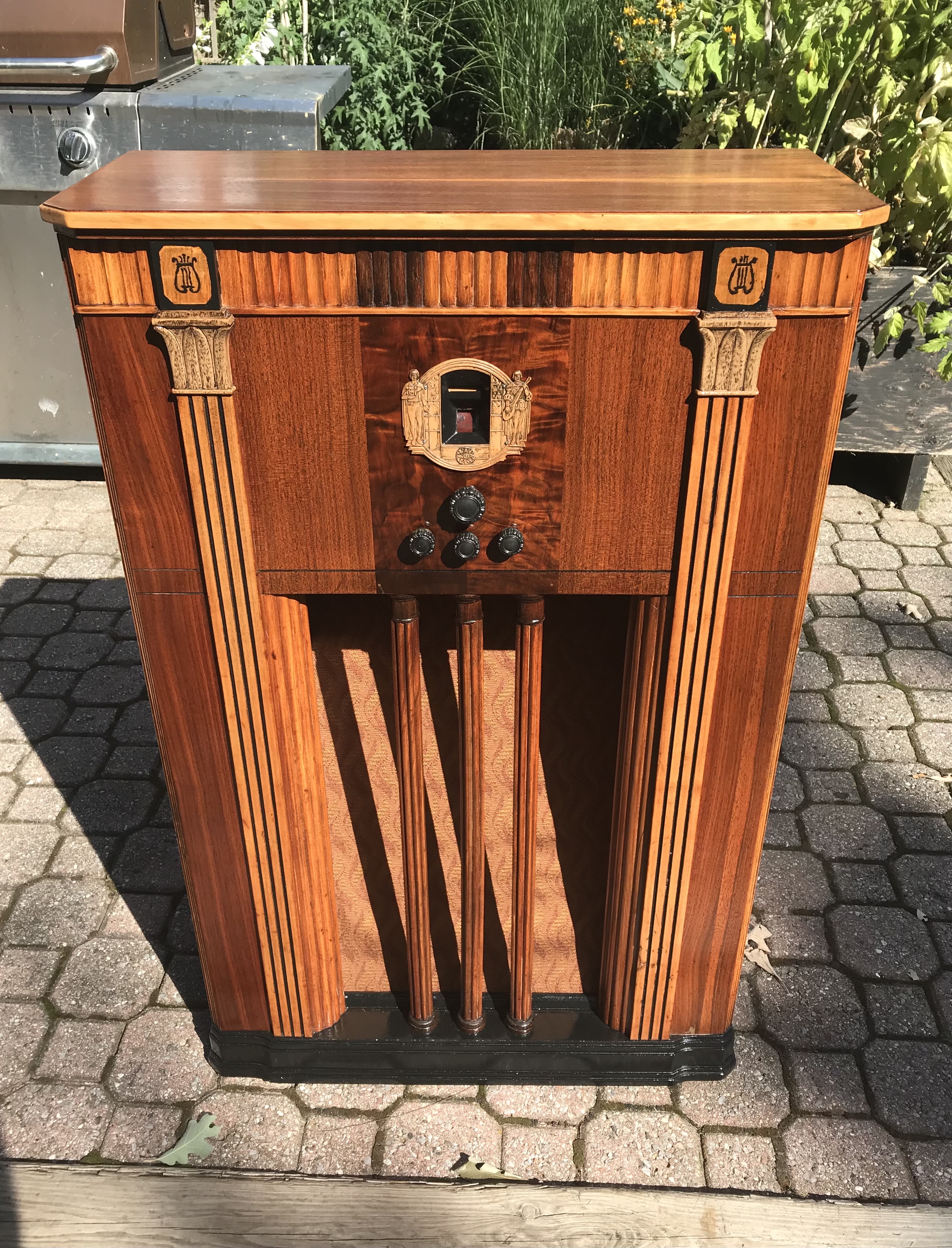

I ended up rewinding both the detector coil, 14 turns and the oscillator coil which was 27 turns. That was the best estimate my eyes could figure out. Glad I did a count before I tried to unwind them because the wires were broken in quite a few places. I used 32g wire for both coils and everything worked out well! The radio plays great and just waiting for some dial cord to complete the radio.
Thanks for all the much needed help and advice!
Glad to hear you got it sorted and working well. Some would say those sets (89/19) are tougher than the average bear to fix. The mixer circuit tends to be problematic. But you nailed it.
Great looking radio! Take care and BE HEALTHY! Gary
