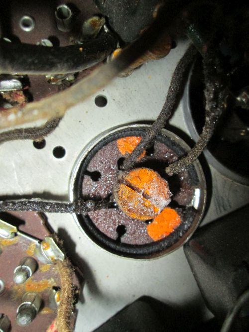

Earlier, in this post is a picture, of the underside of an IF Transformer. The wires are covered with what look like a crystalline substance. At present, I'm working on a Philco 118, and the bottom of both transformers, and their connecting wires are covered in this. Can someone tell me what it is? Thank you, in advance for your response.
Bees wax...
If it was PVC wire and sticky, it would be degradation of one of the ingredients in the plastic, if so that wire should be replaced as it will corrode copper..
Pliny the younger
