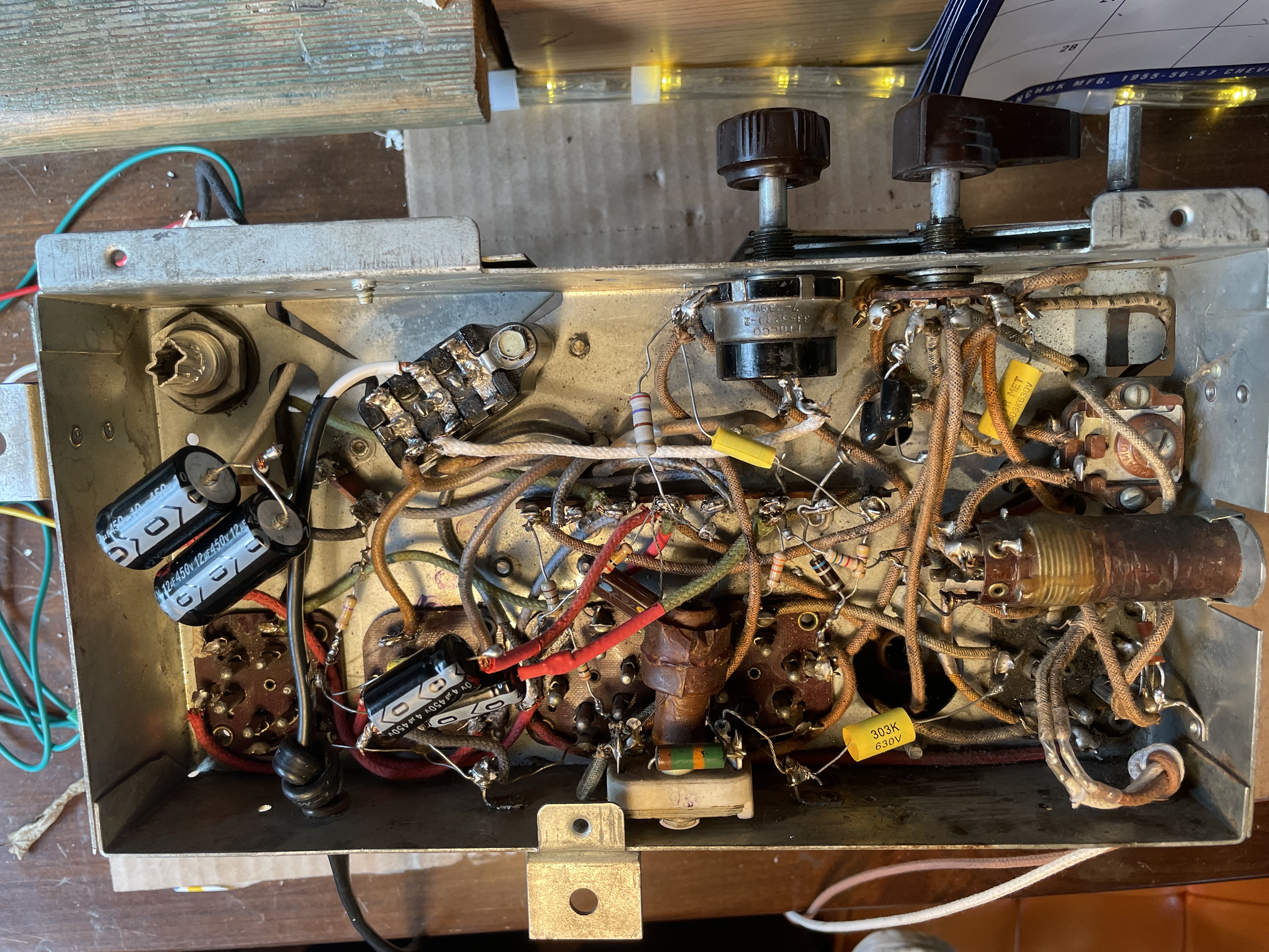

Hi Folks - I have a 38-15 that is giving me a bit of trouble.  I have done the regular things - I have recapped it and replaced out of tolerance resistors - checked the transformers and tubes.  On the schematic,  off of the volume control (part #20) one leg is connected to between a  250 ohm 1 w resistor  (p# 33) and a 70 ohm 1/2 watt resister (p # 34). Problem is that 250 ohm resistor keeps dying (i.e. burning hot then smoking)- way too much current through it. it is connected to the transformer (p#36) center tap of the secondary winding.  I also am getting no sound from the speaker.    Attached is a photo of my work so far. I have been mindful of the polarity of the 10 and 12 uf electro caps in part # 31.  Any ideas? -- Andy

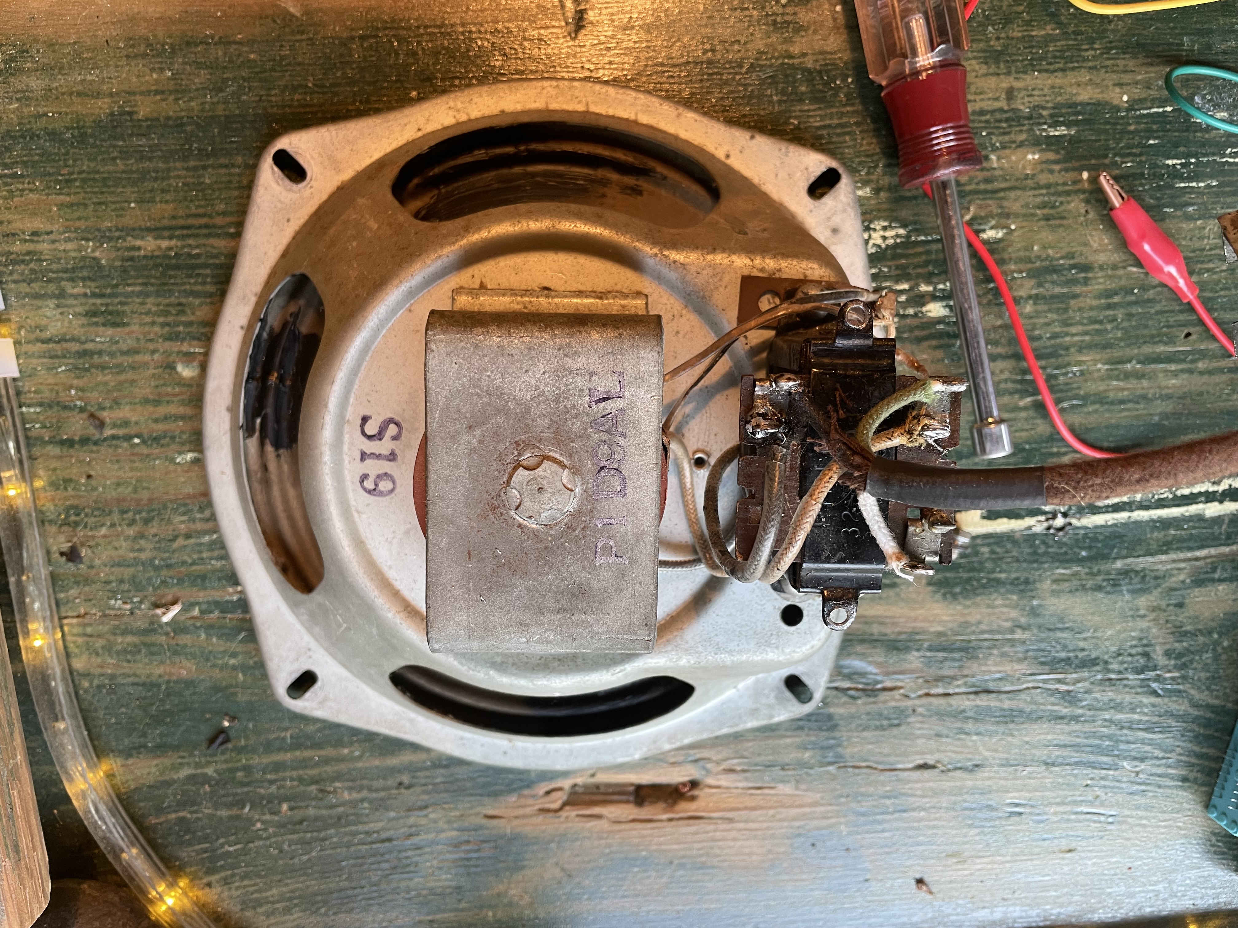

What is making that plate voltage on the 41 output run so high?  If there is hum from the speaker, does that mean the output transformer is still ok?  This is a chairside - so the speaker is a S19 - In the below, the new green wire goes to field coil yellow new white to terminal on the output transformer (now I am thinking this may be wrong given my issue with the excessive voltage on 41's plate) and new black to the black from the field coil.  -- Andy

Glad you got it working. Infortunately, the speaker wiring colors don't match the schematic. Based on your pic, the white should go to the 41 plate. The Green appears to be the output of the filter, so should go to the main B+. The black wire should go to the 84 rectifier tube cathode. If the green and black are reversed, audio level will be lower, B+ and hum levels are likely to be higher.
When observing the OPT, not theat there are 3 connections. The OPT connections are on one side, the lone Field connection from the Rectifier Cathode is on the other side by itself. The connection that is only to the primary winding goes to the Output tube plate. The connection that is both the OPT Primary and has a field connection is the Radio B+ (Output tube screen, B+ to rest or radio). The connection on the other side of the transformer, for the field coil only, is from the cathode of the Rectifier.. Phasing of these connections is also important. If there is too much hum, it is possible that some of these connections were reversed. If the phase of the hum bucking coil or field coil are reversed, hum will be greater.

Thanks for the info on the output transformer connections.  I did have the output tube 41 screen connection wrong - fixed that and now hum is further reduced and all my Pandora stations are sounding great ( via my AM transmitter!)  here is a LINK to it playing on the Philco Facebook site.  -- Andy
