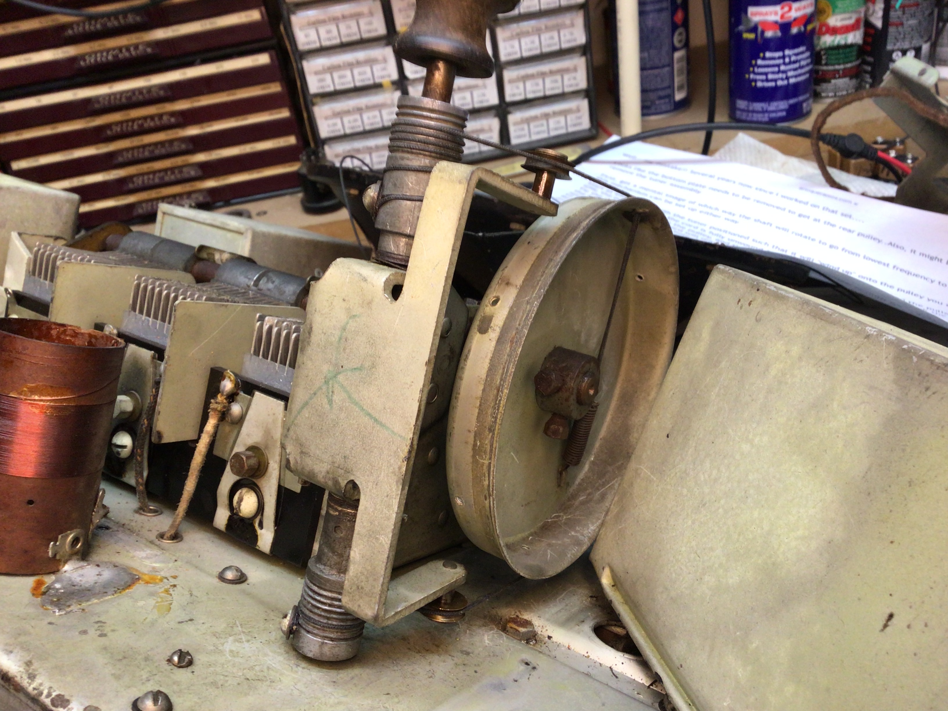

Hi all, won this Majestic about a month ago at a local auction and just getting started on it. Right now to begin
with I am in need of a dial string diagram as the original is broke. The tuning condenser being very stiff to turn I’m sure is what caused it to break! Thanks

Thanks John. I have removed the cover over the tuner and it looks good except maybe for some rust. I’m going to try and remove the rotor and clean up the rust and lube the bearings but that will require some disassembly of other things on the chassis first. For a table top radio man this thing is crazy heavy!

Thanks John. I have the Sams dial string layout book on DVD along with schematics but since Sams didn’t start until around 1947 +/-, my 1931 Majestic isn’t there. I did make some progress on loosening up the tuner so I believe I’ll be good to go.

Well success! It took some trial and error attempts to get this restrung correctly as there are a few different ways and directions to wrap the string around the two ends on the shaft. Probably will be awhile until I get started as I need to order some components and I think I may start on the cabinet first. Thanks John ( Eliot Ness ) for that link and BTW, that’s a gorgeous Strat you have there!

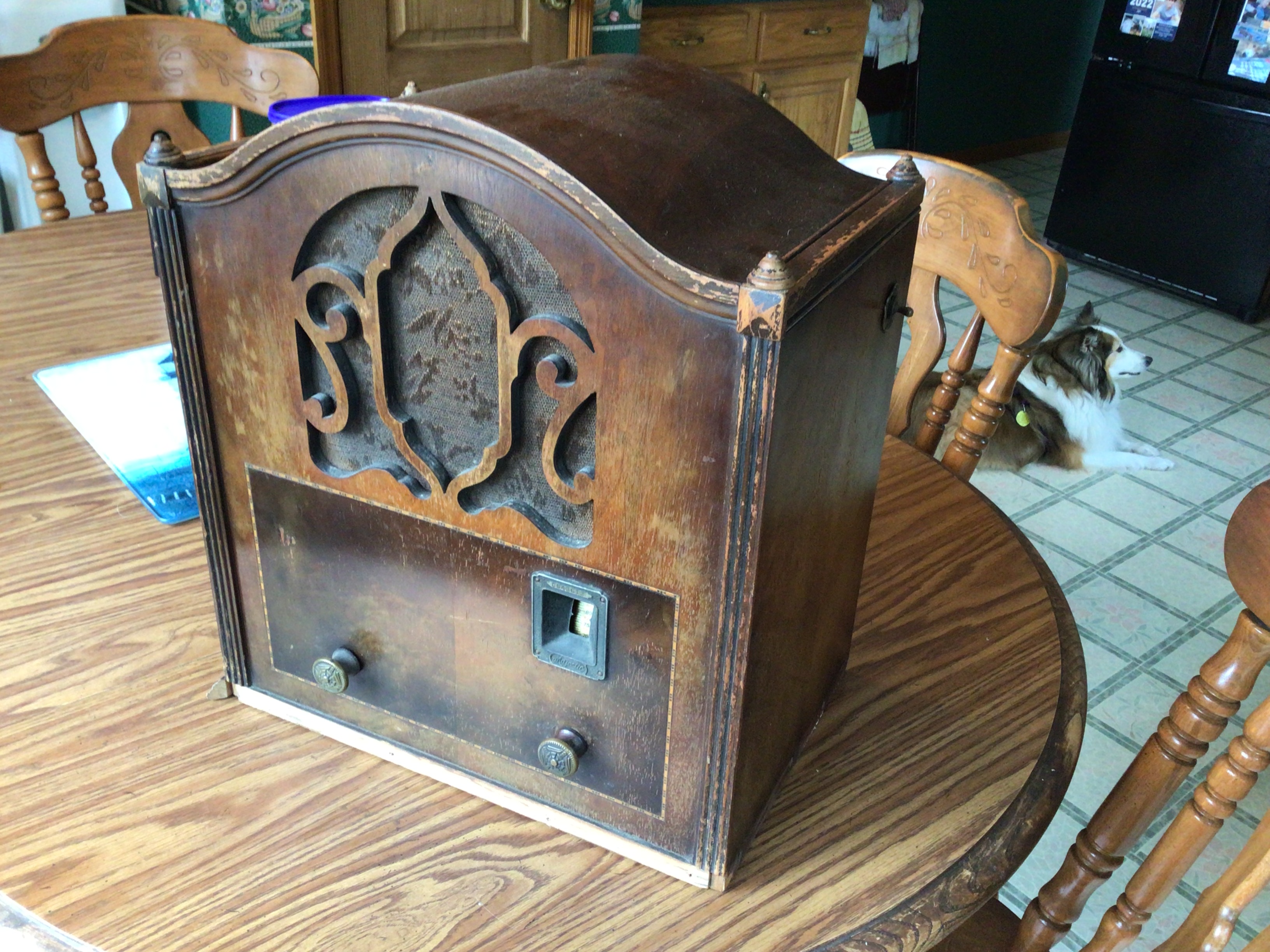

I almost bought one at the buy it now price of $75 on eBuy, but it was pickup only and he was a 6 hour drive away in northern Vermont. I lost a little interest in getting one of these when I got the GE S22A version of the RCA R7A (My collection is heavy on 1920s, later 30s (1936 - 39), 1940s and 1950s radios but light on 1930 - 1935 (the real transitional years in radio). However, I love the shape of the cabinet!
The tuner is interesting. Whoever designed it must have looked at some Radiola 16, 17, 18, 33 and 60 models that are strung in a rather similar mode. However, I love the shape of the cabinet!

MrFixr the shape of the cabinet is what caught my eye too. Paid a reasonable to me $50. If I would have known the weight of this thing as Terry says, it’s built like a brick privy, I wouldn’t have bid on it. I won’t be moving it around a lot and it’s probably one of the hardest chassis to work on that I’ve come across just because of all the shielding and so many major components are sealed in armor but I’m committed to finishing it. It has a decent size speaker and push-pull 45s so should sound great. Thanks Richard on the stringing comment!
