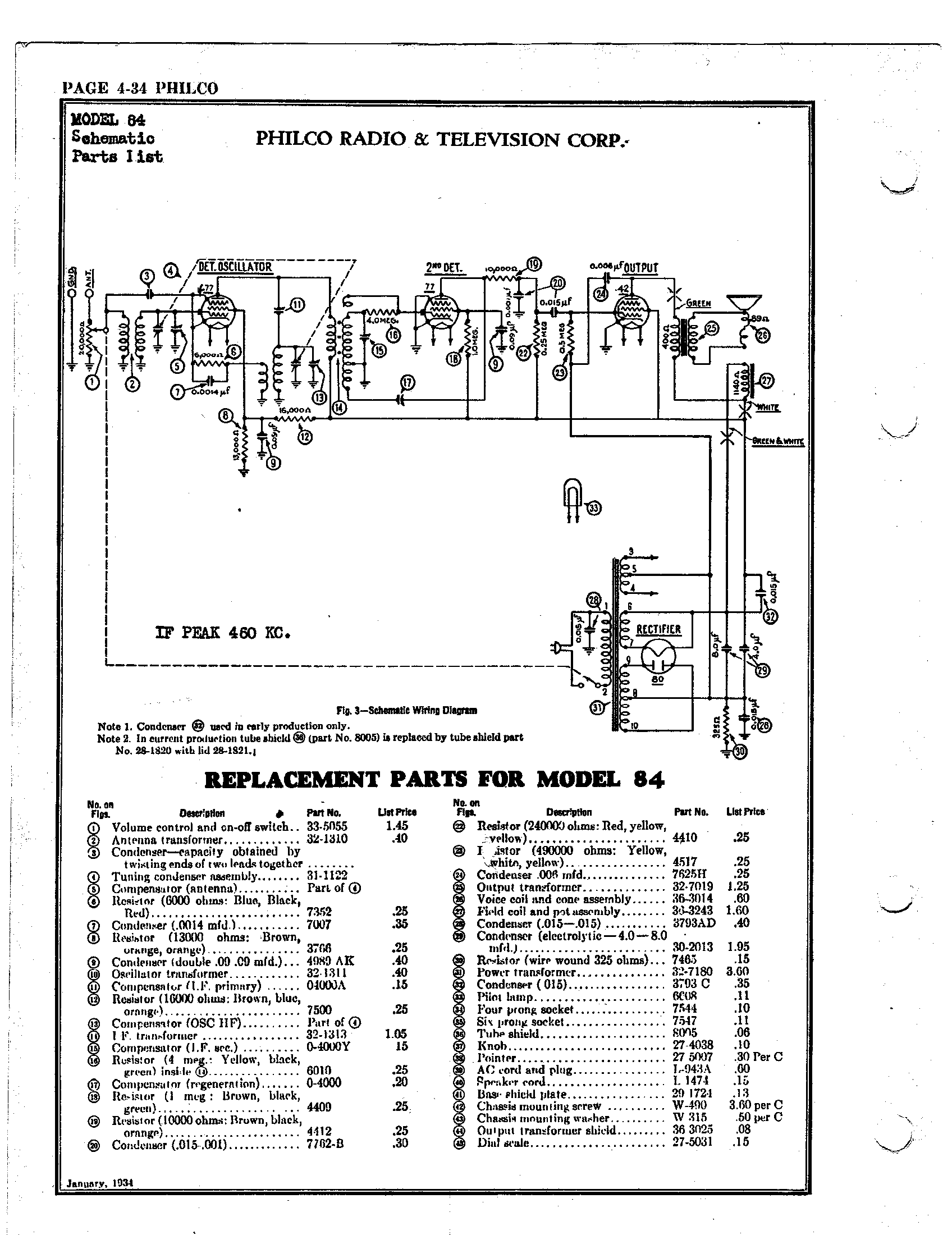

Attached are the schematics and a link to short video showing the issue.

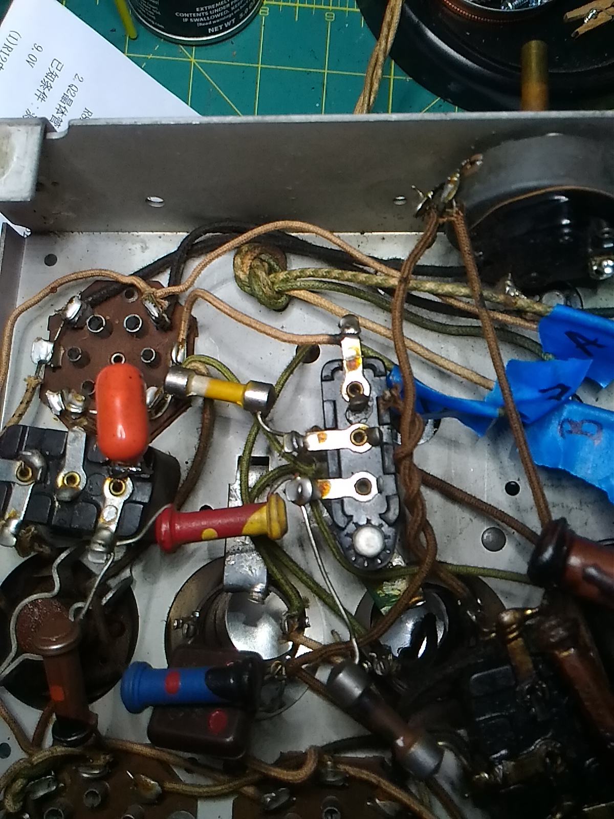

Maybe C3 leaking / shorted? It appears to be a "gimmick" (2 insulated wires twisted together., but not shorted.) Make sure that only the insulated wires are twisted but that the conductors don't touch. I am not sure why it is there, but it is in the 37-84, a set similar to yours except that it uses Octal tubes. It is not in the 80 and 81 which use a 36 Tetrode as an Autodyne Osc / Mixer, nor in the 89 version that uses a 77 Osc Mixer like the 84. If the 2 conductors of this twisted pair touch, it essentially shorts the antenna to the cathode of the tube.

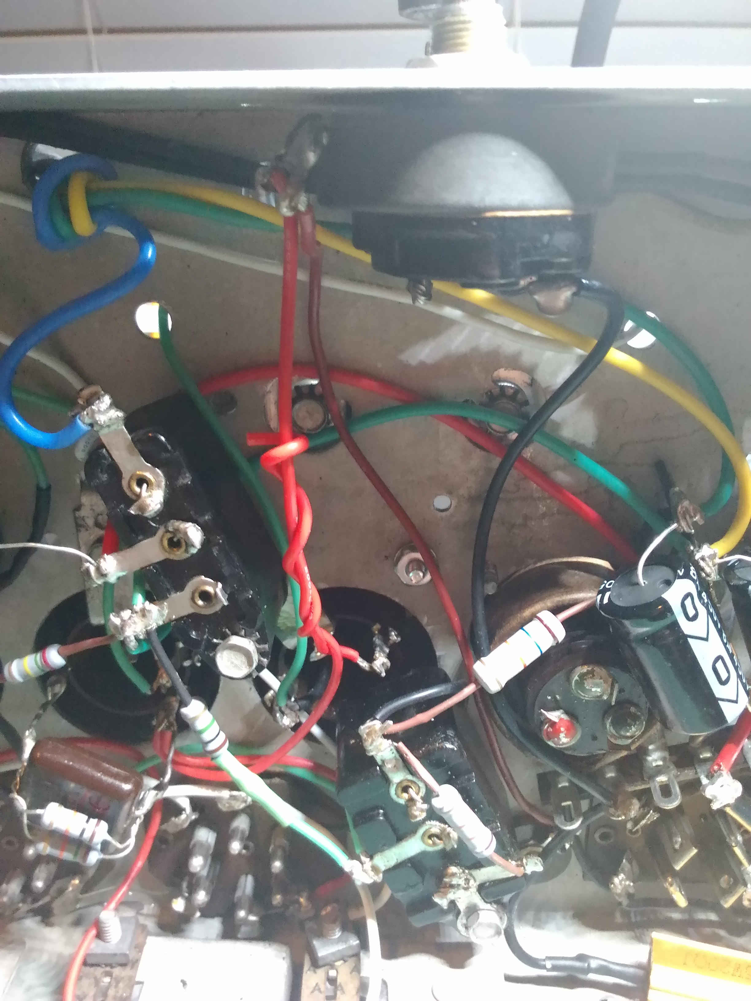

That was one of my lines of thinking, but I don't know much about gimmick capacitors. When I rewired the chassis I tried to get the gimmick to look the same. I've attached before and after pics. As you can can see, only one end of the two wires terminates to a dead end. I guess I can experiment with the length of the gimmick and the number of twists and see if that makes a difference. I also used 20 awg wire. Could that affect how the gimmick works?

Checked #20 again. The .001 cap goes from pin 1 to 3, and the .015 cap goes from pins 2 to 3 per the schematic for the Bakelite block model listed on this site. I'm going to ohm out the oscillator coil next where the gimmick connects on a hunch that the coil may have opened.
