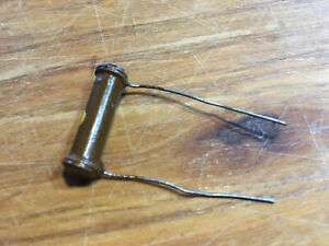

The very early ones are called Dog Bone resistors because their shaped like a dog bone .
