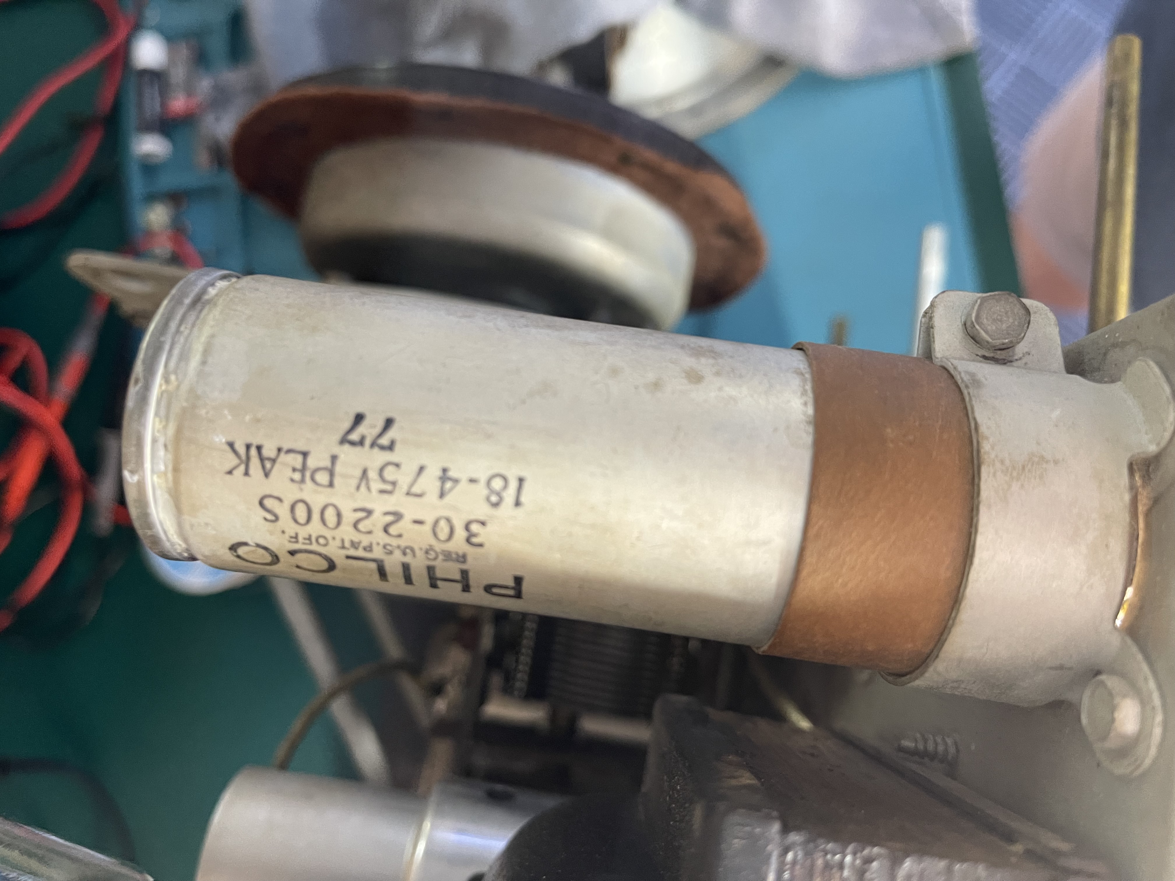

I have a Philco model 38-4 and it has a 30-2200s can with a 18uf 475v electrolytic capacitor. On the bottom in the center is a tab to connect and one on the side. I need to replace it but I am not sure if the center is positive or negative.
Anyone know?
Picture attached
Center is+ the tab on the side is -.
That is what I was thinking, thank you for confirming!
