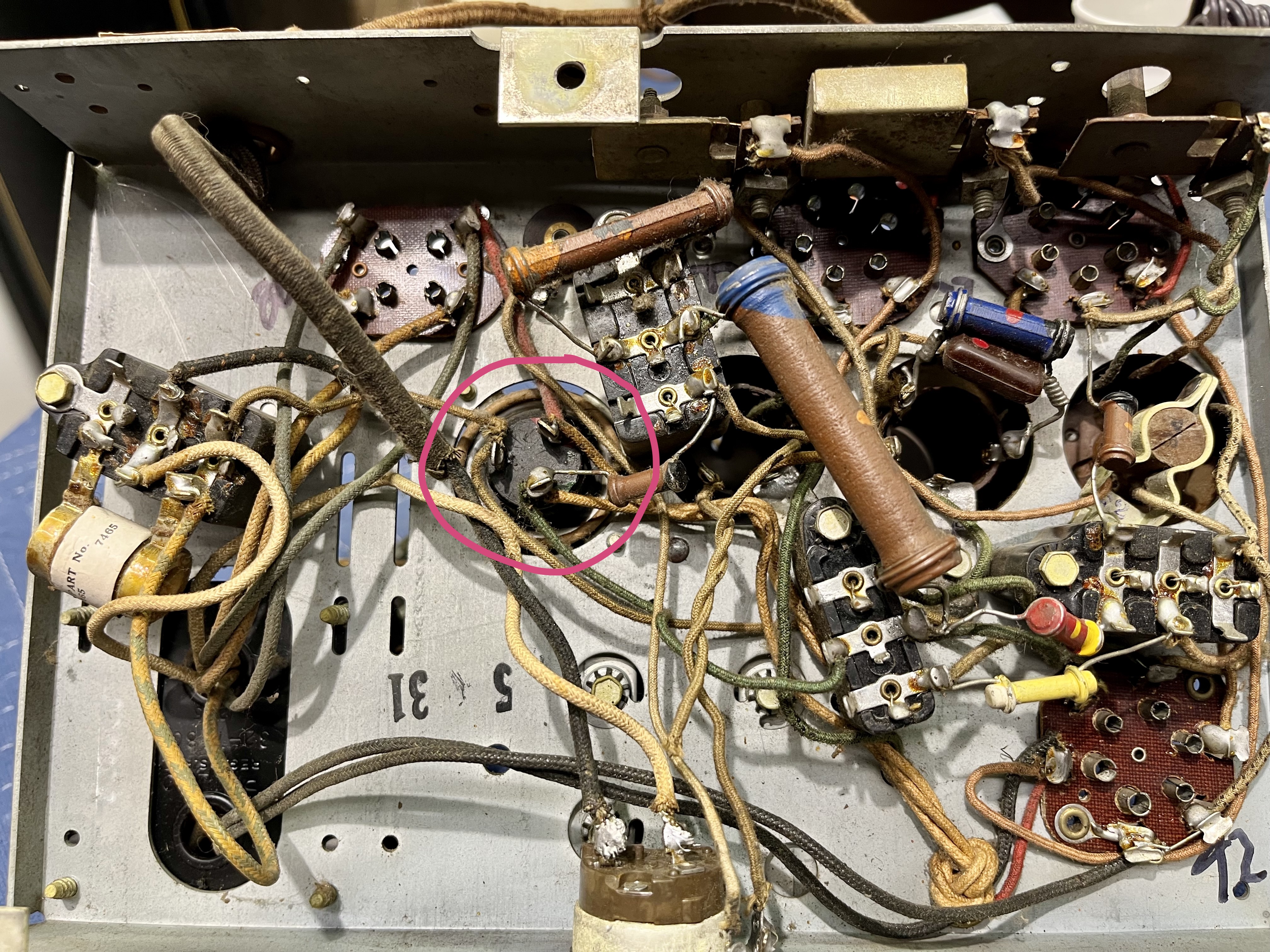

Hi, I just opened up this radio and have what is probably a simple explanation.
There are 3 tabs on for the 30-2013 electrolytic on the Philco 84 that consists of  a 4 and a 8 mfd in it. The electrolytic has one of the tabs marked green the next one is red and the 3rd on is unmarked. I am planning on using 2-10 mfd electrolytics to replace them but not sure hoe to wire it.

Im still a little confused. You can see the 3 tabs on the old electrolytic. If you look close you can see the red and green tabs
I think the wire that goes to the wirewoumd and the cap in parallel on the left (the leftmost terminal of the cap) is the common negative for the other two terminals (red and green wires) that are 8 and 4 uF caps respectively.

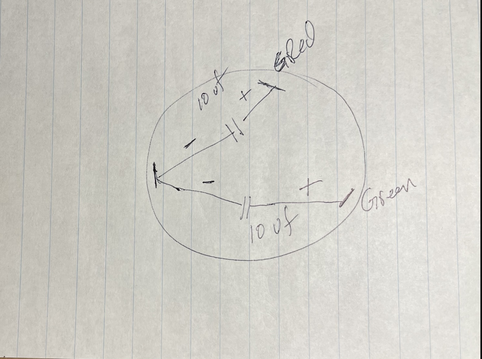

Hi Terry & Morzh
Is this how I am to wire it?
Thanks
Yup you got it. The - side goes to the 325 ohm wire wound resistor/high voltage center tap. The +'s go to the 16K and the filament of the 80 tube. Don't know if you are a diagram reader, the filter caps +'s are on the top and -'s are bottom.
Sorry to confuse. A lot of the Philco e caps a metal tab that slips in between the can and the cardboard insulator. This is where the - connection is made. Yours is a little different. Not wrong as I looked at one of my 84 and it looks just like yours. My mistake.
