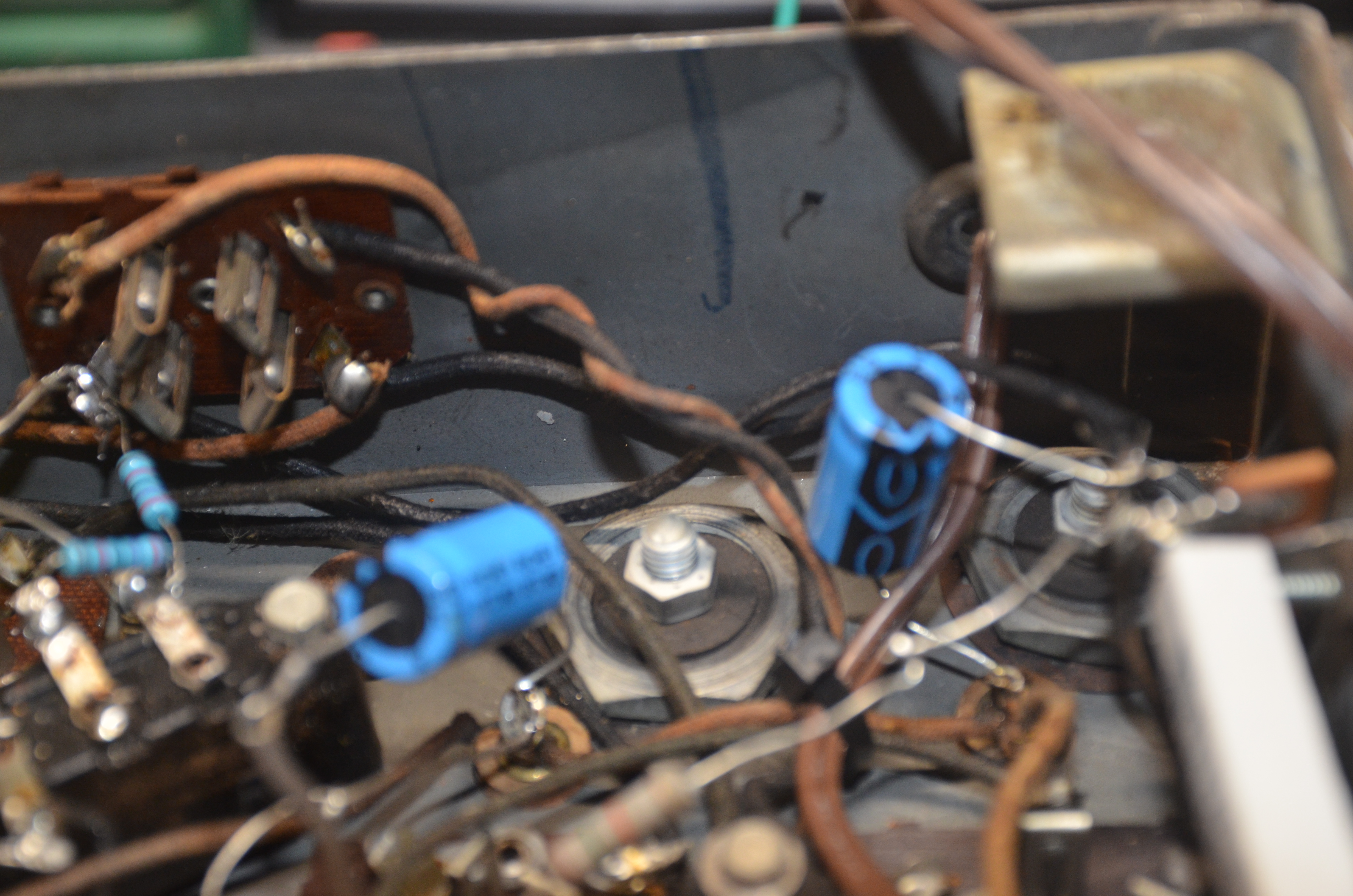

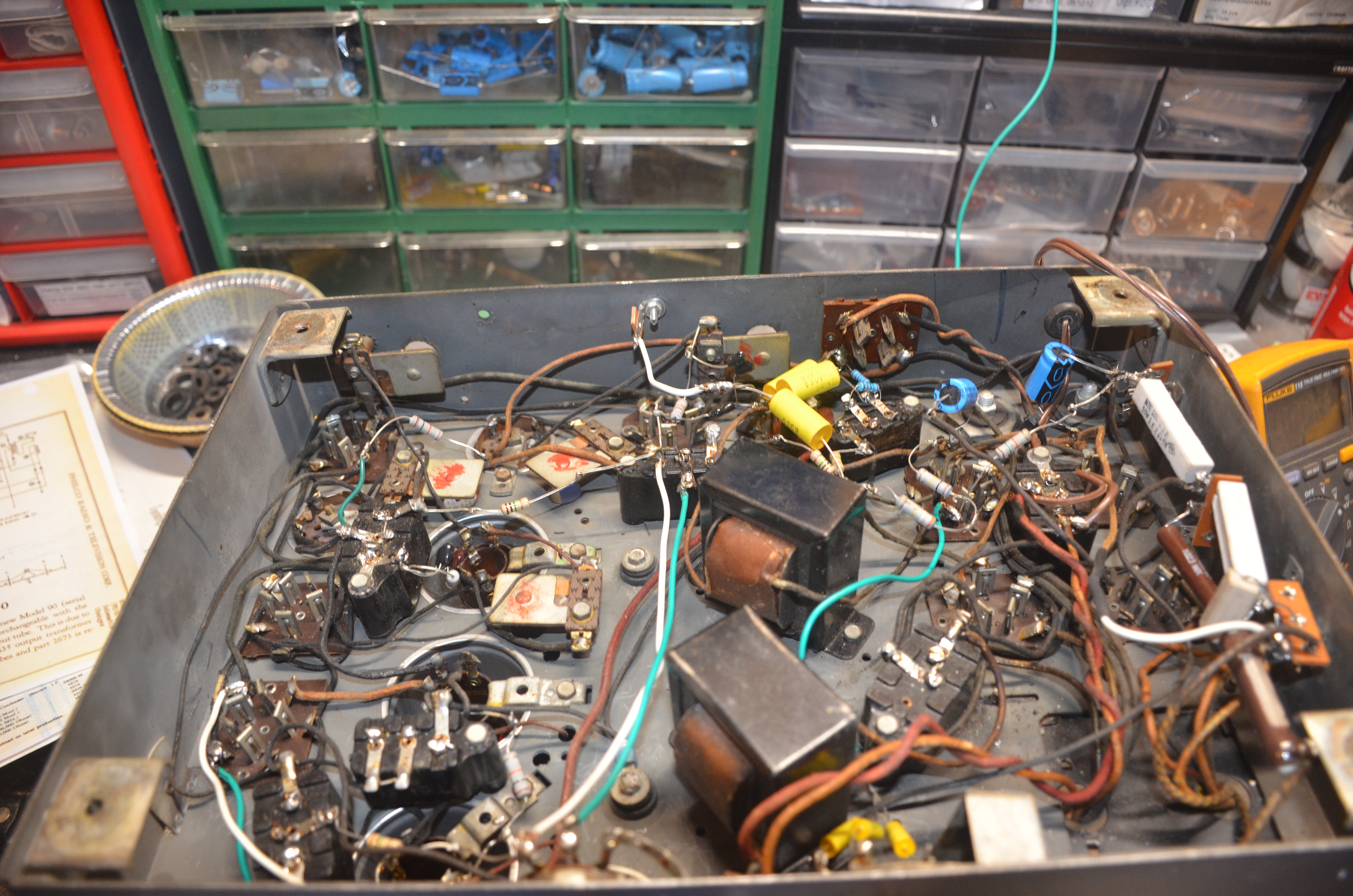

Hi All. I just powered up this Philco 90 chassis with all new capacitors and new resistors. 10 mfd 450 v electrolytics are installed, and everything seems to be correct. However I get a fairly loud 60 cycle hum that doesn't change with the volume control. Any ideas?

Let's take a dive in and see what we can find. Here's the service info:  https://philcoradio.com/library/download...%2085A.pdf  so we can be on the same page.
Starting at the p/s check #'s 48 and 51 the + side goes the filter choke & #50. The - side to the hv center tap. Did you replace or remove #50? If it's original it's probably shorted. This does no damage but will make the filter choke of no effect in the circuit. This will cause hum as will a grounding - side of the filter caps.
Never power the chassis up without the speaker plugged in. You can easily damage the filter caps. If you have to remove the 80 tube this prevents any hv dc voltage. With the spkr plugged in measure the dc voltage from B- (- side of one of the filter caps) to one of the filament pins of the 80 tube. Should see about 275v or so. Then check the voltage over on pin 2 of each the 47 tubes.
Hi, yes I replaced #50
According to the Bintliff bakelite block book, the 6287-B block should have 1 .15 capacitor in there. I think i found my mistake, I put 2 .1s in it and should only have put 1.
My recommendation would be to omit cap 50 and increase the value of 51 a bit.
