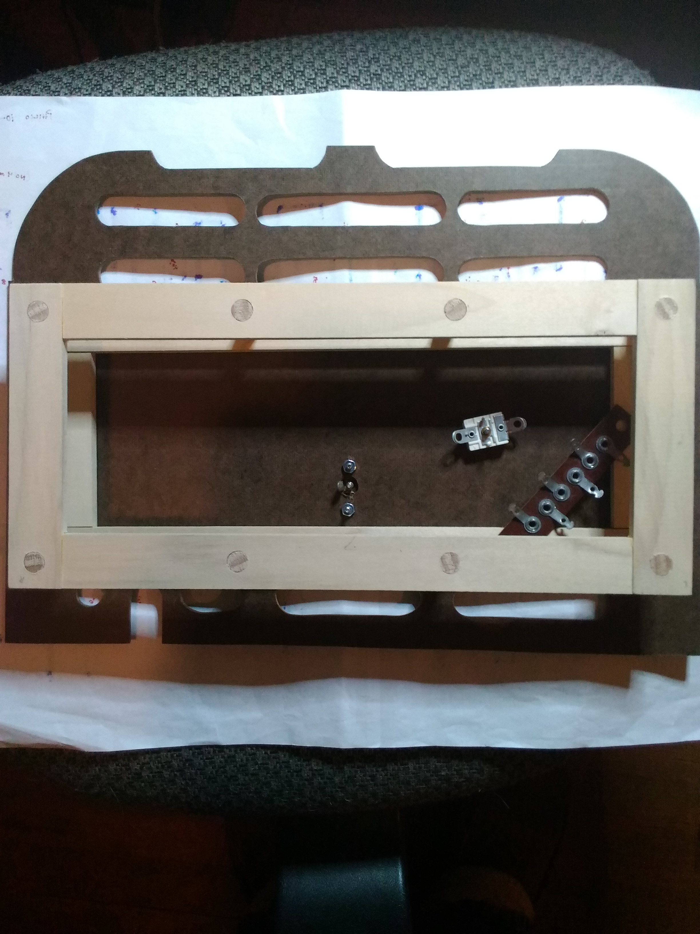

In the process of finishing up a restoration of a Philco 40-145 and am trying to build the missing loop antenna usually attached to the back cover.  Have already reproduced the back cover and the frame for the loop antenna, but don't have enough details regarding the directions to loop the wire, the number of loops, or how they connect to the terminal board and variable cap mounted to the frame of the antenna.  Used several videos and still images available online to get a basic idea, but there are some specific details missing regarding the path of the wire loops. Would greatly appreciate any assistance, i.e. photos of an original antenna or maybe a hand-drawn schematic. I've attached a pic showing my progress so far.
Nice work on that frame. I like the dowel pin joints! Take care and BE HEALTHY! Gary

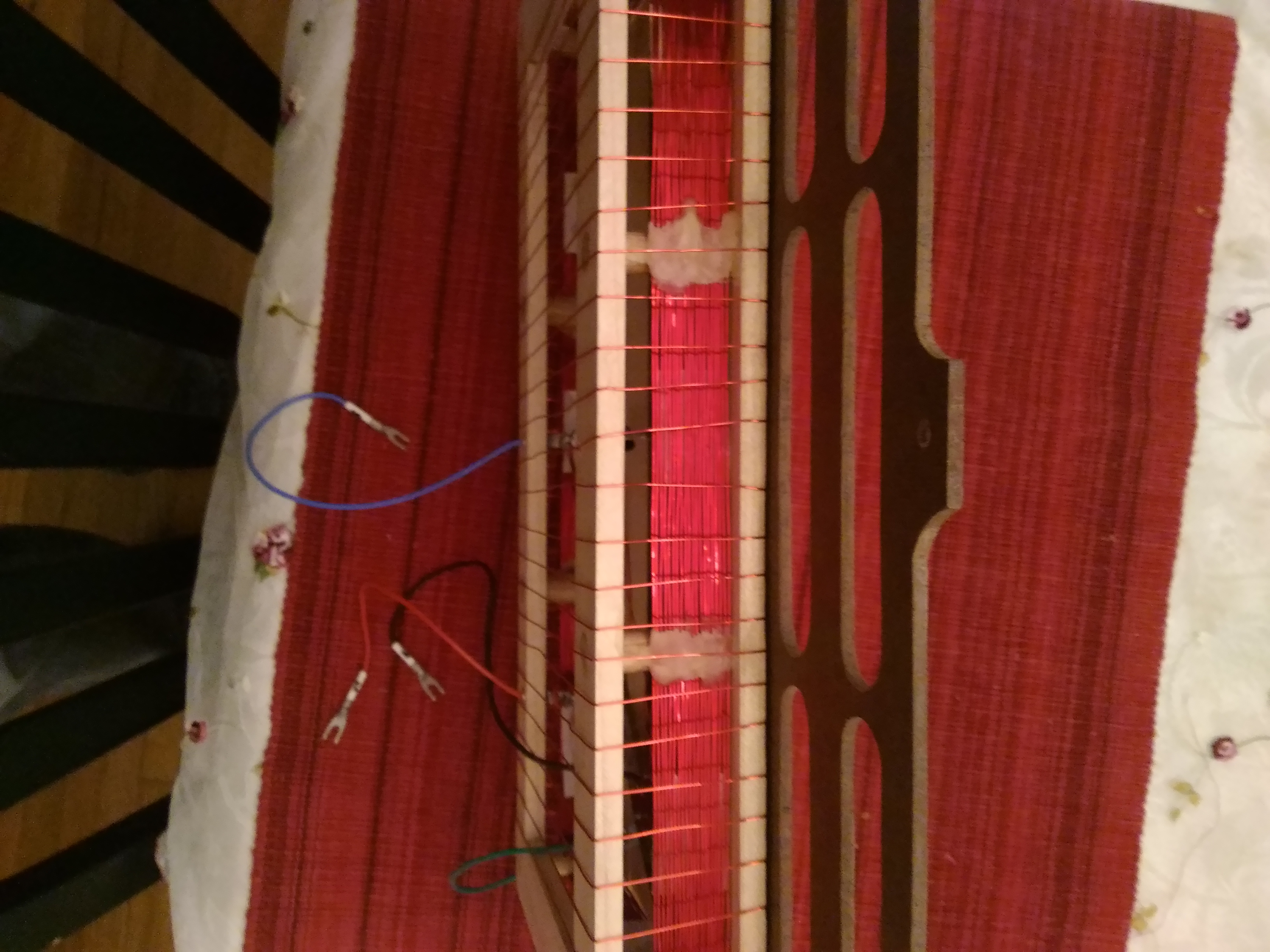

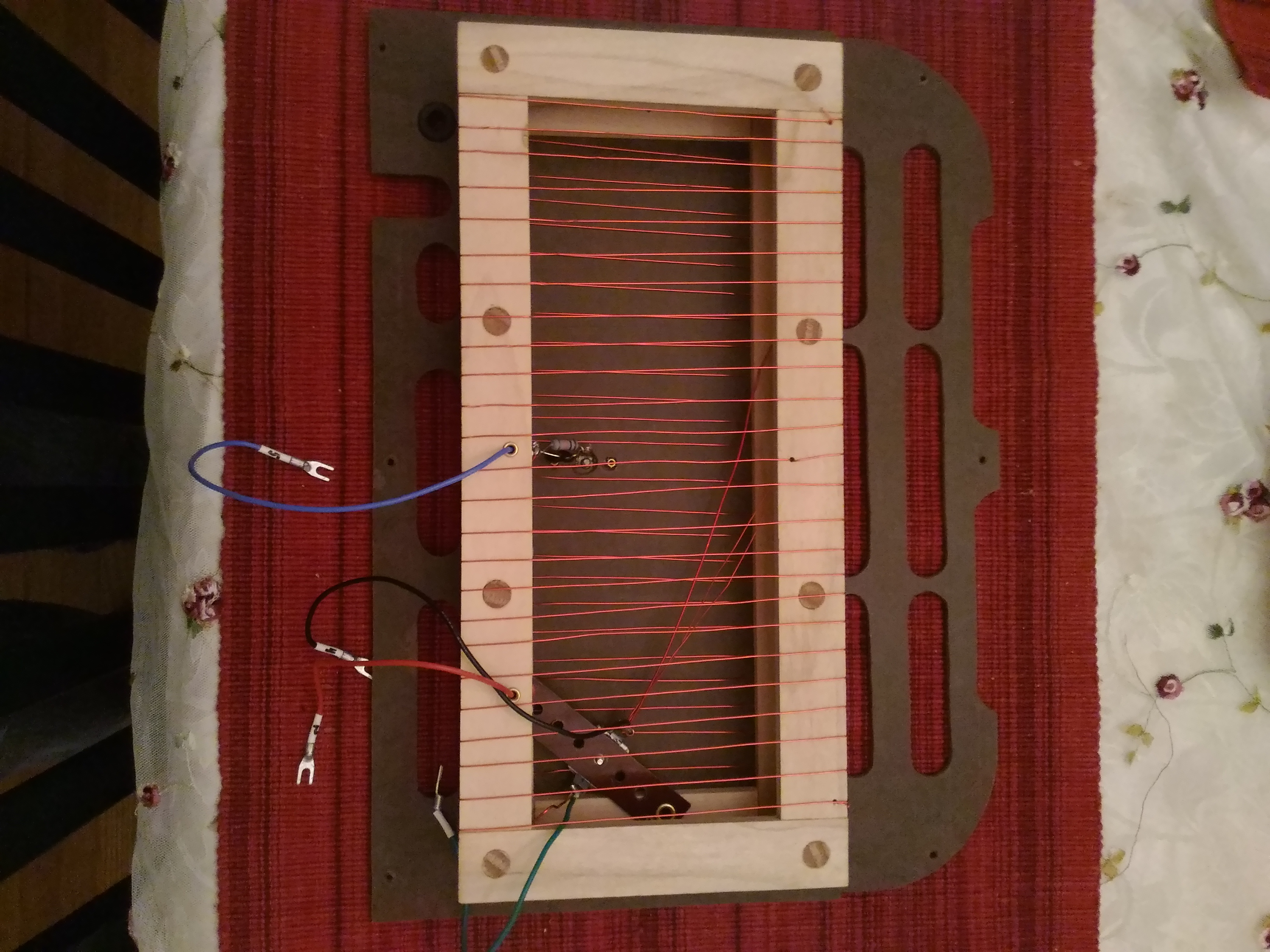

Based on these details, I wound the loop antenna using 20 awg enameled magnet wire.  The schematic for the 40-145 showed four wires attached to various points on the loop; one at each end of the wire, and two taps. I made a total of 21 windings on the loop and tapped into the loop at what I felt were the appropriate locations based on my analysis of a loop antenna for a different model: at 11 loops and 16 loops. One of the interesting descriptions in the patent info was that this loop should wind around the back half of the antenna frame, further away from the receiver.  This is shown in the patent diagram.

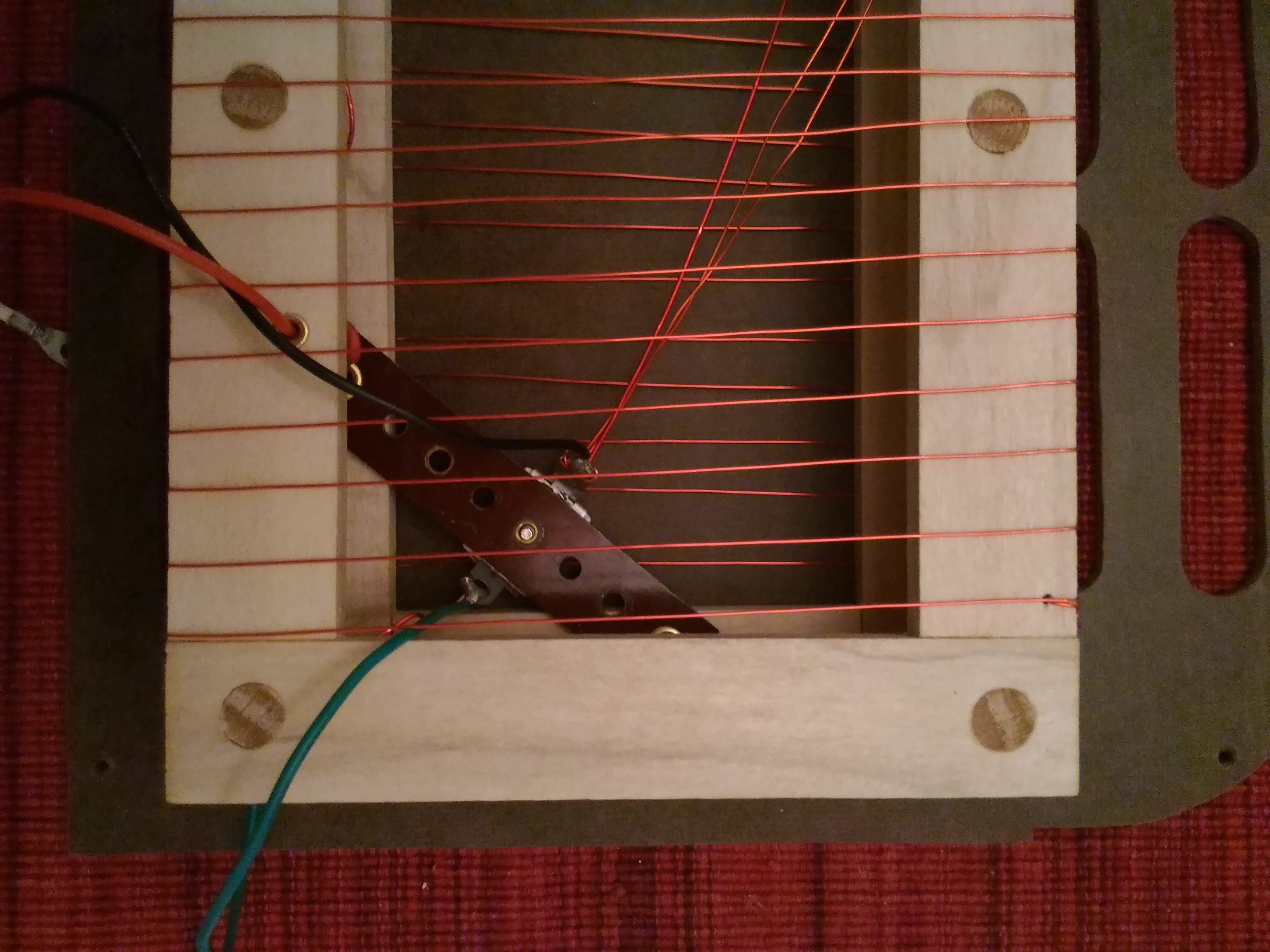

One end of the loop connects to a 75-350pf Arco variable trimmer cap (part 465) mounted on a Bakelite terminal strip (with terminals removed) and goes to the back of the receiver (#1).  The other end of the loop connects to the opposite side of the same variable trim cap.  This is the antenna ground and hooks to the back of the receiver (#4).
The tap at 11 loops connects directly to the back of the receiver (#2).  The tap at 16 loops actually connects to a 250pf mica cap and 10k resistor run in parallel from a separate external antenna connection on the back panel.  This then runs to the back of the receiver (#5).
Note: The #3 terminal on the back of the receiver is for the shortwave antenna (which I previously reproduced using instructions found on the Antique Radio forum): https://antiqueradios.com/forums/viewtop...6&t=300441
The shield wire has a total of 26 loops of 24 awg enameled magnet wire, 13 on each side with a center tap running to the ground on the variable trimmer cap.  The center tap was done according to the description in the patent.
After winding the loop antenna and shield, I secured the wires using some beeswax and double-sided tape mounted on the interior of the loops where they are less obvious.
