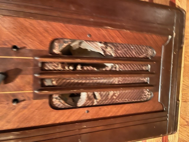

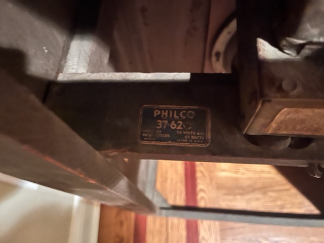

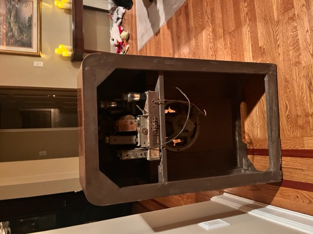

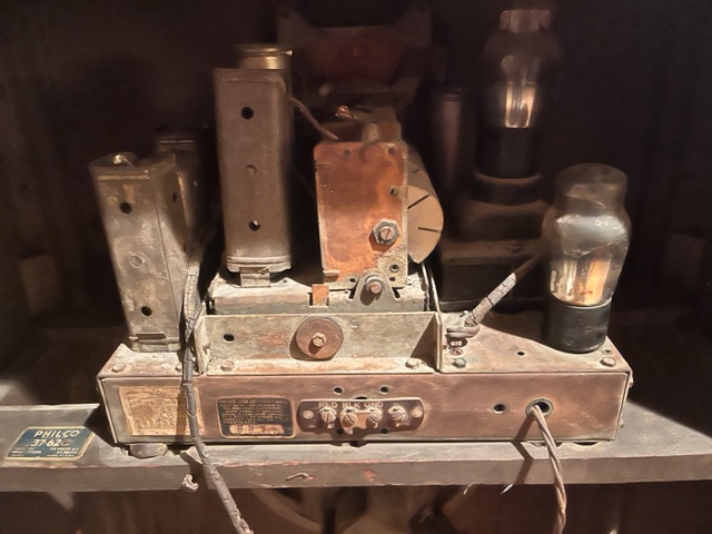

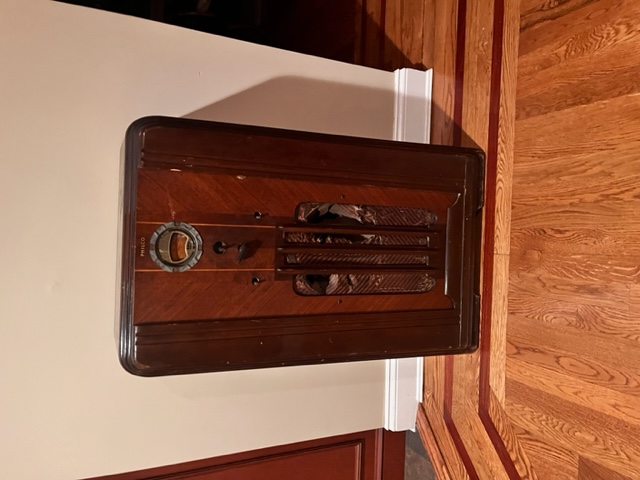

    Hello all,  I am new to the group.  My name is Scott.  My wife's grandmother had a Philco 37-620 Radio console. I looked at photos and it looks exactly like 37-620J from 1937.   The wood itself is in good shape.  I believe the parts are original, but the unit doesn't work.  The decorative foil is still attached but badly ripped.  Missing knobs.  For sentimental reasons would like to get it restored for my wife as a gift.  Would appreciate greatly some direction.

Based on the pix you posted:
-The speaker needs to be repaired and likely re-coned.
-The "grille cloth" must be replaced
-The power cord must be replaced.
Getting to the tuner sub-chassis may be difficult.
Also note that your rectifier is the uncommon 5Y4, not the more common 5Y3. They are not directly interchangeable die to different pin connections for the plates. rewiring is necessary to replace a 5Y4 with a 5Y3.
If you don't do this yourself or get a hobbyist friend to do this for you, a pro job is going to be expensive, but this is an heirloom and a good performing, rather sensitive radio.

One is, some folks will make the chassis look like it has just come from the factory. Or even better. this requires time, patiens and possible work with chemicals. Yours look like it has developed some rust on it. It does not look like that crystalline "wet basement" rust, but it is oxydation nevertheless. If you want it gone, and then whether or not you want the chassis to look nice, bright and uniform, this will add to the effort.
