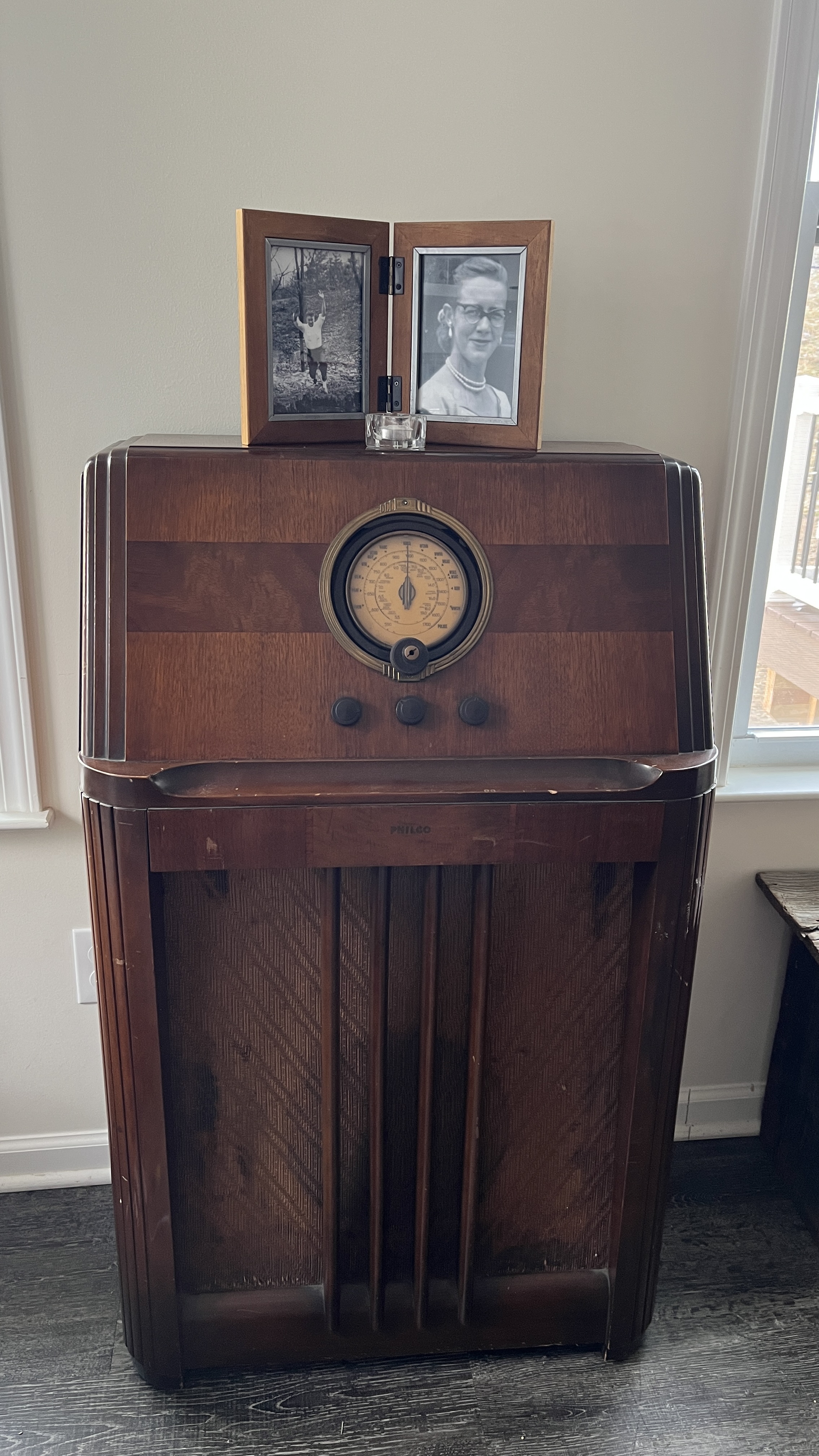

Hello! I recently inherited my grandfather‘s Philco 38.7 console radio. The cabinet is in great condition. However, the plug is scary looking, and has not been plugged in for a very long time. I would like to restore it to working conditions. I am just not sure where to start. Any ideas?

Welcome to the Phorum, Atlas! That is a very good looking console and should clean up nicely. Give it a good cleaning with GOJO or GOOP non-abrasive hand cleaner. You'll be amazed at the years of wear that will disappear. Please take pictures of the chassis. Hopefully it will be in as good shape as the console.

@ poulsbobill No sto0ping because of the slanted dial. Or so says the ad. Of course, that only counts if your eyes are about 30 years old. Otherwise stoop and glue face to dial after donning your strongest reading glasses.
