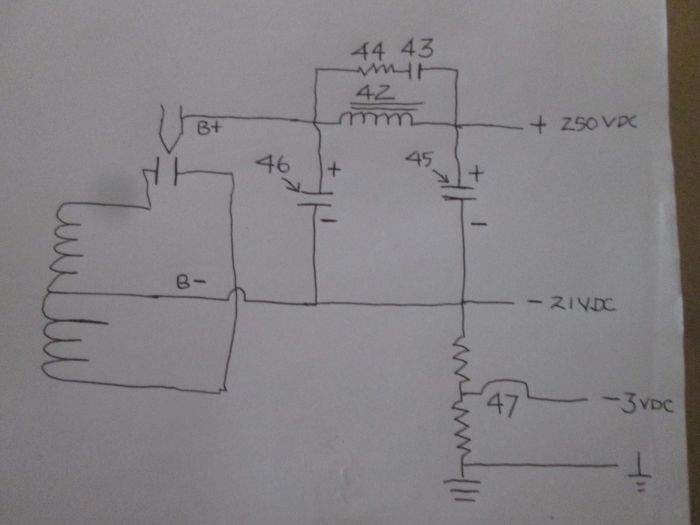

Here's a drawing of the p/s that's a little easier to follow. Perhaps it's just a matter of semantics. I'm calling it b- because it isn't grounded to the chassis (the exterior of the filter can). You are calling ground because unless it's insulated from the chassis it would be grounded.
Not trying to pick a fight or anything but the chassis ground point is found thru #47. It's used to develop the negative voltage applied to the control grids of the 75 tube (-3vdc) and the 42 tube (-21vdc). Without these negative voltages these tube would draw excessive current and generally would be hating life.  Over heating the power transformer and stuff like that.
Voltages listed are off the top of my head not to be used as an exact measurement. Oh and btw some Philco sets one of the filters is at chassis ground and the other is at b-. Some have the b- floating just like your set but there is a filter cap from chassis ground + to the hv ct - to filter the - side of the dc output... Check out #75 on this one https://philcoradio.com/library/download...%20165.pdf Better yet get you one. The 16/116 tombstone is the one to have.

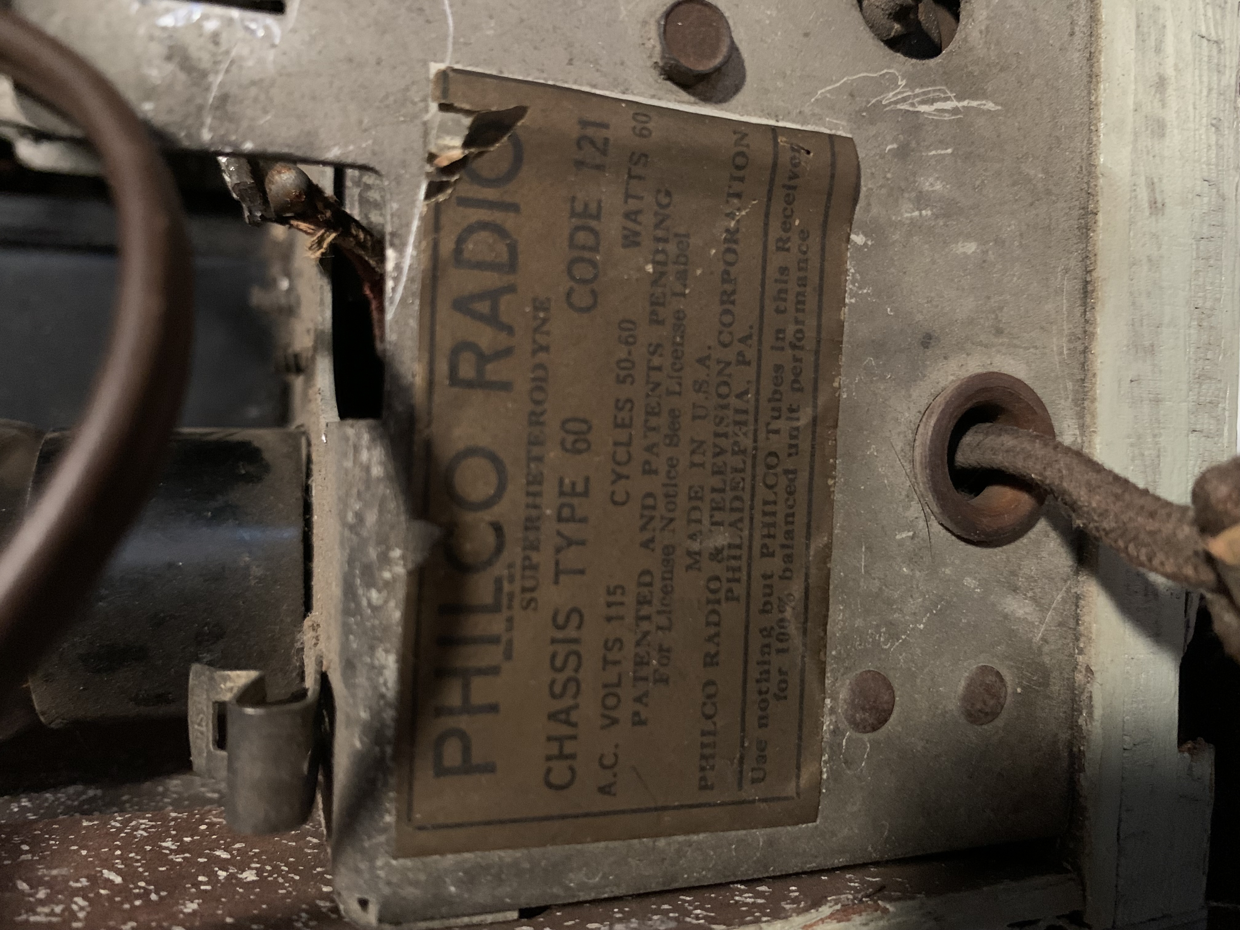

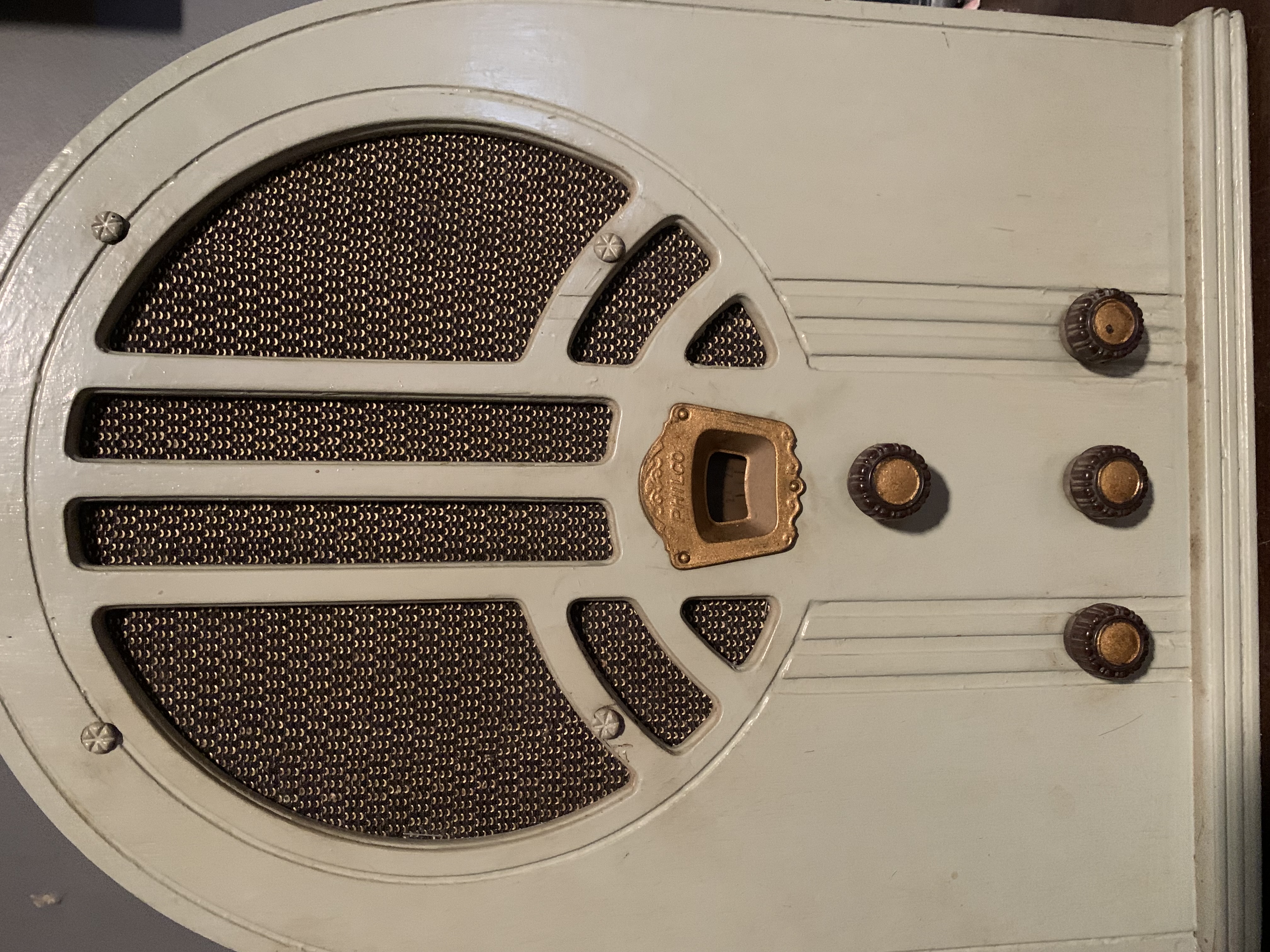

Attached are some photos of the radio. to me it looks like a model 60B 1934.

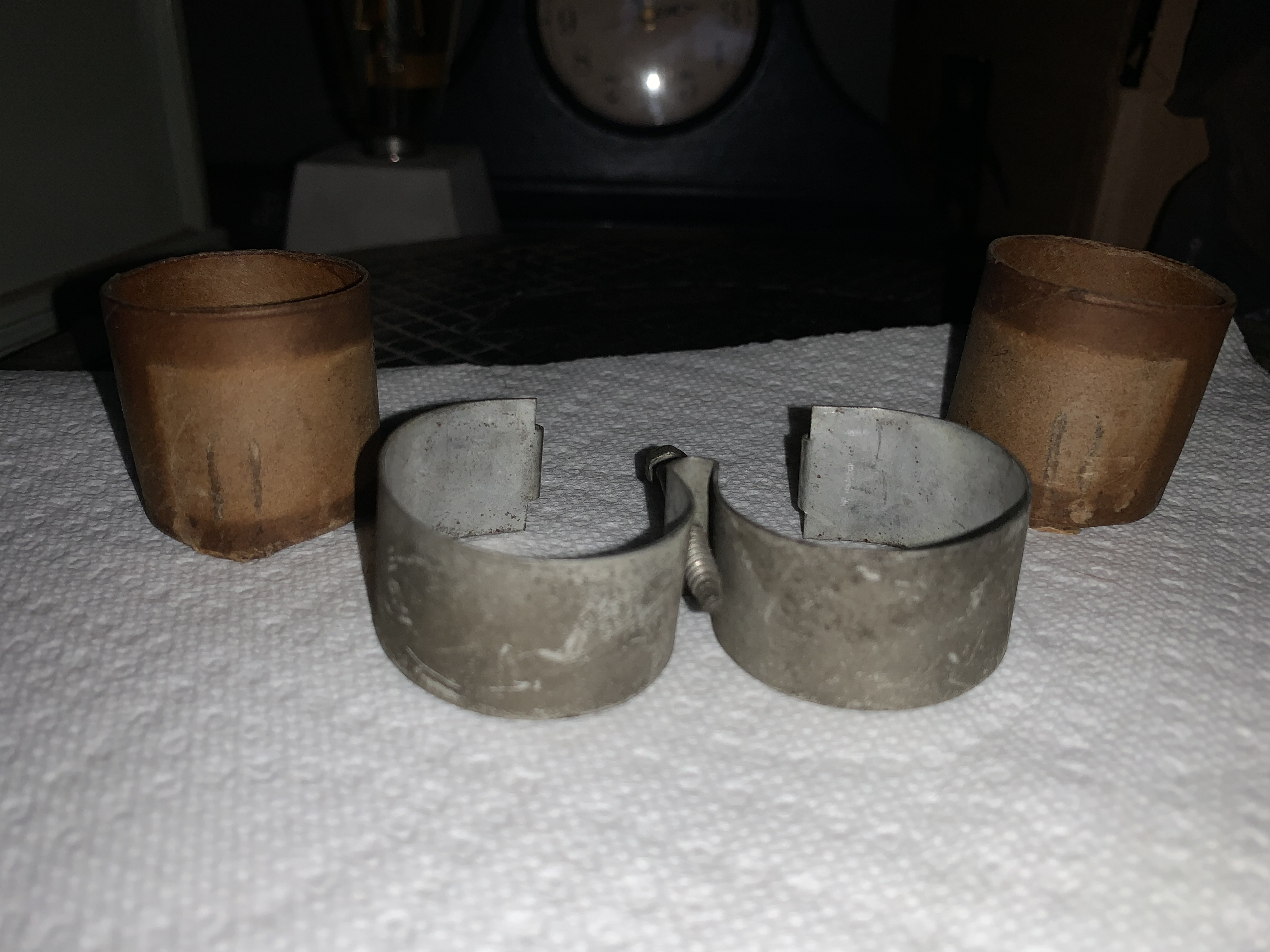

I also attached some photos of the cardboard insulators and the bracket that holds the caps, you can see marks on both cardboard insulators where the ground wires go. Or at least where the one existing ground goes and where the other missing ground should go.

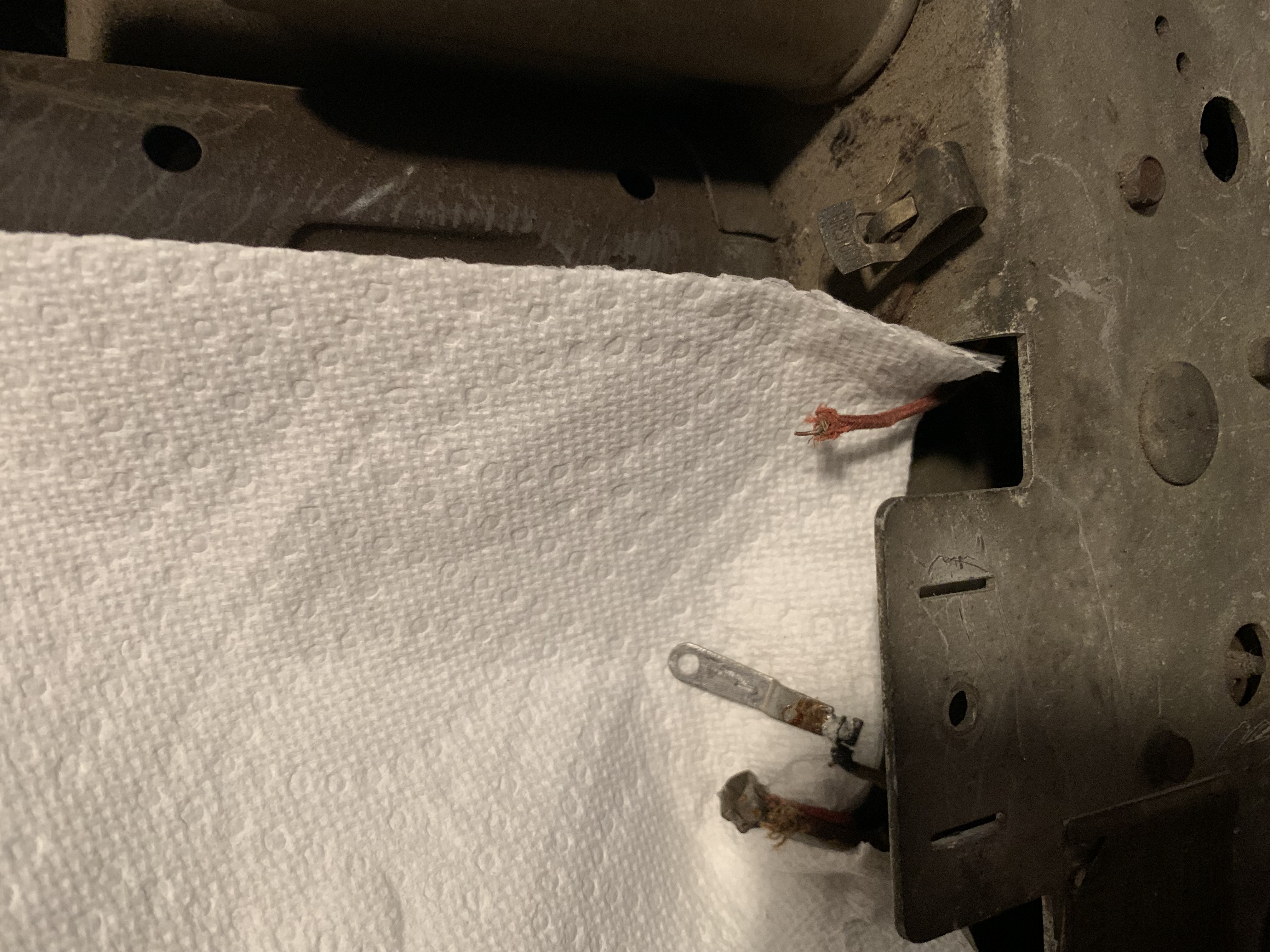

I included a photo of the existing wires, with a white paper towel in the background for clarity. They sure didn't give you any extra wire when they built these radios.

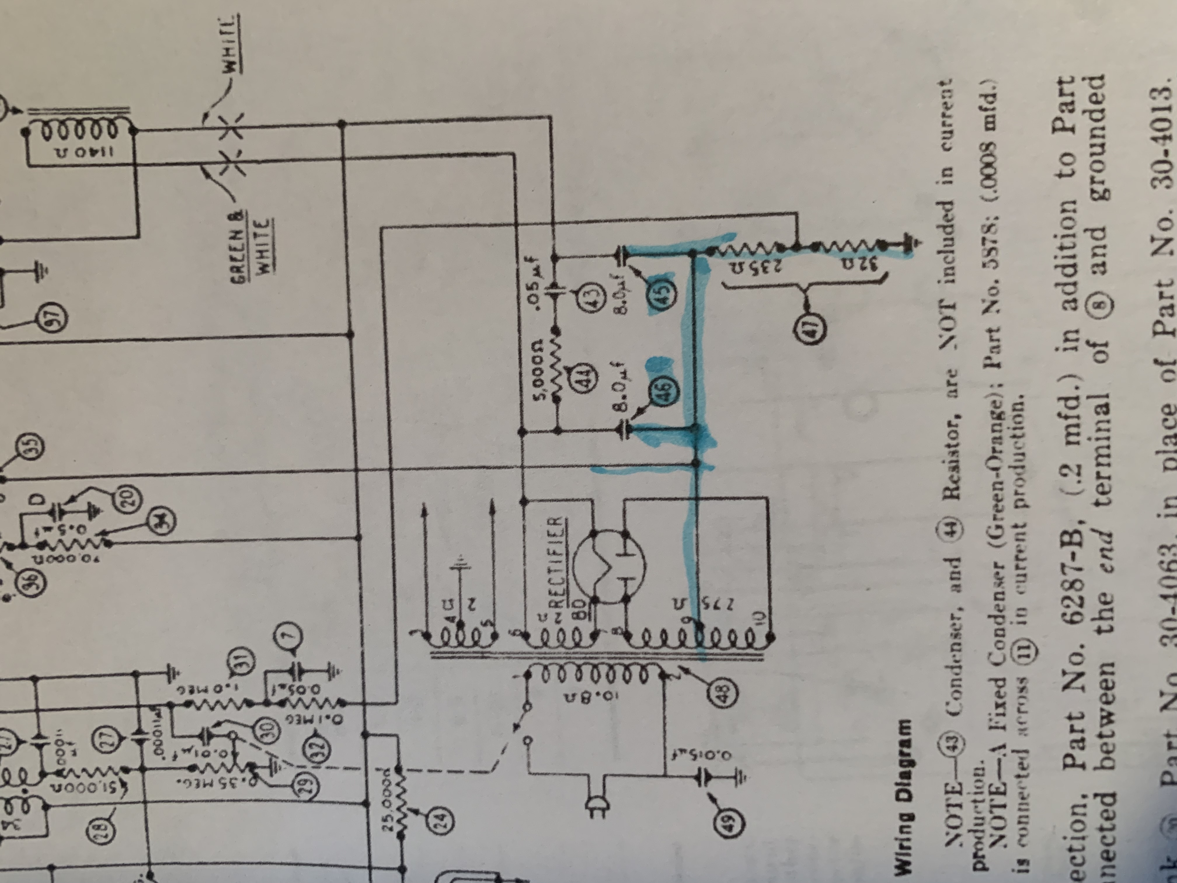

last photo is of the schematic with the caps and wire highlighted.  What do you think?

I think what you are asking is: "can the negative lead of electrolytic caps 45 and 46 be connected together?" Yes, they can. The exterior of the capacitor cans of 45 & 46 was originally the negative lead, thus the use of the little metal connection lug that was held between the capacitor can and the insulating cardboard sleeve so that wires could be soldered to it. The cardboard sleeve isolates the negative leads from the chassis which is at ground potential ( 0v). The two negative leads from caps 45 & 46 connect to the center tap of the transformer and as Radioroslyn notes are at a negative potential with respect to chassis ground. This is the most negative point in the radio and is commonly labelled as B-.
Hope that helps.
This is a typical power supply for radios of this era. It produces the B+ voltage for the tube plates and screen grids. It also provides a negative voltage for control grid bias in the audio circuits. Consider the casing of the 2 electrolytics to be the negative connection and don't call it ground. When the negative is connected to the chassis you have grounded it. But not in this case. The electrolytic negatives are connected to the center tap of the hv secondary creating a B- which is above ground. Thus, when resistor 47 is connected to B- and chassis ground it creates the negative bias for the audio tube grids. If you ground the electrolytics to the chassis you loose this bias voltage and the audio tubes will experience catastrophic consequences. It's very important to follow the schematic.

Yes klondike98, this is exactly what I was asking. This helps a lot. Thanks for everyone input and advise, it sure helps me learn and grow
