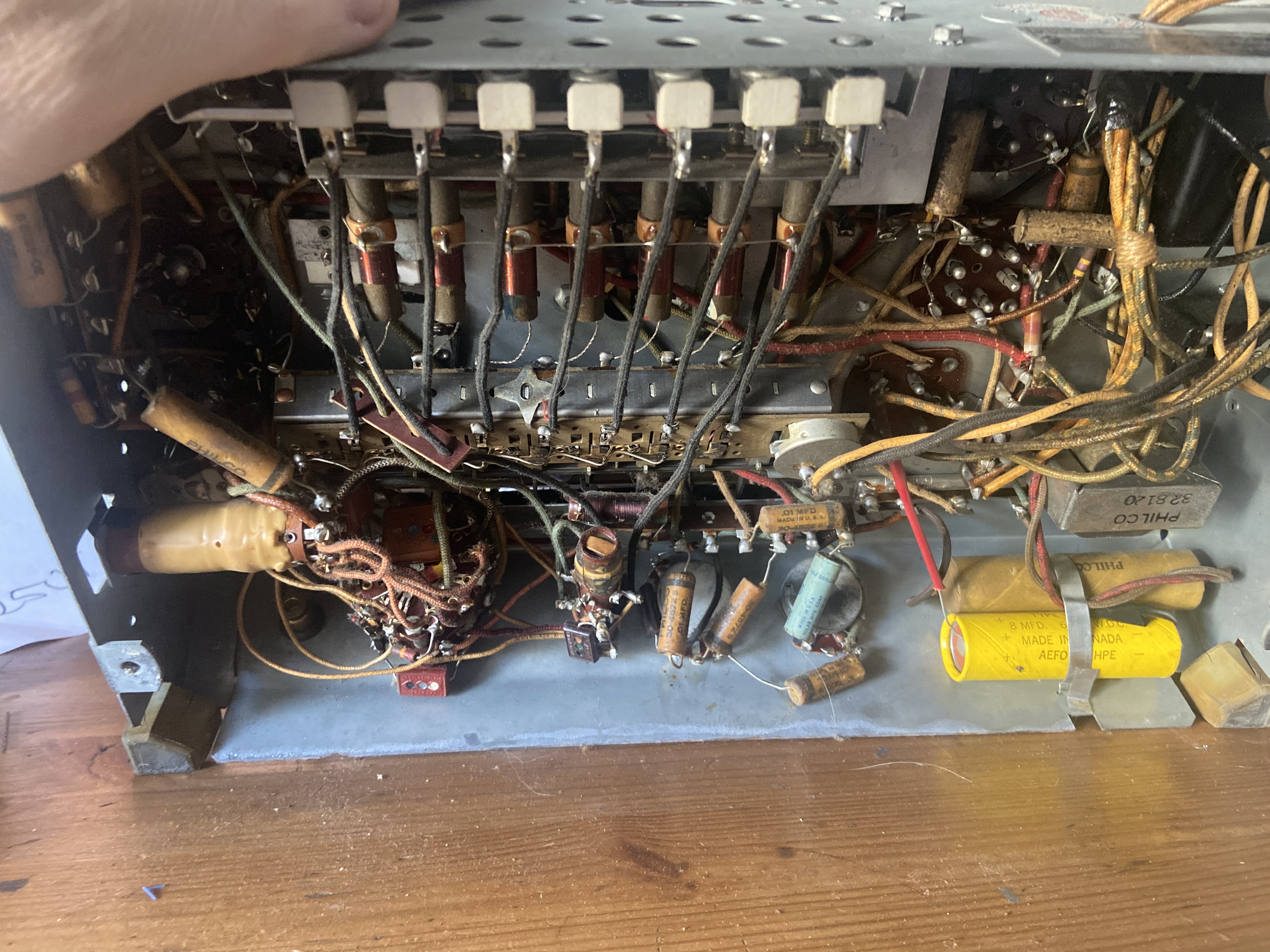

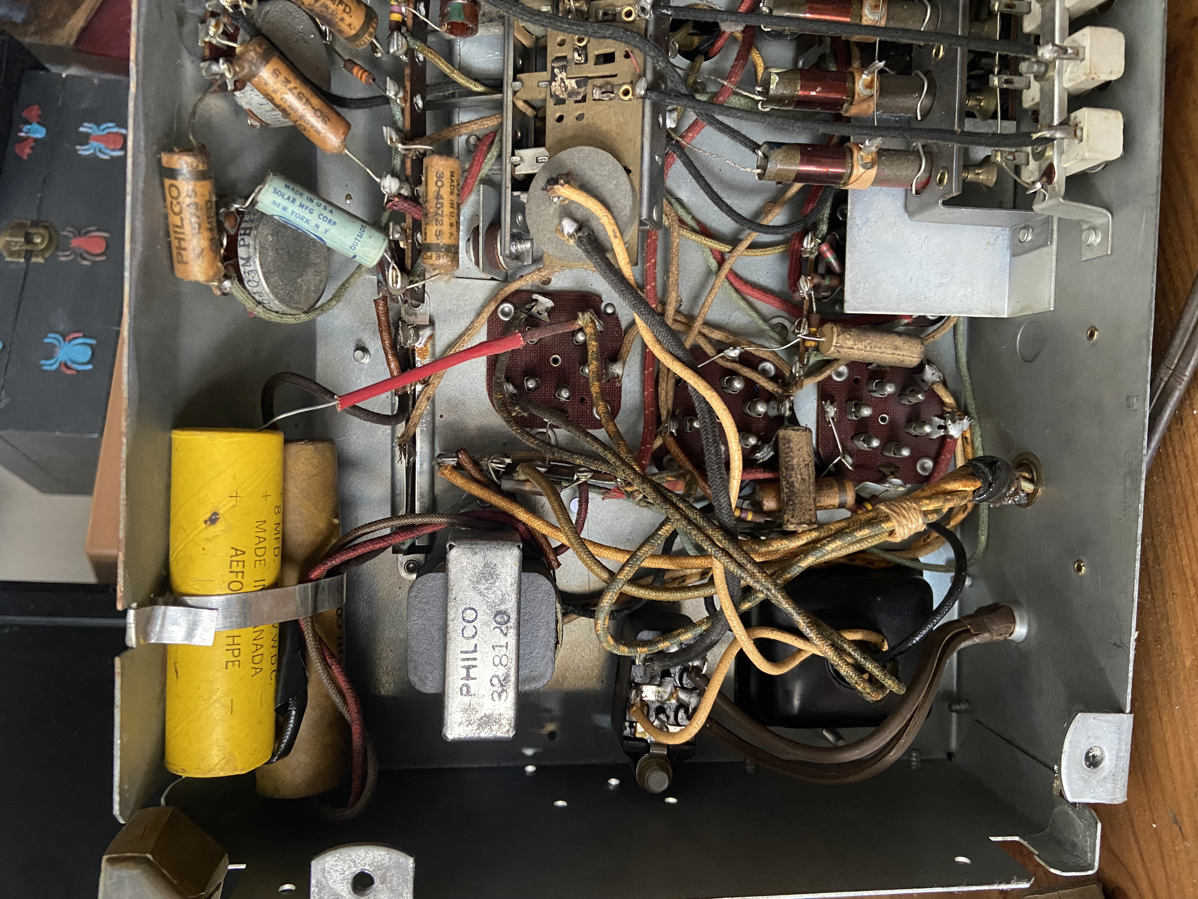

Im getting started on a 41-250 that was my Great Grandfarther. Has anybody refurbished this model before  and have a list of the replacement Capasitors they used.  I get very frustrated trying to convert the mmfd mfd pgf uf im not a numbers guy.
Any help is appreciated     .

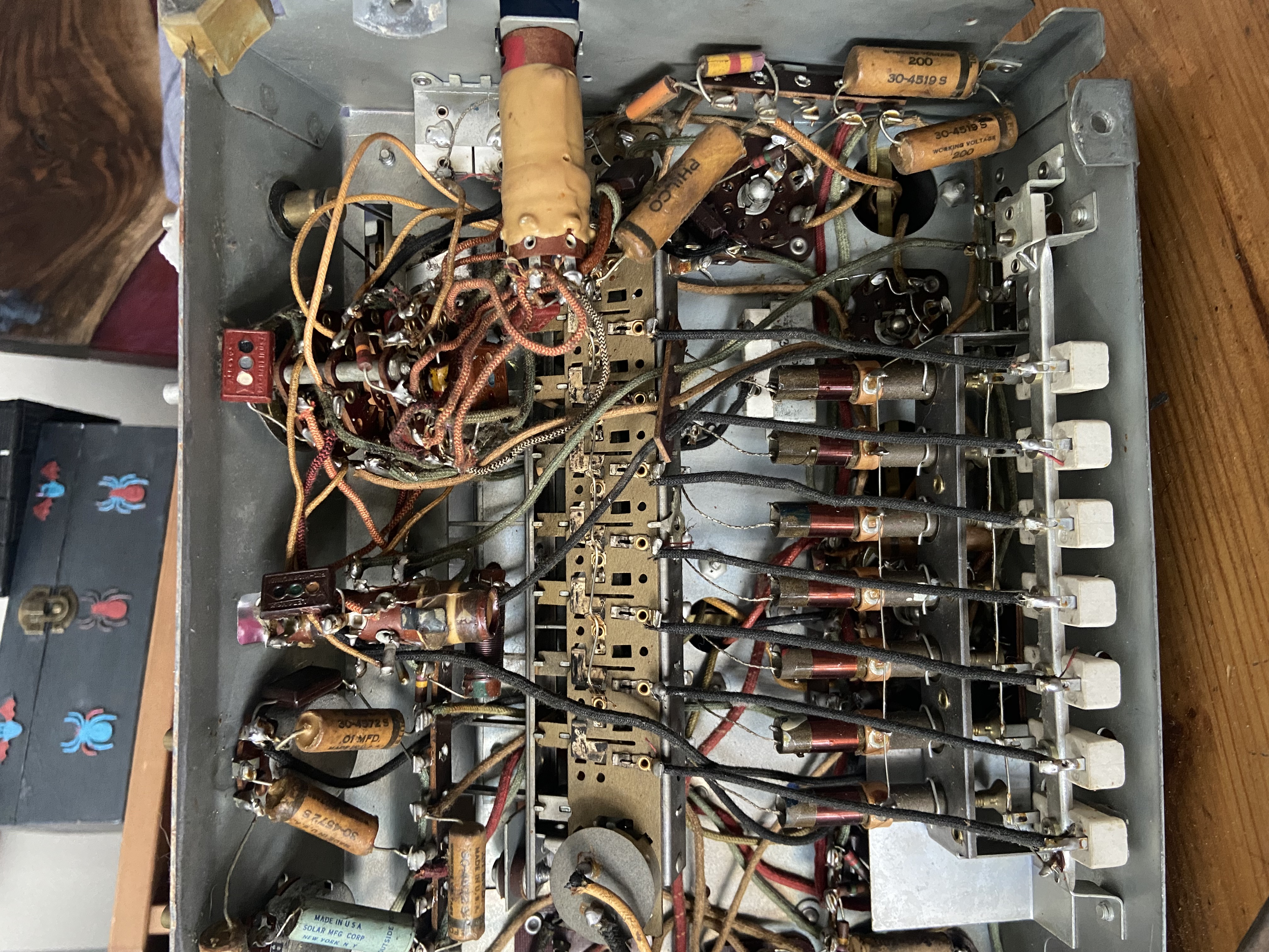

Welcome to the Phorum, JK! That is one very clean example of an 80-plus year old radio. Almost looks NOS! The information you're looking for is in the 1941 RMS yearbook. Click on the Philco Radio Library icon (bottom of the page), select service info, and 1941. This chassis is very similar to a 41-280X that I have, but have not restored as yet. Good thing to see is cloth insulated wiring instead of rubber insulated. You'll also want to replace the chassis corner rubber feet. It all looks innocent enough to work on, but exercise caution with that band switch. It will teach you patience! Welcome, and good luck restoring it. Keep us posted on your progress in this thread. Take care and BE HEALTHY! Gary

I have one of these also. MMFD is the same as pF. Move the decimal point 6 places, or just google convert uF (MFD) to pF (MMFD). It is an interesting circuit, as it uses a voltage divider in the screen circuit of one output tube to get the inverted signal needed for the other output tube. Therefore, make sure that your resistors in that circuit are good. I have not totally finished recapping my radio, but have replaced the 'lytics, bypass and audio coupling caps.
This radio uses tubes common to Philco's auto radios of the vintage, except for the XXL. This is a very good performer, except that you need a good long line antenna to get the best from it.
