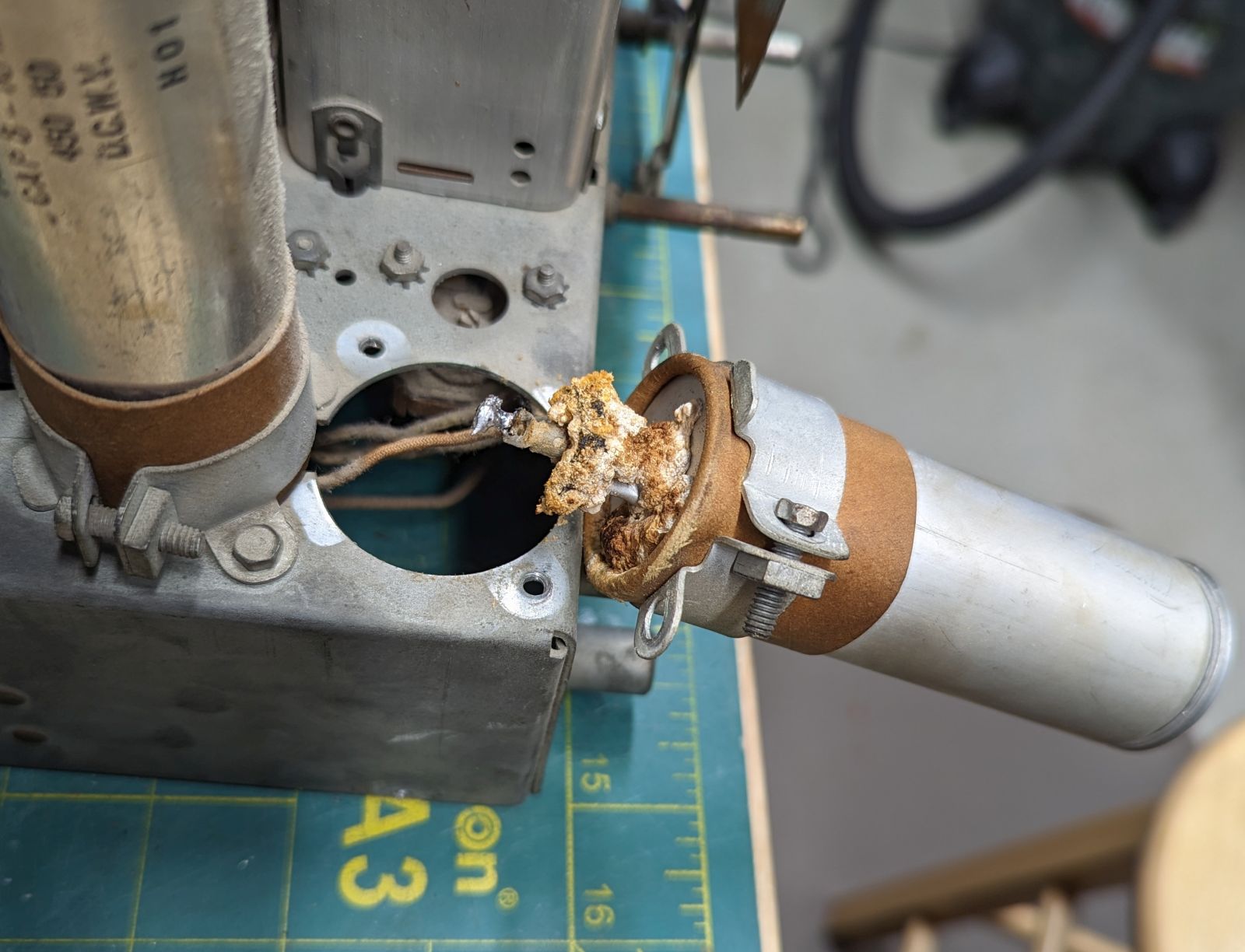

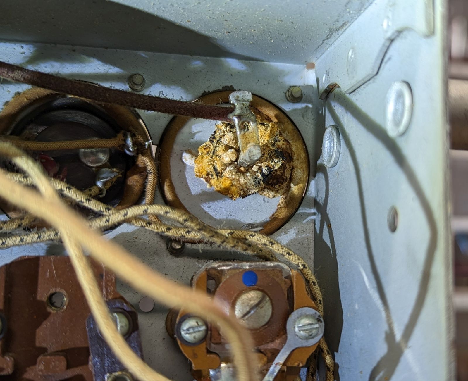

Well I know it's NOT...yuk! I wonder what that electrolyte was?

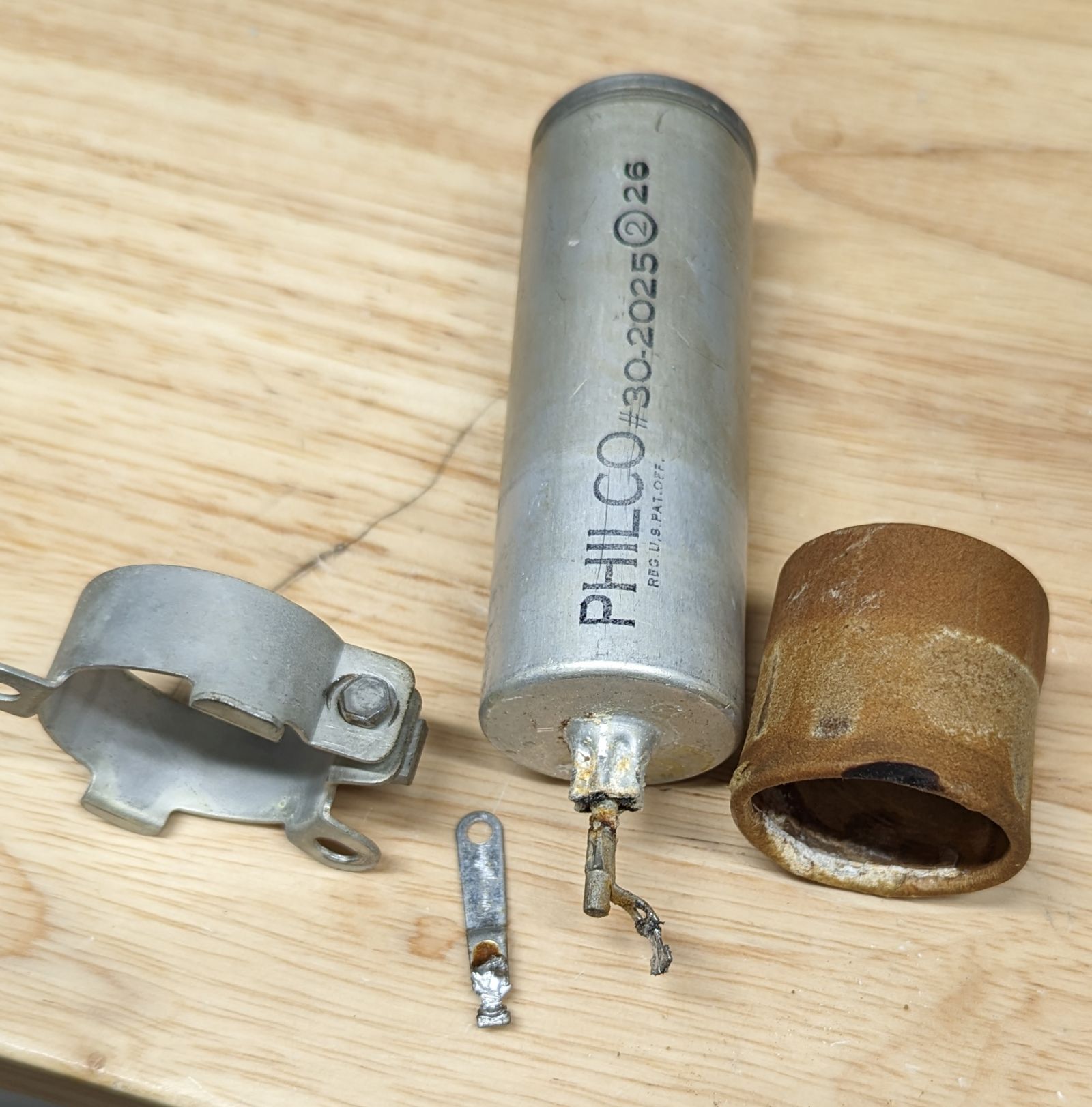

I know I can mount the replacement cap under the chassis, but there's some appeal to sticking it inside the old can. Any tricks for opening the can from the bottom for access?
And yes I've read about restuffing the plastic case caps... looks like a sticky mess.
I, would leave the can in place, disconnected. Trace the wires into the chassis and see if there is an available terminal and for the (+) and the (-) that can comfortable span the leads of a replacement electrolytic with some sleeving over the leads. Most often there is a location. The location should NOT be next to the volume control or in the RF area of the chassis. If there is no location find an area where there is an existing hole and install a terminal strip to support the cap and bring the exist leads to it. Or, drill a hole in the side of the chassis for the same. FWIR this cap is above chassis ground so either lead wire must not touch the chassis.
The crust is borax combined with extracted sulfur from the terminal gasket.

Use orodless mineral spirits, but first try in an inconspicuous place.
There are many more than one post here on the Phorum about restuffing old aluminum can caps.
Depending on the type, it might be better cutting off the top or the bottom.
Then you gut it, clean it, and put a new cap inside.
Just search by the topic; otehrwise this will be another duplicated therad on how to restuff an electrolytic: we probably have at least 10 of those, if not more.

Here’s an example of stuffing the electrolytic can. Just one one of a number of options.
