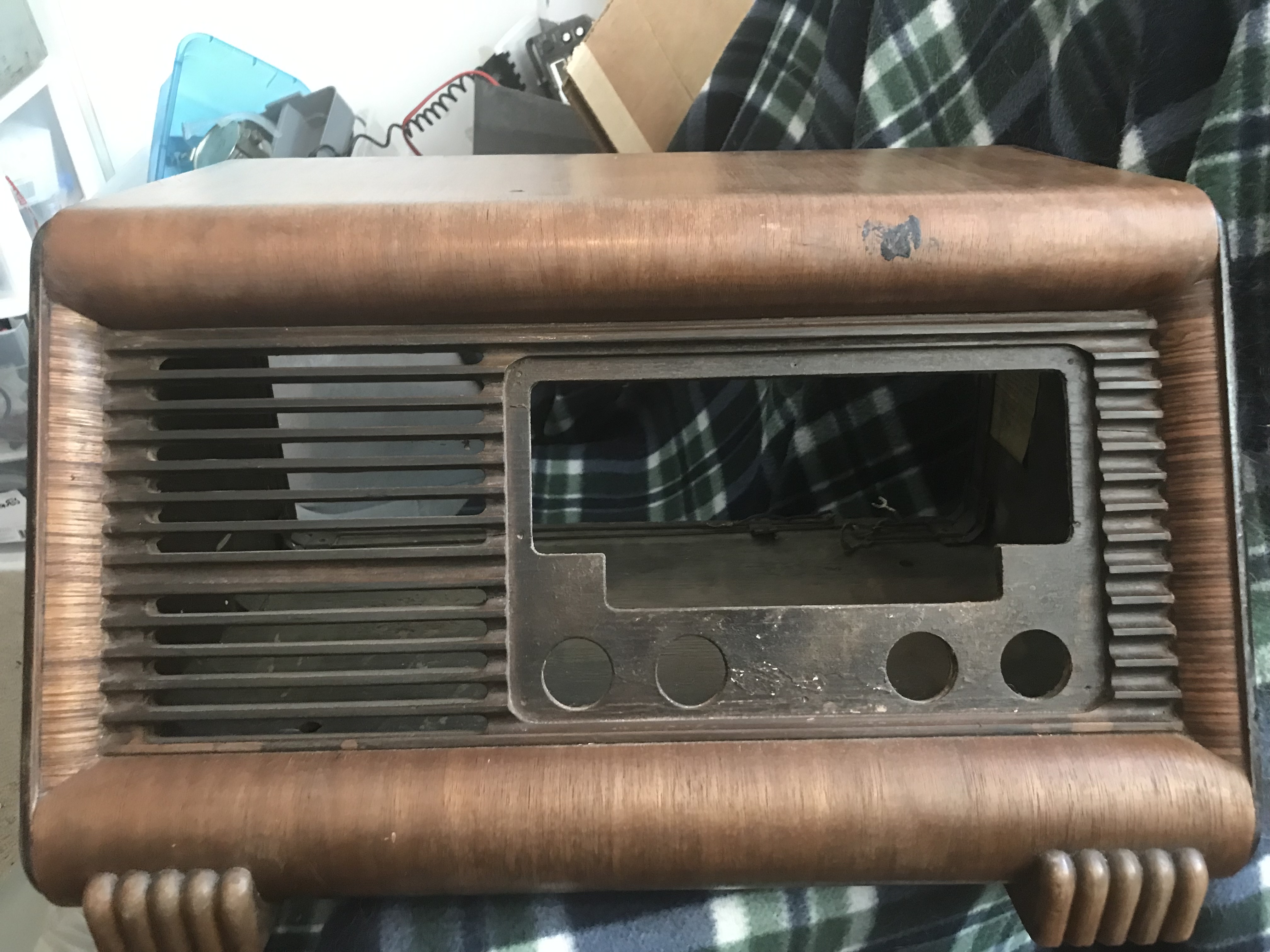

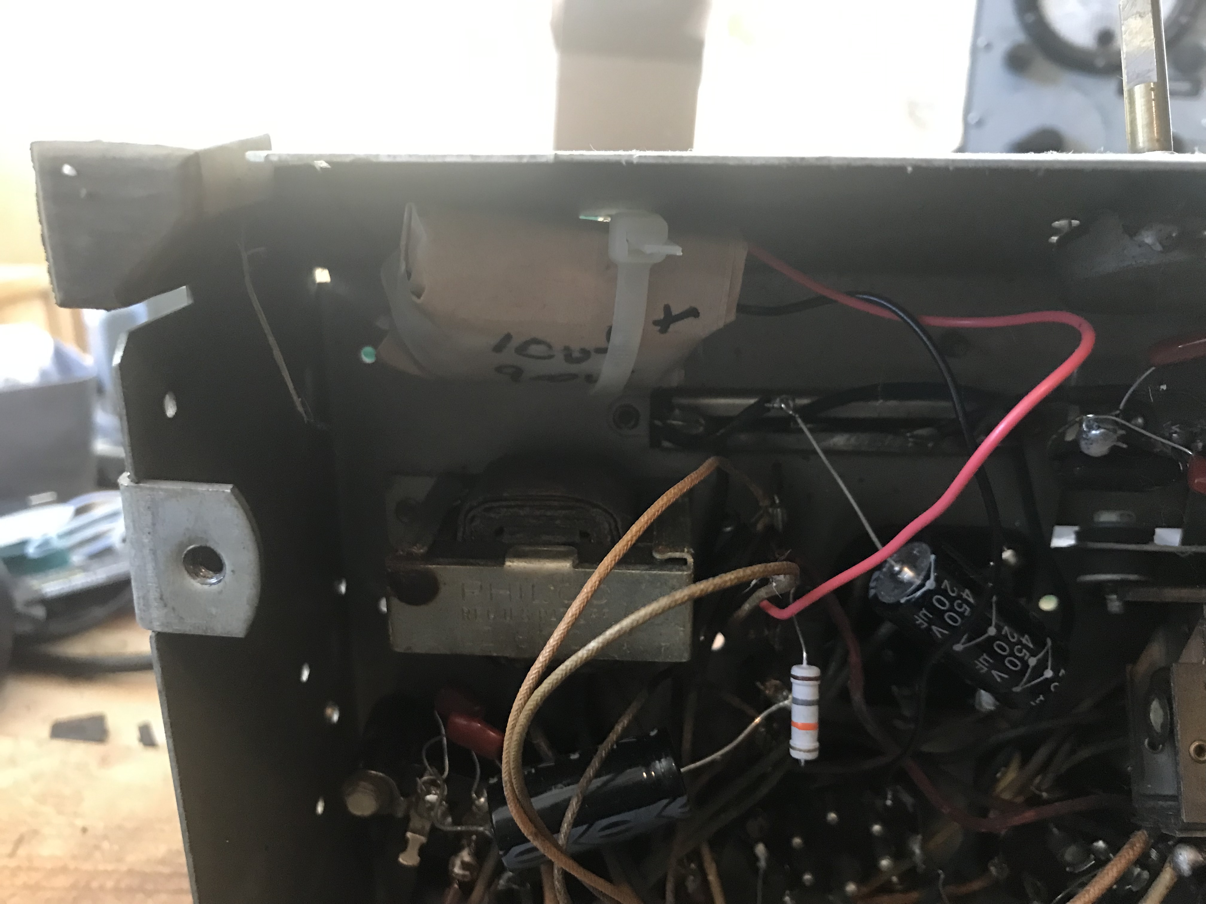

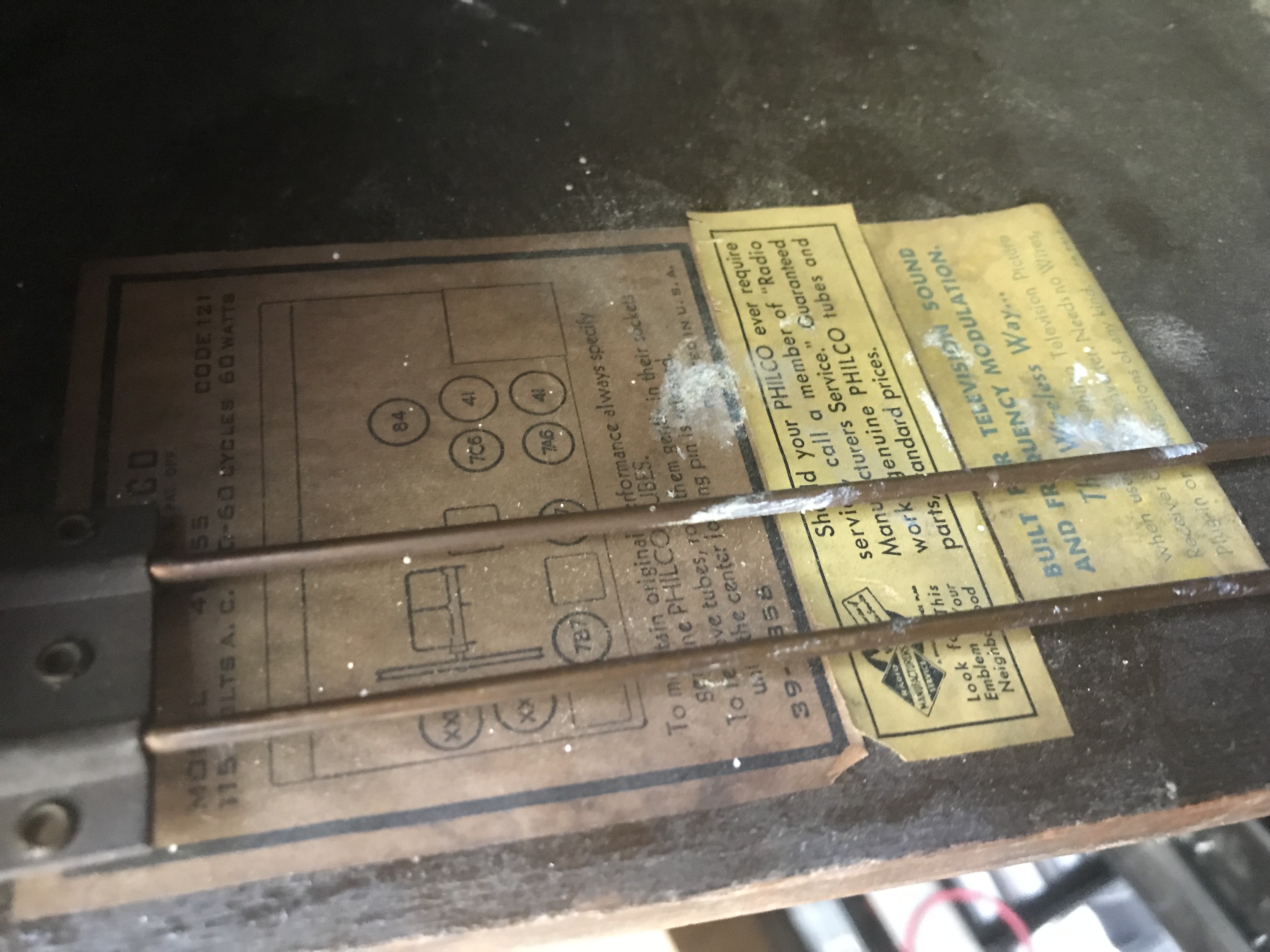

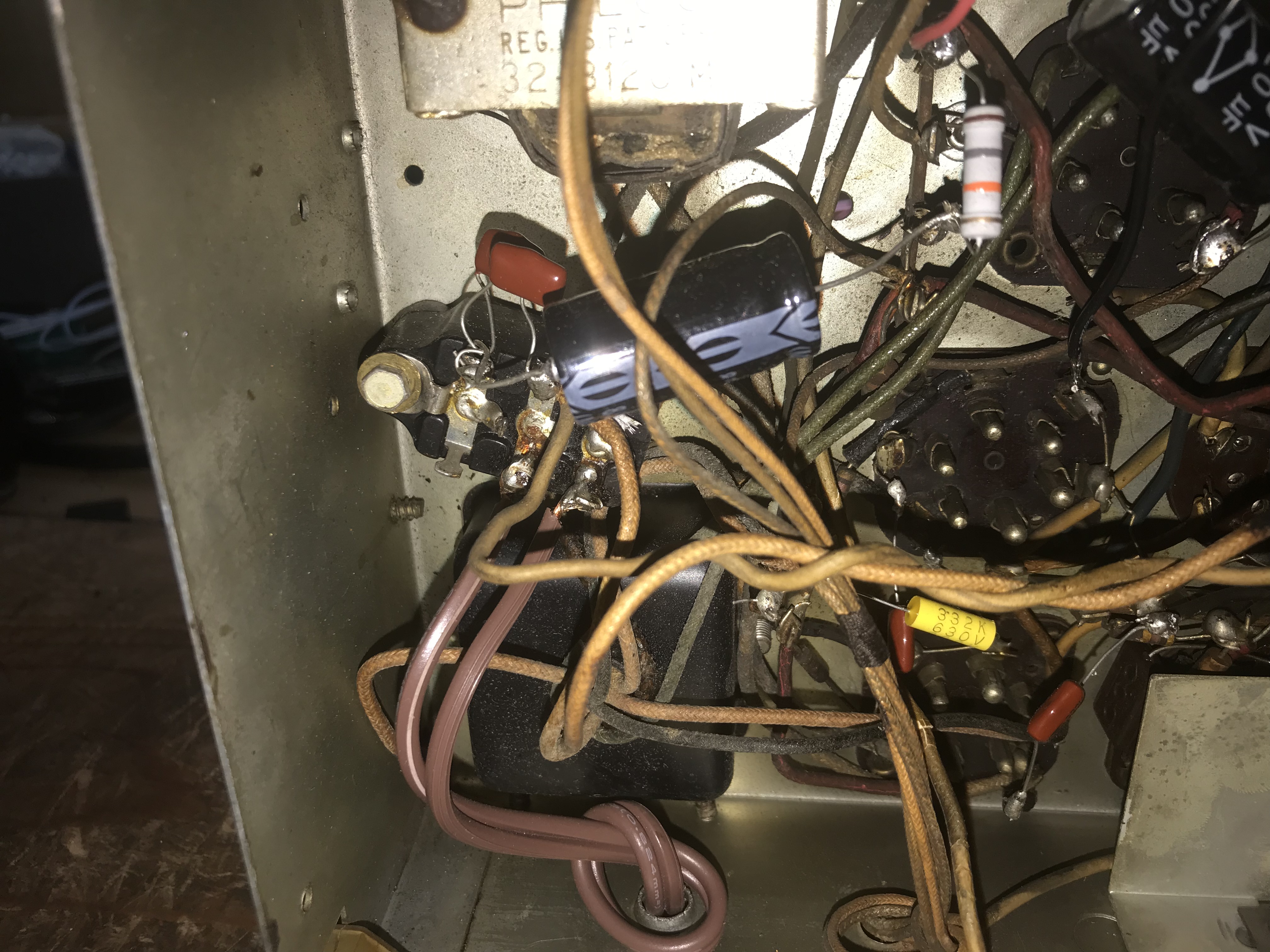

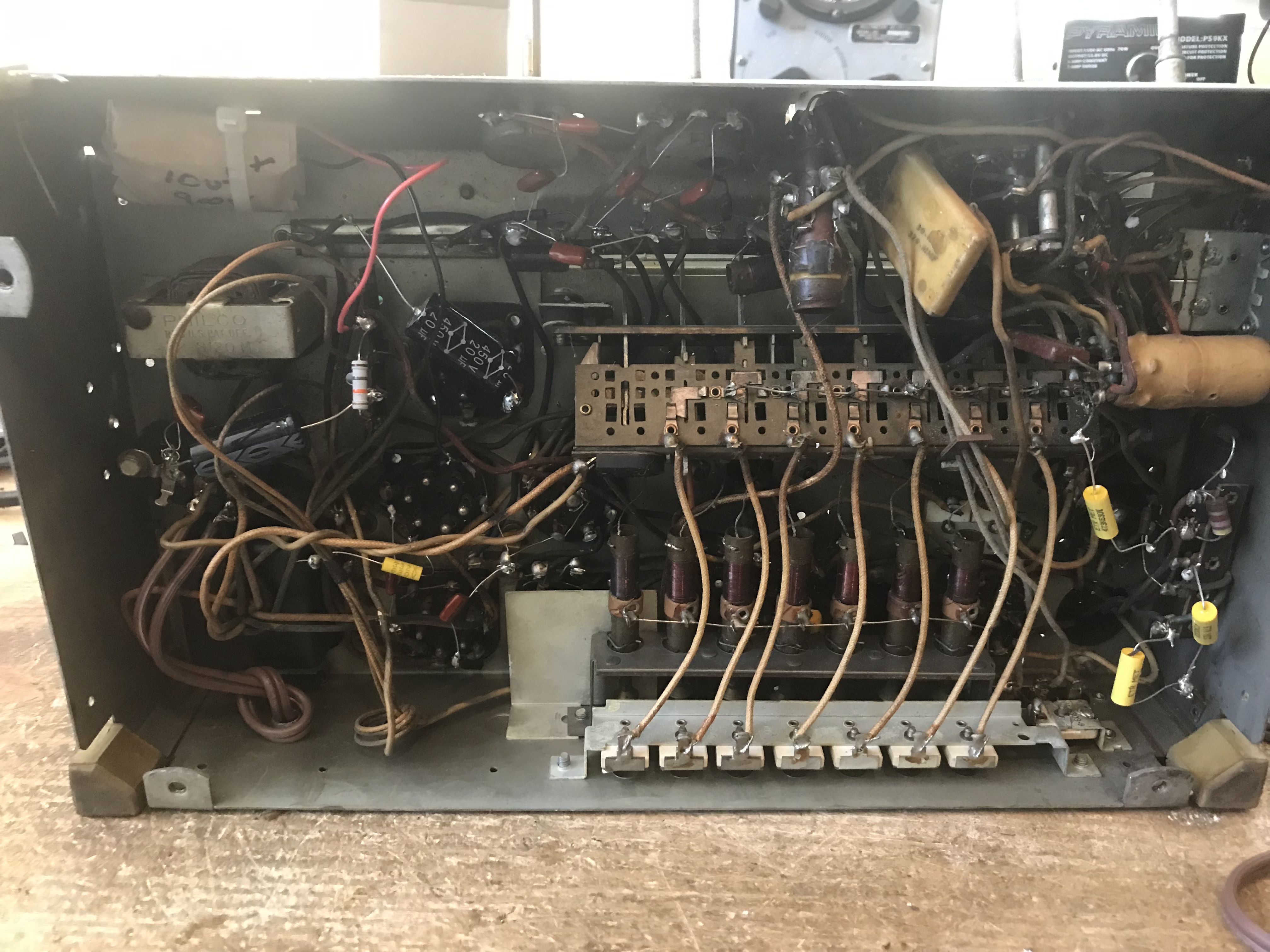

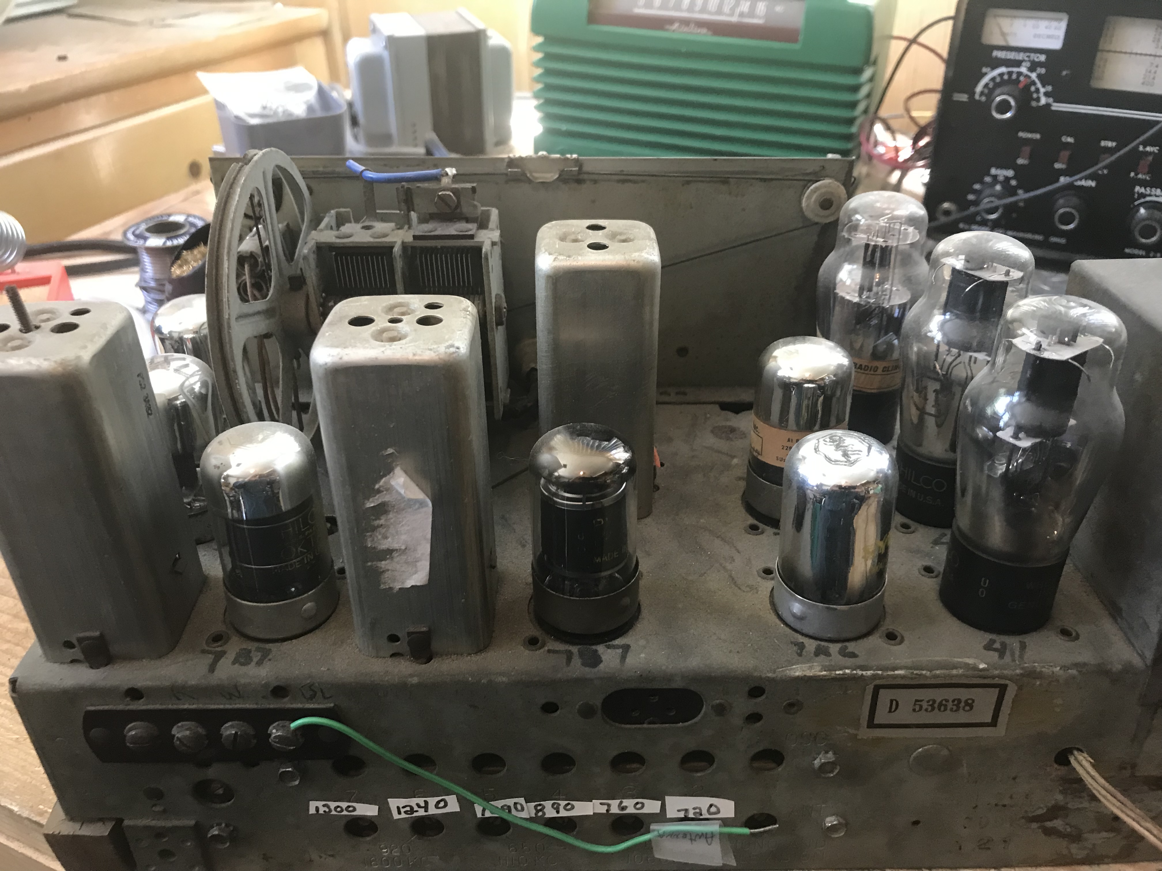

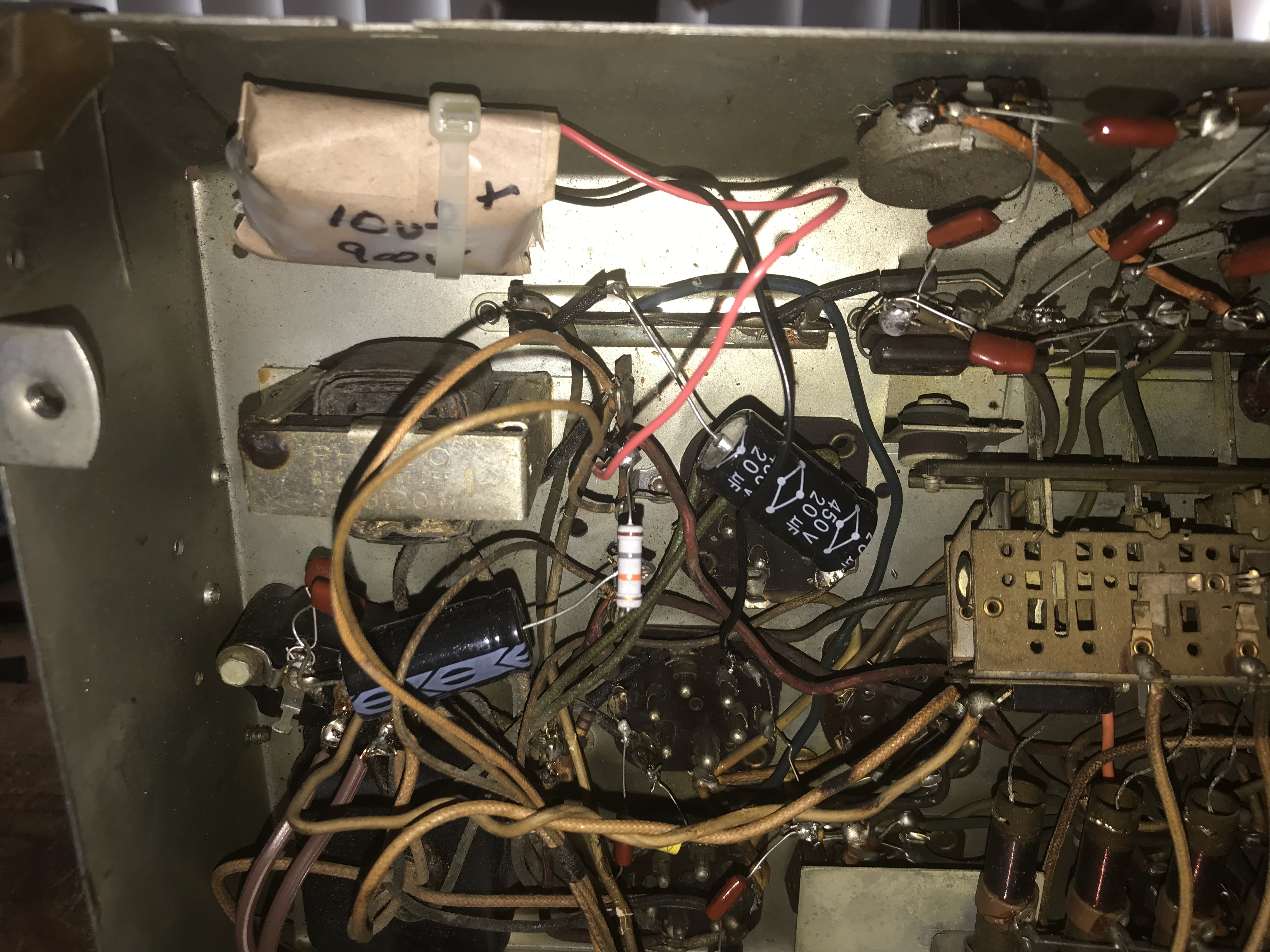

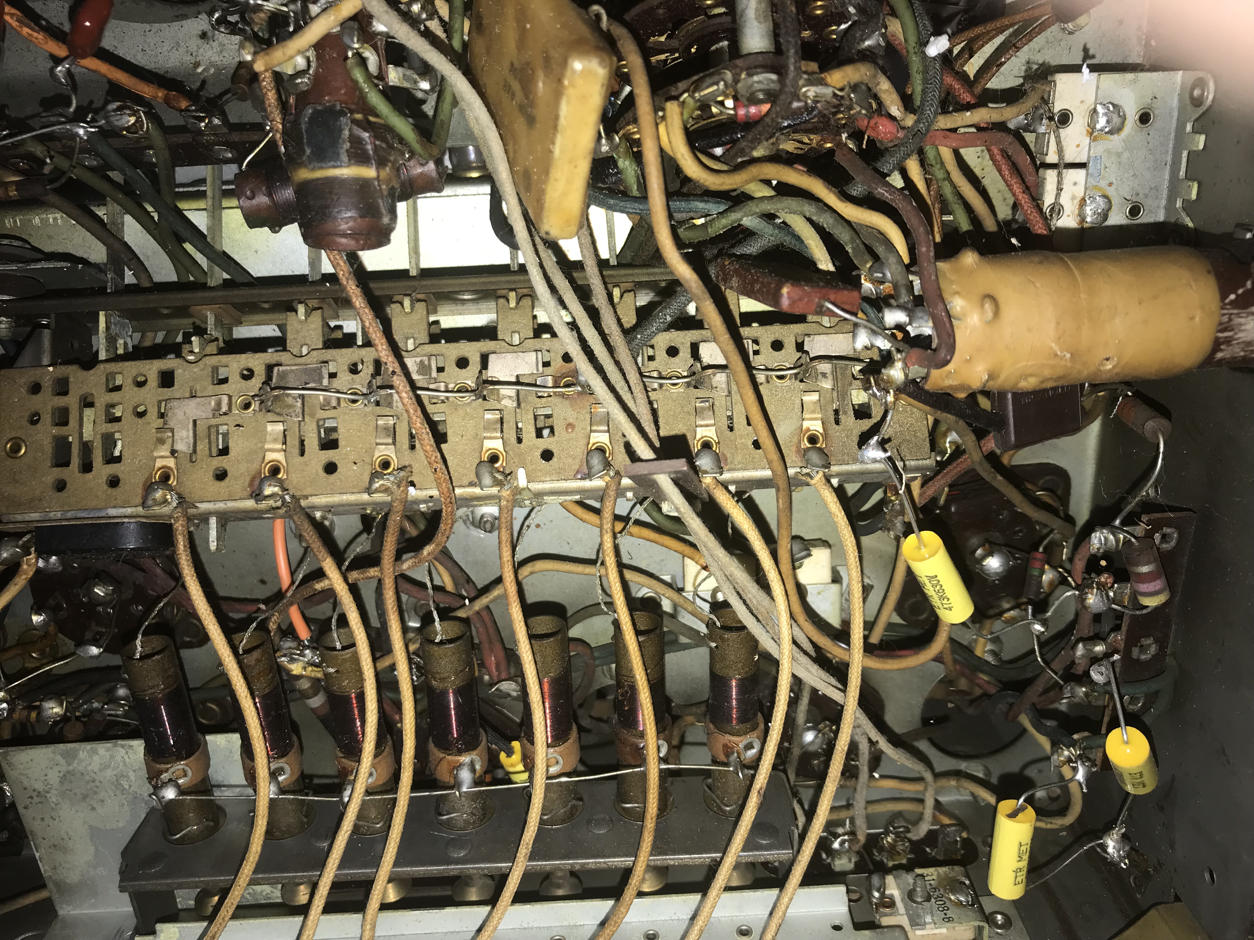

I got this today. This had already been worked on electrically recently - note new caps. I’ve got to check
out whatever that white paper container is. Even the wiring looks like new.
Otherwise, aside from a missing speaker which I need to source - see my WTB post - this is all just cosmetic stuff. The hardest thing to find will be that metal trim strip for the knobs.
The case is in almost perfect shape - one bit of goo came off. The only defect I can see is a light water stain ring on the top. I’m just going y clean and wax the case.
I’m just shocked at the wonderful state of this - and I paid $30
