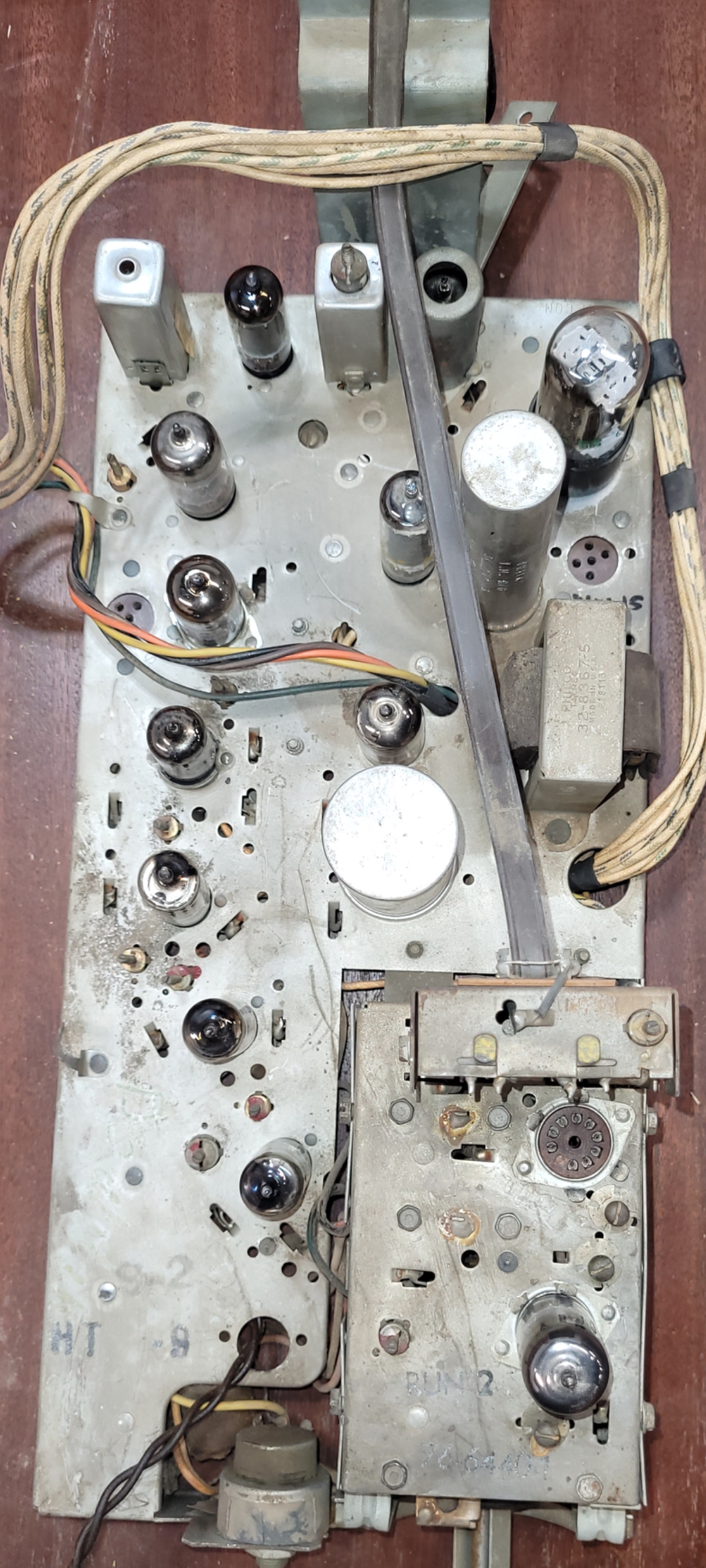

The first problem I have is that it's missing a tube. The schematic for the RF-IF tuner shows a 6CB6 tube, but on the chassis there is a 9 pin socket, which means I have the wrong schematic.
So... I'm trying to find the console model # , so I can get the correct schematic, so I can get the correct tube. The back of the tuner just has RF 35 rubber stamped, and RUN 6.

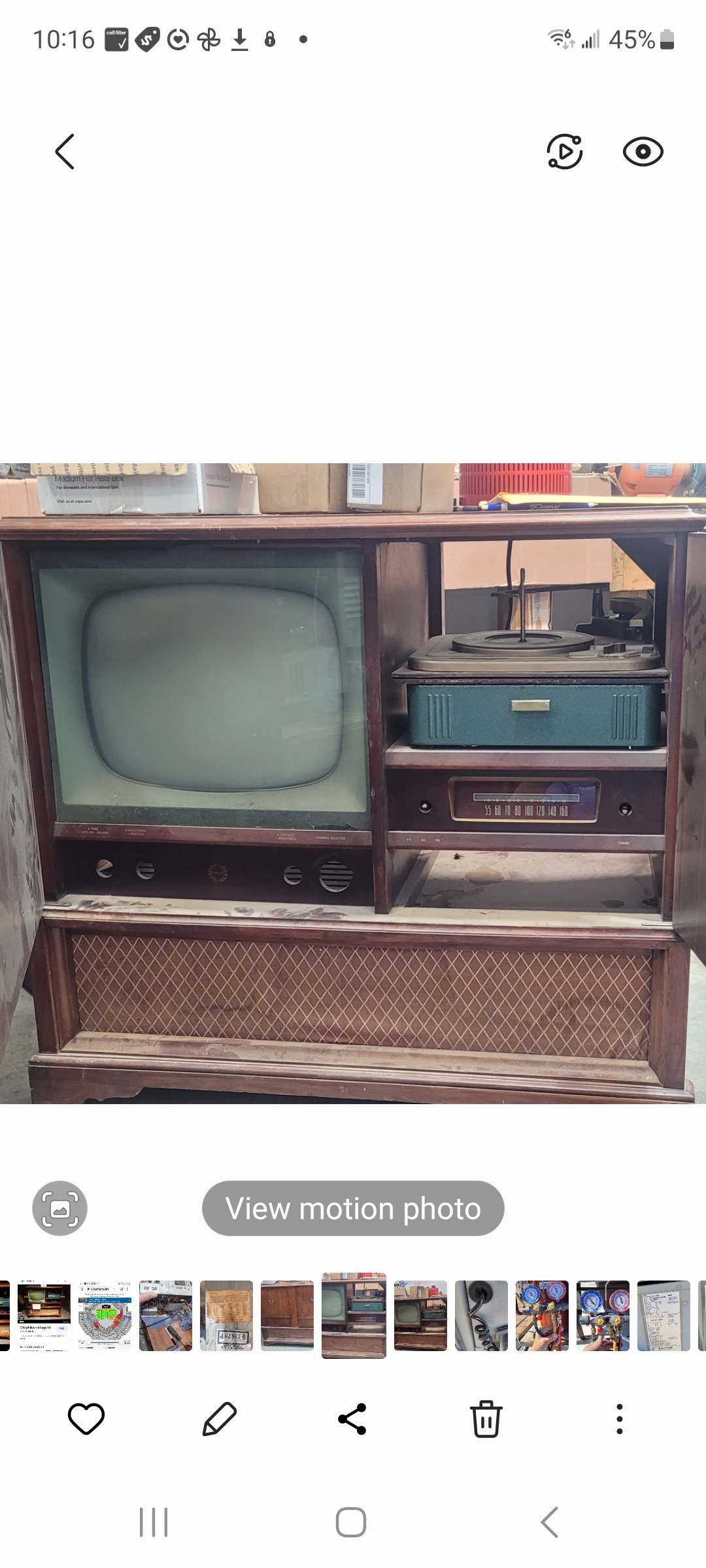

I've been searching that #, and no results. I have pics of the console, and found one on the internet that looks like an exact match, but still no mod #. And adding pics here is a little tricky.
