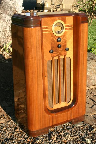

Quick, slightly blurry photo of a 37-650X...
[Image: http://i326.photobucket.com/albums/k420/...7-650X.jpg]
Another refinishing job by Barry Jones of Evansville. You can see where the shading should be in certain areas.
If your cabinet was finished with a true lacquer finish, it can still be made to look like this. All it would need is some light sanding, then some extra dark walnut toning lacquer sprayed on the trim as shown above. Follow that up with some coats of clear lacquer. I believe it should have extra dark walnut on the trim instead of the medium dark walnut used on the cabinet above, but this cabinet still looks better than a single-color (monotone) finish.

I need to take a photo of a 37-650X I have here that Barry Jones, a friend of mine and a genius at refinishing cabinets, did a year or so ago. It was toned where it should be toned...and is walnut where it should be walnut.
If it was sprayed with lacquer, don't worry, it can still be made to look right. But I would be having a long talk with that "refinisher"...especially once you see what that cabinet should look like.

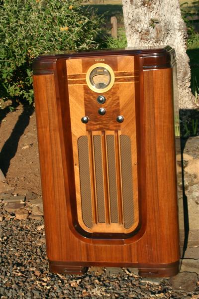

Mine is a 630 but very close to the same finish.
This is out in the sunset, so it is a little darker in a room:
Your "refinisher" should be painting houses.
That one could still be fixed. It would not be too hard for someone that knows how. Maybe you need an amateur.
