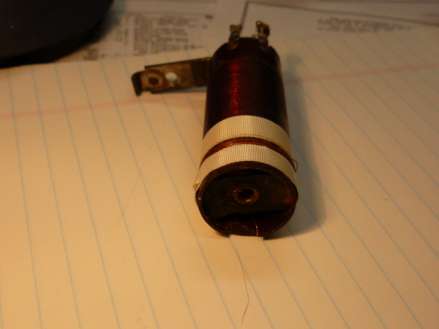

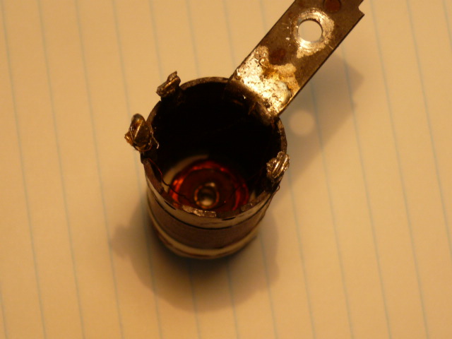

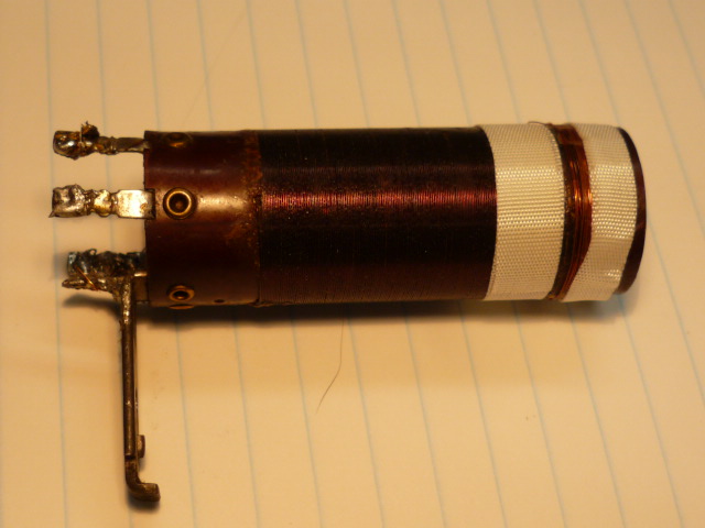

I have a Philco 551, 51, 51A I'm trying to restore and I've run into an issue with the #16 (Schematic) 2nd IF coil part # 03886.
There are 4 tabs and I'm looking for resistance values and which tab's they go with, someone has been in this and rewound part of it, is turning into a bear to sort out.

An IF transformer is difficult thing to rewind and make it work properly. The type of wire, the distance between the coils, how it's wound, and the amount of Q of the coils are all factors that determine the IF transformer's performance.
If the rewind looks like it's hand wound or spun on a drill I would look for a replacement 175kc transformer. They were popular from the '30s-50's so they're not hens teeth.
The resistance readings don't really mean anything in this case. It would just tell you if the coil is open or not. Your probably looking for about 20-30 ohms.
Yes it has been partially rewound and I get about 7 on one coil and 3.5 on the other. I will look around for a 175 kc can.
I put the tape on to keep the end coil from unraveling.

Hold on - that is not an IF transformer. It looks like an antenna coil.

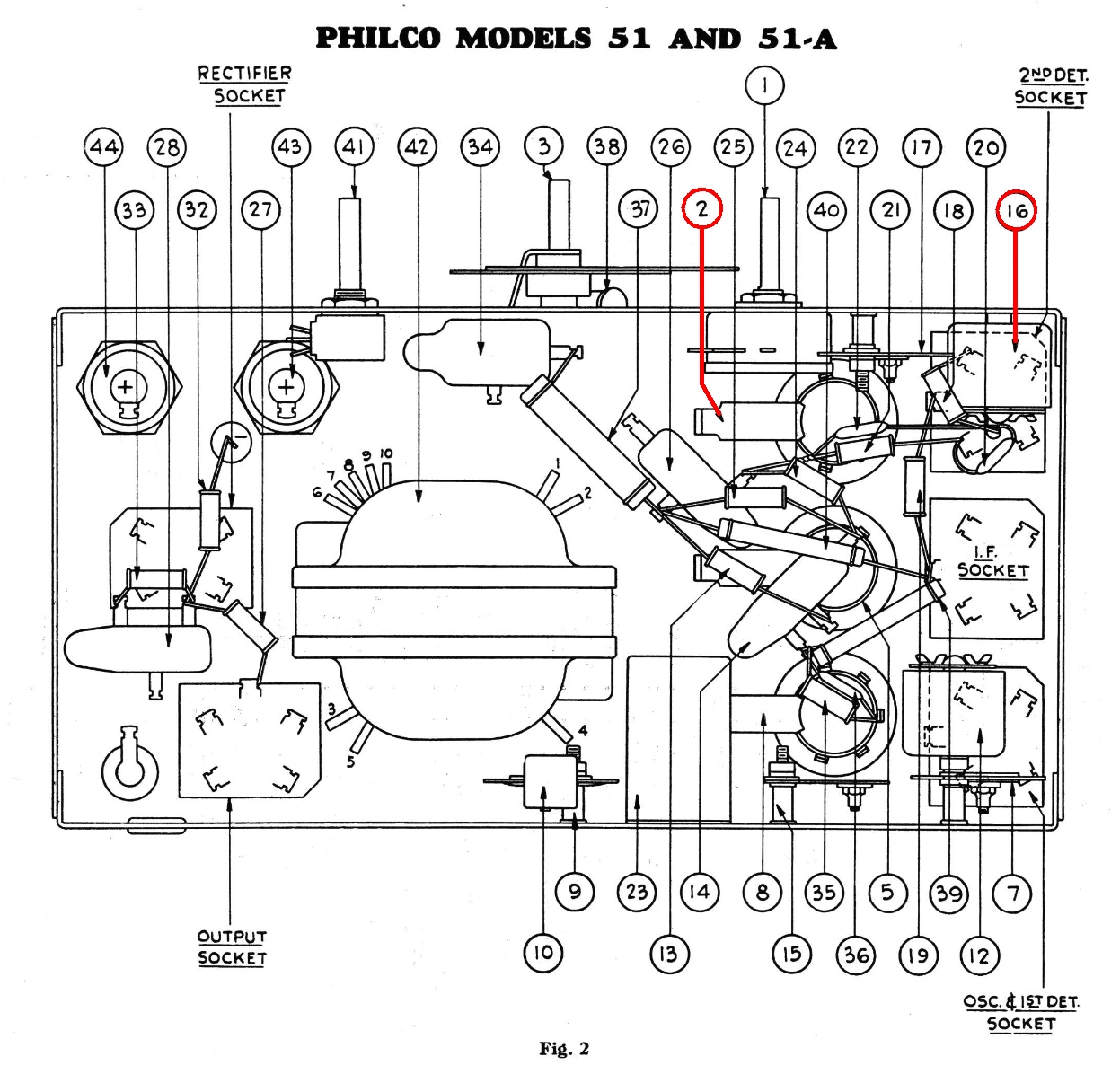

Please study the under-chassis drawing (taken from Service Bulletin 114, for model 51) carefully.
Notice that the 2nd IF transformer, part (16), is in a cylindrical container mounted above the 2nd det. tube socket (when looking underneath the chassis). The 1st IF transformer, part (12), is in an identical cylindrical metal container, mounted above the 1st det.-osc. tube socket. The antenna coil, part (2) and probably the coil you have photographed, is mounted inside the chassis as shown in the drawing below.
Please confirm where that coil came from in the chassis.
You are spot on!
I now see the IF's 12, 16 (I would have never spotted them) in the chassis and the coil I pictured is in the can marked by #2.

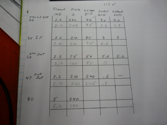

It powers up and I can get some static as I touch components so I think the Audio part is ok, here are the Socket Voltage readings that I took the one that looks really out of line is the control grid on the 24 2nd detector I get nothing.

A word about the antenna coil, part (2). As the winding that was rewound appears to have been done rather sloppily, this is in the antenna input of the radio and, therefore, is somewhat forgiving. If it had been one of the other coils, it is more important that they be rewound properly if they were to need it.

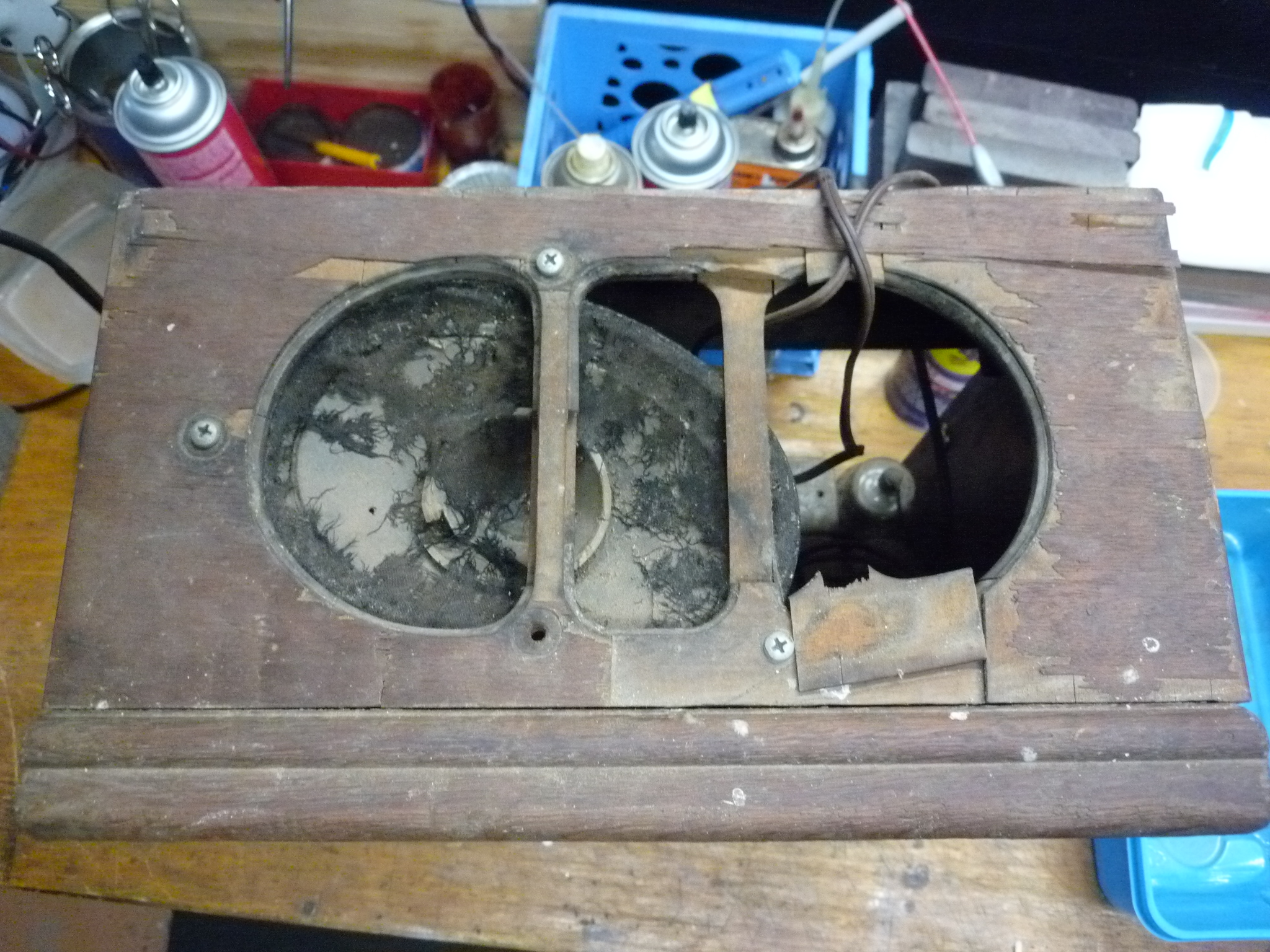

I will work on replacing the rest of the caps and resistors, Also working on the cabinet it was in terrible shape and am in the process in making some of the wooden parts that belong on the top and speaker grill.
