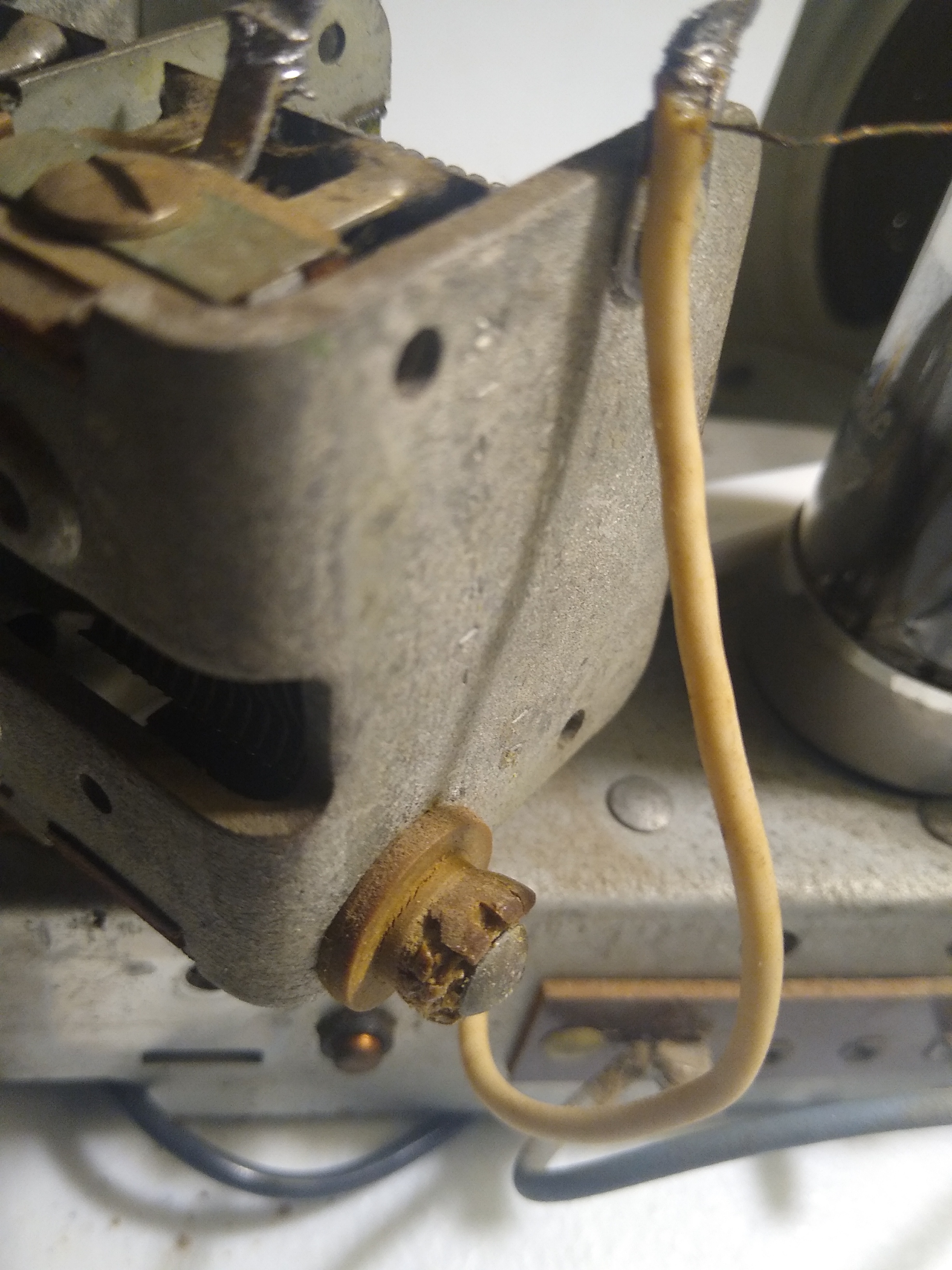

I received this radio and original condition and it was not working. After replacing the capacitors and one weak tube, I now have it playing.. my question has to do with the tuning condenser.. the tension on the dial string pulls it downward so that the large pulley is rubbing on another metal object. See photograph with green arrow. This means that, when I turn the tuning knob, the string just slips and the tuning condenser does not rotate. Using a screwdriver or similar tool I can lever the tuning condenser up, allowing me to operate the pulley, but when I stop pushing with the screwdriver, the string tension pulls the shaft back down. The assembly seems to float within the frame.. What do I need to do to put this back into good operating condition?

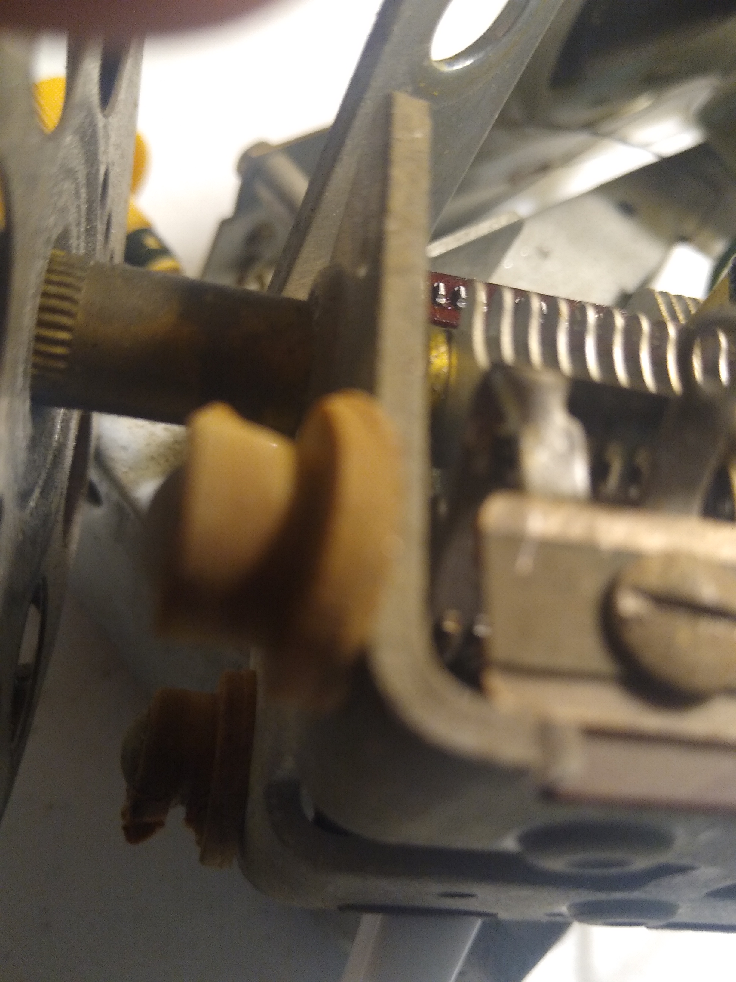

Thanks, guys. Turns out there are rubber grommets involved, but they are on the sides of the condensor, not the bottom. See brown objects in photos. P all three of these rubber mounts are turning into powder. Acc to the schematic, they are part number 27-4771-1
Any ideas for a good replacement?
You might check these out: http://www.renovatedradios.com/product.php?product=313  Double check the sizes to see if it is suits your needs. If not have a look around the site maybe there is something that will. GL
