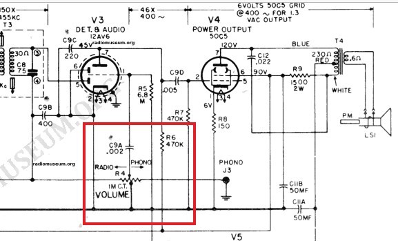

Hey Terry,
Being clumsy and using too many words is my special job. Since you write concisely and with great intelligence, brevity and clarity is your job (Insert all in good humor emoji here) Since I forgot to click the detailed reply, I will make another entry with the GE 574 clock radio schematic which uses the same scheme. It can be compared to the Philco schematic. A picture = 1,000 words, 1,000 of Terry's words and about 15,000 of mine.
I noticed that the Phorum somehow promoted me to expert. If that was a moderator's decision, I am humbled and honored. They made a big mistake in doing so, but I thank them. If it was an Algorithm's decision, then I still thank the Phorum
Wink
Hi Pholks,
This is a copy of the GE 574 Radio - Phono Volume Control.
It is a single pot with a grounded (to B-) center tap.  Resistance between the 2 ends of the resistor body is 1MOhm.  It is likely that the resistance between either leg and the grounded center tap is 500KOhm.  I assume that the unit acts as a back to back audio taper.  The midpoint of control rotation puts the wiper over the grounded center tap and is minimum volume for both.  Unsure why Philco did not draw the control in the same manner.

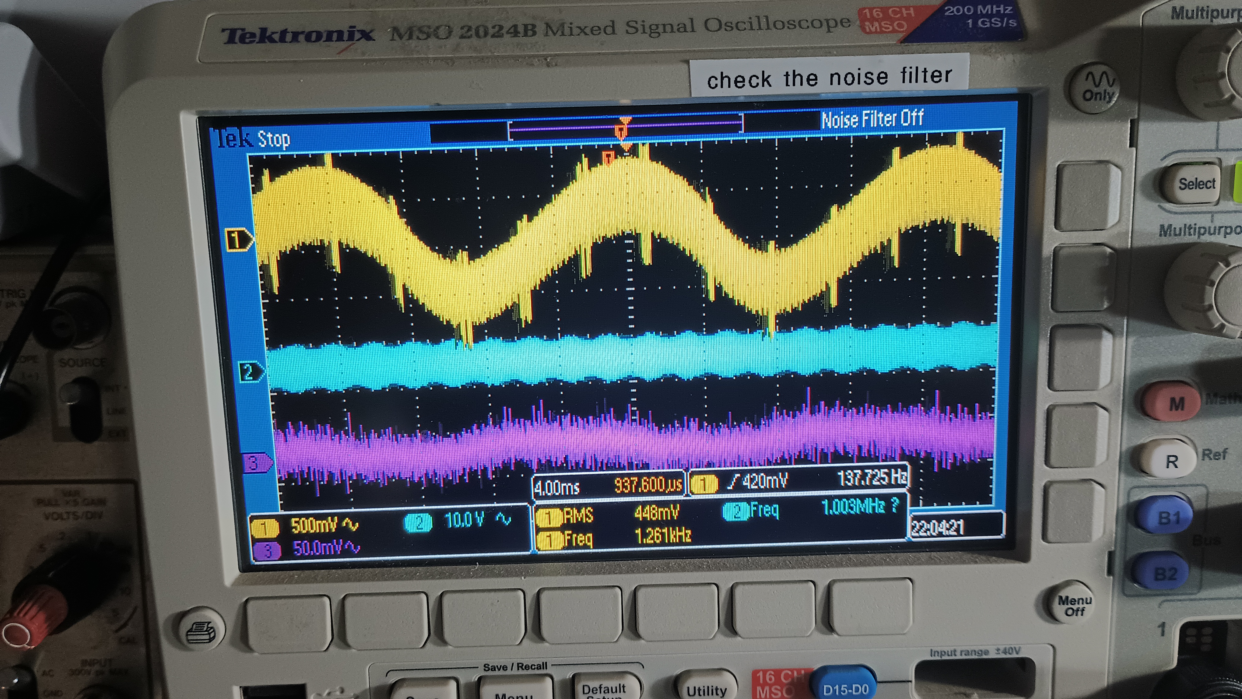

Input signal is 1000kHz
Signal shown in photo is what I see at pin 5 of the detector.

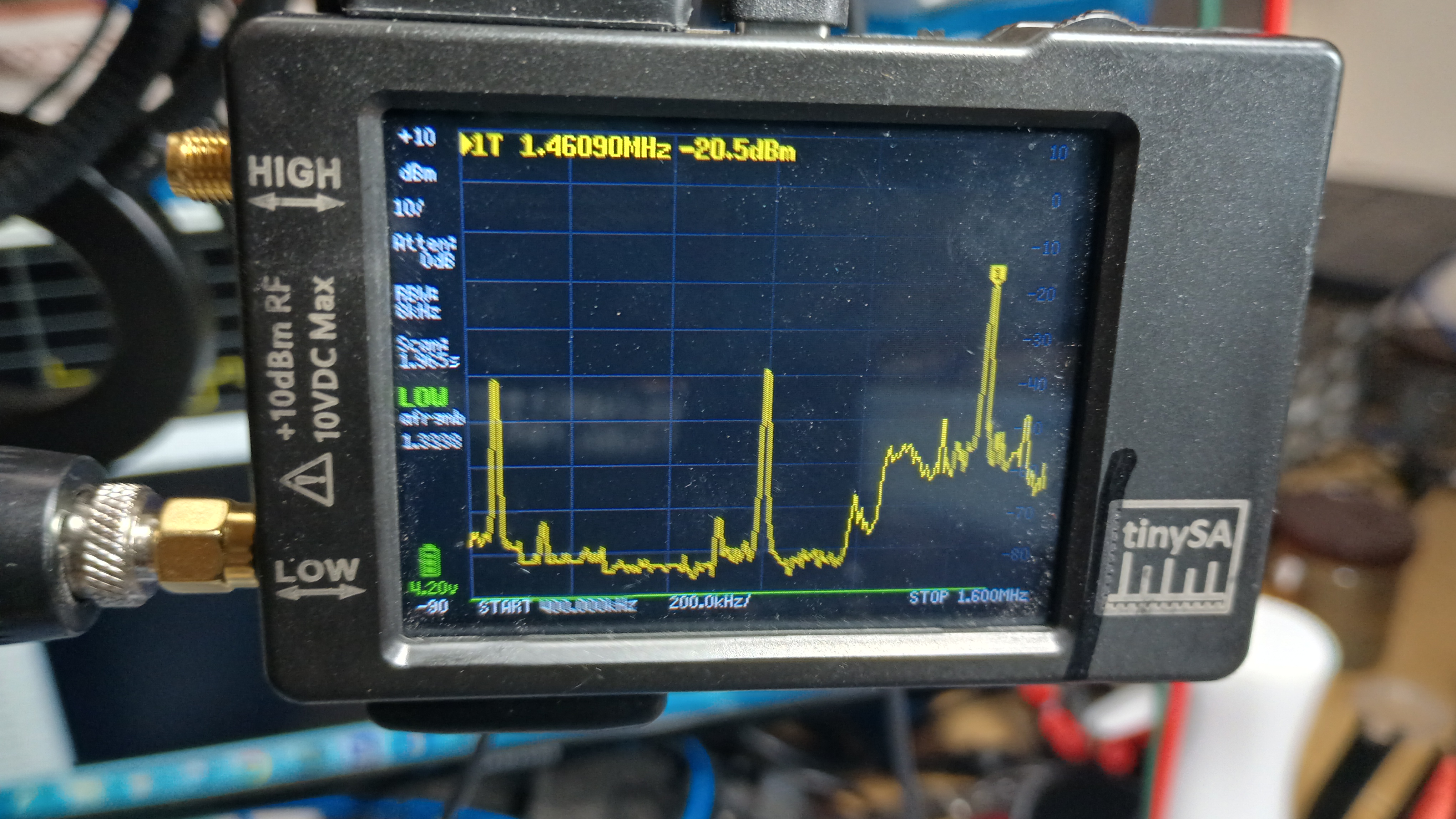

As shown in the last reply, I'm testing with a modulated 100kHz signal. I'm seeing the IF, the original signal, and the local oscillator. What I'm not hearing is any output from the detector.
The test signal being sent to the loop is shown in cyan. The output from the mixer (pin 2) is shown in yellow. The input to the detector (pin 5) is shown in magenta. I'm not sure what the periodic bursts from the mixer are - their frequency is about 300Hz.
