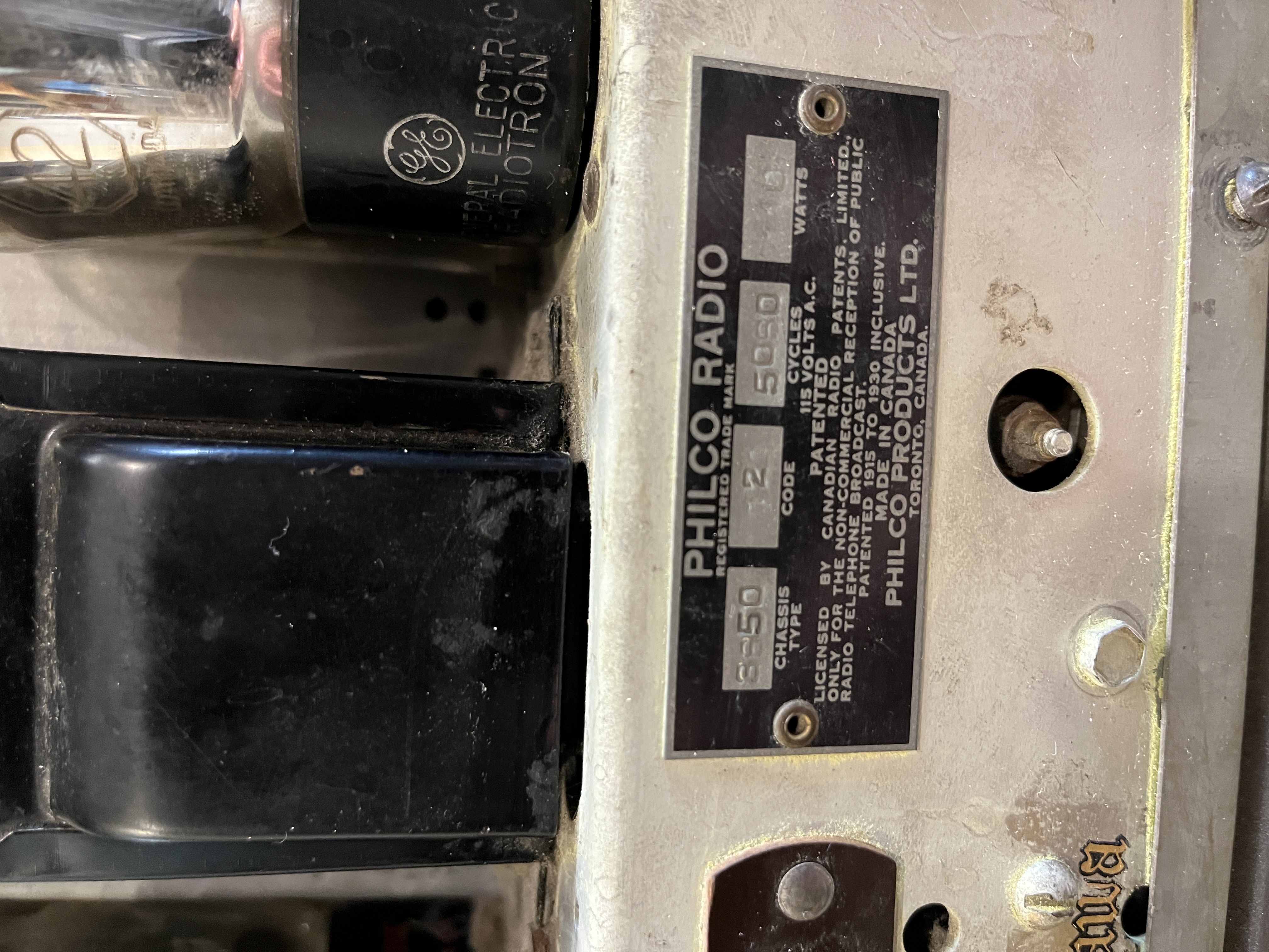

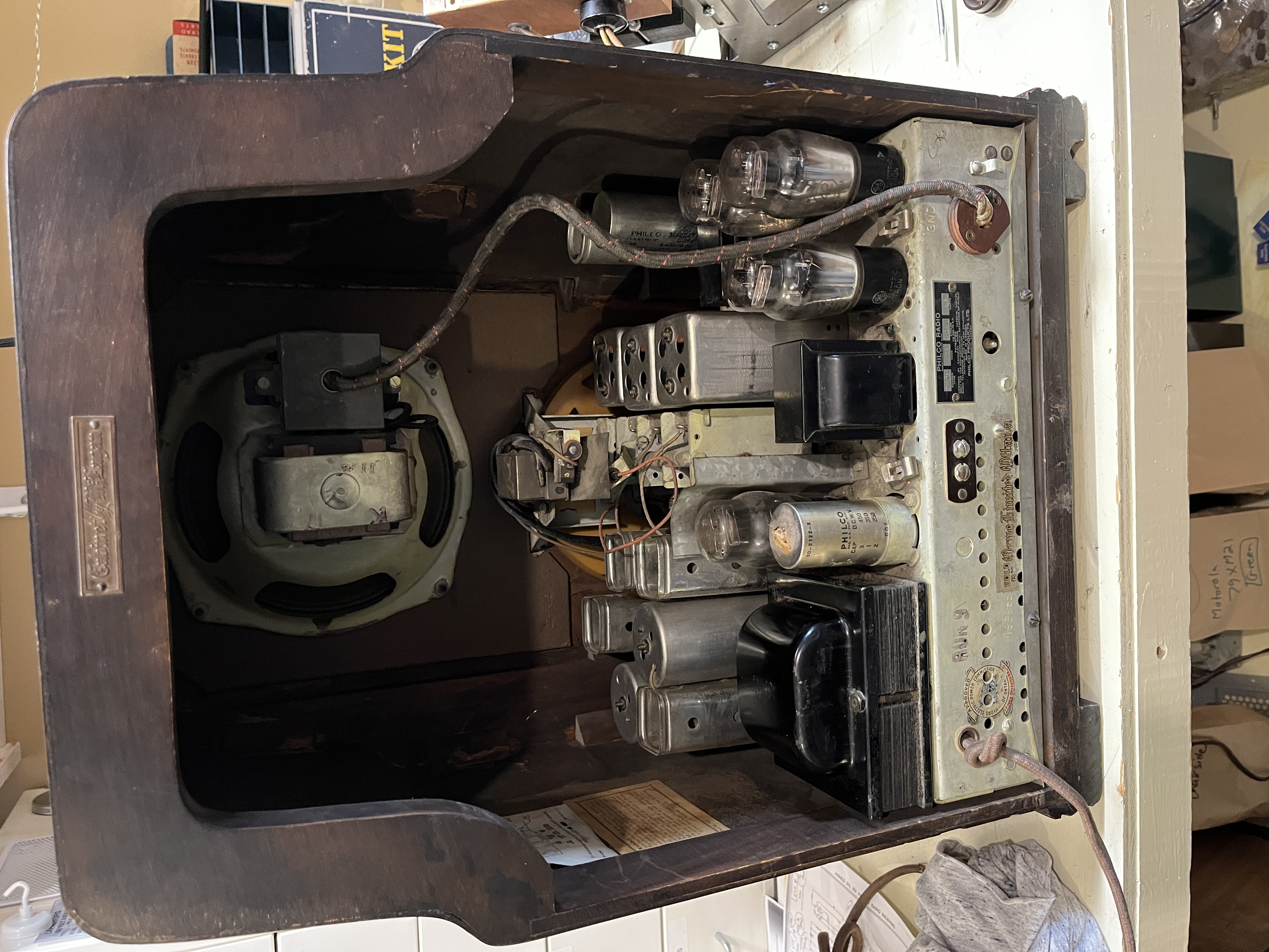

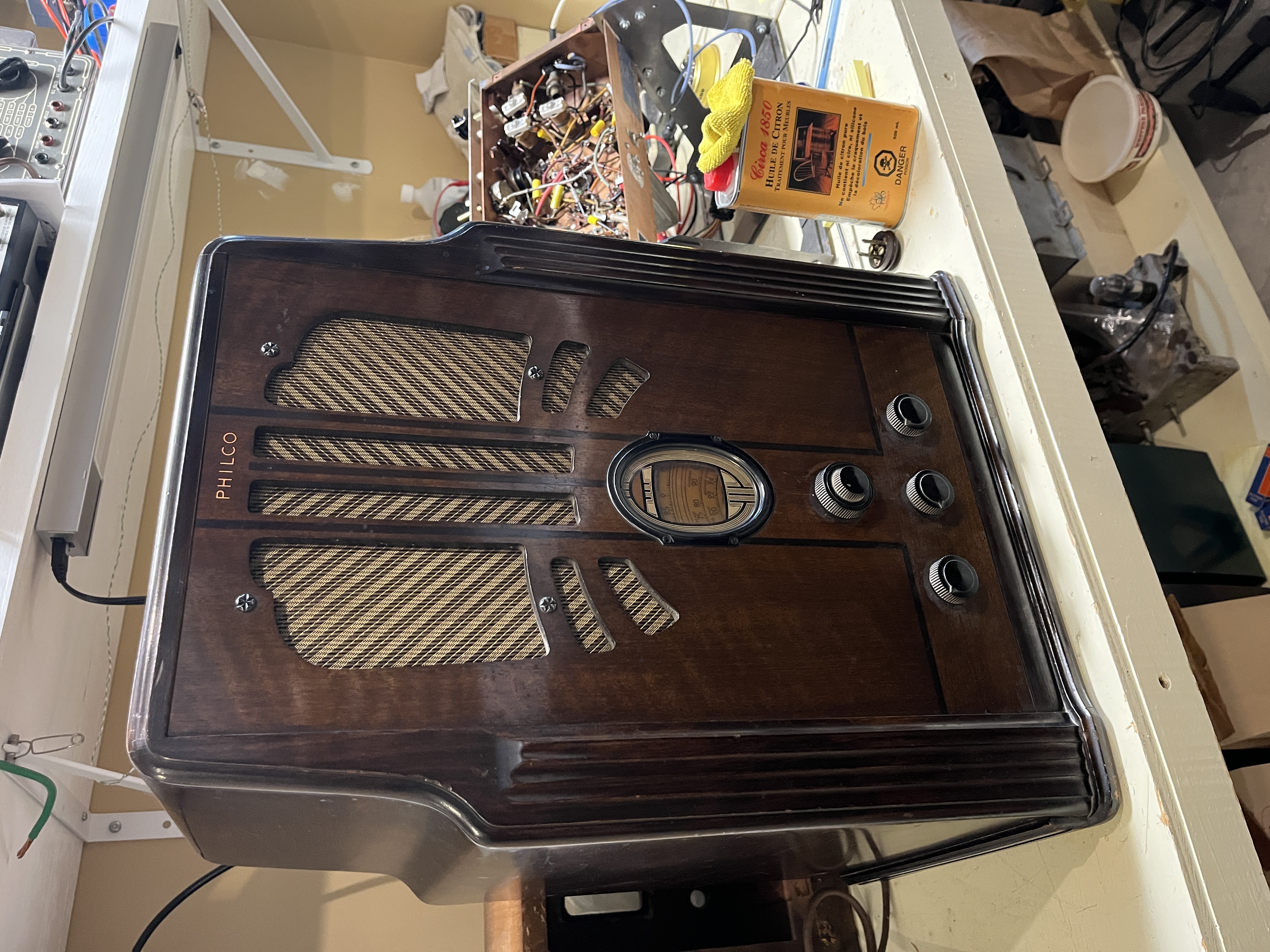

New toy in the collection to play with- 3650 tombstone! Very heavy!
Chassis is clean, but one of the electrolytic cans has blown it's top, and the 80 rectifier tests open filament, so...may find bad things when I take the chassis out.  Icon_problem

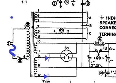

The "Diode" mod that I describe is useful for radios that use the 80, 5Y3, 6Y4, 5Z3, 5U4 etc. full wave rectifiers, where the filament is the cathode.  if the filament opens from overheating, etc. or in the old 80s, just from age, and touches the plate, the tube is shorted from plate to cathode.  this puts AC across the electrolytic filter caps, shorting and possibly blowing them up.  In addition, for 1/2 cycle, there will be a dead short across the transformer secondary.  Since these sets usually are not fused, the secondary will burn out, sometimes with fire.  This actually happened to me and I lost an early post-war Philco console, my parents and sister lost hair and I was forced to put the radio to the curb.  Mom would not let me restore it and Dad knew where his bread was buttered.
The actual procedure is pretty easy.  You can use 1N4007 (1A, 1000PIV) diodes.  I use 3A 1000PRV diodes.  Simply:
-Unsolder the 2 HV "legs" from the Plate pins of the 80, 5Y3, etc.
-Solder the cathode (band) end of a diode to each plate pin of the rectifier socket.
-Slip a piece of heat shrink tubing over each of the 2 transformer HV secondary lead, as far down the lead as possible.
-Solder each of the 2 HV leads to the anode of each of the 2 diode installed.
-Slide the heat shrink tubing over the diodes, covering all exposed leads and the solder "joint between each diode and the
  transformer secondary lead.  Shrink the tubing.
-Add a fuse to the transformer primary between the power cord and power switch.
See the next post for a Scematic showing the "Mod".
Since a picture is worth 1,000 words (or 10,000 of my words, attached below is a partial schematic of a Philco Model 20 Power supply section with the diode mod and fuse added:

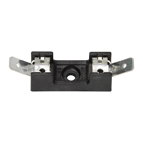

Hey MrFixr55 - Unless I missed it, you didn't give a recommendation for the fuse on the transformer primary between the power cord and switch. What do you/would you use there?
Hello mark,
Far as your Answer to Line fuse you could easily mount one under the chassis here is the type I use .
Also I see your plate on the back of the radio says it draws 110 watts so that means its pulling just under 1 amp but you will want to go over that and I would use a slow blow .
